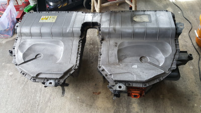

Battery just arrived. No idea on power beyond what is listed on newtis. Will find out when driving.

That was quick!
