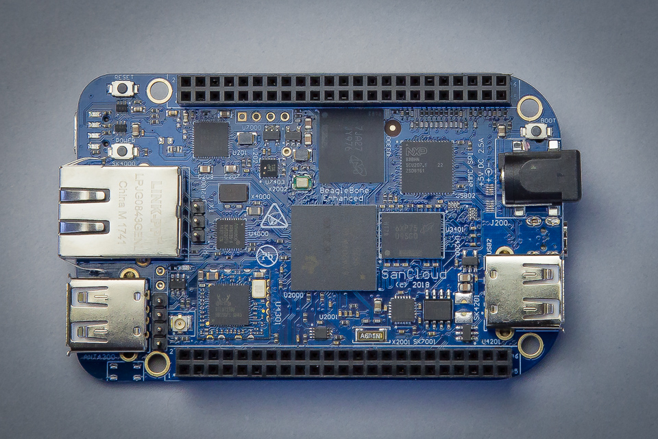

Kevin Sharpe wrote: Fri May 08, 2020 11:44 am Have you considered Renesas R-Car running Qt open source?
I'd also take a serious look at Automotive Grade Linux (here).
Which could be run on the BeagleBone Enhanced SBC which cost ~75 USD with HDMI interface (here).
Mounted inside a BeagleBone Cape if you want the full IP67 'waterproof' enclosure (here). Also available with extended operating temperature from -40 to +85 deg C.
This would give you a low cost ruggedised platform built on open source (here) which would allow the rest of us to contribute :D
