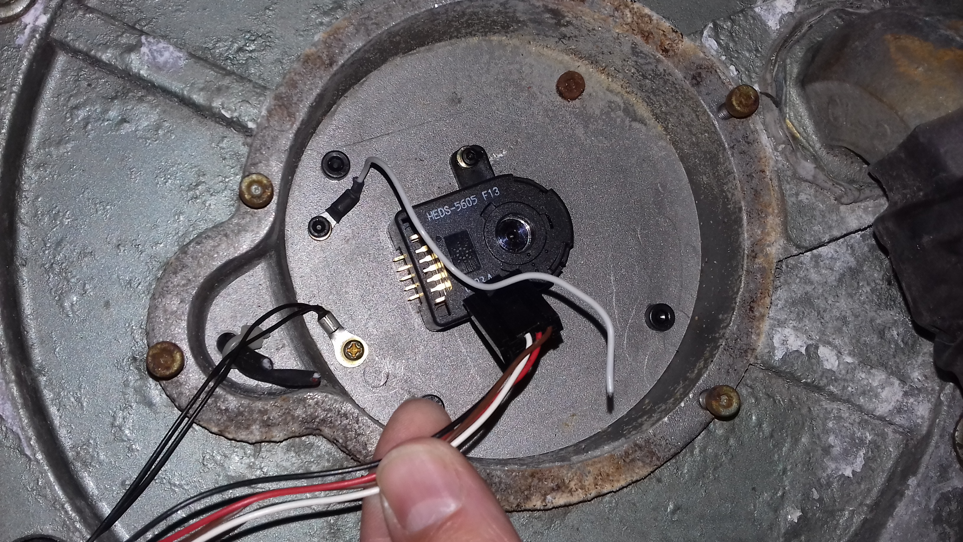

I have the 90kW Enova induction motor with optical HED-5605-F13 encoder with 256 pulses / revolution and I have taken 5V from the sensor board to power it. Signal to pin 3. I have read that the V1 board and R3 value can be altered to suit higher frequencies which this encoder will generate at > 2300 rpm, so I wonder if anyone has tried this? But since this is at motor start, as it gets spinning I do wonder if it is something else?

I got dust in the encoder wheel on my HEDS sensor, didn't show up on scope most of the time (hand turning) but generated a lot of errors at times while driving. See Substation1 in projects...

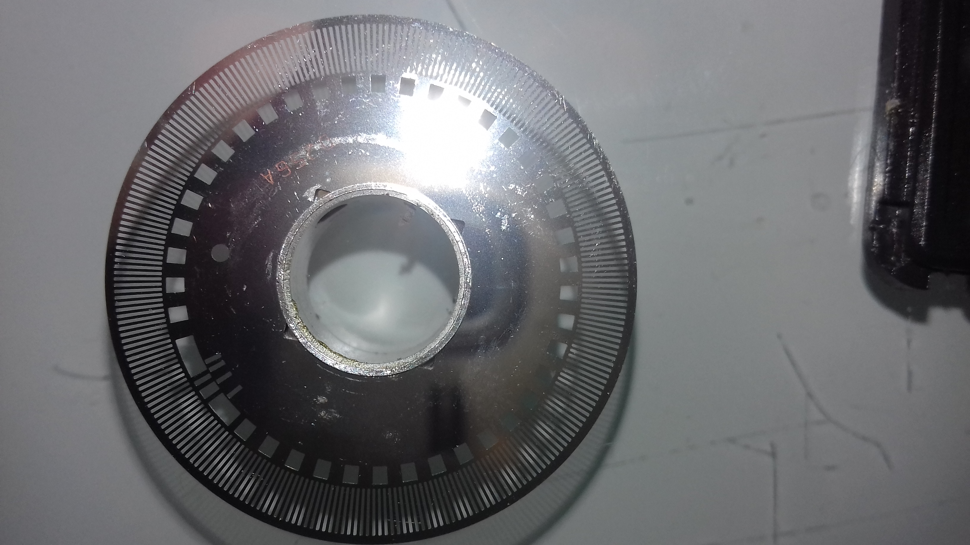

Took the Avago encoder off last night and could see it was indeed 256 pulses on the disc, all evenly spaced.
Perhaps 256 pulses and the slop in the drivetrain (im using original single reduction gearbox off the Edison van) will causes more erratic pulse signals? So i have just ordered one of these to try:

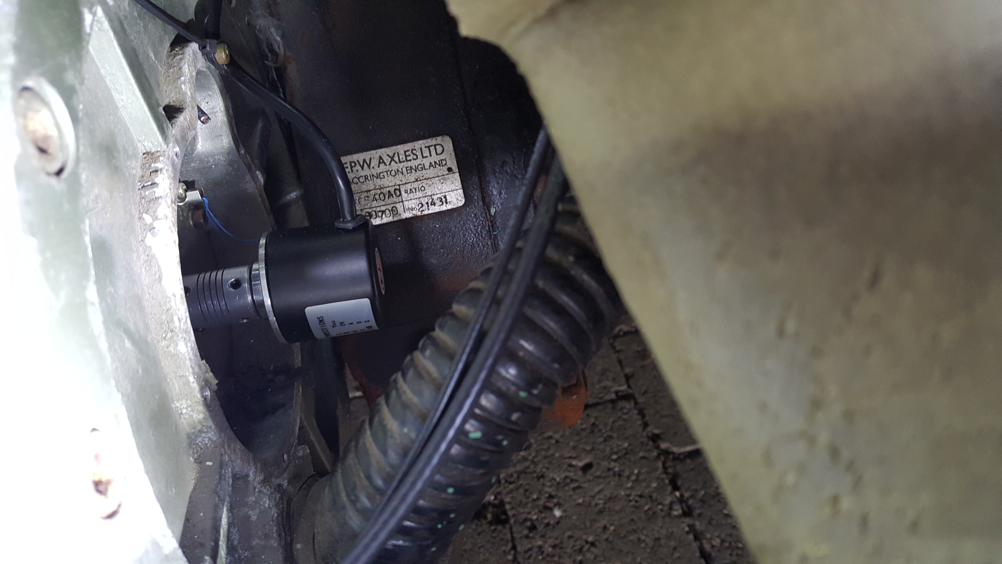

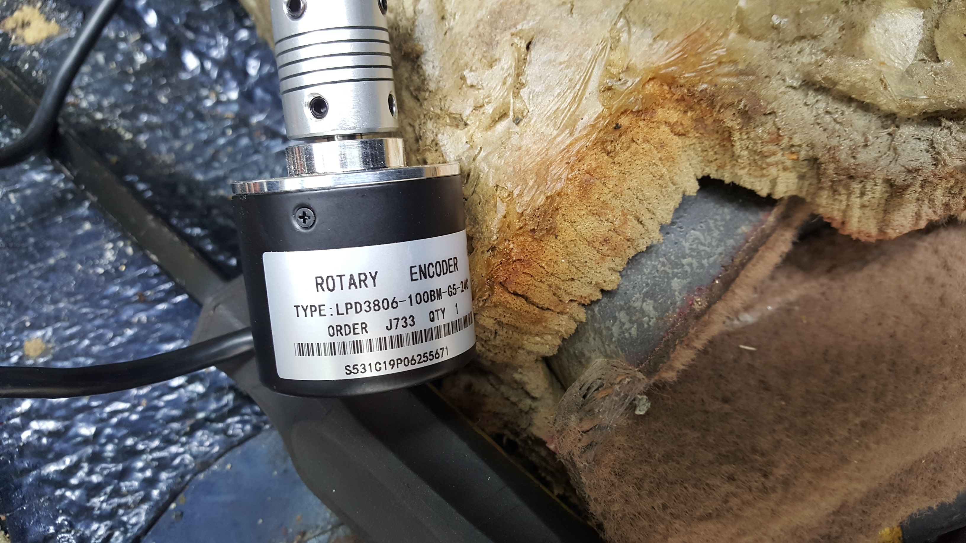

Ripped out the original encoder today on the rear drive motor on the range rover and replaces with this thing from ebay. Very big improvement. Not perfect, but much better. Never thought I'd be thanking the clown who cut out the floor...

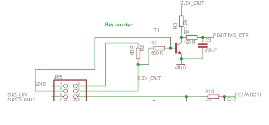

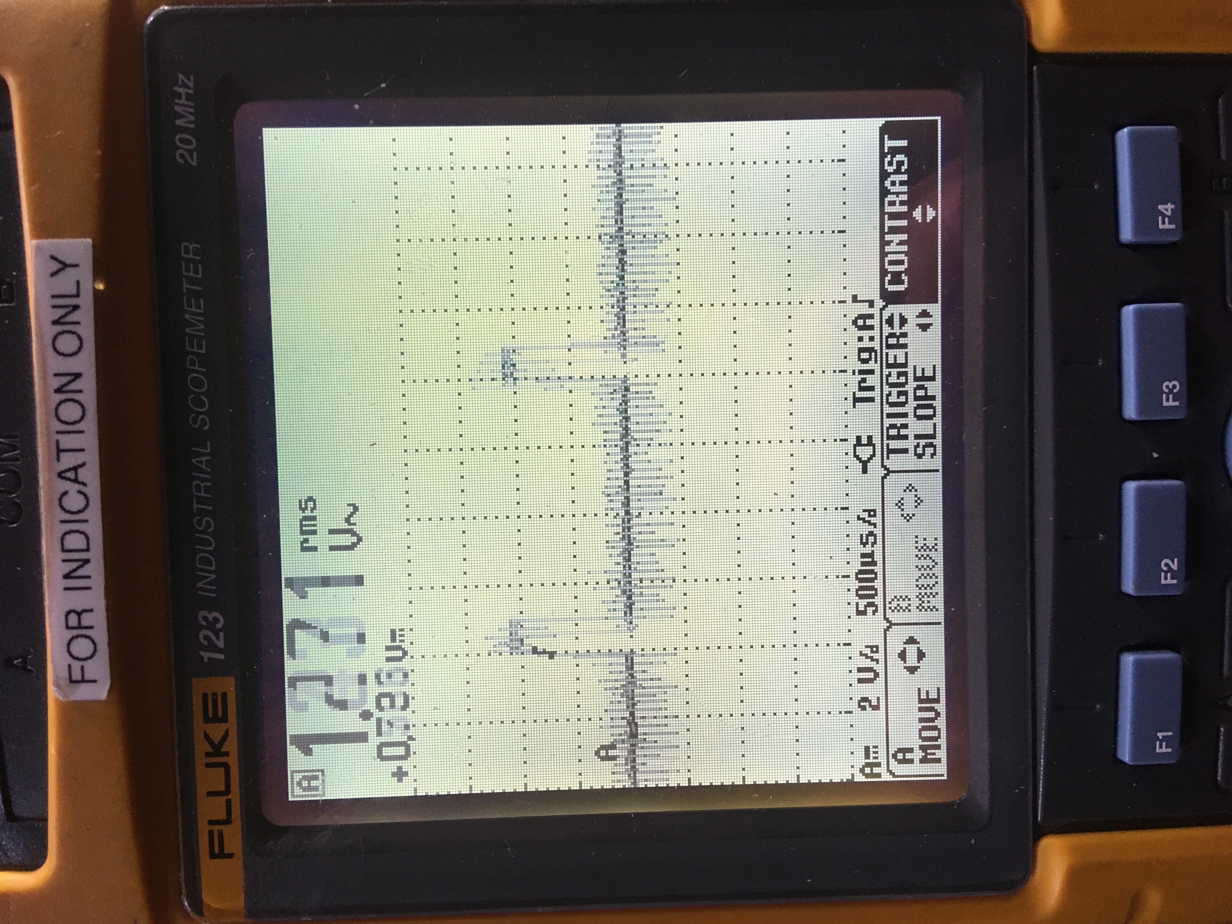

I don't understand what is going on, but I can see what seems to be a poor signal from the encoder? I did get smooth running in both manual unlimited frequency it seems, but only up to 1 or 2 Hz run mode via pedal for some reason, but then i keyed off and on and i couldnt even get manual mode to work properly, so possible something else is going on, or i changed something in my haste to try different parameter values?
I used my scope channel 1 - top line encoder signal to T1 base.
Channel 2 lower line T1 emitter signal.
Manually turning wheels in neutral:
Manual mode 0 to 20Hz:
Attempt playing with udcnom values 0 , 50V (actual bus voltage), 300V (motor plate) until it trips with 300V set:
Another attempt with different parameters set:
(Channel 1 disconnected)
Im thinking about changing R3 & R4 to 500 Ohm resistors, but I doubt very much that's any cause for the problem.
Thats great news Damien, think i will be looking for something similar.

Have you checked the encoder signal with a scope as it approaches the problem speed?
I found the ‘on’ time was getting smaller and smaller compared to the ‘off’ time as the speed increased. The on and off pulses are not equal. Not sure if that makes sense but here’s a photo:
The width of the ‘off’ pulse is correct, the ‘on’ pulse becomes almost non existent at the speed that I get stuck at. It seems that this is what is causing my issue but I’m not sure of the root cause. Wondering if the encoder is not up to the job but if you have the same problem that would be very interesting.
As you can see I also have a lot of noise. This is on the 5V supply and the 12V whenever the forward or reverse is selected. Doesn’t seem good but I’m not sure if it’s causing the problem. The noise is present at all speeds so seems to cope with it ok. I did try adding a low pass filter on the 5V supply but that didn’t fix the problem. I didn’t have a scope at that point to check if the noise had been reduced though.
I also tried a separate 5V supply as you did but it made no difference for me. In fact it made it worse - I got clunking from the motor at lower speeds that work fine with the 5V supply from the board.
