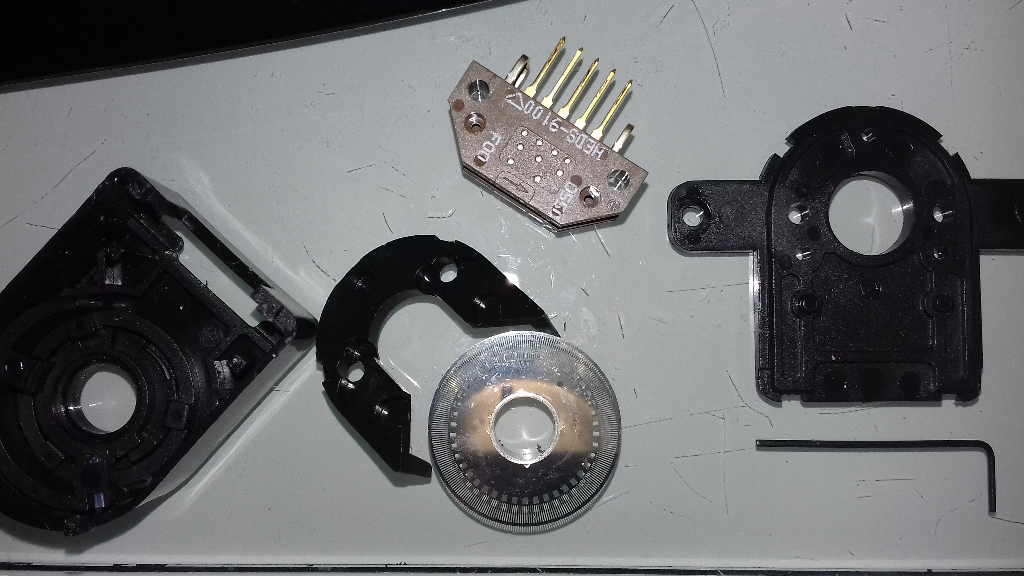

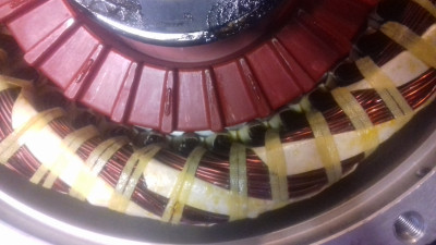

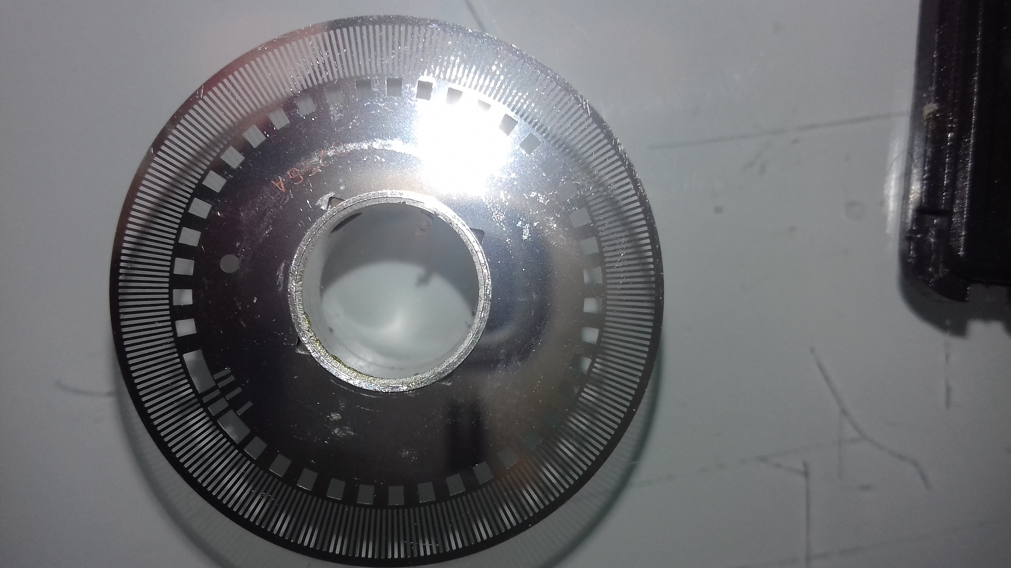

EVElvis
Posts: 31
Joined: Thu May 07, 2020 9:17 pm
Location: Leicestershire
Re: V1 Board Enova Encoder error
Post by EVElvis »

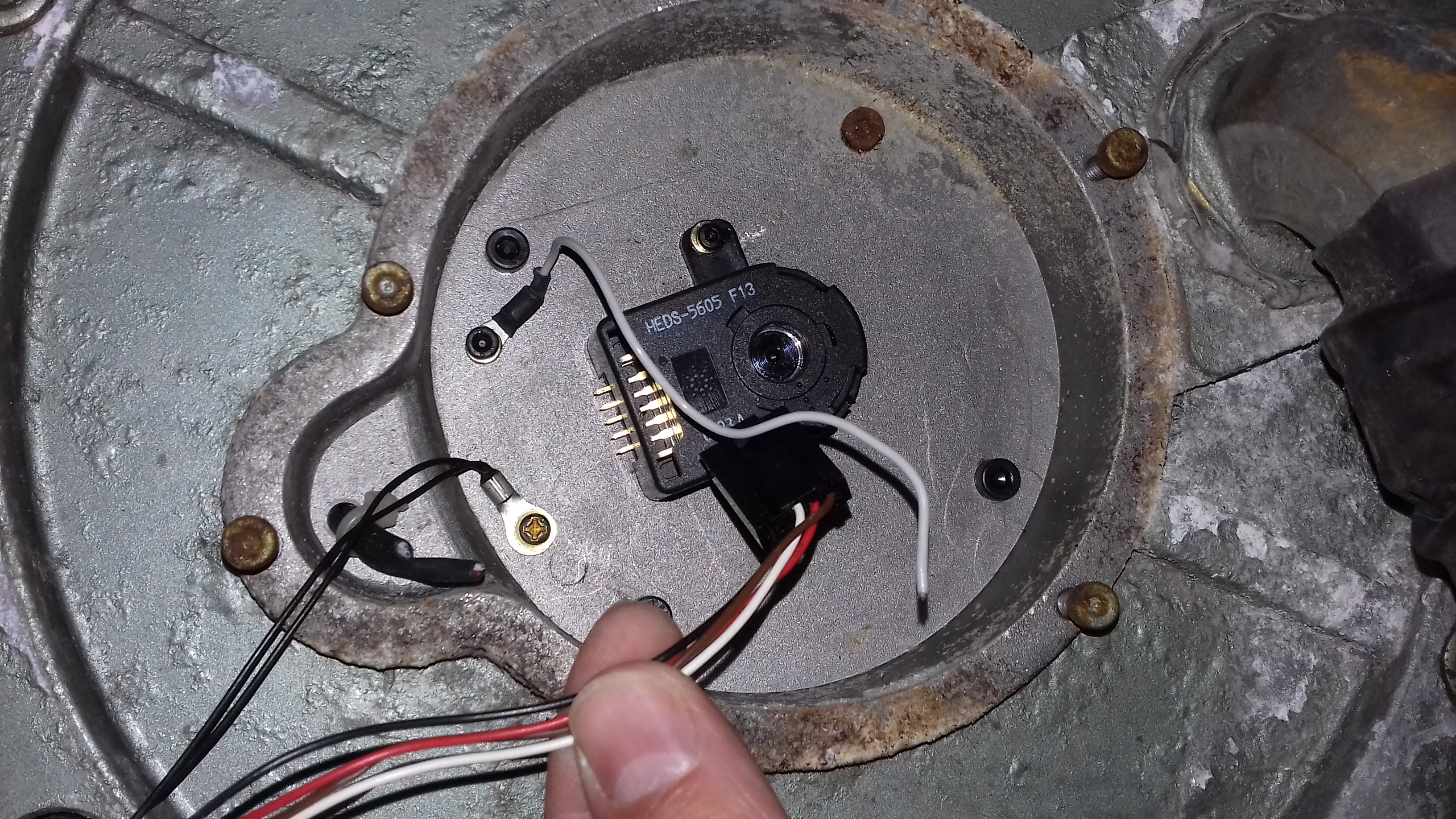

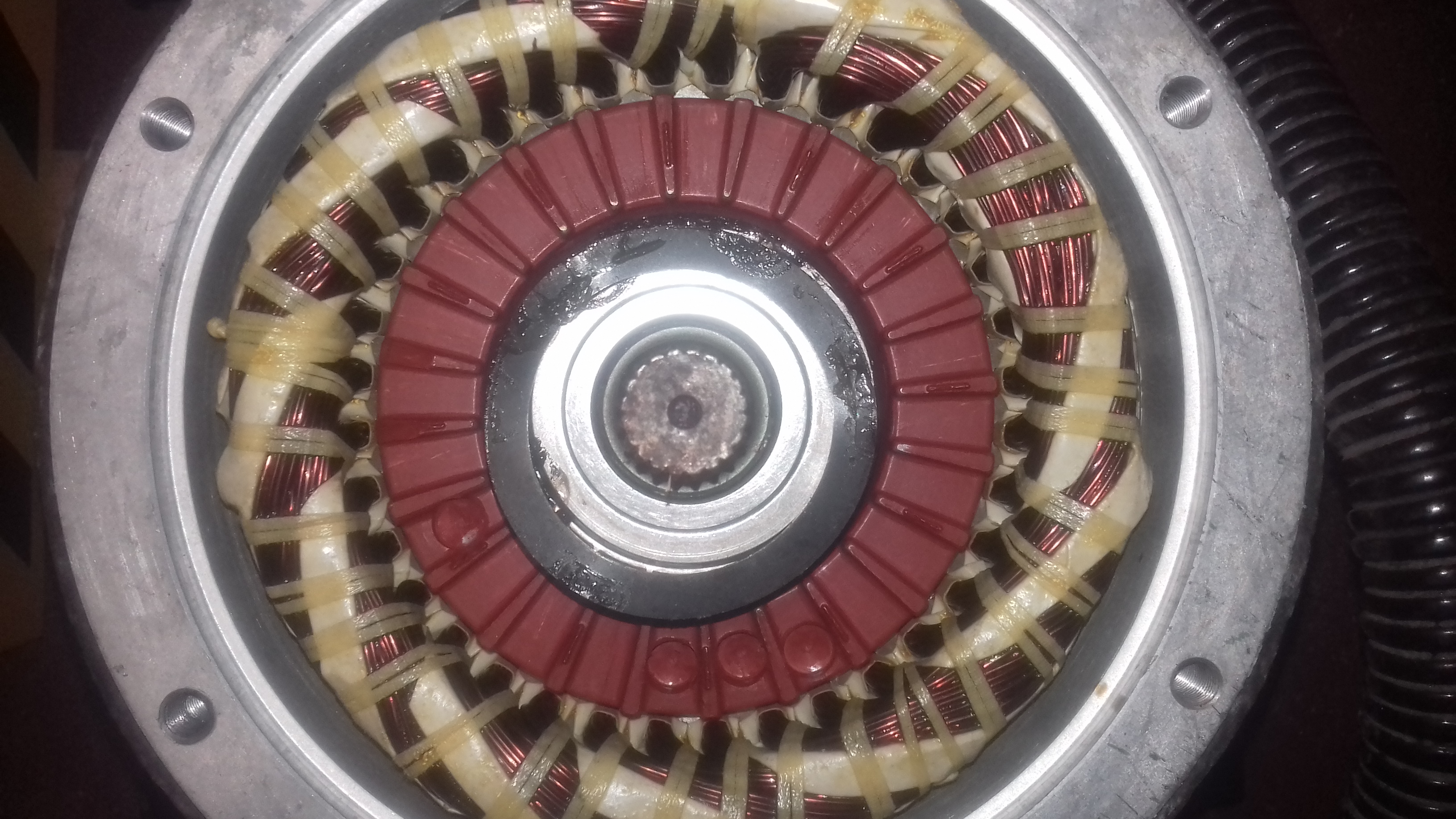

Took the Avago encoder off last night and could see it was indeed 256 pulses on the disc, all evenly spaced.
Perhaps 256 pulses and the slop in the drivetrain (im using original single reduction gearbox off the Edison van) will causes more erratic pulse signals? So i have just ordered one of these to try:
https://www.ebay.co.uk/itm/AVAGO-Optisc ... 1438.l2649
Luckily postage was cheaper than advertised :-)
Looks like I will have to adapt outer shell of old encoder to this one to mount it, but i hope 50 ppr will at least help highlight something? Enova clearly used two channels, which may have helped get it working for them?
Was interesting to see 4 unconnected wires into motor casing - they measured 320 kOhm accross them, so not sure what they are for?

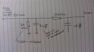

I now have my optical 50 ppr encoder and i didnt get much of a change with single encoder mode, but the reactions of the set up seem less violent. I get loads of strange noises (like the old internet dial up noise i think) from the inverter when it tries to run the motor which still barely turns, unless i go into manual mode, so im now less convinced it is the encoder itself, but i can get some nice sounding ev inverter whine (like i used to get 3 years ago with v2.97? SW?) but somewhat pulsed wheels turning with AB encoder mode, so i dont know why this is so different to single mode, apart from the obvious pulsing probably because theres only one signal input?
Im going to focus on the switching of T1 next as I have only seen it switch cleanly turning the wheels by hand, so when powered I hope to see it switch ok. All good learning :-)

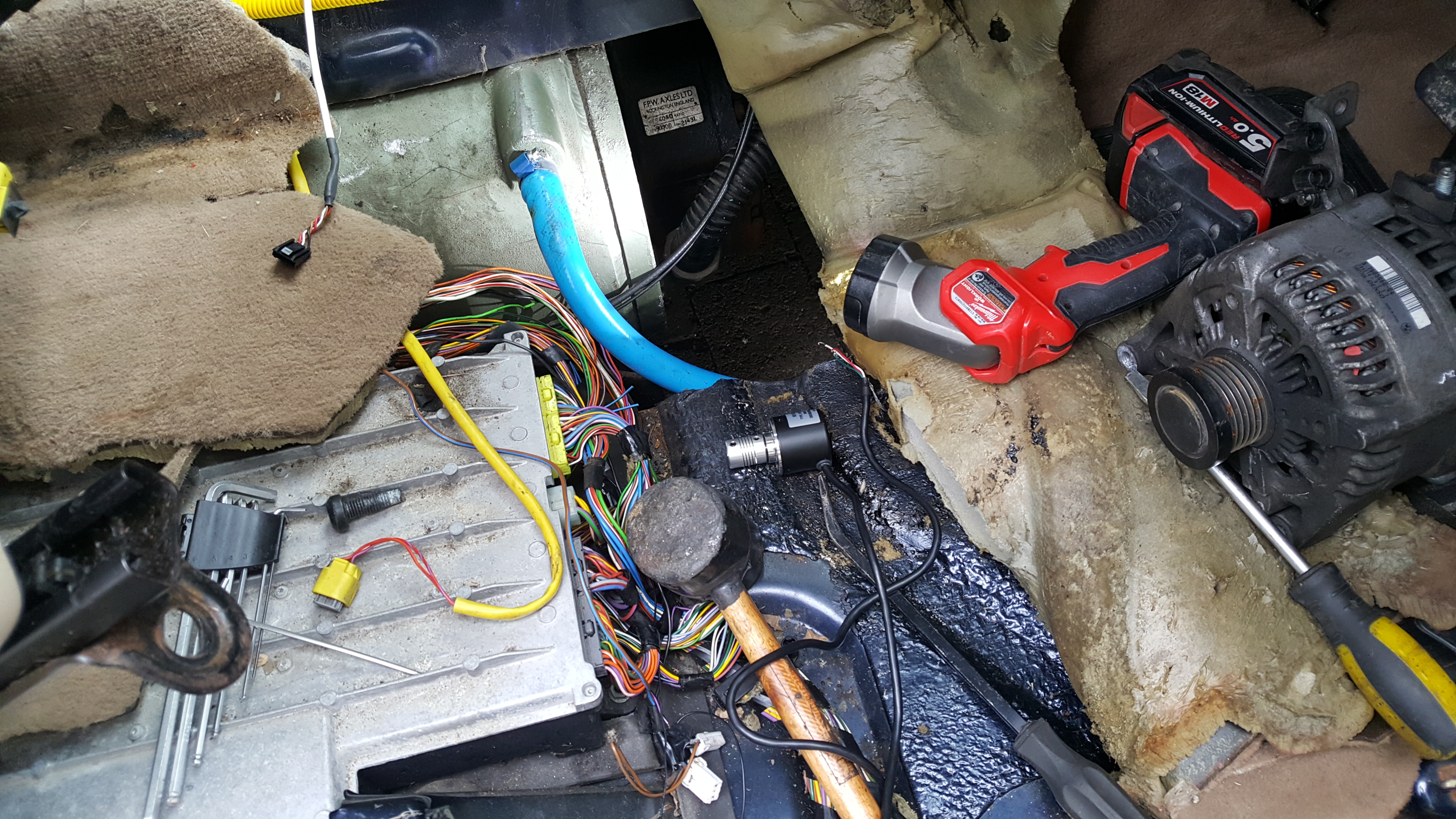

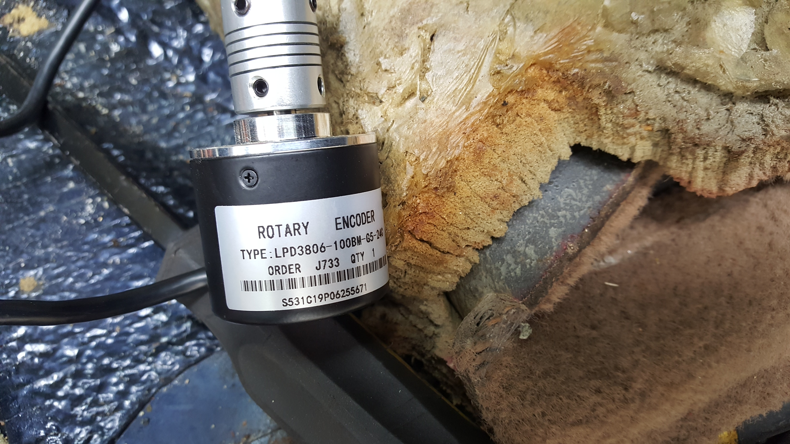

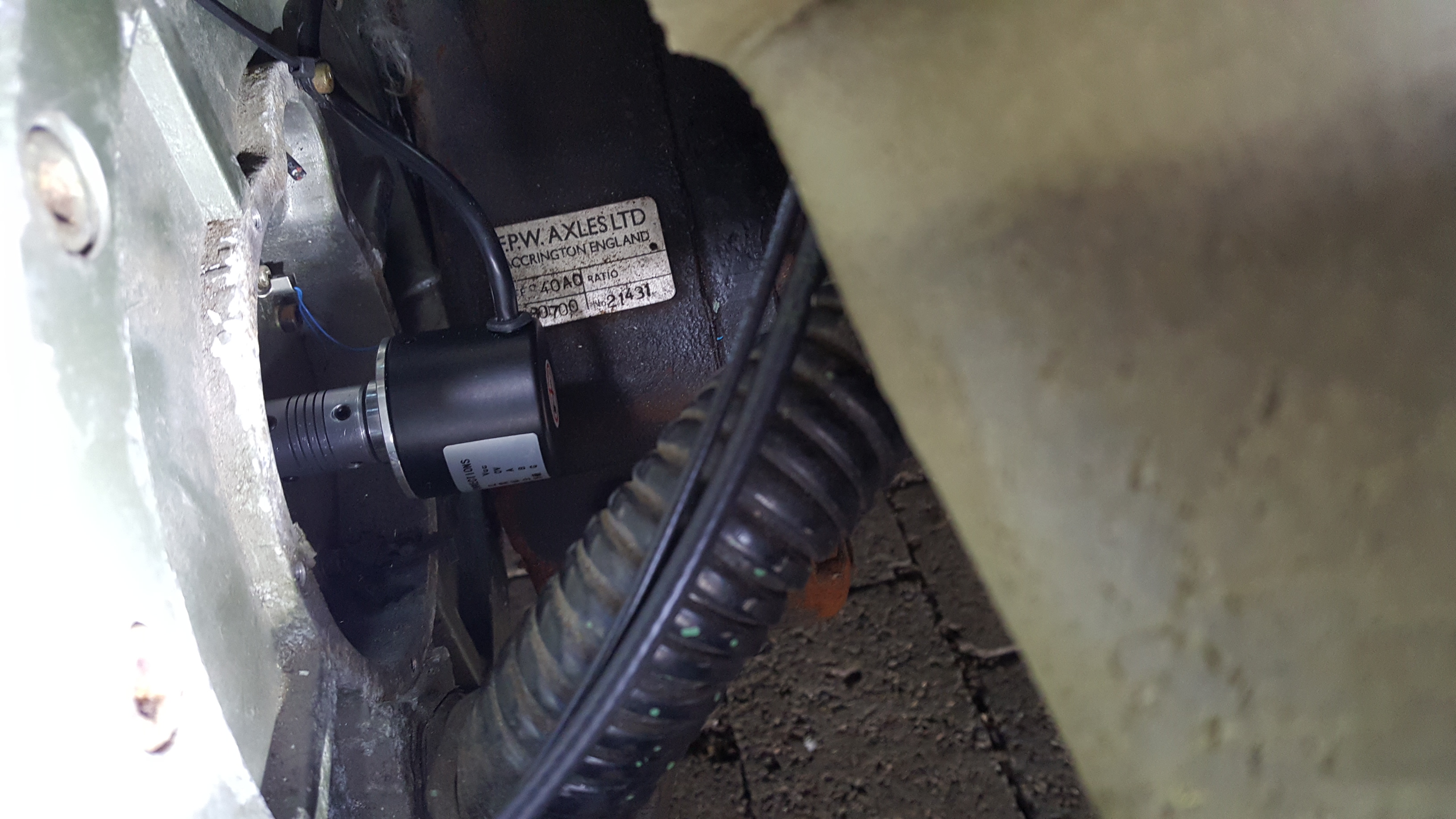

Posts: 4006
Been thanked: 1135 times
Ripped out the original encoder today on the rear drive motor on the range rover and replaces with this thing from ebay. Very big improvement. Not perfect, but much better. Never thought I'd be thanking the clown who cut out the floor...
Been thanked: 1918 times
Are these waterproof? I consider swapping the one in the Polo as it recently played up

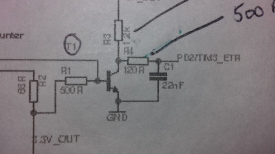

EVElvis
Posts: 31
Post by EVElvis »

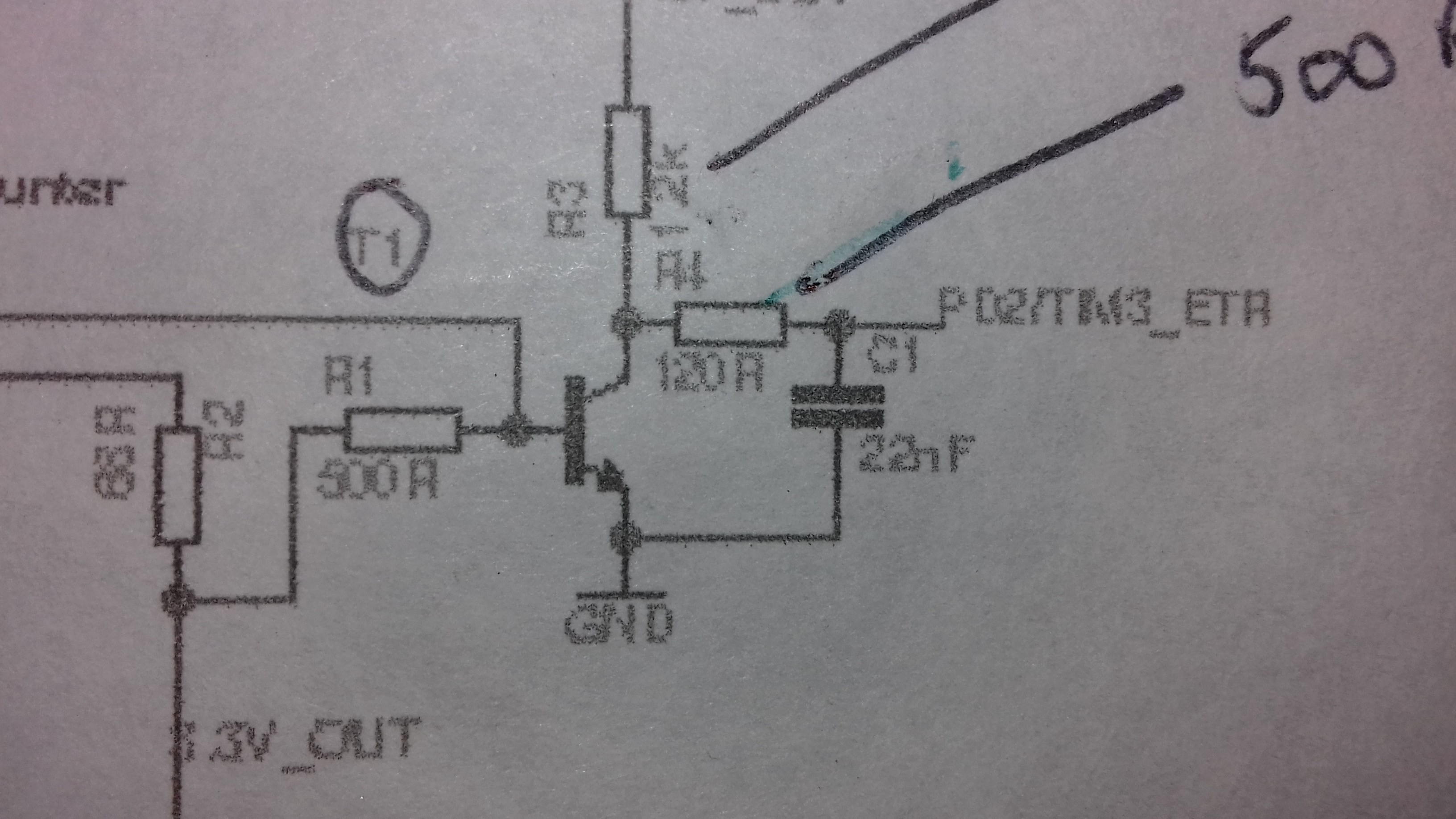

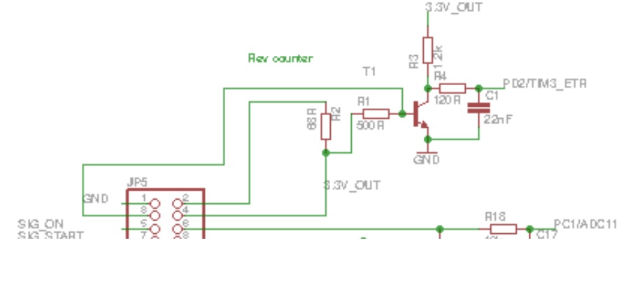

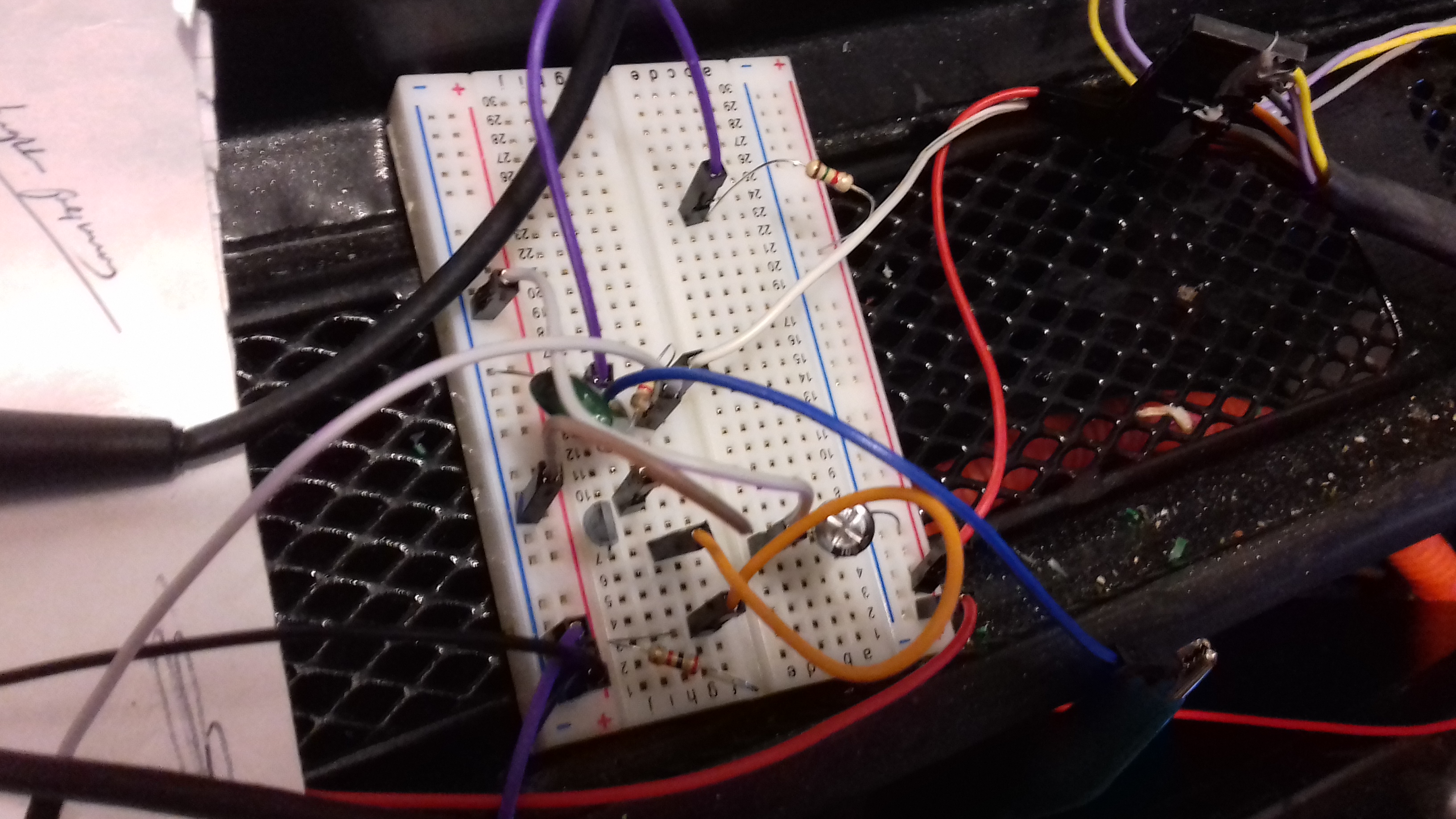

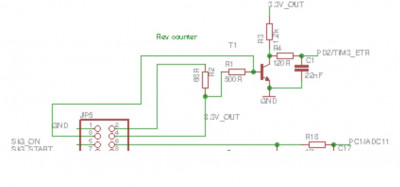

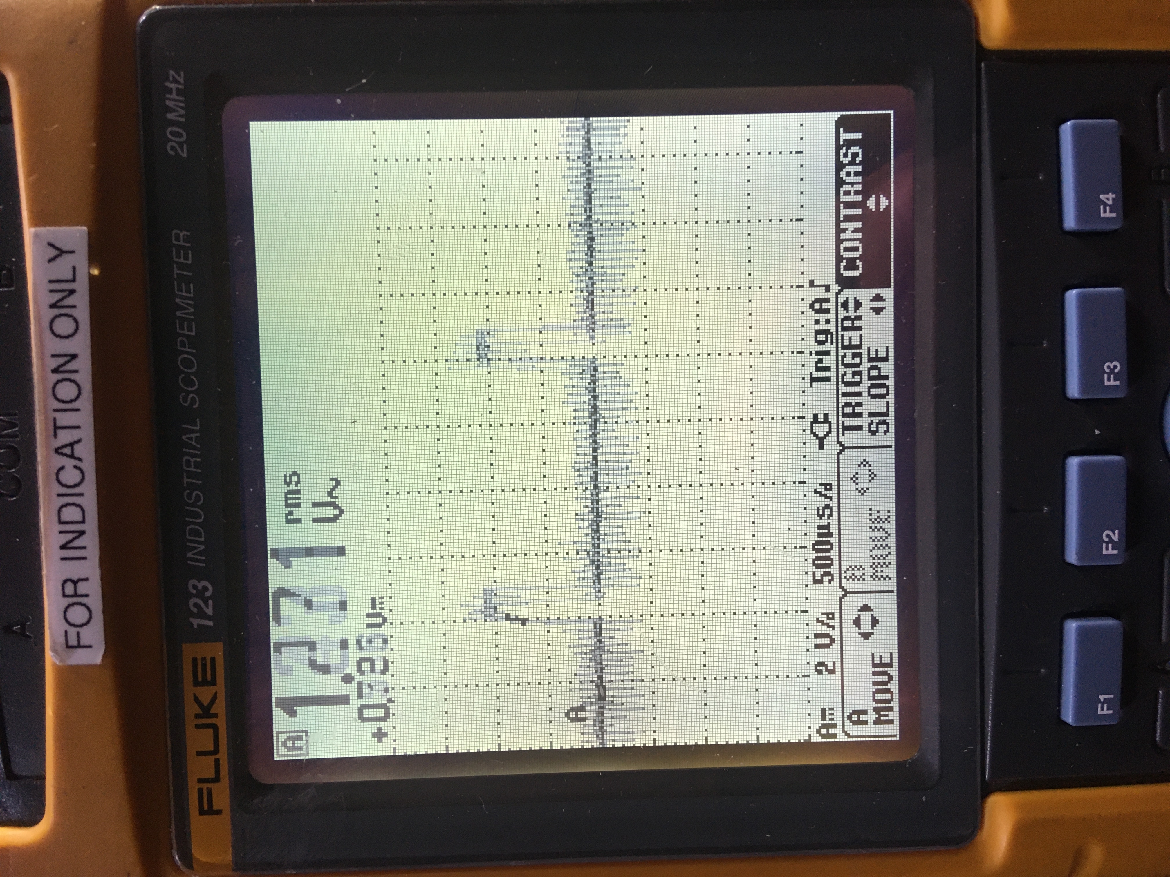

I don't understand what is going on, but I can see what seems to be a poor signal from the encoder? I did get smooth running in both manual unlimited frequency it seems, but only up to 1 or 2 Hz run mode via pedal for some reason, but then i keyed off and on and i couldnt even get manual mode to work properly, so possible something else is going on, or i changed something in my haste to try different parameter values?
I used my scope channel 1 - top line encoder signal to T1 base.
Channel 2 lower line T1 emitter signal.
Manually turning wheels in neutral:
Manual mode 0 to 20Hz:
Attempt playing with udcnom values 0 , 50V (actual bus voltage), 300V (motor plate) until it trips with 300V set:
Another attempt with different parameters set:
(Channel 1 disconnected)
Im thinking about changing R3 & R4 to 500 Ohm resistors, but I doubt very much that's any cause for the problem.
Thats great news Damien, think i will be looking for something similar.
cheers

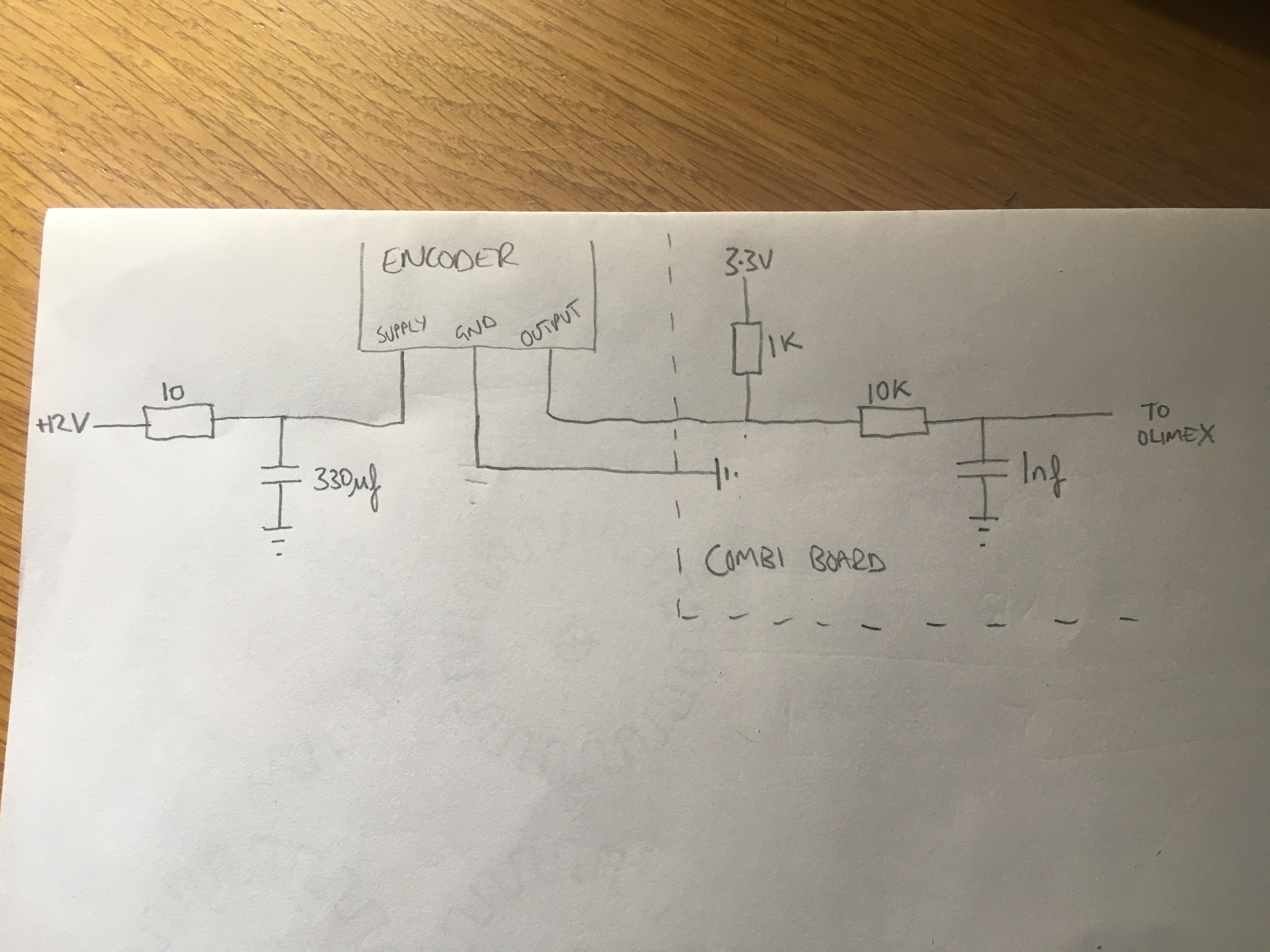

tom3141
Posts: 157
Joined: Sat Dec 22, 2018 2:29 pm
Location: North Yorkshire
Post by tom3141 »
When I was running mine at 30V I had boost at 6000, fslipmin at 1, fslipmax at 2.8. Try setting fmin much lower, I think I had it at 0.05.
Other than that your settings look very similar to what I used for running at 30V.
I’ve got some updates on my testing with the encoder that I’ll post later when I get a chance.

tom3141
Posts: 157
Post by tom3141 »
Have you checked the encoder signal with a scope as it approaches the problem speed?
I found the ‘on’ time was getting smaller and smaller compared to the ‘off’ time as the speed increased. The on and off pulses are not equal. Not sure if that makes sense but here’s a photo:
The width of the ‘off’ pulse is correct, the ‘on’ pulse becomes almost non existent at the speed that I get stuck at. It seems that this is what is causing my issue but I’m not sure of the root cause. Wondering if the encoder is not up to the job but if you have the same problem that would be very interesting.
As you can see I also have a lot of noise. This is on the 5V supply and the 12V whenever the forward or reverse is selected. Doesn’t seem good but I’m not sure if it’s causing the problem. The noise is present at all speeds so seems to cope with it ok. I did try adding a low pass filter on the 5V supply but that didn’t fix the problem. I didn’t have a scope at that point to check if the noise had been reduced though.
I also tried a separate 5V supply as you did but it made no difference for me. In fact it made it worse - I got clunking from the motor at lower speeds that work fine with the 5V supply from the board.
