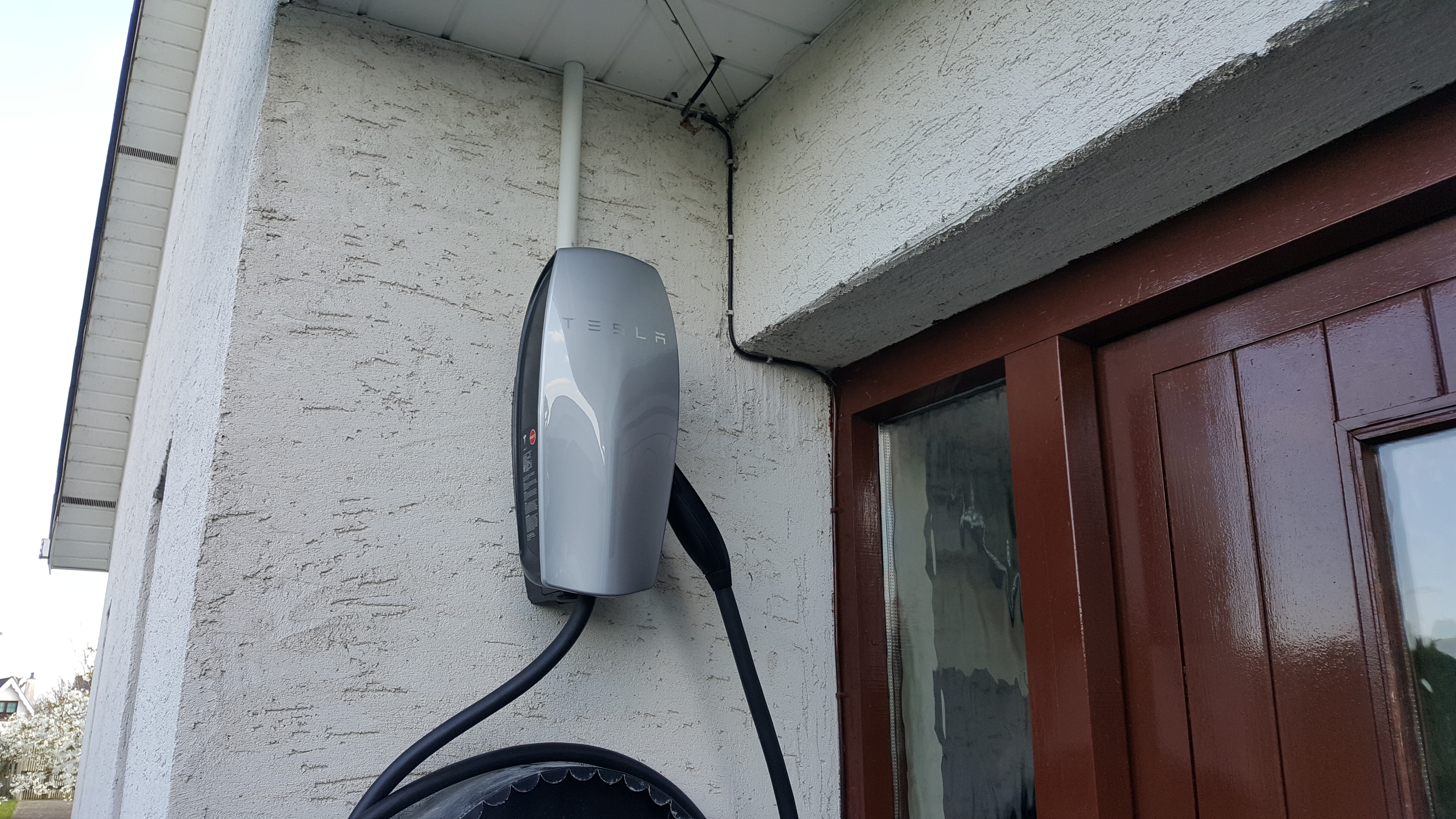

Jack Bauer wrote: Thu Apr 04, 2019 3:43 pm Just a little heads up on a new version of the Gen 2 and Gen 3 charger boards under development. They will feature the ability to switch the pilot signal between standard J1772 protocol and SWCAN. I was donated a Tesla wall connector that finally got installed last week. These can be set to "Tesla only" or legacy mode. A lot of destination chargers in hotels etc are "Tesla only" hence the SWCAN option.
What was the progress on this?
Did anyone work out how to switch from J1772 to SWCAN?
Once in SWCAN mode, it looks like the car sends a single byte message every 100mS to control charging:
 can0  30C   [1]  00
A payload of 00 disables charging. 01 enables it.
I also have decoded other messages where it sends the TWC serial number, model number, version. And where the car sends the VIN number, SoC etc.
However, what I haven't worked out yet is how to switch to SWCAN. Monitoring a Model 3, it appears comms start using J1772.
When the car is plugged in, the +ve voltage drops to 9V ('Vehicle detected'). After about 600mS the TWC starts generating the 1KHz PWM CP.
About 1.2 seconds later the +ve voltage drops to 6V ('Ready/charging').
Shortly after the comms switch to SWCAN (0 / 5V).
If I simulate the car myself (Diode, 2.74k // 1.3k) the TWC turns on, but stays in J1772 PWM mode.
The SWCAN circuits appears to have an input impedance of 3.5K, which in parallel with the above combination would put the +ve voltage at around 5V (or SWCAN levels). I tried switching this in, but no go.

From what I can understand, different firmware on the TWC behave in different ways. I'm running what I believe is the latest (for Gen 2) 4.5.3. In 4.5.3, the DIP switch doesn't appear to do anything. With an oscilloscope on the CP when a Tesla is connected, shows it talks in SWCAN mode regardless of what position the DIP switch is in.
I'll see if I can get a Oscilloscope trace and post it, but as per my post above:
If anyone has a TWC running a firmware version earlier than 4.5.3, I would be interested to hear how the SWCAN comms works in relation to the DIP switch.

Edison wrote: Wed Jun 03, 2020 8:57 am I'll see if I can get a Oscilloscope trace and post it, but as per my post above:
As promised, this is what a charging session between a Model 3 and TWC 4.5.3 looks like:
  • Charger idle @ 12V.
  • Plug Inserted @ approx 700mS. Signal pulled down to 9V by car's 2.74k resistor ('Vehicle detected').
  • Approx 1.3s. TWC starts generating 1KHz CP signal.
  • Approx 2.6s comms switch to SWCAN
  • First 1KHz pulses have positive peaks at 9V ('Vehicle detected')
  • Car then switches in 1.3K. Peaks drop to 6V ('Ready/charging')
  • 11 pulses later, switches to SWCAN
  • It appears line is released (not driven by TWC) shortly after 11th pulse.
  • SWCAN starts shortly after. Its not yet clear which device starts talking first.
What is also interesting, is the TWC was configured for 8A during this session. The 1KHz PWM signal was 50uS or 5% duty cycle (Approx 3A).
I wonder if this is why some third party vehicles refuse to charge.
More to come....

Edison wrote: Sat Jun 06, 2020 2:58 am What is also interesting, is the TWC was configured for 8A during this session. The 1KHz PWM signal was 50uS or 5% duty cycle (Approx 3A).
5% duty cycle indicates digital communications. Here's an extract from IEC61851-1{ed2.0}
Edison wrote: Sat Jun 06, 2020 2:58 am I wonder if this is why some third party vehicles refuse to charge.
It's possible that cars have bugs or that Tesla are doing something strange in the TWC. Certainly early Model S had issues when the EVSE commanded 6A.
