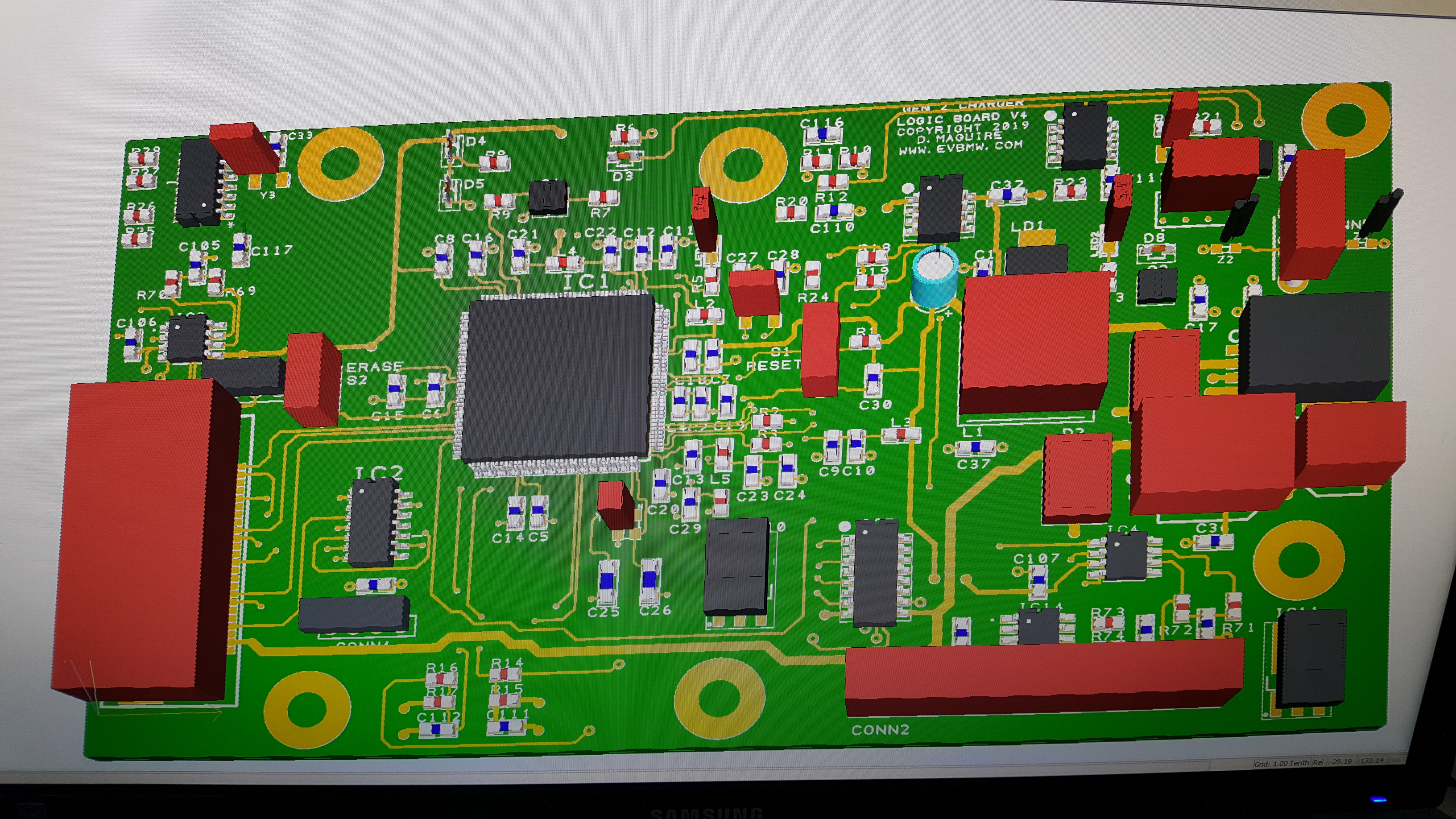

Design and pcb layout done. Schematic in PDF format up on Github :
https://github.com/damienmaguire/Tesla- ... ematic.pdf
Design files will be released as soon as I confirm pinouts on a few parts are correct. Particularly the USB socket:)
all comments / suggestions welcome.

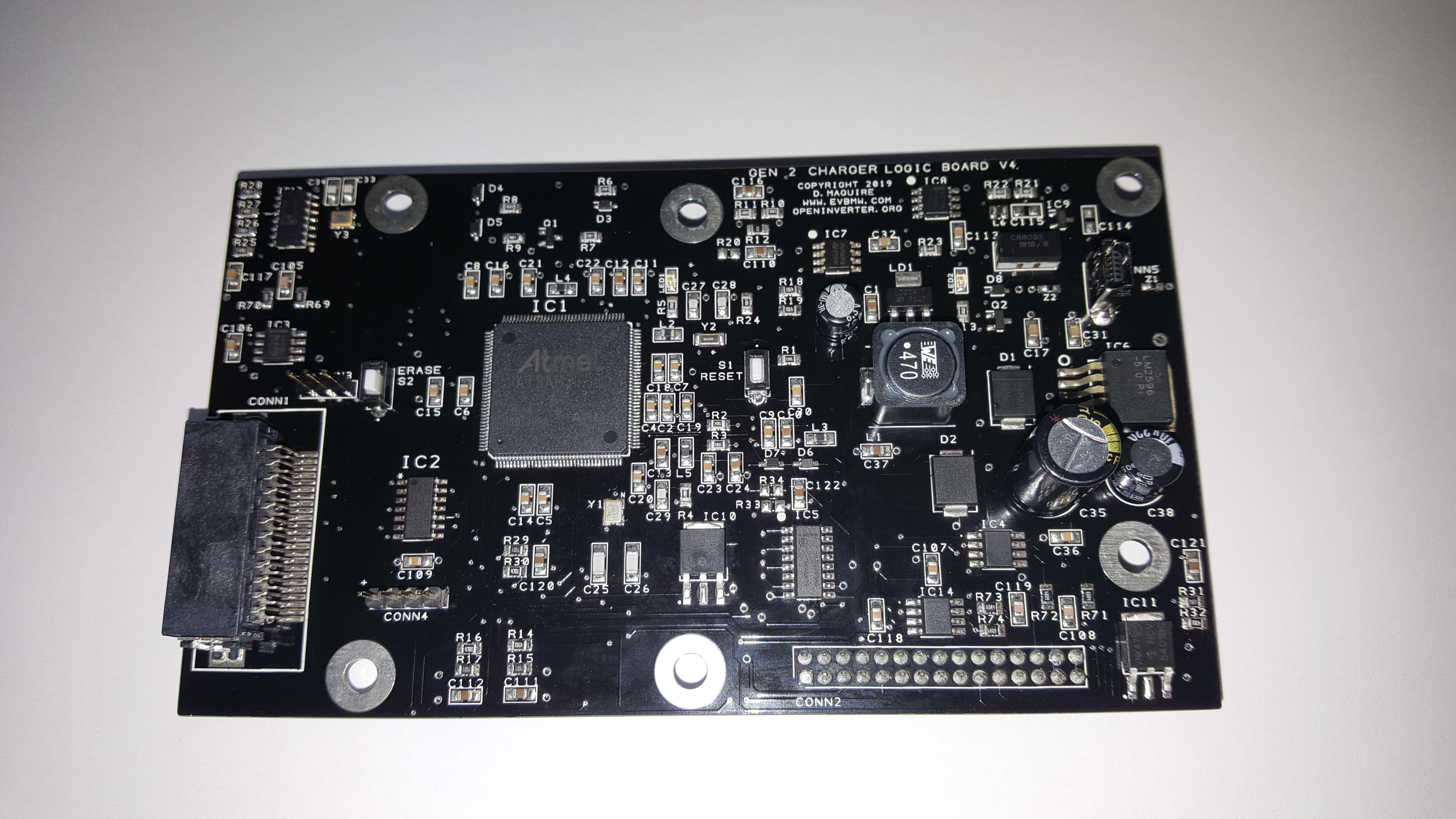

Re: New Tesla charger board
Naturally the library part for the USB connector had the pins assigned wrong. That would have been fun. PCBs ordered and design files released.
https://github.com/damienmaguire/Tesla- ... gicBoardV4

BOM now uploaded to Github for the V4 design.
The software is currently Tom's version with a few small mods I made for my own needs such as shutdown on reaching a setpoint voltage etc. Once I have some prototypes of the V4 then sw development can start. The V4 is designed for backwards compatability.

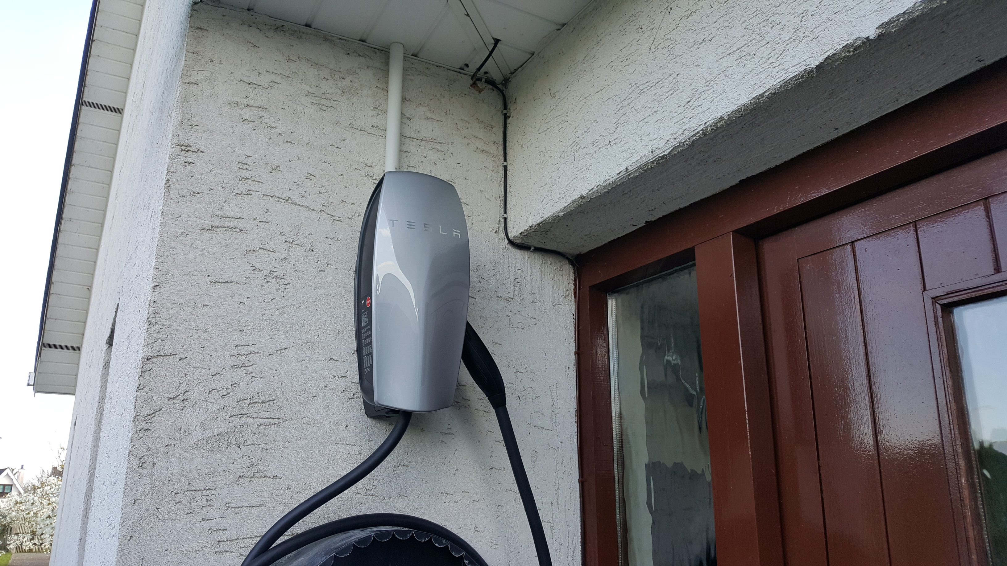

What was the progress on this?Jack Bauer wrote: ↑Thu Apr 04, 2019 3:43 pm Just a little heads up on a new version of the Gen 2 and Gen 3 charger boards under development. They will feature the ability to switch the pilot signal between standard J1772 protocol and SWCAN. I was donated a Tesla wall connector that finally got installed last week. These can be set to "Tesla only" or legacy mode. A lot of destination chargers in hotels etc are "Tesla only" hence the SWCAN option.
Did anyone work out how to switch from J1772 to SWCAN?
Once in SWCAN mode, it looks like the car sends a single byte message every 100mS to control charging:
can0 30C [1] 00
I also have decoded other messages where it sends the TWC serial number, model number, version. And where the car sends the VIN number, SoC etc.
However, what I haven't worked out yet is how to switch to SWCAN. Monitoring a Model 3, it appears comms start using J1772.
When the car is plugged in, the +ve voltage drops to 9V ('Vehicle detected'). After about 600mS the TWC starts generating the 1KHz PWM CP.
About 1.2 seconds later the +ve voltage drops to 6V ('Ready/charging').
Shortly after the comms switch to SWCAN (0 / 5V).
If I simulate the car myself (Diode, 2.74k // 1.3k) the TWC turns on, but stays in J1772 PWM mode.
The SWCAN circuits appears to have an input impedance of 3.5K, which in parallel with the above combination would put the +ve voltage at around 5V (or SWCAN levels). I tried switching this in, but no go.

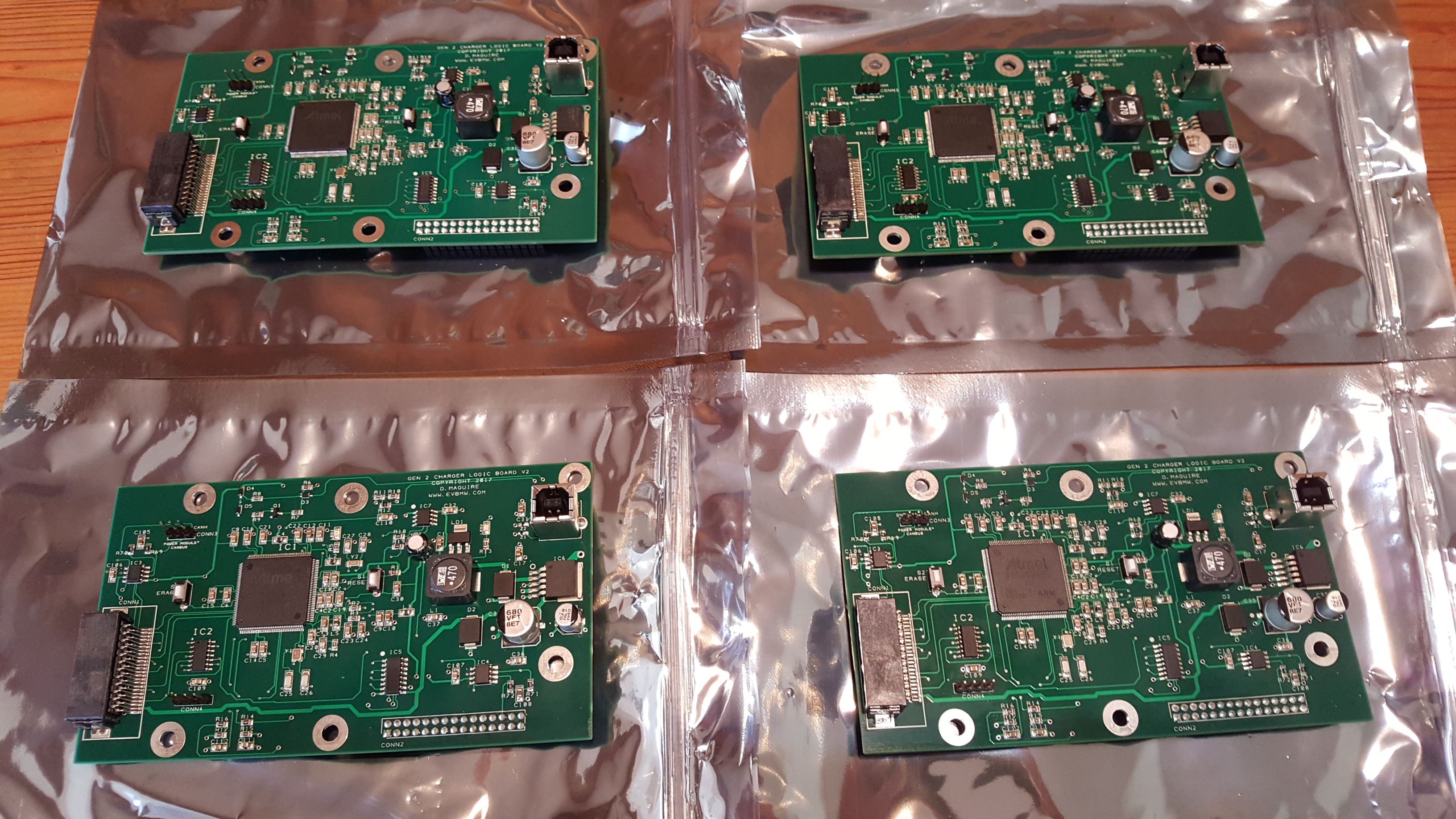

Progress was I reverse engineered the Tesla board cp input, implemented this on a board. Made the board open source :
Sold them for a while. Even offered free to anyone willing to do some software and of course no takers. So that board is no longer in production but you are welcome to get some made using the resources on github. Appreciate the share.

iirc one of the DIP switches inside the TWC selects between J1772 and SWCAN mode at power up. What are your switch settings?
Edit: here's a reference to the second DIP switch setting. Also note comments re timing;
https://teslamotorsclub.com/tmc/threads ... st-3698196

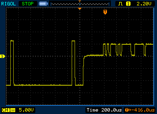

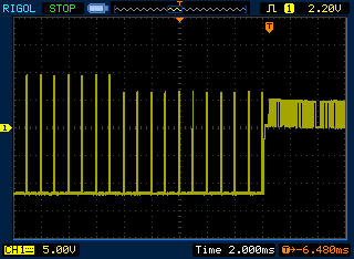

As promised, this is what a charging session between a Model 3 and TWC 4.5.3 looks like:
- Charger idle @ 12V.
- Plug Inserted @ approx 700mS. Signal pulled down to 9V by car's 2.74k resistor ('Vehicle detected').
- Approx 1.3s. TWC starts generating 1KHz CP signal.
- Approx 2.6s comms switch to SWCAN
- First 1KHz pulses have positive peaks at 9V ('Vehicle detected')
- Car then switches in 1.3K. Peaks drop to 6V ('Ready/charging')
- 11 pulses later, switches to SWCAN
- It appears line is released (not driven by TWC) shortly after 11th pulse.
- SWCAN starts shortly after. Its not yet clear which device starts talking first.
I wonder if this is why some third party vehicles refuse to charge.
More to come....

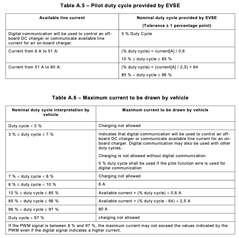

5% duty cycle indicates digital communications. Here's an extract from IEC61851-1{ed2.0}
It's possible that cars have bugs or that Tesla are doing something strange in the TWC. Certainly early Model S had issues when the EVSE commanded 6A.

Thanks.Kevin Sharpe wrote: ↑Sat Jun 06, 2020 6:02 am 5% duty cycle indicates digital communications. Here's an extract from IEC61851-1{ed2.0}
What does IEC61851 define as digital comms? I believe it is ISO 15118-3 HomePlug Green PHY for talking to DC fast chargers.
