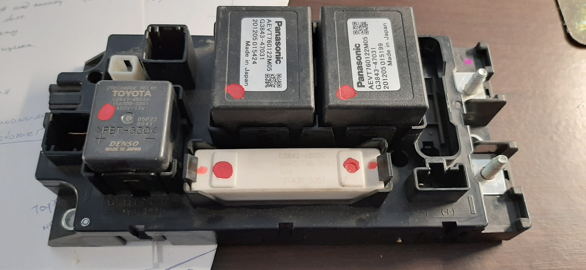

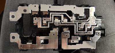

Are this contactor assemblys from Toyota HV battery of any good use?
Two contactors at both positive and negative lines, precharge relay with resistor and as far as I can say - with built in current sensor.
Why I'm asking? There is a guy, who sell toyota HV cells, and those assemblys are "leftovers no one needs" :) and he sell them for ~30 euro, and as he says, he have got "many of those".
I've bought one and tested - it works.

konstantin8818 wrote: Fri May 22, 2020 5:59 am I've bought one and tested - it works.
How long did you run the contactors for? You need to run them for an hour or so at ~14V and measure the temperature rise to ensure they will work long term.
Great find even if they need external economizers :D

Kevin Sharpe wrote: Fri May 22, 2020 9:15 am How long did you run the contactors for? You need to run them for an hour or so at ~14V and measure the temperature rise to ensure they will work long term.
Will do. Just need to wait until summer refreshes in it's memory it is time to show up :? My garage is opened to every winds. I've just detached economizers from kilovac contactors, because they were jumping like crazy. So I need to attache them back?

konstantin8818 wrote: Fri May 22, 2020 5:37 pm So I need to attache them back?
If you run a contactor that requires an economizer without one then you'll burn out the coil.

You can also just send a PWM signal to them (this is essentially what the economiser does). Start at 100% and then drop it to whatever keeps it closed.
I use this code to achieve this:
#define CONT_MAXPWM 2550 //start pwm value
#define CONT_MINPWM 1280 //end pwm value
#define CONT_PWMRATE 1 //rate of change
//setup
int c_pos_pwm = CONT_MAXPWM;
//contactor function, called from loop
    if (contactor[C_POS])
      if (c_pos_pwm > CONT_MINPWM) c_pos_pwm -= CONT_PWMRATE;
      analogWrite(CONT_POS, (int)c_pos_pwm / 10);
    else
      analogWrite(CONT_POS, 0);
    //same again for negative contactor, etc
Of course you need a suitable circuit to drive the coil. Best to keep the economiser. I run Kilovac contactors (with economiser), with a 10A relay to trigger them. The code above is used as an economiser for the 10A relay.

xp677 wrote: Fri May 22, 2020 9:04 pm You can also just send a PWM signal to them (this is essentially what the economiser does). Start at 100% and then drop it to whatever keeps it closed.
I'm barely understand this programming thing. Also contactor in this board activates true BTS117. Are they capable of handling PWM signal? Won't they overheat? I'll better solder those economisers back.
Most contactors require economizer functionality to minimise power consumption in the coil. This can be built into the contactor, an external circuit, or via software/hardware in the controller.
AFAIK none of the Open Inverter boards support software/hardware economizer functionality directly (they're just simple switched outputs) and therefore you need to implement this yourself with an external board or use a contactor that has the functionality built in.
