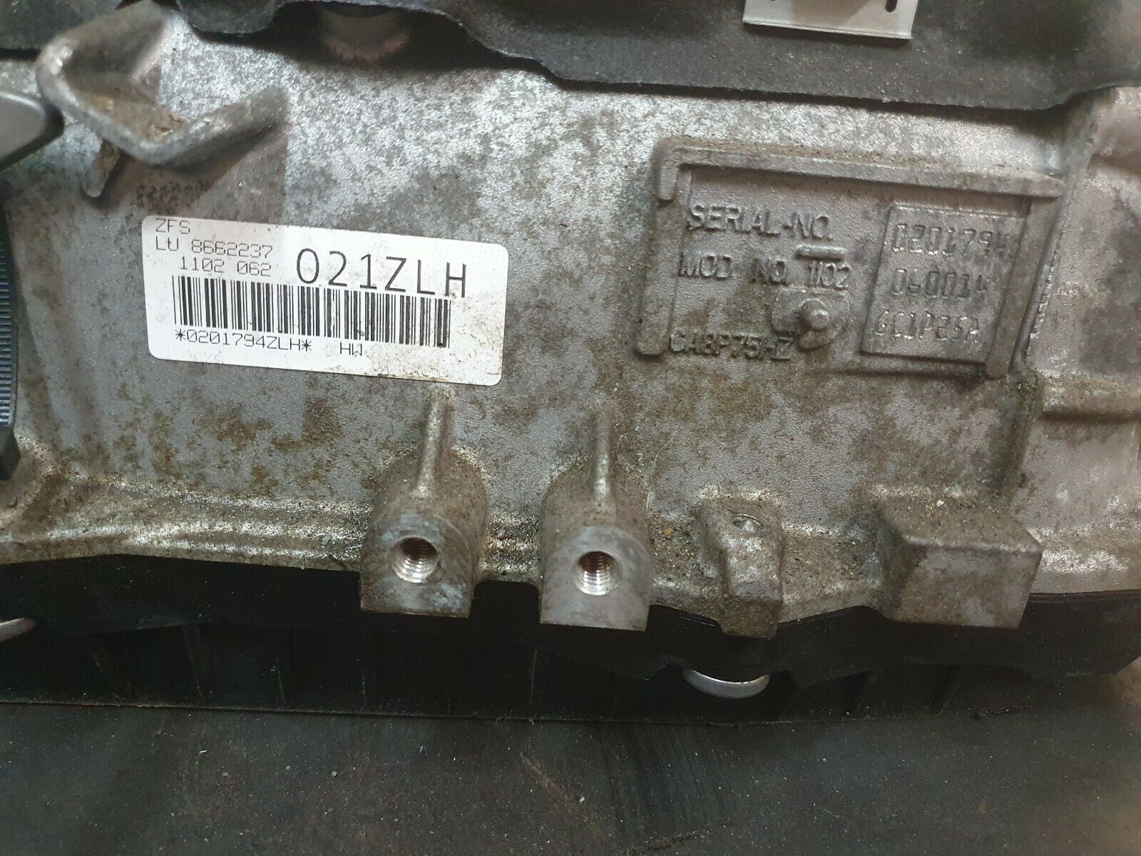

Just arrived. Now the connector hunt begins....again

Nice Purchase. The 3 phase plug to connect to the gearbox is hard to find and the cables are expensive. I purchased the cable from a scrap yard in Germany but it was still expensive. I am sure you will find a better soloution?

Picked up a HV cable, loom and shifter from a local scrap yard for 150 Euros. Considering what some are charging for a tarted up forklift motor and controller then that doesn't seem too bad to me.

Does it look like a typical BMW inline 6 block would bolt right up or adapter needed?
Posts: 4000
Been thanked: 1116 times
Re: BMW ZF GA8P75HZ Gearbox Hacking
Close but no cigar ...
