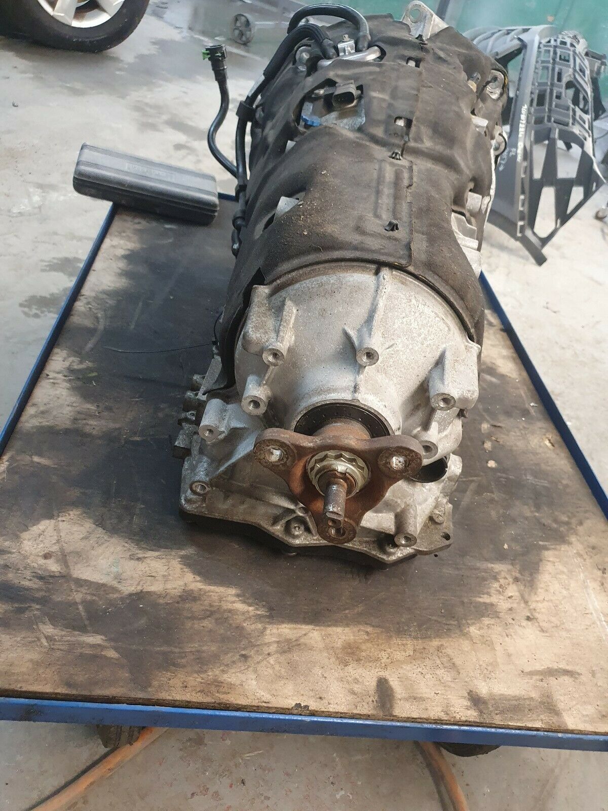

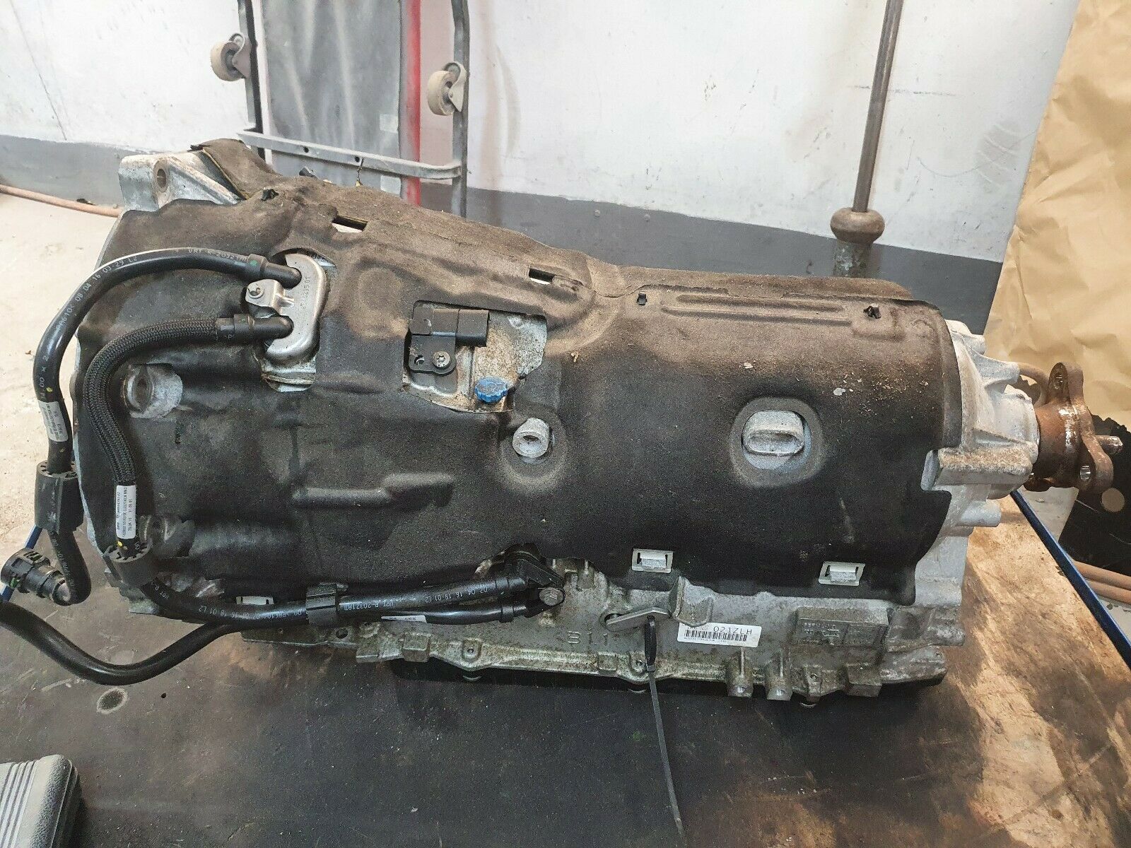

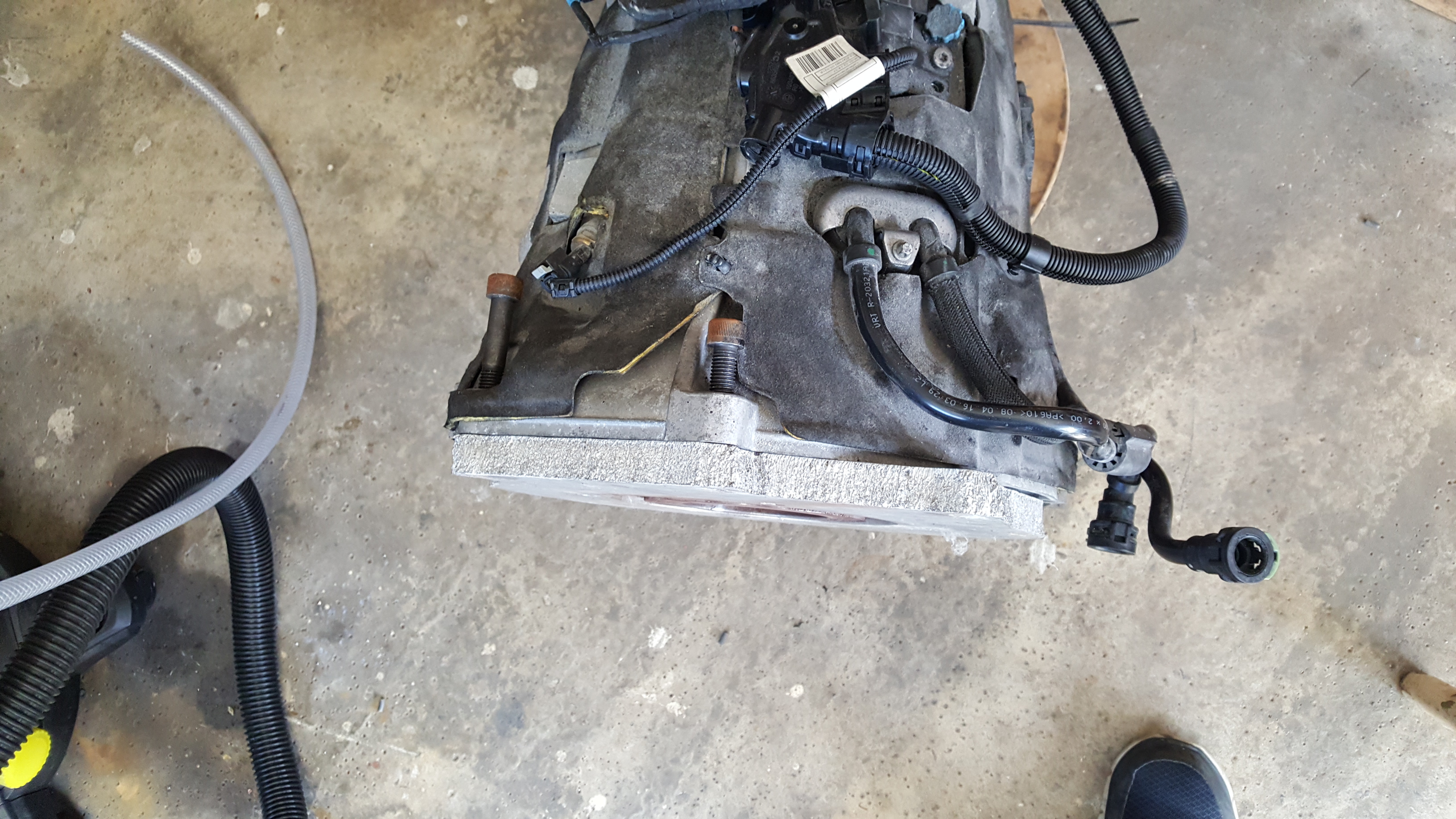

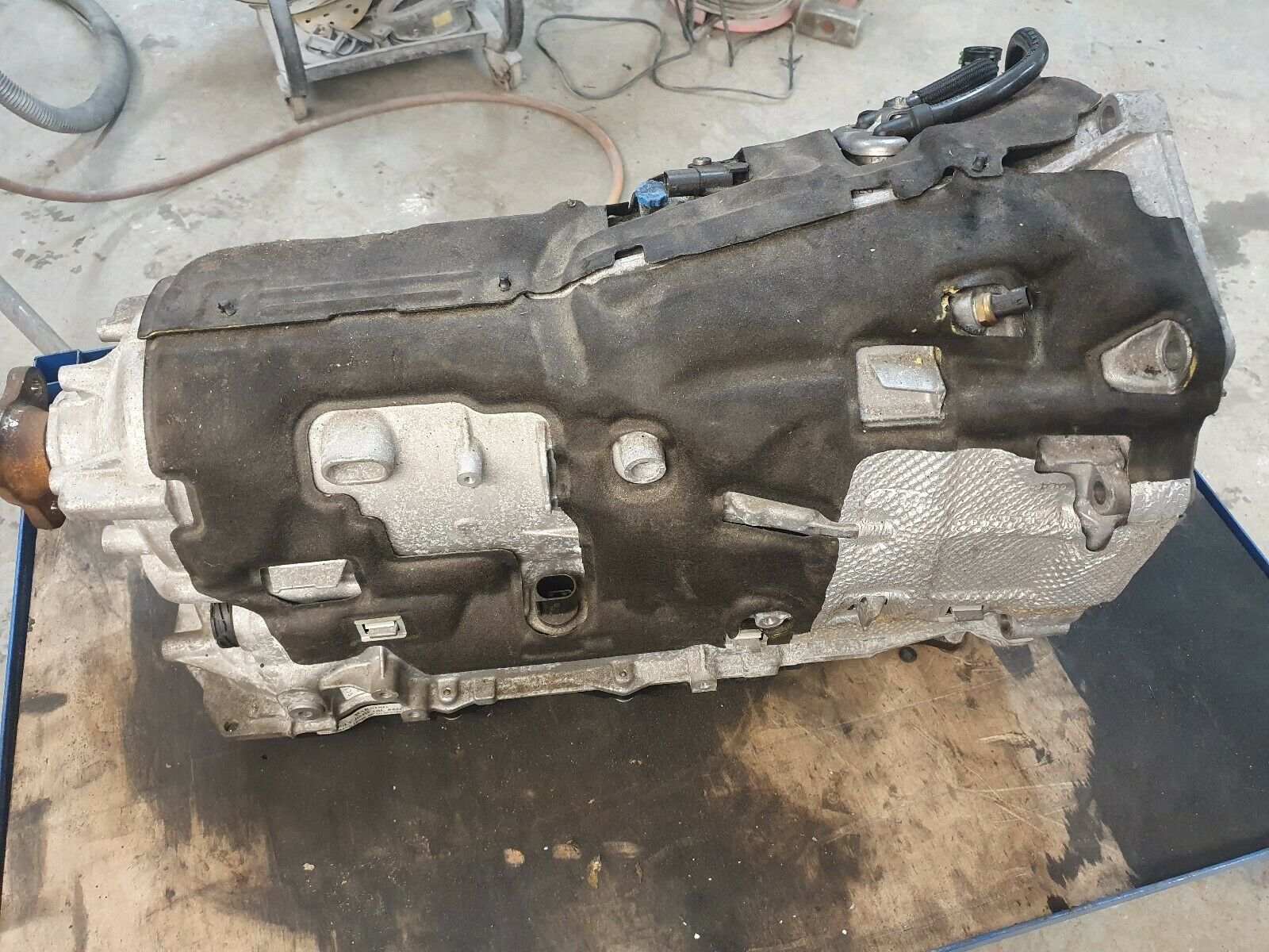

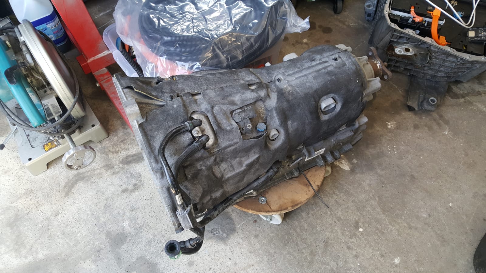

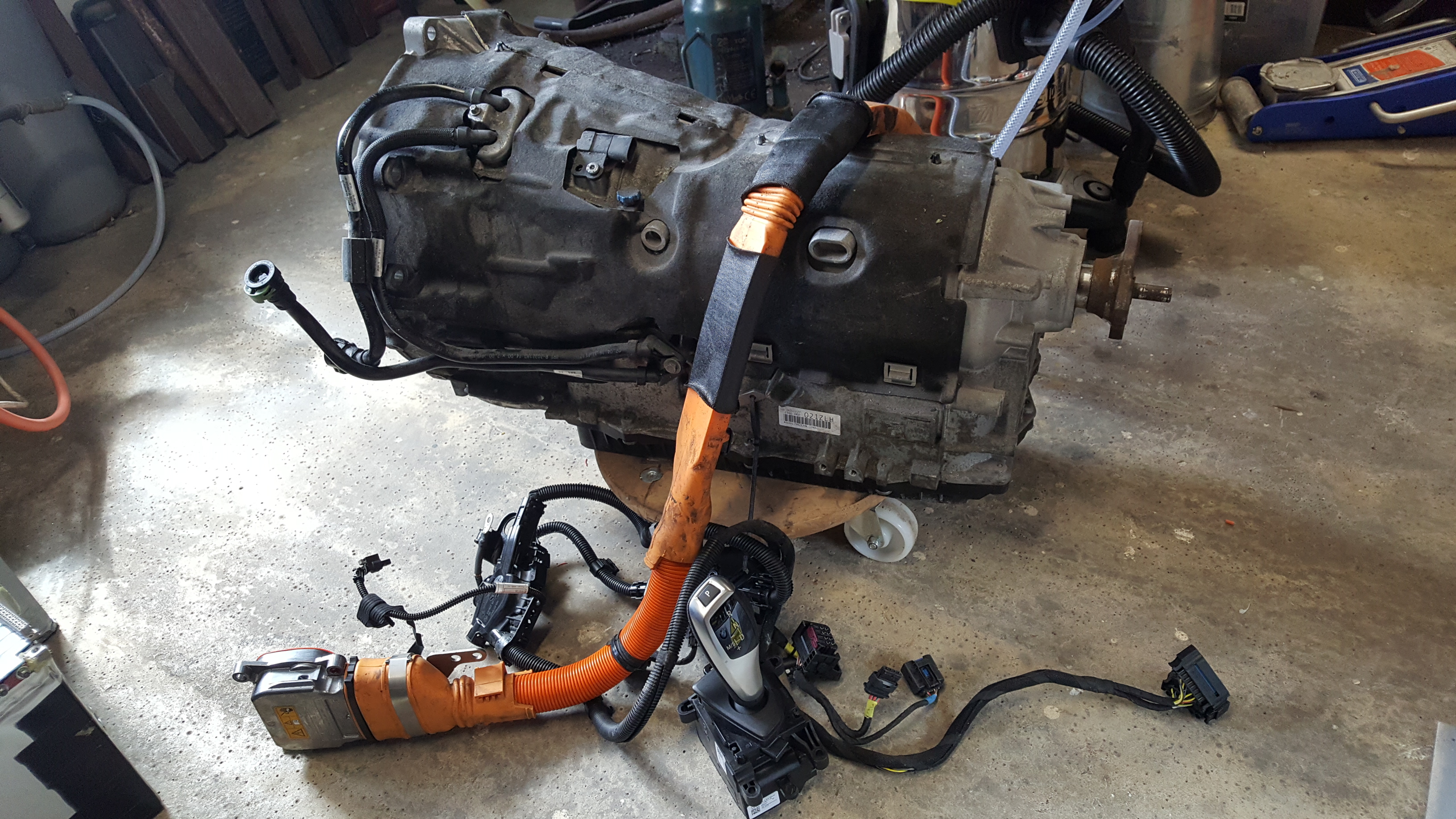

Re: BMW ZF GA8P75HZ Gearbox Hacking
Just arrived. Now the connector hunt begins....again
Nice Purchase. The 3 phase plug to connect to the gearbox is hard to find and the cables are expensive. I purchased the cable from a scrap yard in Germany but it was still expensive. I am sure you will find a better soloution?
Picked up a HV cable, loom and shifter from a local scrap yard for 150 Euros. Considering what some are charging for a tarted up forklift motor and controller then that doesn't seem too bad to me.
Yes I saw you had the cable in your video that you posted shortly after my comment. You are good at getting good prices.

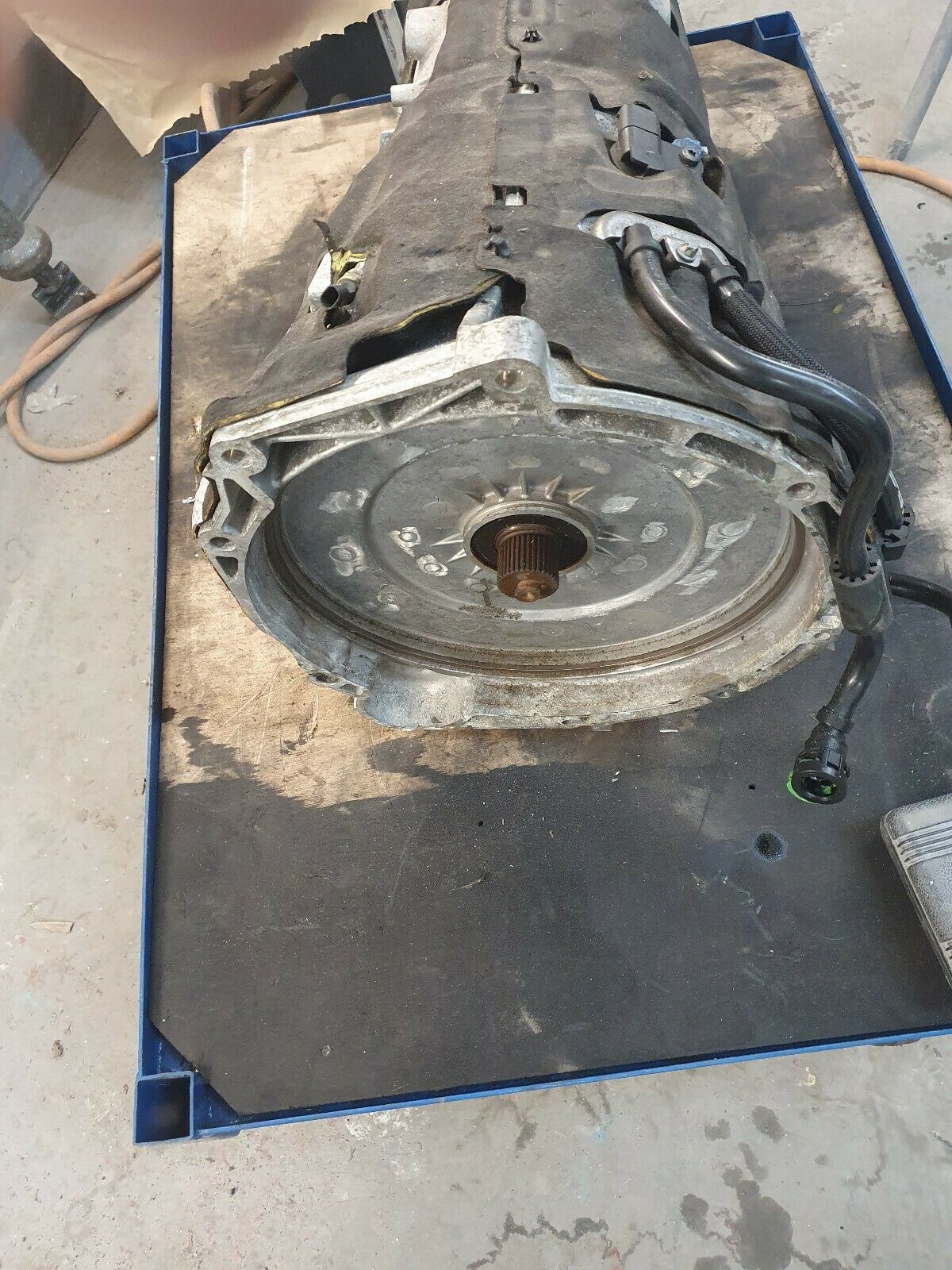

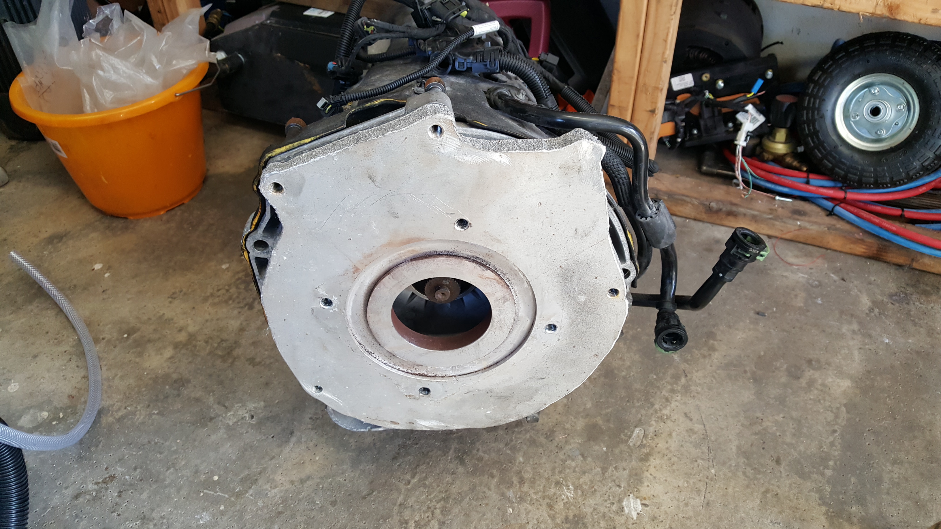

Does it look like a typical BMW inline 6 block would bolt right up or adapter needed?
