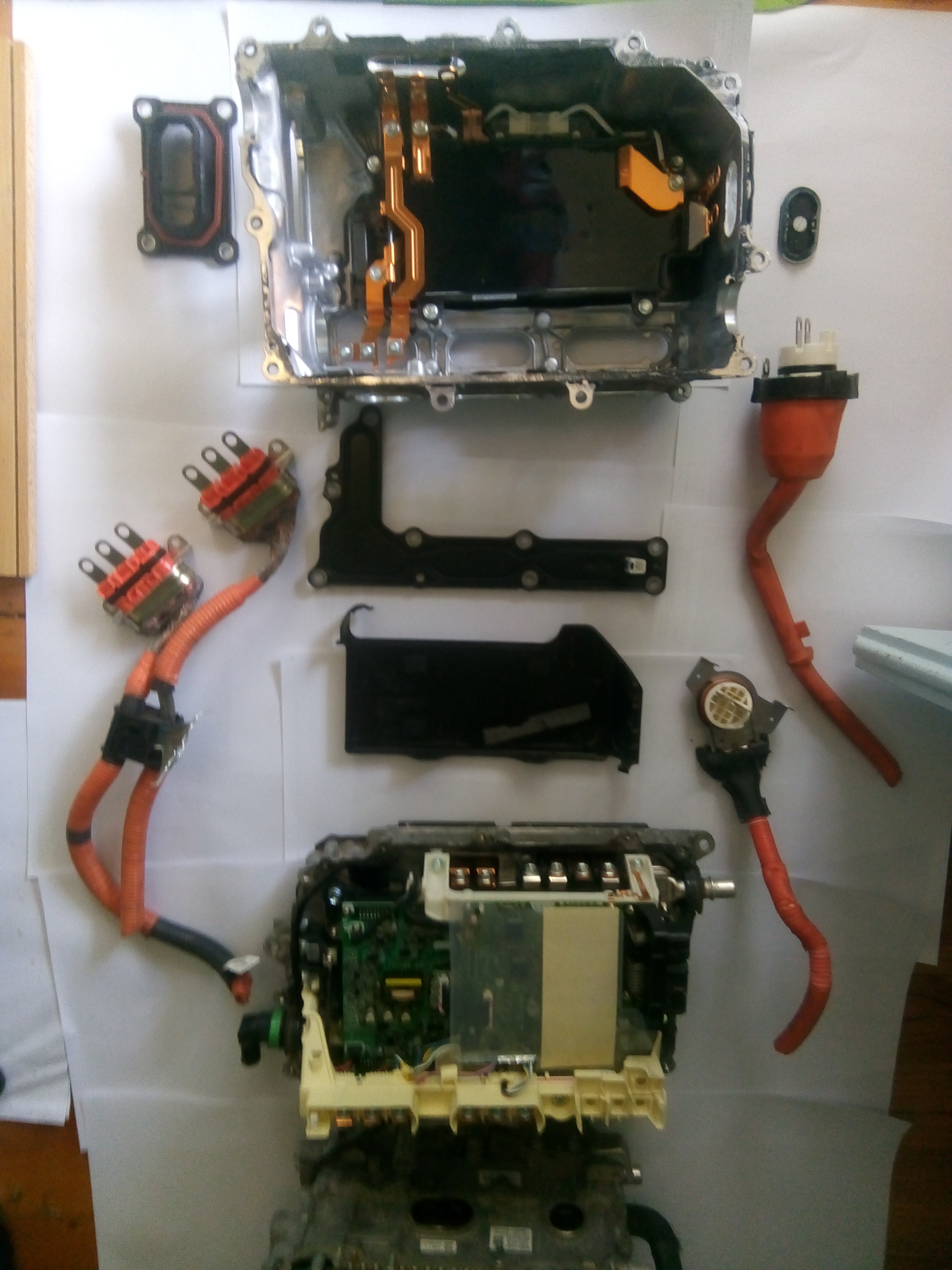

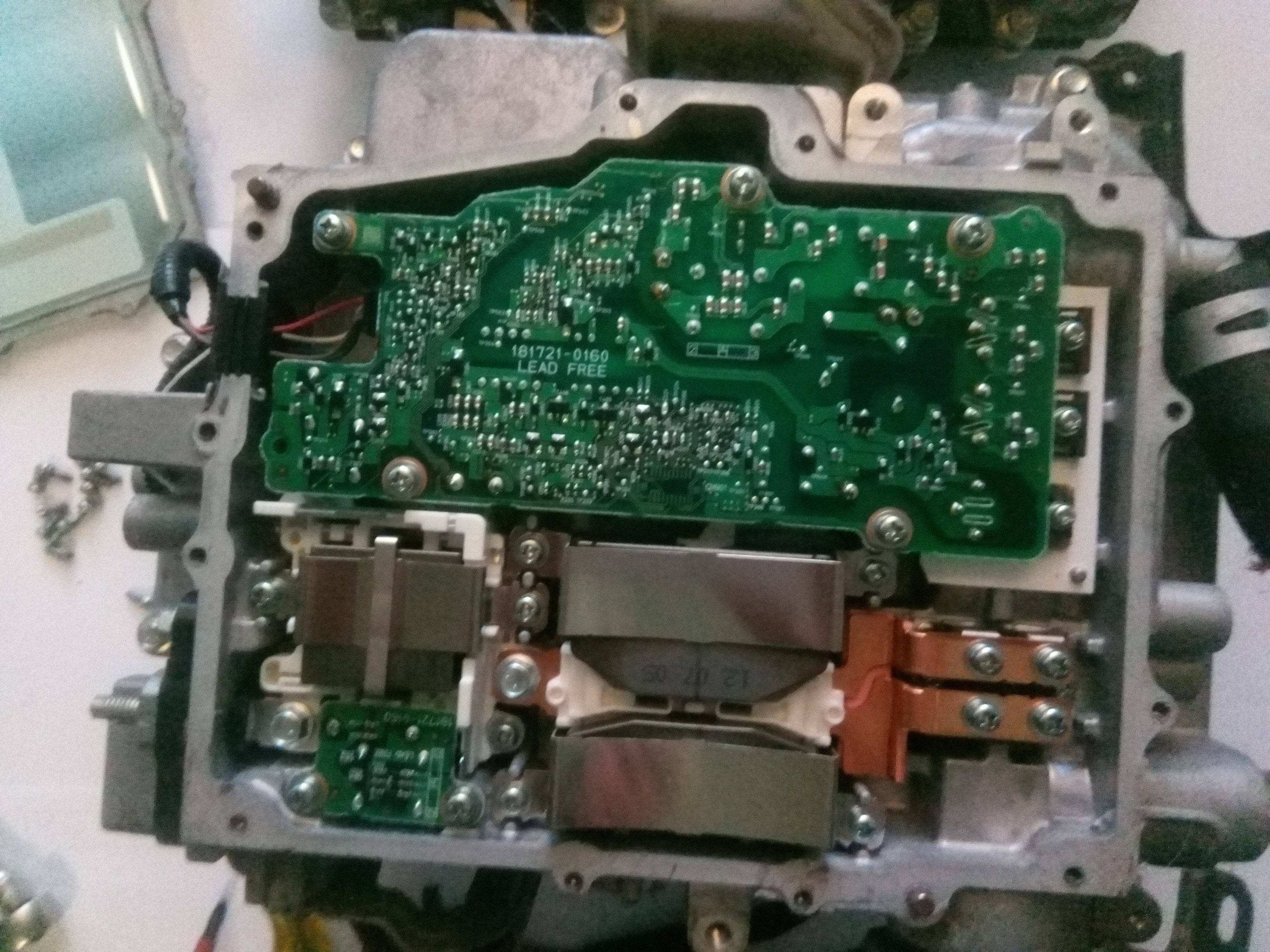

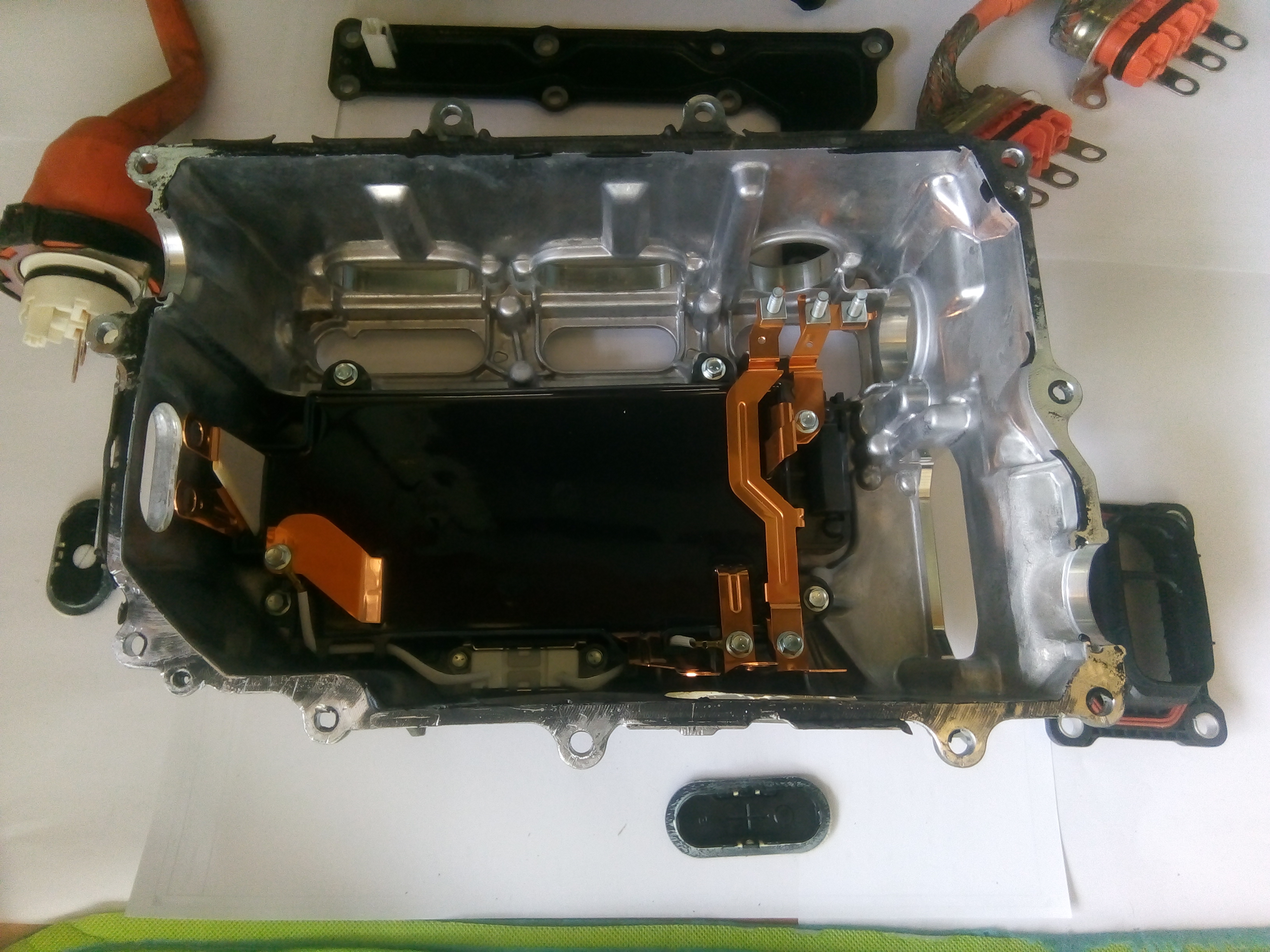

Attached please find some photos of my Toyota Prius Gen Inverter: (ZVW30R), that i wish to modify as per this site.
I did not realize until today, that you need to prize off the two black plastic covers, -then remove the bolts holding the capacitor to the inverter main assembly. Once I did that, the top came off the inverter assembly easily.
This inverter was in a car that had a front impact. From what i can see, there is no damage whatsoever to the internals. I find this quite impressive.
I got this unit from a wrecker that only wrecks Toyota s.
Lid of Inverter upside down, showing inside capacitors, 2 plastic covers and 1 connector molding.
Shows inverter base, lid and HV connectors

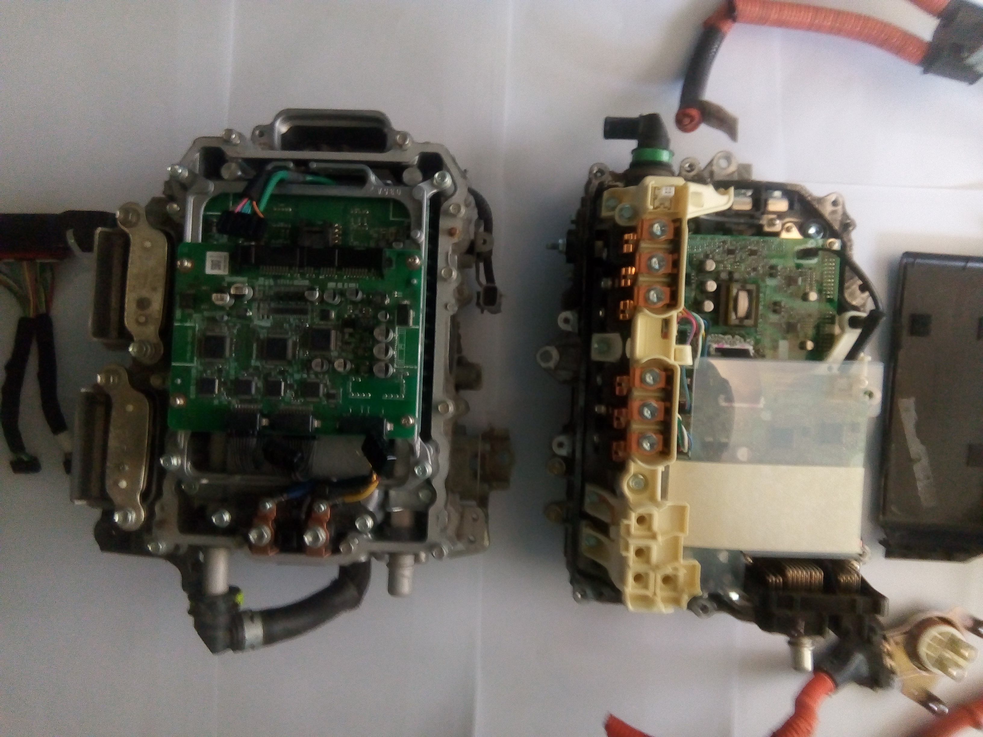

So i have pics of a Toyota Camry Hybrid AVV50R inverter. I have compared them with the Prius inverter.
Bottom view of AVV50R Camry Inverter.
Comparing Prius and AVV50R Camry Inverters.

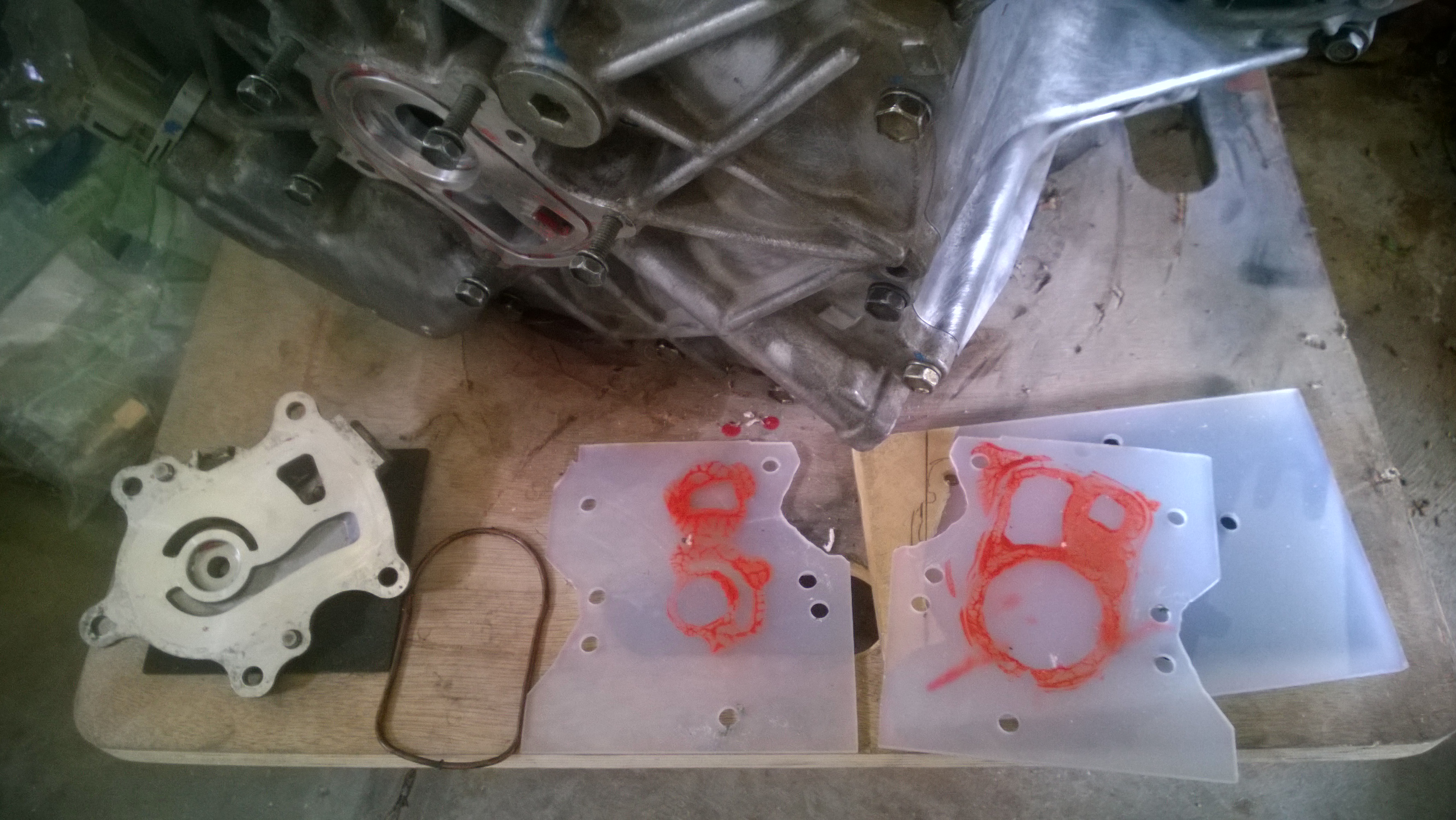

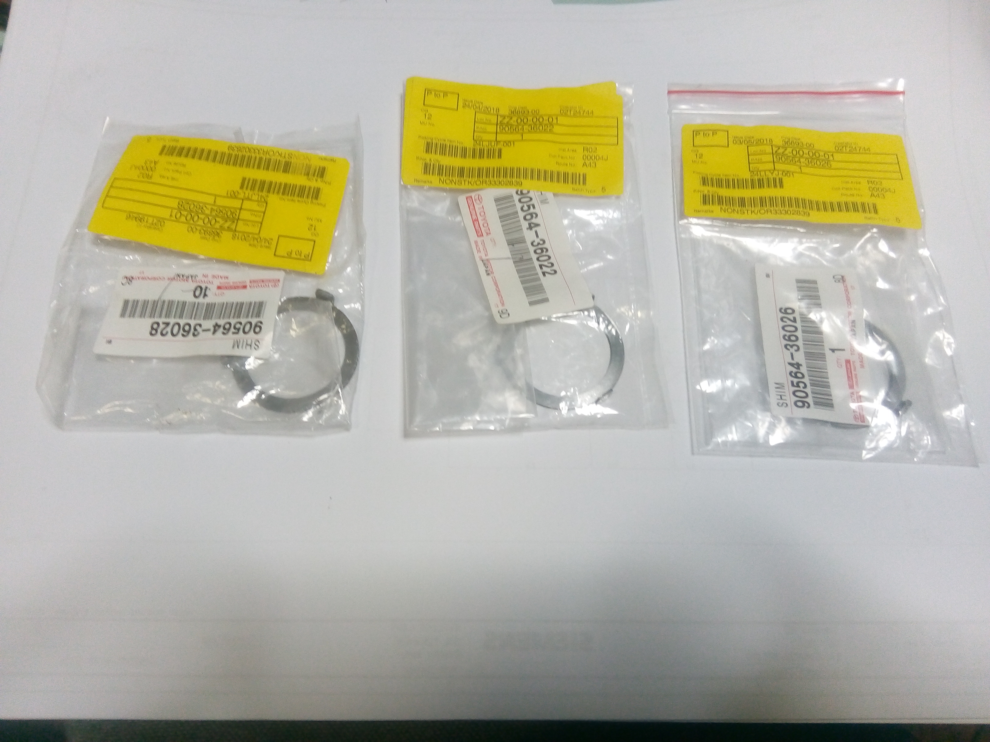

On page22-38 of the Prius Repair manual above, there is a discussion of shims that touch the motor MG.
I actually bought three different thickness ones because i thought i would need them at one stage.
I went to the Toyota dealer, showed him the page in the manual and said i would like to buy three of these shims.
To my surprise, he requested my Toyota Prius 2004 serial no. I happened to own a Prius at the time, so i could provide him with this number.
6 weeks later these items arrived. they were between Aus$5 to Aus$20 each.
PS: if you acquire a Prius transaxle, there should be at least 1 mm play in the splined axle that normally attaches to the petrol motor via the transmission input damper assembly.

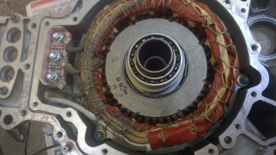

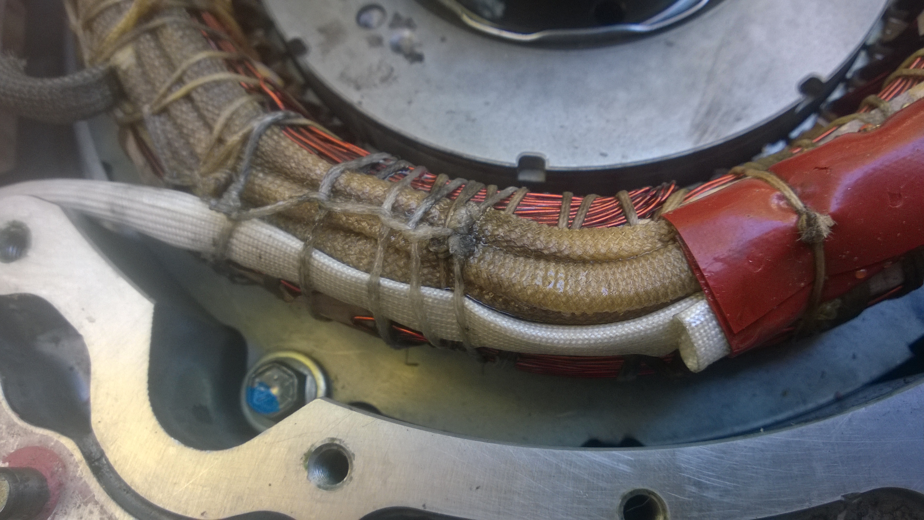

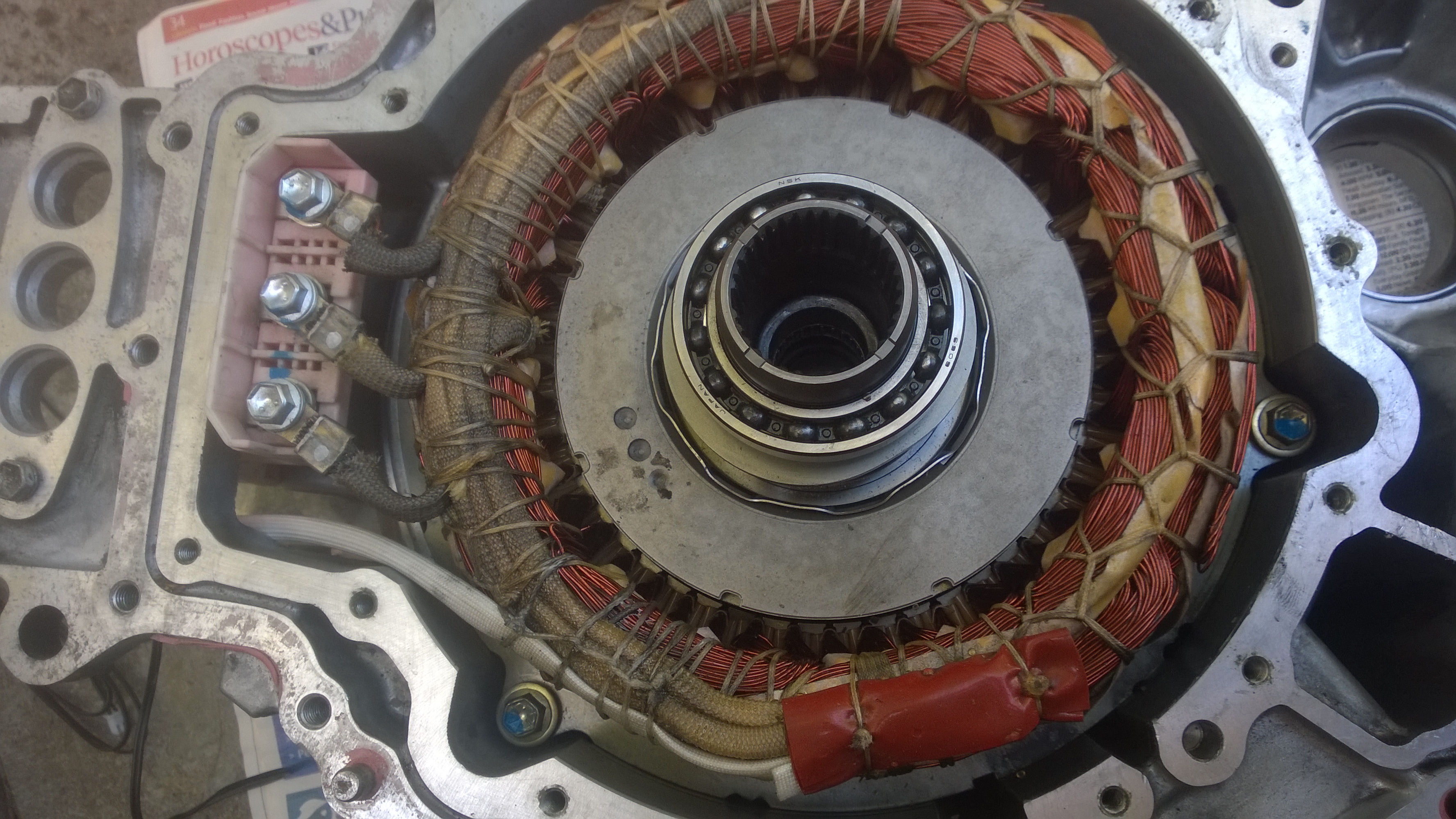

I am going to be adding temperature monitoring of the generator winding's, because at present they don't have that.
i put the sensor inside high temp spaghetti, and tied it to the original winding's, then coated it with a special winding's varnish.

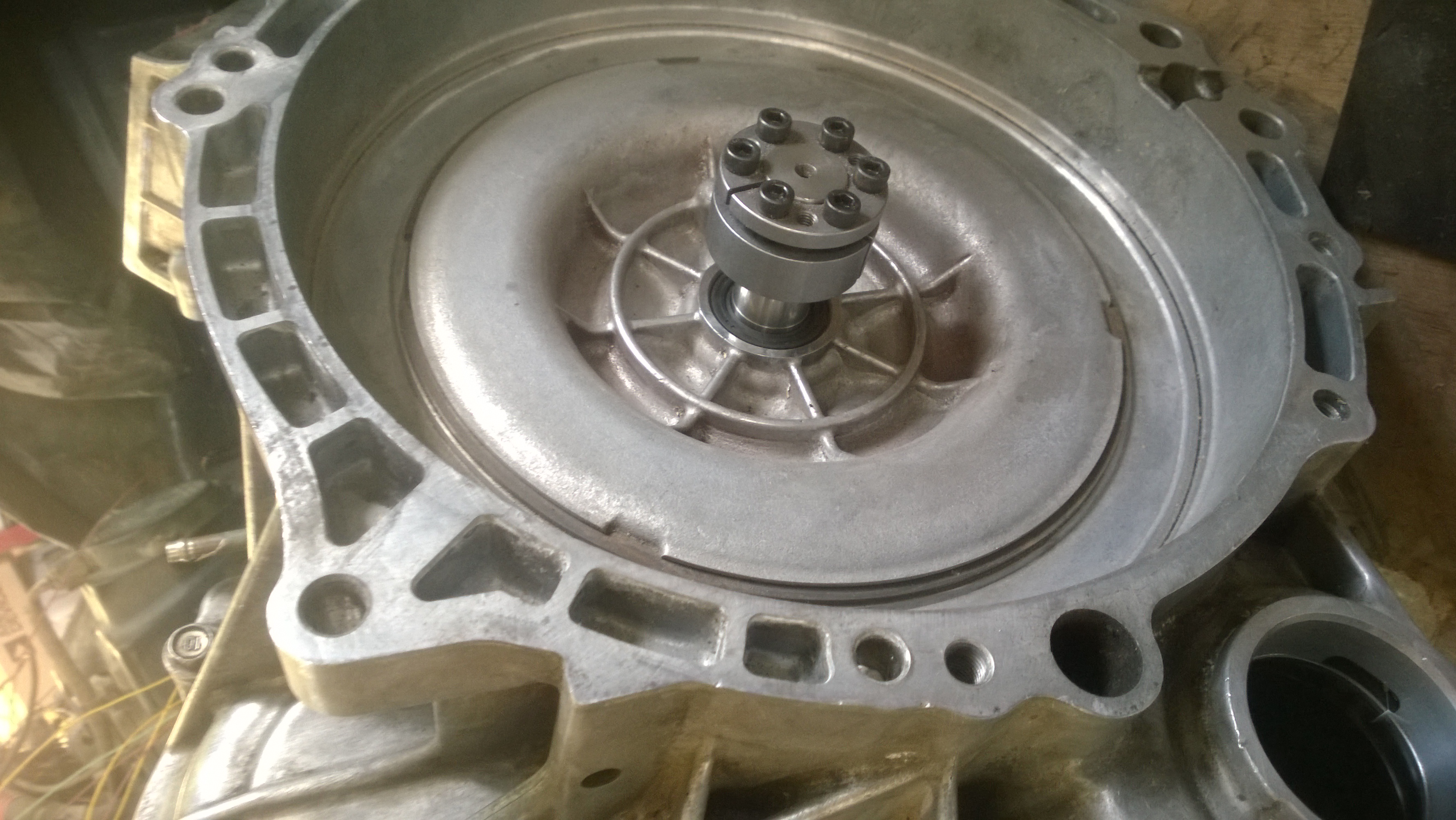

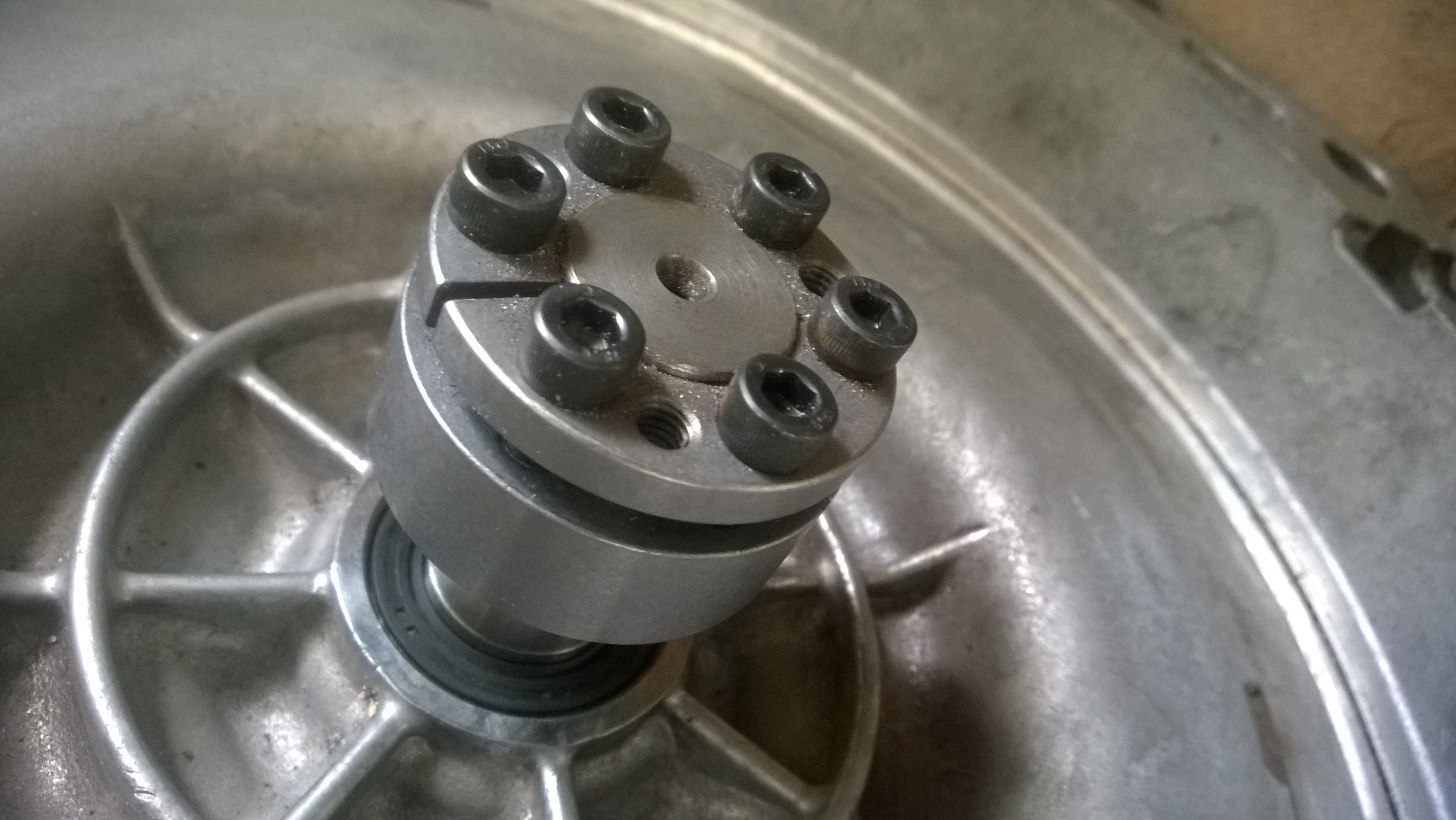

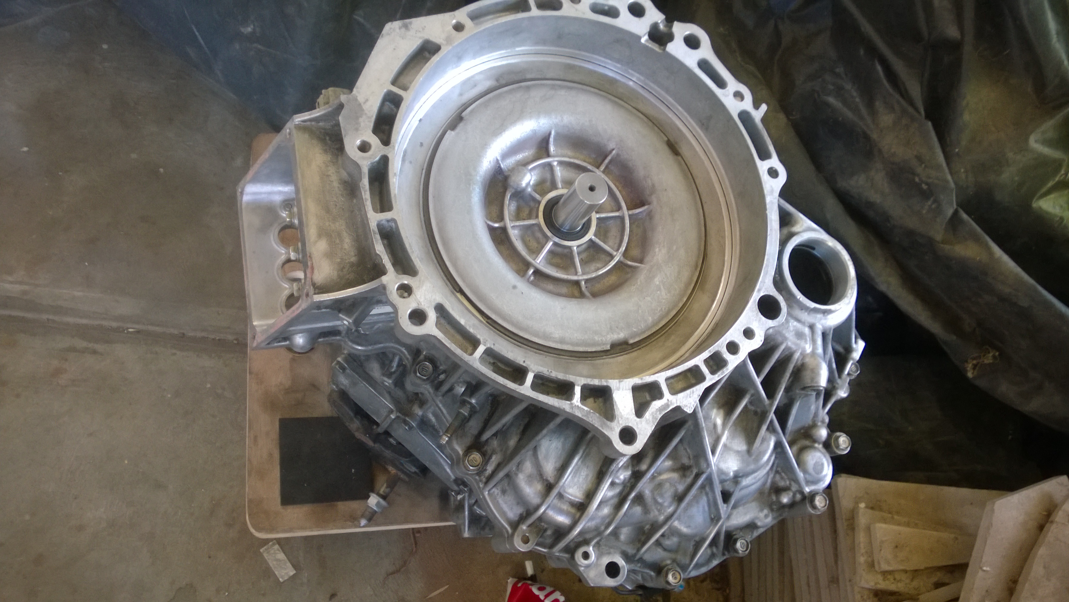

I have also had a special spindle made up for the Prius trans-axle so that MG1 and MG2 always run at the same speed. Unfortunately for this first version, i forgot to add a part to drive the oil pump at the end of the motor. So i am having to make my own oil pump with a 12 volt pump to drive the oil around. Although, that is not such a bad thing, because i can instrument this thing and see how much oil I need to wet the MG1 and MG2 stator winding's and bearings for successful lubrication and removing the heat from the stator.
I will be joining this modified Prius device to a Getrag 260 5 speed gearbox to drive my e39. Yes it probably will be under-powered. This will be my first conversion, and I am happy to learn many things from this.
I will use a dual inverter to drive the MG1 and MG2 windings. I am planning on using a Prius Gen 3 Inverter for this.
PS: the ATF WS oil has amazing electrical properties, it is very good for improving the winding wire electrical insulation properties, much better than air.
PSS: i have had aluminum disks made to interference fit the original transaxle portals no longer required. Will add the photos of this later.
PSSS: the spindle is 25mm in diameter, it is good for over 440Nm, i know this because the 25/50mm friction coupler is good for this. I gave up trying to work out the 25+ parameters for splined shafts...
PSSSS: i have to take the spindle back 5 times to the manufacturer to get a "little bit" honed off the end so i had sufficent play once all the bolts joining MG1 to MG2 were tightened up (Hence the interest in the MG shims discussed above).

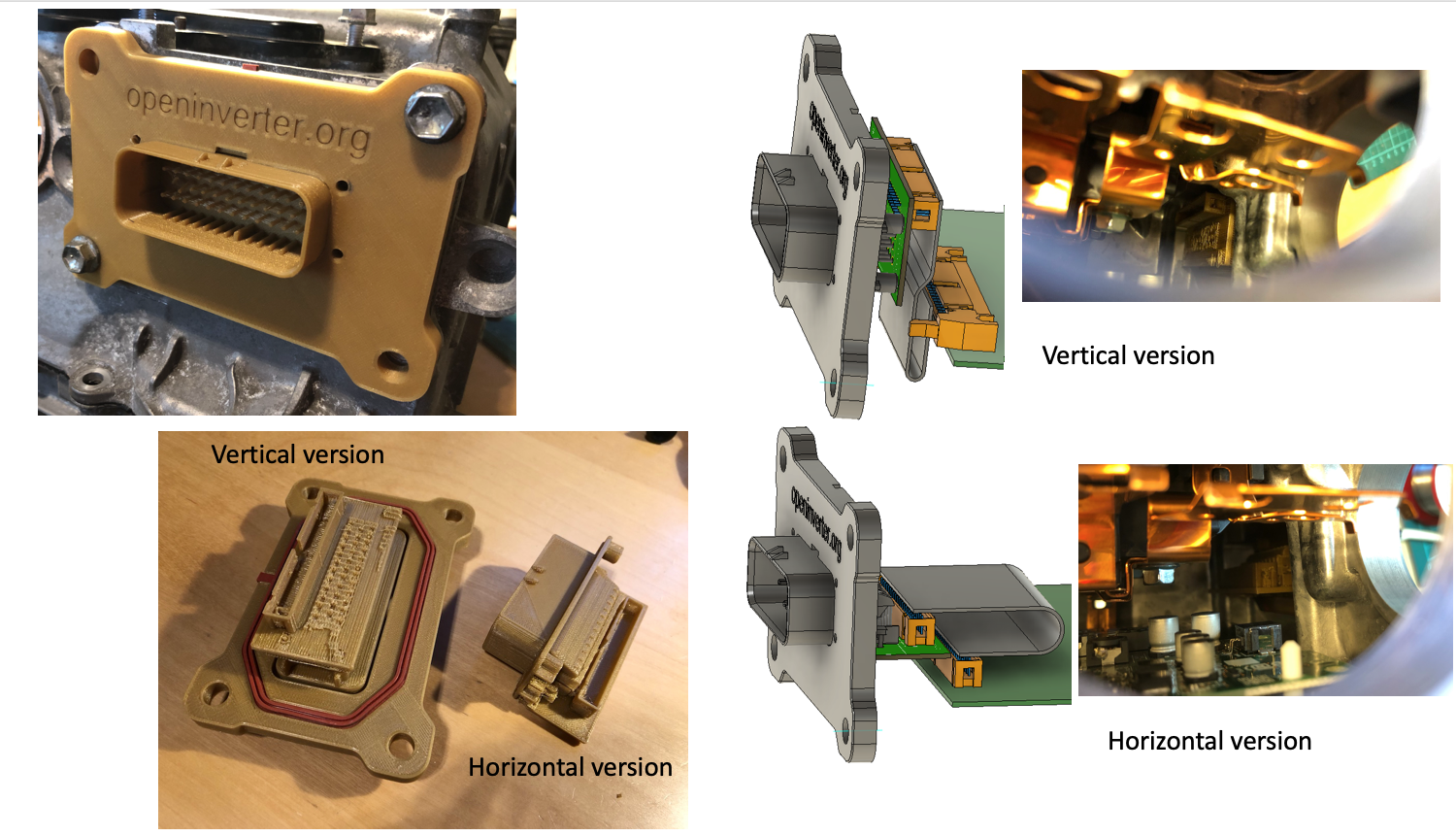

Previously I'd outlined an idea for an adaptor plate to fit the Prius inverter (and Leaf) to replace the difficult to find connector. Here's what I've got so far:
There's two versions as I developed the horizontal one first, but wasn't happy with the layout in the Prius inverter so decided on the vertical one which is much better.
The connector is a 35 way Ampseal connector which is readily available. JBs Prius board needs 40 ways, but I decided that some connections could be commonised, like the brake switch input for example.
The ribbon cable has a loop in it for assembly reasons. I think it will be possible to pass the ribbon through the hole in the housing, plug it into the adaptor plate, then bolt the plate in place.
I'll sort the files out and put them on my Github site. Next thing is to modify JBs PCB to take the new connector.

Nice work! So that would work for the Leaf inverter as well. I have uploaded the design file: https://github.com/jsphuebner/inverter- ... dapter.fpc
It is made with FreePCB (https://www.freepcb.com/)
