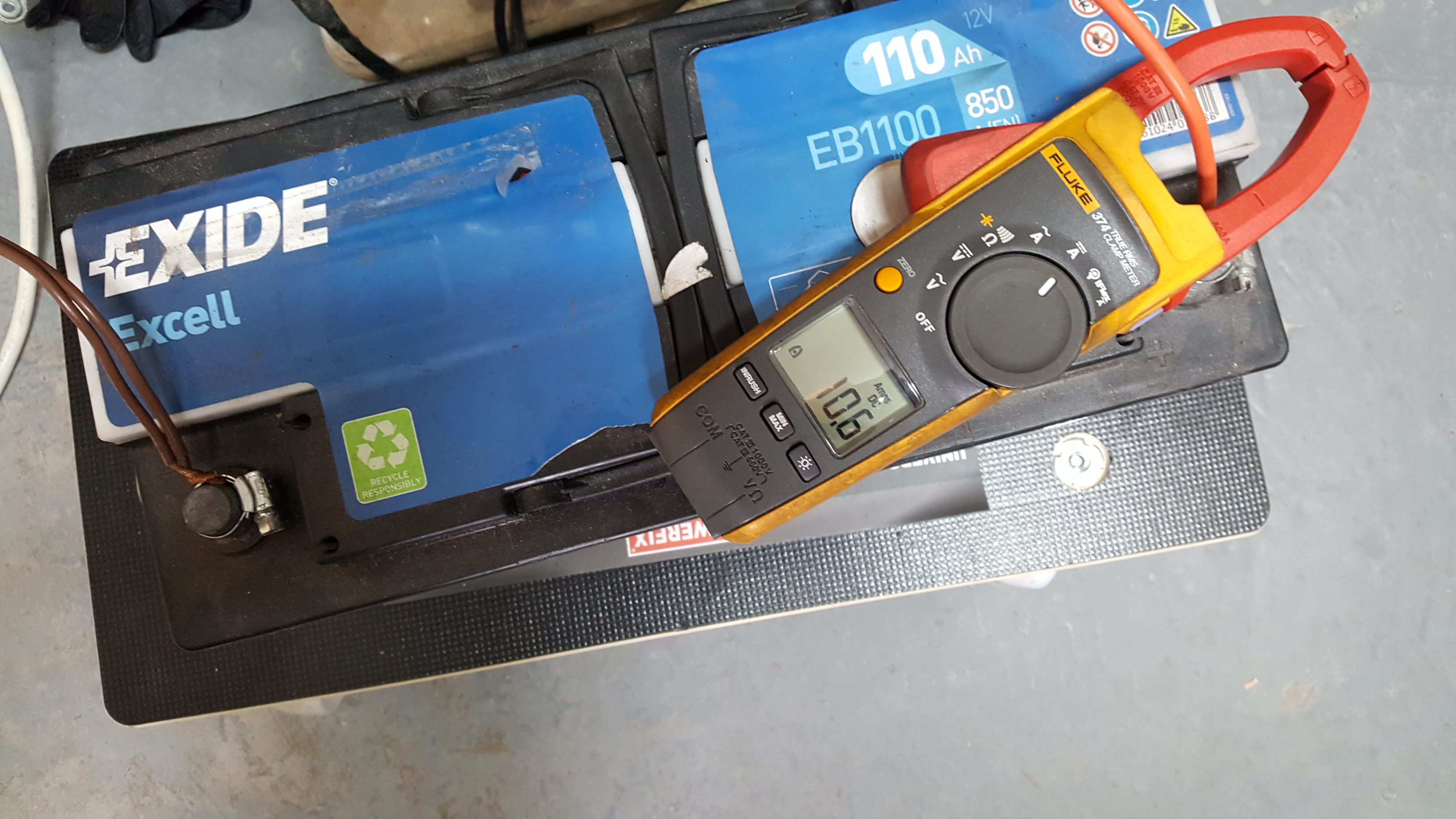

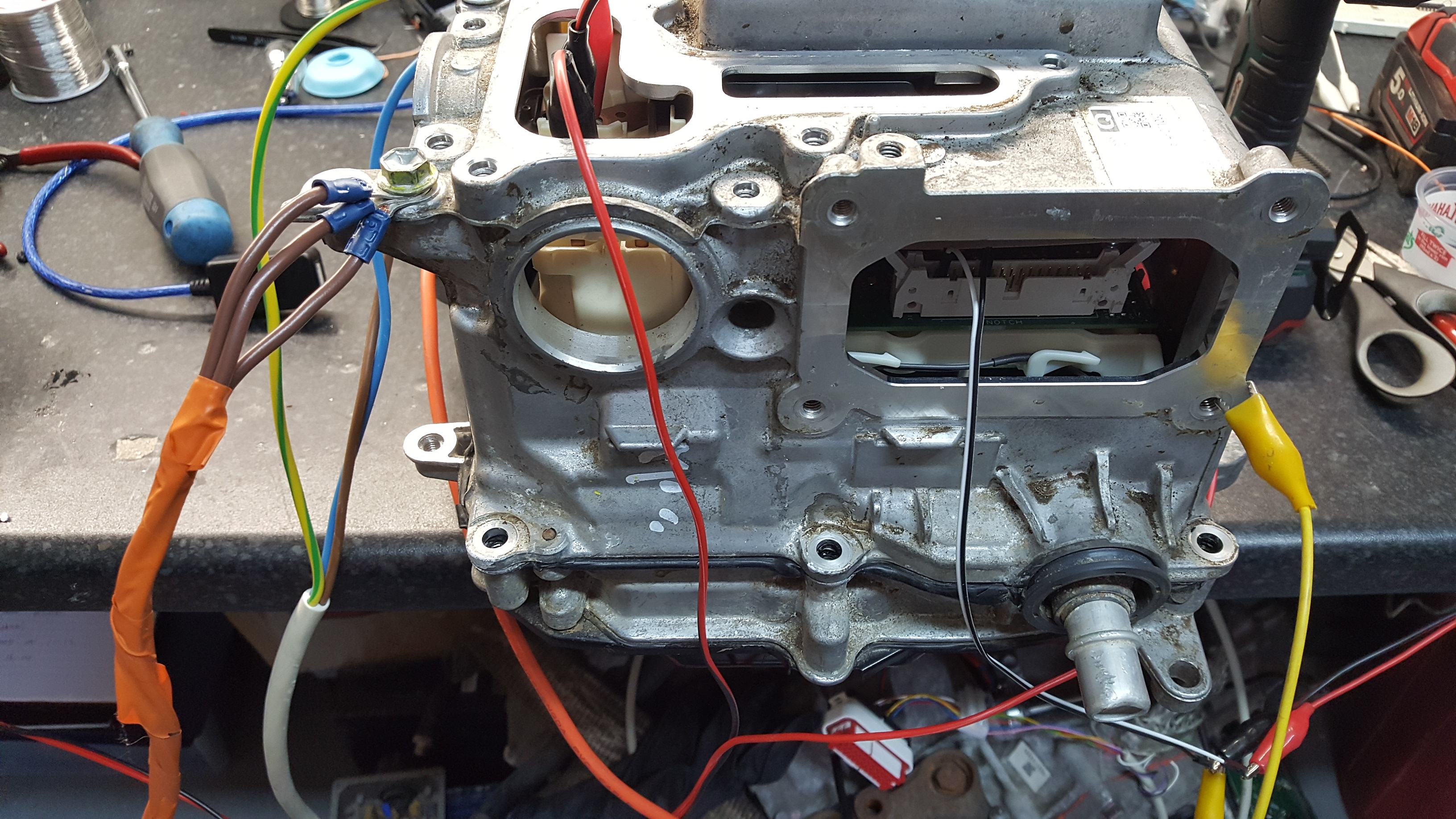

Figured I'd better test it. annnd....it works:)
Connected 230v mains to mg1, battery on the dcdc output. At 230vac in we were seeing about 320v on the HV main side and about 190v on the hv batt side. DCDC works perfectly.

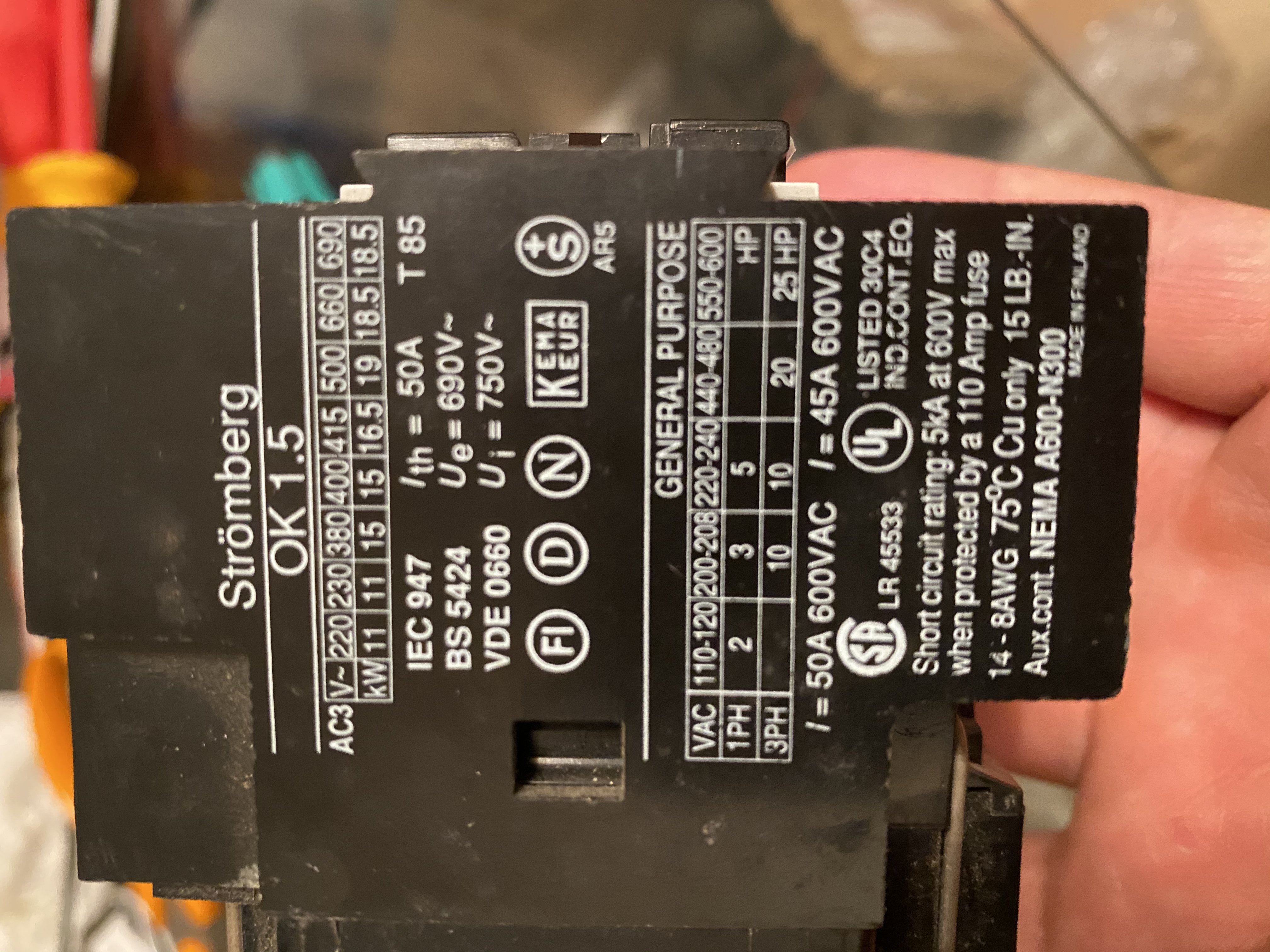

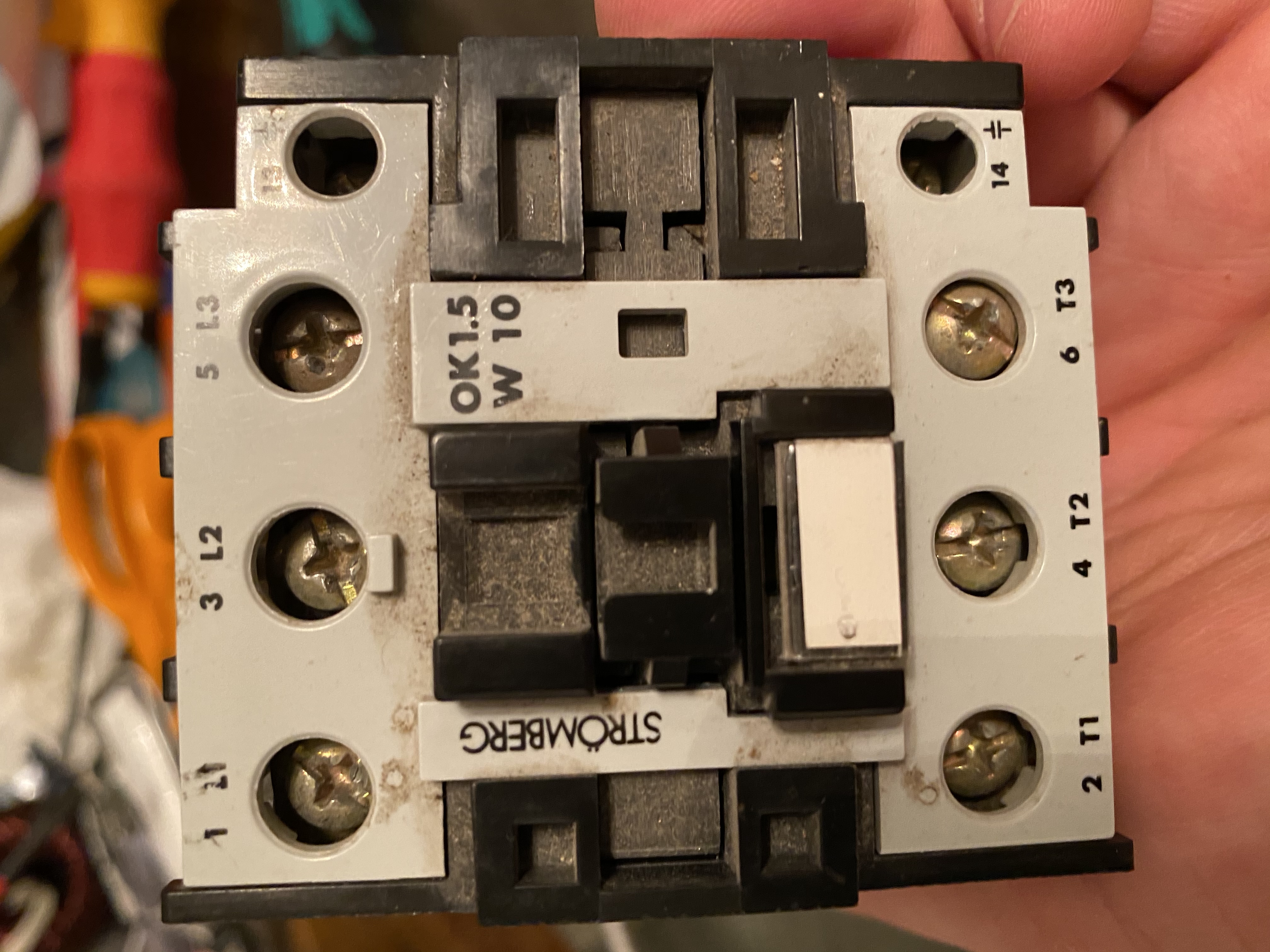

I'm not going to code it blind, I need a high power test setup for it. I currently have a Yaris inverter sitting on my desk, with all original wiring harness connectors. But before I can get to work on making it charge, I need to obtain a 3x400VAC input contactor and either decide to stuff a Prius board into it or obtain a Yaris board (Yes, Damien sent me a Prius board but I only could get a Yaris inverter for cheap...). Also I'm yet to source an HV connector for my BMW hybrid pack (not going to cut the original wiring as I plan to use the entire thing as-is and solder and heatshrink tubing for repairing cut wires isn't a good idea for high voltage high current). Haven't begun checking whether I have the 3 phase cable, connector, high current crimp terminals and whatever hardware for doing this yet. And my bank account is reading about zero right now. The car in which my existing hacky prius gen3 charger is in is a daily driver, I can't just go take it apart willy nilly.
So, if you need the code from me this fast, now you know what's currently blocking me. Throw money and/or parts at me and it'll happen faster.
I'd start programming and testing the charge function tomorrow if I had everything I needed.

celeron55 wrote: Thu Jun 11, 2020 8:15 pm I need to obtain a 3x400VAC input contactor
I have this sitting on my desk unused, if it helps I’m happy to send it to you and cover the postage as well.

I've taken jnsaff's contactor offer so I'm getting closer to having a test setup.
Don't be so hurried and worried about this, it's going to happen and you don't need to waste your time and resources on it.
