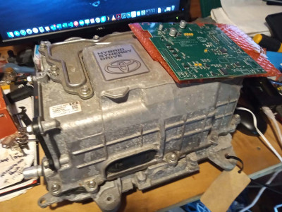

My Early Christmas Presents have arrived!
Looks like i'm going to having some fun over the weekend to see if I can de solder the old connectors, then if all goes well on to some low voltage experiments!
I think I might have to tidy the shed first !!

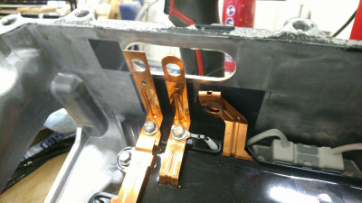

If I was in Africa with no spare inverters in sight, I'd probably connect the boost inductor to one of the MG outputs, do some cutting and soldering and be on my way again
For some reason the 3.3V rail can't get past 1.5V. Have to see what's up with the stm32. At initial inspection it seems to be dead, and taking lots of current.
EDIT: We may have to conclude that if you are switching 1500V into a dead short an inch away from an stm32, the stm32 may die. On the other hand, the atmega328 still runs code just fine and at least the ADC is still working correctly.
It's like a box of candies. If you drop some, you still have some left...

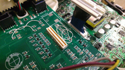

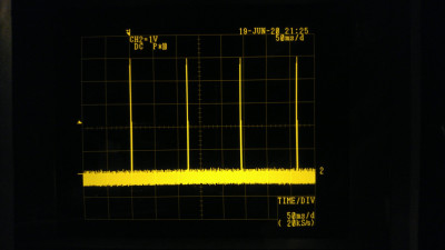

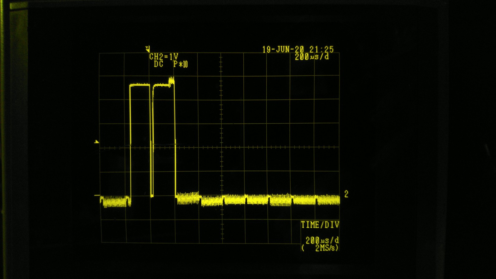

I swapped the logic board into my Prius gen3 inverter (after removing the dead stm32 from it) and I now have a problem.
The IGBT driver board releases the boost low side pull-up about 160µs after the logic board pulls it down for the active part of the PWM cycle and leaves it floating for 120ms before activating the pull-up again. This repeats when the driver board sees the logic board's transistor activate on the next PWM cycle.
As a result, I don't see much useful IGBT activity. Powering or not powering any of the high voltage rails using 12V doesn't have an effect. The high side works as expected. I am not aware of this inverter being faulty.
I'm fairly sure the Yaris inverter didn't behave like this, because I managed to destroy it using this type of control. Has anyone seen something like this? Damien?
Pictured is the TR8 transistor output when a 10% 5kHz PWM is generated by the atmega328.
EDIT: Am I going to guess that this inverter has some safety feature that the Yaris inverter doesn't have, like... shutting down the boost low side if there is no simultaneous MG1/MG2 action? That's crazy. No other option than to test I guess.
EDIT: Oh yeah now I remember: When I originally tried to do bucking with the converter, I tried to drive both sides of the half bridge, and it just shut down the thing just like now. Then I stopped driving the low side and it worked just fine. This is the same effect here, except that now I cannot avoid driving the low side if I'm going to do any boosting. Any time I've tried to drive the low side of the buck/boost converter in this Prius gen3 inverter I've found out both sides of the converter shut down, disabling their pull-ups.
EDIT: I paralleled the buck/boost converter transistor control to one of the MG2 half bridges just to see if it wants to see action there. That did nothing. I'm starting to think there could be a battery low voltage limit for the low side and it won't work unless it sees 200V.
EDIT: Supplying 240V didn't help. I used non-isolated rectified AC so if it checks for HV isolation it would have found a leak, but that's a long shot. There has to be some reasonable reason for this not co-operating.
EDIT: Maybe the relatively small inductor already saturates during a 20us or so on-time, the IGBT driver board protects it and it needs more like 1MHz with more like 100ns pulses? The transistor stage on the logic board can't even do that because it's so slow, need to add some base pulldowns to get the transistors saturate less probably. That seems crazy though, isn't it well known that at least the gen2 boost converter doesn't even work properly beyond 25kHz or so?

What switching frequency are you running? I don't have a Prius Gen 3 with a working booster at the minute (the 40 euro one has a busted boost stage) but do have a CT200H variant working in the E39 now quite happilly at 3.9khz.
- celeron55
- Posts: 804
- Has thanked: 38 times
- Been thanked: 136 times
Re: Gen 3 inverter converter control software
I've tried a lot of frequencies and pulse widths from 2kHz to 20kHz and 5-50%. Getting the same result at 3.9kHz.
I think I'll switch to buck only with precharge contactor on the AC side like I had before. More external components but it's what I already had working.
EDIT: The TJA1050 was also dead. No wonder as it was like 5mm away from where the short circuit current was going. Happened to have a replacement chip for it.

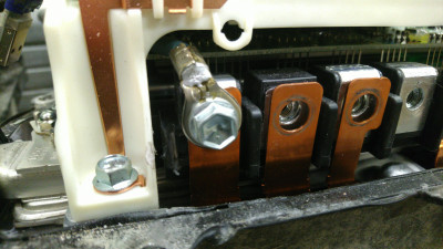

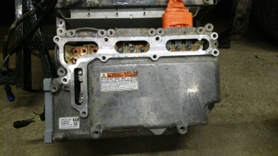

What on earth just happened?! I was merrily precharging the AC side and then bucking some reasonable output voltages to the capacitor with nothing connected to it, which I have done before with no issues as my control code is careful enough to do that. Now in my log the last output voltage was 278 volts. After that I heard a pop and each one of the four circuit breakers along the way from the house to the MG2 terminal opened, including one phase of the main 25A breaker of the house.
Both of the buck/boost converter IGBTs are dead shorts now and by quick glance there was no other damage.
I was doing buck converting with my previous total hack of a control solution for many hours at powers from 0 to 14kW in the car with no major issues, with this exact same inverter.
I guess the IGBT voltages are rated so much higher than the capacitor that if the voltage measurement was giving somewhat erroneus values, and there was slight over voltage over the total time of the test, the capacitor should have gone first. And the Prius gen3 buck output side is known to be rated for 400V all around so there's quite some headroom.
I was not driving the low side IGBT at all, because if I was, as I've tested many times now, the inverter would have stopped allowing me to drive the high side IGBT and I wouldn't have had any output voltage.
So... what caused this?
Was this inverter after all faulty to begin with and the low side IGBT just happened to give up during that specific test? That seems very unlikely after all the heavy use I previously gave to this buck converter, but I might have triggered development of the kaboom when I was trying to get the low side IGBT to do any boosting at all on the bench. So some kind of DESAT event might have been happening due to the low side IGBT being faulty, and at the same time the IGBT was getting worse.
Does that sound like a good theory?
And does anyone happen to have more inverters lying around or do I finally have to do the Africa thing and connect the boost inductor to one of the "spare" MG half bridges?

- NiHaoMike
- Posts: 69
- Location: Austin, TX
Do you have a way to check if it's actually the IGBTs themselves that are shorted or rather the parallel diodes? The diodes are not protected by the driver circuit and it's all up to the control circuit to make sure they're operating within their ratings.celeron55 wrote: ↑Sat Jun 20, 2020 8:43 pm What on earth just happened?! I was merrily precharging the AC side and then bucking some reasonable output voltages to the capacitor with nothing connected to it, which I have done before with no issues as my control code is careful enough to do that. Now in my log the last output voltage was 278 volts. After that I heard a pop and each one of the four circuit breakers along the way from the house to the MG2 terminal opened, including one phase of the main 25A breaker of the house.
Also, did you have the low side drive signal tied to the inactive state (which I recall is 5V on the gen 3) or left it floating? EMI can cause unwanted switching on floating inputs, and (much less intuitively) large loops can also pick up stray signals.
It would also be helpful to know what's the "correct" frequency to run the converter at. Too high causes excessive switching and reverse recovery losses, too low causes excessive ripple current.

Some modding:
The end result looks a bit suspicious to the experienced eye:
I cut off the aluminium where the inductor goes to the half bridge midpoint and re-wired it from there to the MG1 phases A and B. Then bent off the boost high side from the MG rail and wired those MG1 phases to be driven by the atmega328's outputs. (Seen also in the photos is my coupling of the current sensor inputs together so that I can read the MG2 sensors using the atmega328, as my 3 phase input cable doesn't reach MG1.)
I did some bucking using this and it appears to work. I've yet to put more power than a kW or two through this.
But it seems like doing this is perfectly fine if you don't have the big bucks to spend on an actually working inverter. If you have a motor on MG2 you just need to add an external rectifier from AC to the MG rail, which is not very expensive but needs to have its own heatsink if you intend to put 10 or 20 kilowatts through it.
I blew my 100A 450VDC fuse I have on the charger cables during the Yaris inverter mess-up and don't have a spare so I need to improvise a bit or wait for a spare to arrive. (Yes, looking back the blown fuse was why I saw 0V in the inactive charger output, so the Yaris inverter is slightly less messed up than I thought.)

I don't know how to check that without destroying the otherwise perfectly working inverter, which I don't intend to destroy.
Damien's board always leaves them floating when they aren't active. The output circuit is this: MCU -> 1k resistor -> MMBT3904 npn transistor -> 100 ohm resistor -> IGBT driver board.
Sure would be. The converter is really loud at audible frequencies though, even at low powers like 1kW. It's embarrassingly loud if you want to use it on a public charge point and almost ear-breakingly loud if you use it in an indoor space at high power. I wonder if Toyota's sound insulation is heavy enough to make it unhearable from the driver's seat when driving an actual gen3 Prius (at high speed when it's actually in use), or if Toyota uses 20kHz to make it silent.

Ok the code hasn't exploded my inverter anymore and on the other hand it has charged my battery at maybe 15kW or so on a public charge point (didn't have cooling and was in a hurry so had to stop there) so I think I can release it.
I did try to clean it up a lot and I haven't tested the changes, so good luck.
I'll maybe get to drawing some wiring diagrams maybe, but if you take a good read at the comments at the beginning of the .ino file and then all the #defines afterwards, you should get an idea how to put it into use.
This, of course, is an excellent piece of software and electronics to absolutely blow up your battery and set everything near it into flames, so be careful. If not for yourself, then at least for the credibility of the EV conversion community.
https://github.com/celeron55/prius3charger_buck
