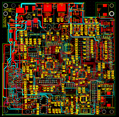

Re: Prius Gen3 Inverter Hacking
Might be a little difficult to see, but I've added U2 to JB's Prius board so that the original TE part (Conn1) or a 40 way header (U2) can be fitted depending on choice. If U2 is fitted, then my little adaptor PCB can be used.
I've also modified the top edge so that it should work with either version of inverter mounting structure:
Just need to check now that it it's all OK.
JB - are there any mods to be made based on your testing to date? I was idly wondering if DC 12V feedback to the ATMEGA328 would be useful?
Looks great. Yes I do have a few mods. I'll post later.

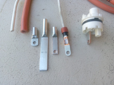

The original cable for powering the Prius Gen3 was via two aluminium cables. I did not like the current carrying capacity of this so created a 50mm2 copper cable and lug set to replace the original cables in the same plastic socket fitting, please see pic below. I am using second hand welding cable double sheathed and long lugs i have hand machined to match the original. I think it might also be possible to use waterpipe and fashion into the same shape as the lug.
I have a proper 50mm2 crimping tool to use once i know the cable lengths i want.
PS: i also looked at 35mm2 cable instead of 50mm2, and there was'nt much difference is size, so went for the much better 50mm2.
thanks for the idea. I was wondering how to do the connections on my Prius Gen Inverter.johnspark wrote:I think it might also be possible to use waterpipe and fashion into the same shape as the lug.
You're thinking of using 8 or 10mm copper pipe as a starting point?
50mm2 area cable equates to 8mm diameter. So that would mean copper pipe with 8mm inside diameter is required.
copper pipe is much cheaper than the lugs. The long lug cost $5. I have seen them on Ebay for $50.
you will need a proper crimper to get the copper strands to have good contact with the tube and good mechanical rigidity. It also helps a lot with effectively transmitting high frequency current. Years ago i saw a crimped 2.5mm2 connection that had high frequency voltage placed across it. Some of the high frequency information was not transmitted. Then the technician soldered the end, and now all the high frequency information was transmitted.
my original plug came with shielding that used to go over the aluminium wires. I am going to keep using that and either use some more of the same or copper tape i bought off Ebay for EMC reasons.

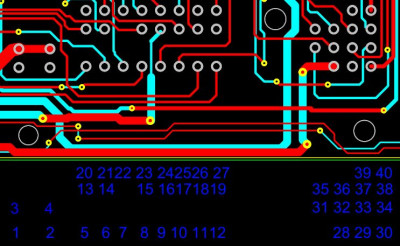

JB, have i worked out the correct terminal nos for the pcb?
kind regards...
kind regards...
PriusG3_V1 - PCB_withNos.pdf- (447.39 KiB) Downloaded 549 times
