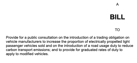

I highly recommend converters in the UK get involved in the political process... maybe Bryony would be a figure head and raise your profile if you get organised and are serious :|
Her Private Members Bill is worth a read because it includes modified vehicles;
Electric Vehicle Trading Scheme and Road Usage Duty (Consultation) Bill [HL] 2019-21 (here)

Post by doobedoobedo »
Thanks for highlighting this Kevin.
The easiest way to contact your MP (you don't even need to know who they are) is through https://www.writetothem.com/?a=westminstermp

Has anyone in the UK approached the Baroness yet? I'm happy to drop her a mail and sound out her position on conversions. I'm no expert on law or politics though so if anyone has input on what we would be taking as a lobbying position I'd be grateful.
I'm guessing that it would be clarification that all that is needed is an MOT and change of registration? And the formalisation of this guidance to give us all confidence about our conversions?
