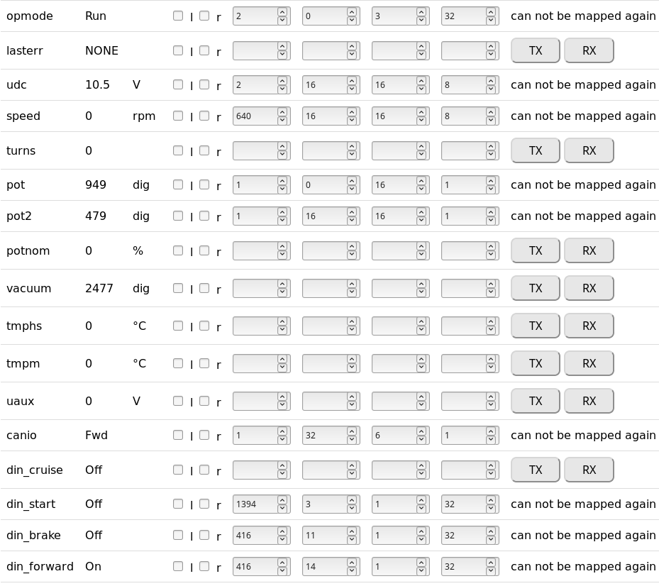

I took quite a liking of CAN today. I "wired up" the various control signals like key switch, throttle, brake via just mapping them on the CAN bus. So much easier then finding all that stuff in some convoluted wire harness. So there are just 4 wires connecting the Nissan to the VW world.

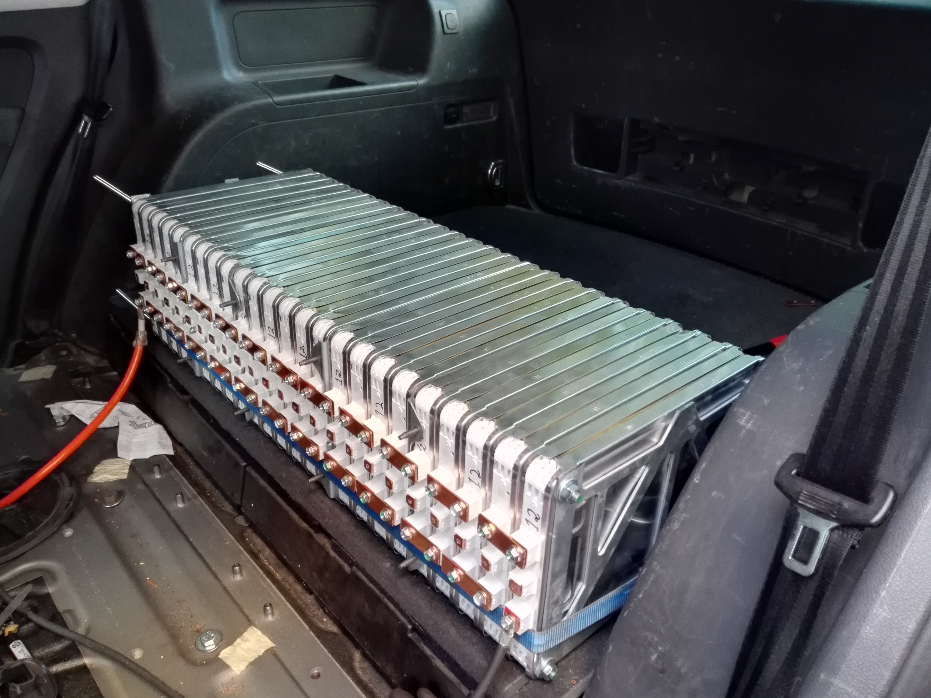

Mounted one battery in its final position and one temporary.
So now I could test at full voltage (380V). First thing I did was burning out the relay driver buried in the inverter :(
So I did manual precharging from now on
So when car is not in gear it tends to "idle". I got it to spin up to 4000rpm. The throttle/current curve is weird. When at high speed when I ease the throttle current actually increases. A lot to tune here. syncofs is 57000, next I will try the value that Arber used.
The first test drive was very slow and with unwanted regen. So just like Arbers experience.

Wow! So you actually did a full test drive with 360Vdc! That is a great step.
So did you use a strong steel profile to mount the battery pack? This will be tested now that your car will move and buck under 360Vdc.

No I was too lazy to change the mounts ;) I drilled the middle one so that it now also fits. Also re-tapped the hole with the damaged tread.

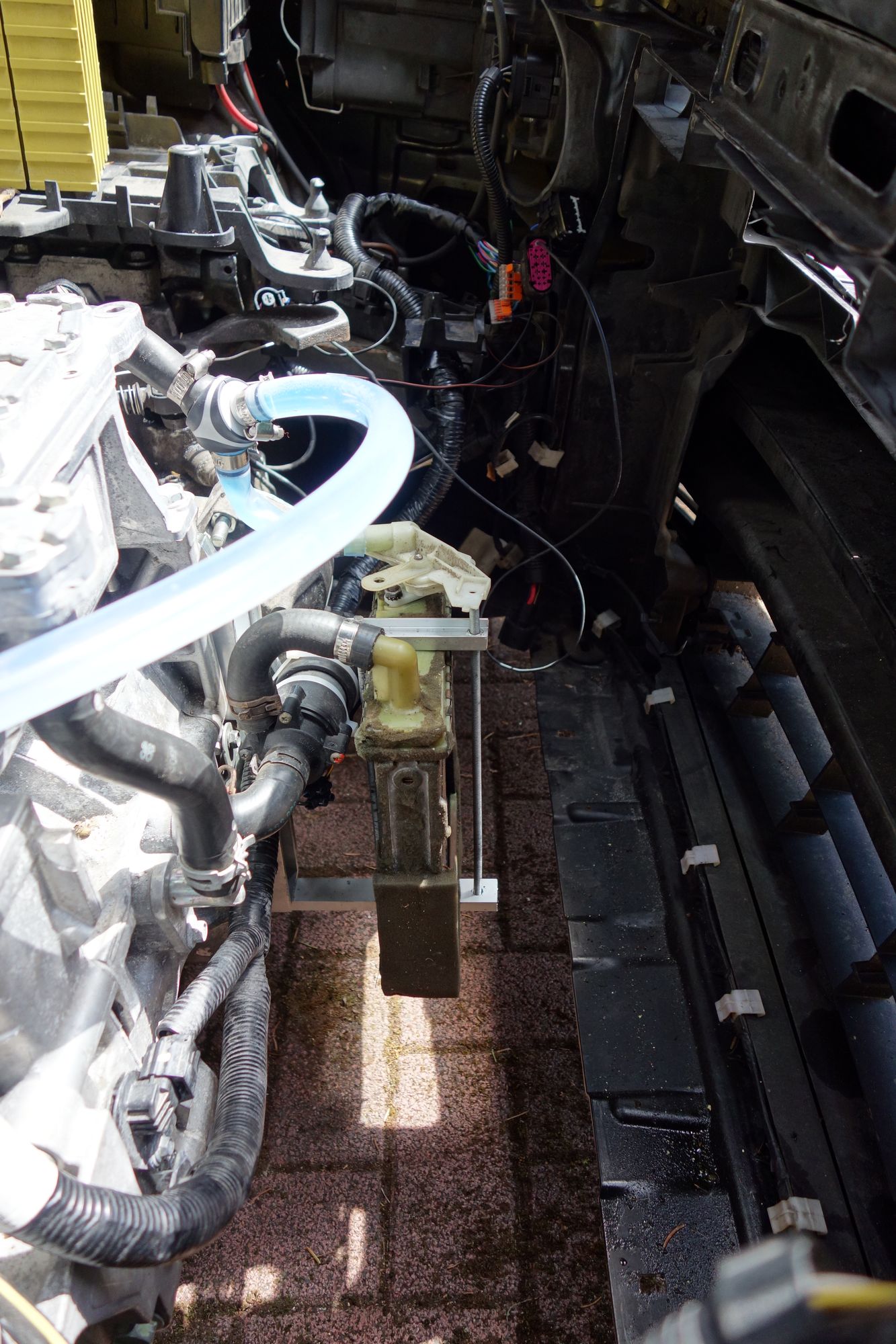

While waiting for the precharge resistor I decided to fix some miscellaneous problems:
  • Oil pressure warning: pulling low oil pressure switch depending on speed. Speed read from CAN
  • Burned DC switch driver: using custom ECU with DIP relay driver and flyback diode connected. It closes DC switch depending on opmode of inverter that is also read from CAN
To round it off I will try to obtain the counterparts of the two plugs shown below.
Will post the ECU code on github
CAN mapping. Collecting various bits from VW CAN bus. Throttle is read from analog pins
Radiator
Radiator
Overall view
Overall view
4 wires from ECU end up here - handy
Oil pressure signal
Oil pressure signal
