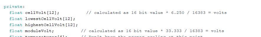

Good News everyone.
Turns out the cell mapping was correct, however migrating from BMW I3 (12 cell module) to the Phev (16 cell) in code someone forgot to change all the checks / initialisation based on 12 cells.
The temperatures was a typo was looking for IDs starting with 0x1780 but should have been 0x180. But now updated and verified using an arduino spitting out Phev Canbus thus hardware in a loop testing.
Code now on github : https://github.com/tomdebree/BMWPHEVBMS
