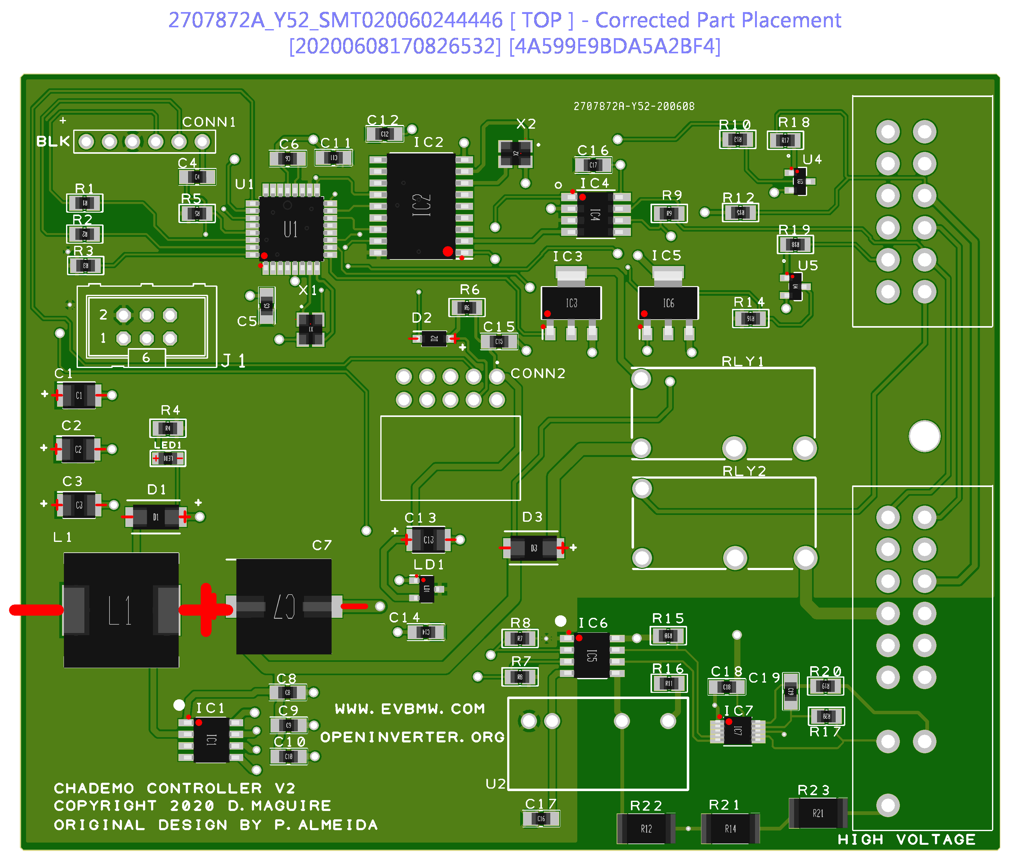

For now you'll need to work this out yourself;
Jack Bauer wrote: ↑Thu Mar 12, 2020 7:30 am Design files on github : https://github.com/damienmaguire/Chadem ... Controller
Damien, I noticed for R9 across the CAN transceiver H/L inputs, you have a 4.7k value resistor on the JLC BOM. Is this supposed to be 120 OHM?
- Posts: 3668
- Has thanked: 12 times
- Been thanked: 356 times
I've not looked at the boards as yet but yeah sounds like a mistake.
Damien - one more comment to the schematic. R21/R22 are dividing high DC voltage VBAT of the battery to the value suitable for VBUS input of INA226. Ordinary SMD resistors are known to quickly degrade on such high voltages, either special ones need to be used or many ordinary ones in series. You can find the second solution even in Yaris/Prius inverter.

Following some testing failures, V2 hardware now uploaded. Problems arose with the HV voltage divider and isolation distances. Now ammended along with some minor component value corrections.

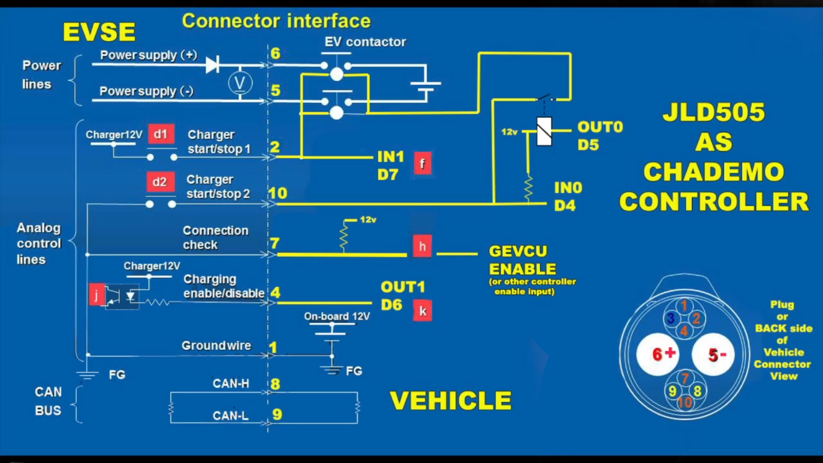

Technically speaking, if you already have something like the SimpBMS or the ISA shunt available for voltage values, the main points of the board then become:
CAN communications
Contactor control
Charge start signal to the CHAdeMO charger
Is that accurate? I wonder how much simpler / smaller we can make the design if we offload the HV measurement function.

Two outputs and two inputs are required to handle the contactors and CHAdeMO handshakes.
Abstracting the HV measurements would be great; that was the biggest hurdle when I was working with CHAdeMO a year or so ago. It's not great to have extra HV wires running around the car.
(Current is also needed, the charger and car have to agree on that value as well; I guess you could force them to always agree, but that is less safe/doesn't comply with the standard)
-Isaac

Technically speaking the SImpBMS can report current as well with the right sensor (which the Chevy BMS master should have one in it.). So then an either/or solution there would work.
Looking at the pinout doc:
You're right though. So:
CAN
2 Input signals
2 Outputs for contactors
1 output for Charge Enable
-Matt
is where I got the idea that only Pin 7 would be needed for an output.Plug B (CHAdeMO)
1 – GND, connect to PIN1 (GND)
2 – Charge Start 1 , connect to PIN2 (IN1)
3 –
4 – Charge Enable, connect to PIN4 (OUT1)
5 –
6 –
7 – Proximity, connect to PIN7 (Proximity)
8 – CANH , connect to PIN8 (CANH)
9 – CANL , connect to PIN9 (CANL)
10 – Charge Start2, connect to PIN10 (IN0)
11 –
12 –
CAN
2 Input signals
-Matt

Seems to me like Pin 7 is not actually needed at all on the vehicle side, unless you want it to power up the chademo controller.
It is hardwired to ground on the charger side. I charged without using it at all.
Are two contactor pins needed?
EVTV schematic (old but works): -Isaac

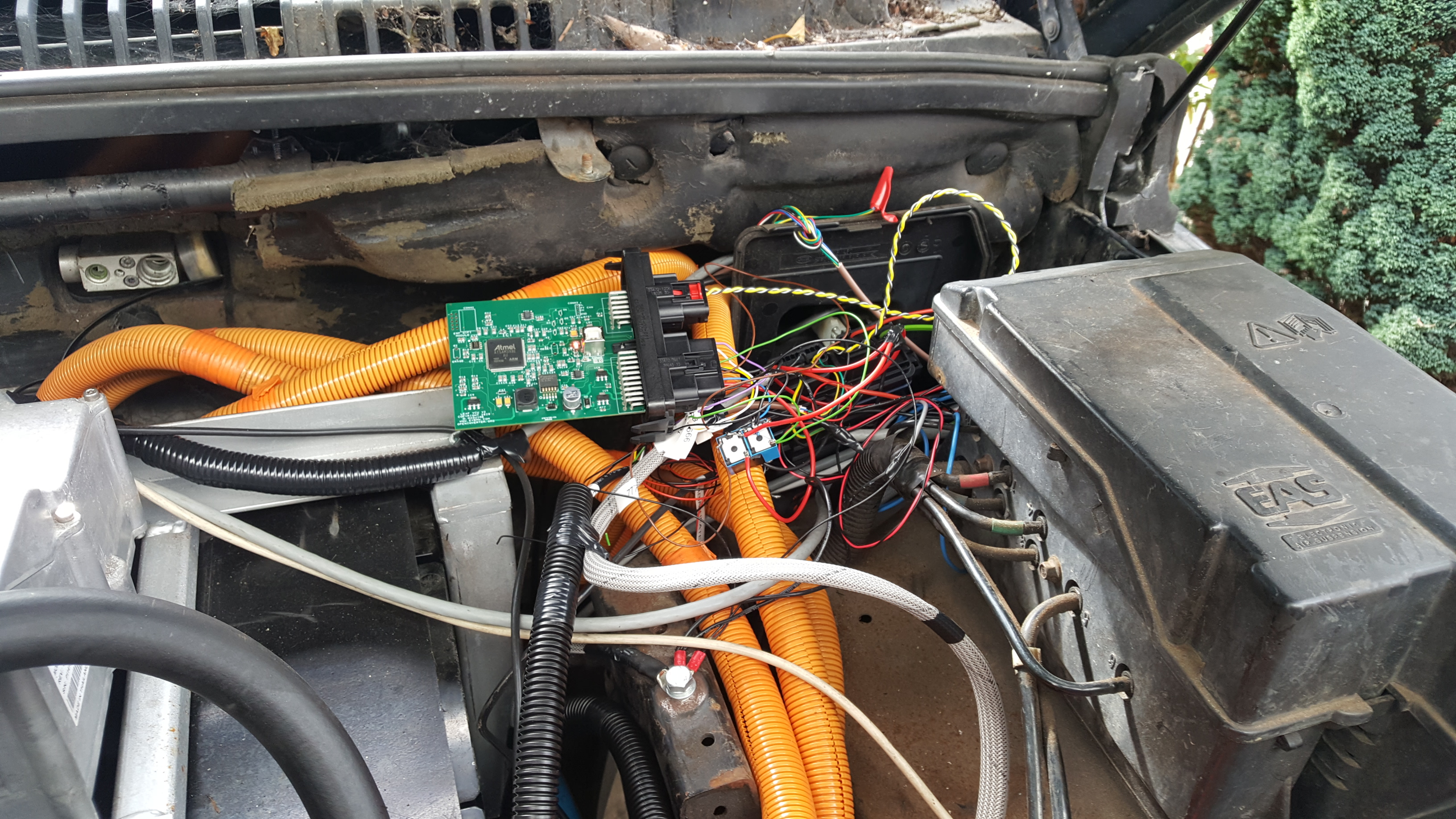

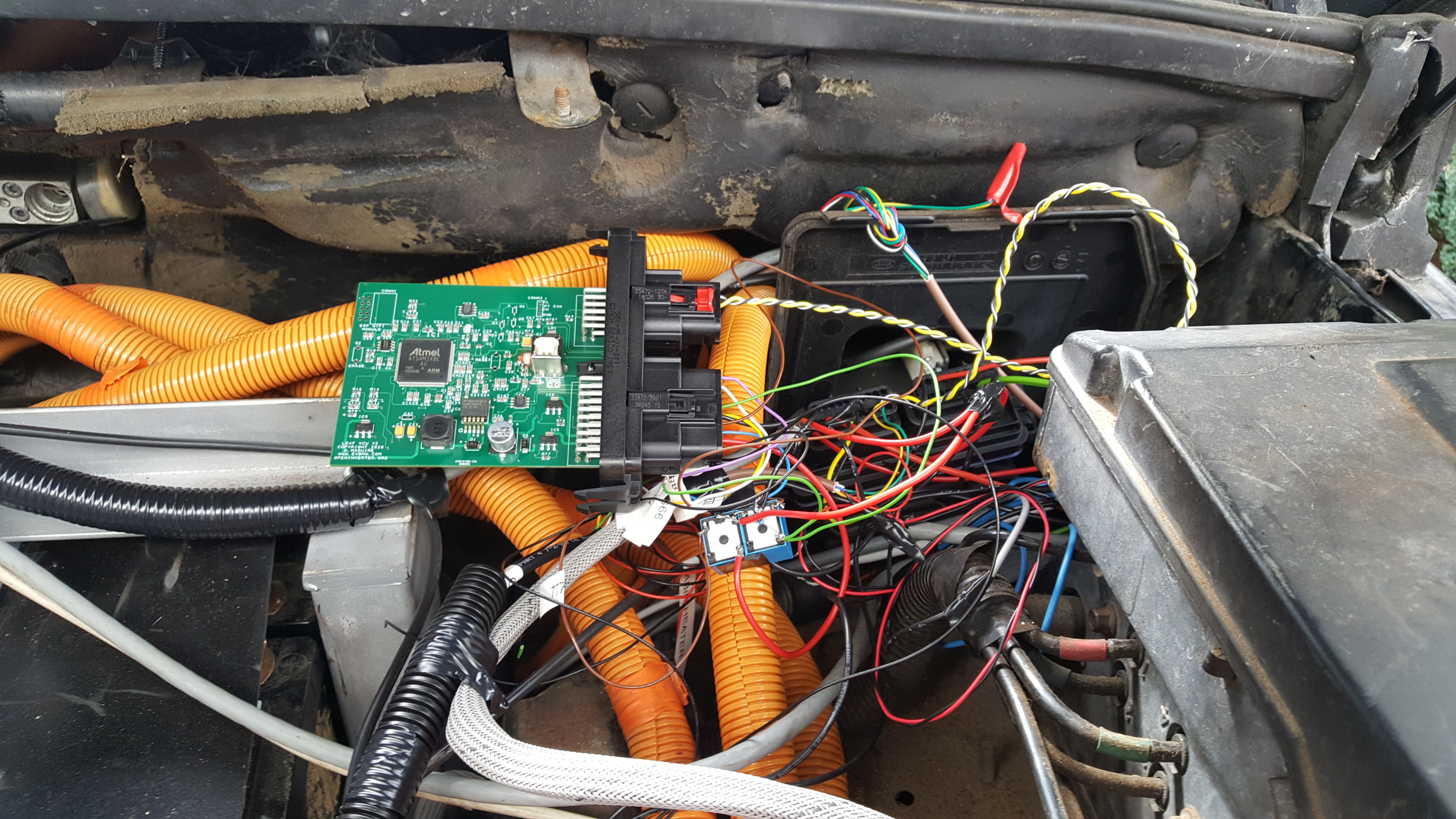

So as all my vehicles now incorporate the ISA shunt I have decided to take a different track with the Chademo controller. Basically its now using the same hardware as the Leaf VCU V2: https://github.com/damienmaguire/Nissan ... Controller
and two small external relays to provide the interfacing.
Currently installed in the deranged Rover and as soon as I can find a chademo port will be installed on the E39. Once proven there it will be available for sale. As this is 90% a software task I'll put it out there to the community and ask for some help to develop the firmware. If people get on board then its will be 100% open source. If not and I have to retain a developer it will be released under the same model as the V5 Tesla charger board.
Added bonus of no extra stupid shunt or hv wiring needed.
- Posts: 3668
Few pictures of it installed in the Deranged Rover.
