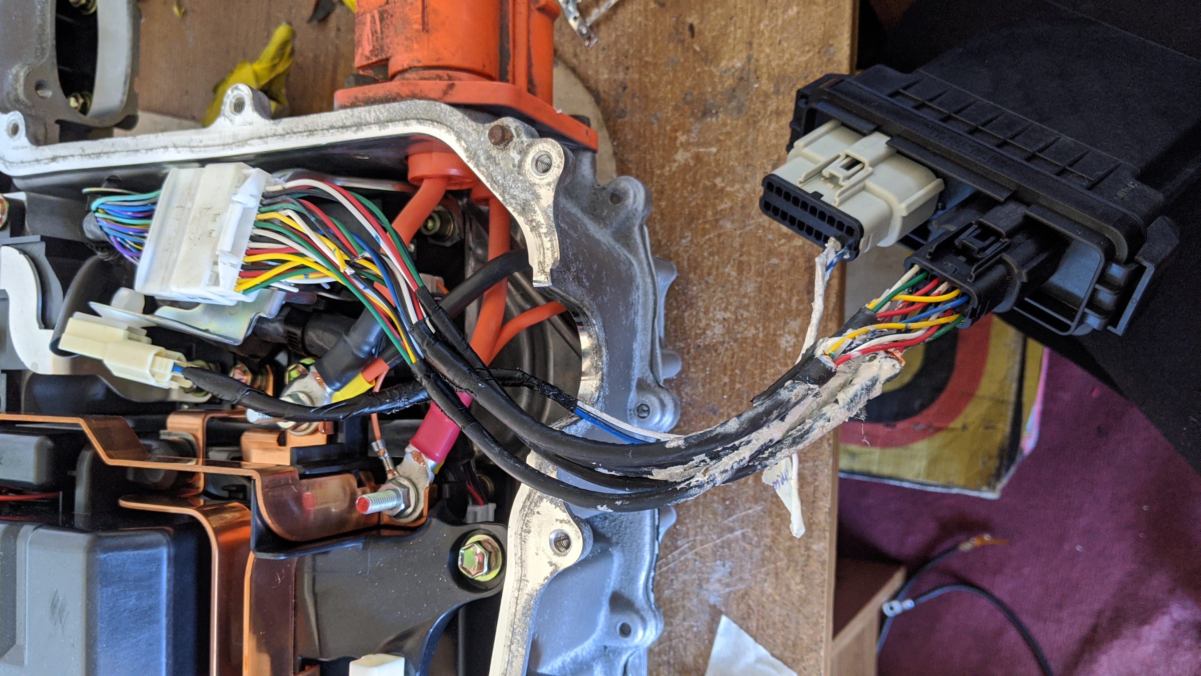

LRBen
Posts: 577
Location: Somerset, UK
Has thanked: 78 times
Been thanked: 231 times
Post by LRBen »
MattsAwesomeStuff wrote: Sun Jul 12, 2020 12:11 am We should probably create a page just for the inverter itself and the breakdown, and then from that link the two project pages that came out of it.
Even if it's not much more than a placeholder, it's going to mislead people if they can't find content about it.
I think that would be a good idea. Even just the basic information from this thread would be fine with a very basic overview of putting it all together. If there was a page created for this project I would be happy to populate it with what I learn as I go.
I do have a question about the initial setup. On the info sheet it says to connect the 2 pole power connector to 12v and GND. Does that mean the 2 pole power connector to the 12v and GND on the control board pins or a 12v supply and GND?
I am assuming it means a 12v supply and GND as when I set it up like the attached photo I get nothing.
So just to clarify. I need a 12v supply and GND to the inverter board, and 12v supply and GND to the 2 pole power connector on the inverter itself?
Just want to make sure before I pop something.

LRBen
Posts: 577
Post by LRBen »
LRBen wrote: Sun Jul 12, 2020 5:49 pm I do have a question about the initial setup. On the info sheet it says to connect the 2 pole power connector to 12v and GND. Does that mean the 2 pole power connector to the 12v and GND on the control board pins or a 12v supply and GND?
Figured it out. Inverter needs 12v and ground, so does the control board. Got it running now and giving me a voltage reading on the HV DC line.
