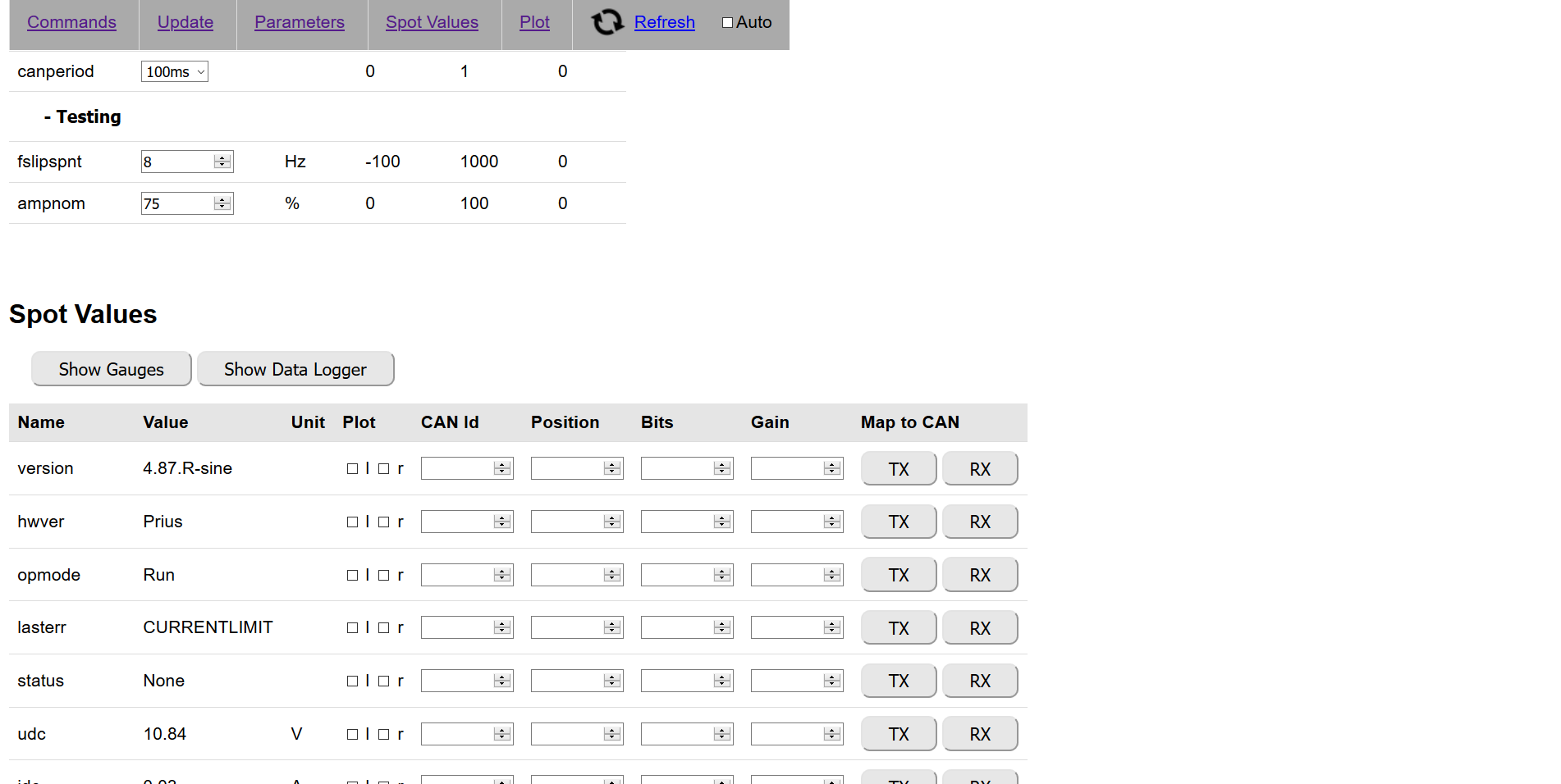

Now with FOC and having followed the "Using FOC Software" instructions, I get zero output on any of the three phases and I don't hear any PWM being applied (although I have mild tinnitus...). Any ideas?
The GREAT news is that now the Resolver works perfectly w/FOC 4.87.R and I can even count revolutions and seems to match published gearing almost exactly :D
Posts: 6619
Has thanked: 343 times
Been thanked: 1485 times
ZooKeeper wrote: Sun Jul 19, 2020 12:07 am Now with FOC and having followed the "Using FOC Software" instructions, I get zero output on any of the three phases and I don't hear any PWM being applied (although I have mild tinnitus...). Any ideas?
Great the resolver works.
Run mode or Manual mode? Is dir=forward? Either by setting dirmode=AlwaysForward or applying 12V to forward pin. All derating parameters set up in a way so they don't derate? (Shouldn't matter in manual mode however)

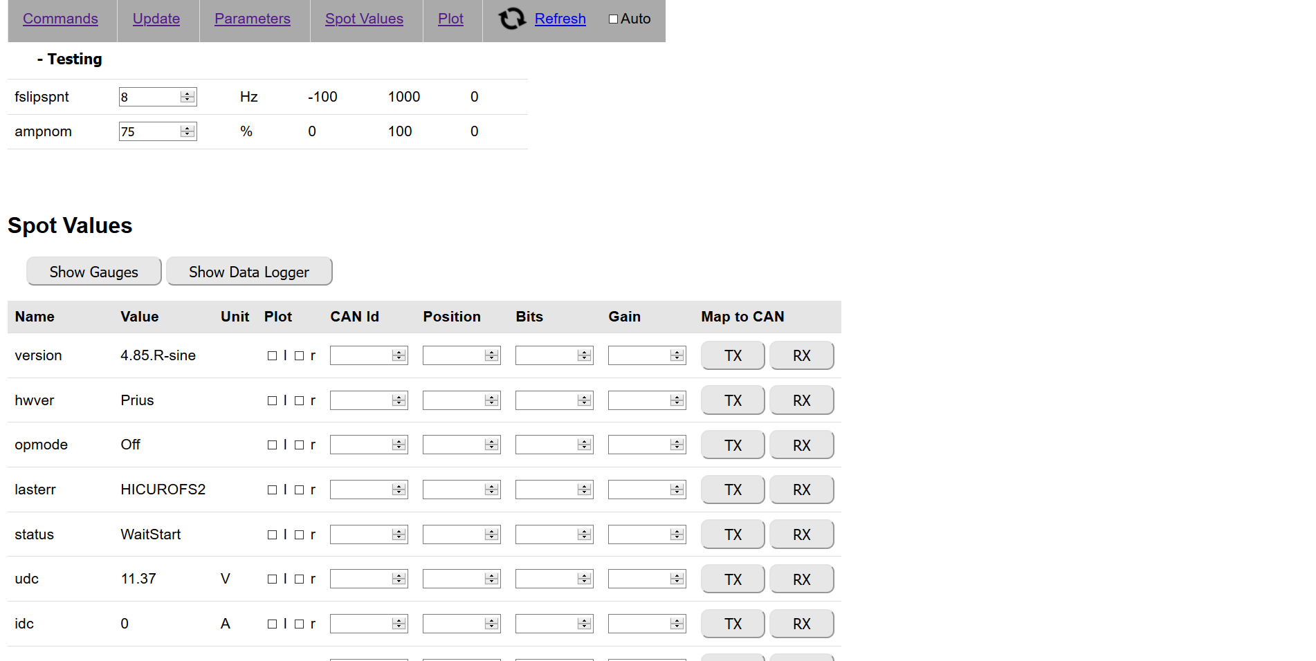

I did notice something odd after loading the current SIN.bin file for testing, every time I try and enter 8 for fslipspnt & 75% for ampnom, it reverts to 1 and 10%, almost like it is dividing by 10 and rounding??? Every time I refresh, they do the same. I found 4.85.R is normal for these params.
Wondering if the inverter is ok after the minor short yesterday. Although I cannot see how that would be possible to damage it A 40V with 20ga wires and a power supply limited to <100A.
4.85.R = normal fslipspnt &amp; ampnom
4.85.R = normal fslipspnt & ampnom
