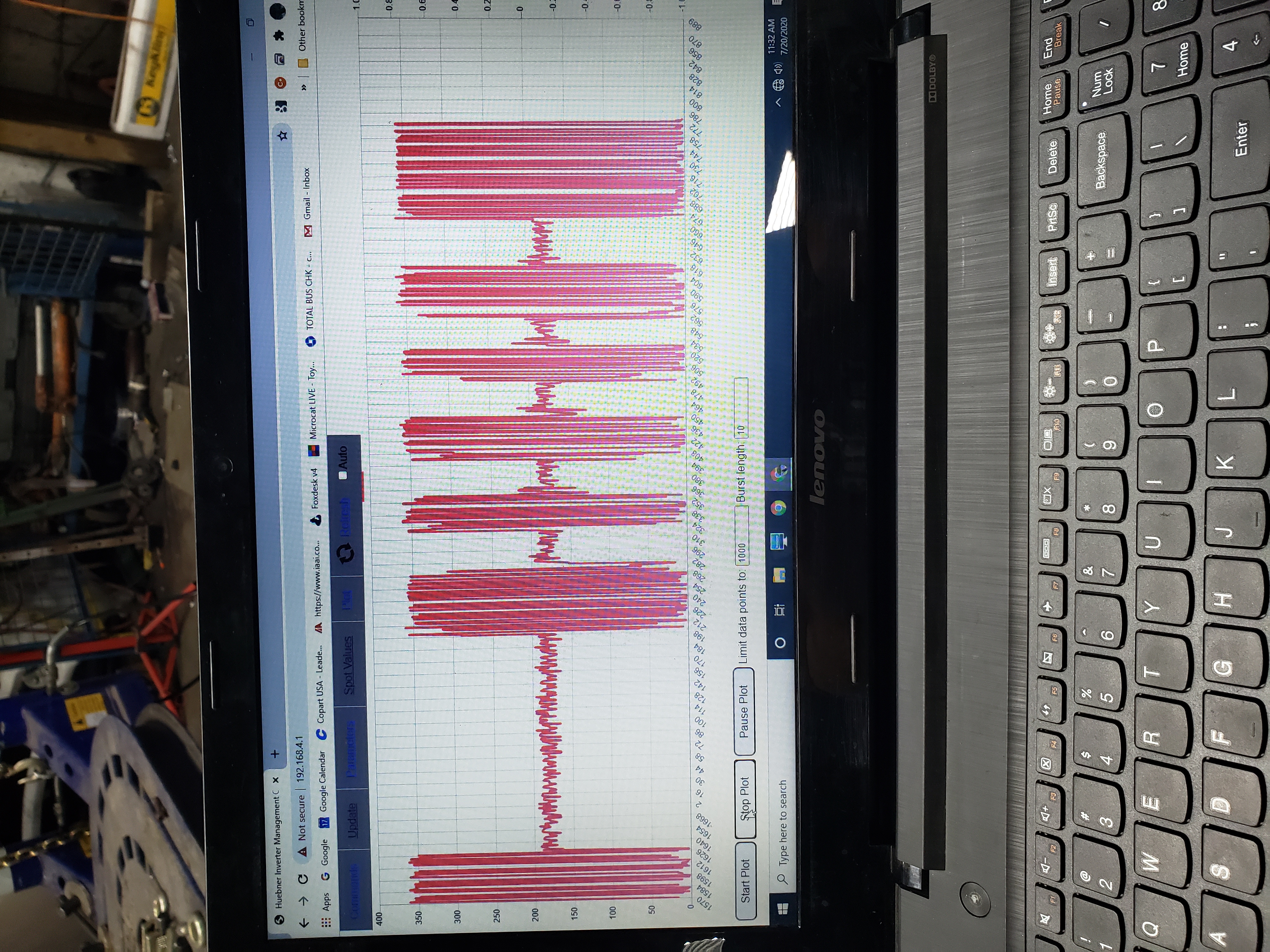

You need to be systematic about pole pairs, otherwise you are left with too many variables. Set both polepairs and respolepairs=1 and try to do a full motor revolution while plotting angle. How many times does angle go from 0 to 360?

okay set pole pairs to 1 and it appears to me that there are 6 zero crossings.see the photo
does that mean.....what?

That would mean 6 pole pairs for both polepairs and respolepairs
ascii-art wrote: Mon Jul 20, 2020 4:44 pm This reverse engineering report might be useful. It says 8 poles for both MG1 and MG2 on pg. 10.
And that would mean 4. Now what ;)

I notice that my angle plot is a modulated sine with 6 zero crossings in one revolution, but in Damiens youtube video at time 17:23 his is a nice sawtooth.
most information including the oak ridge report linked above and the youtube comments seem to agree there are 4 pole pairs for the prius mg2.
but I believe I saw damiens pole pairs was set to 2 and resolver set to 1 at time 21:37
these photos show that mg1 and mg2 resolvers are the same. I have just taken apart a gen2 transmission.
and you can also see there are 48 sections to the motor and 14 sections ( slots) to the resolver.
im wondering how 6 goes into 14....but both are divisible by 2 ( his pole pair setting.)
