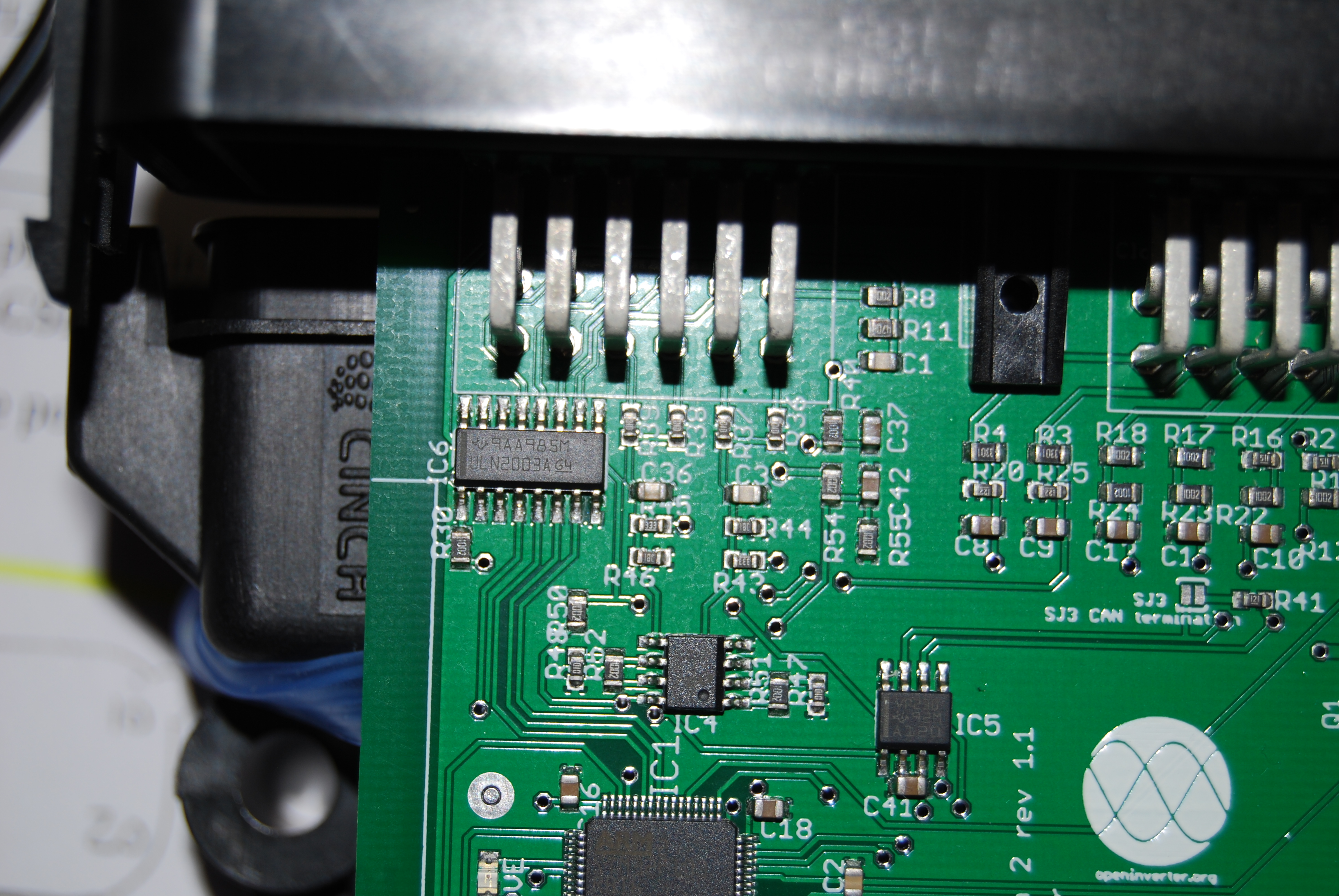

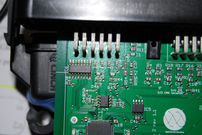

So I bought another inverter, not that I need a 4x4 vehicle or have another MGR to use with it, but for testing as it was cheaper than another VCU.
Same results, absolutely zero inverter output on MG1 or MG2 and the resolver circuits are not working, so I am pretty sure the VCU is damaged. Resolver wiring ohms out the same as before, I will take that as good news :)

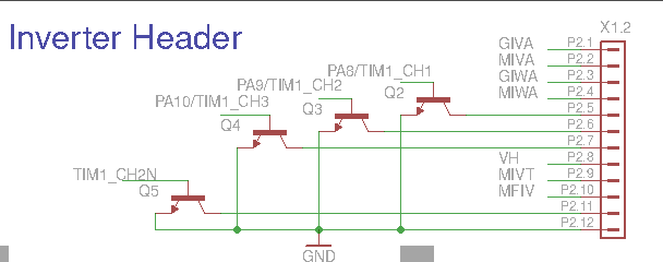

I found the diagram for the board, but it calls out Q1, 2 & 3 as drivers, but I can only find Q1 & Q2 on the board.
At least I know to concentrate the testing on the driver chip and resolver circuits :) Now if I only knew what I was looking for :(

Q3 is an oscillator or something like that. It is located next to the STM32 Pin 1 location. Rectangular.

Unfortunately that does not match the diagram I found (attached), not even close. From the diagram, Q2, 3 & 4 should be the PWM control connected to the inverter MUU, MVU & MWU, but shown on different pins than the production board. Guessing Q5 is for CPWM?
The good thing is I am not over my head in this, but just about :?

I have been over and over the board looking for abnormalities and finding none, I performed some voltage tests as suggested. However, the diagram I found for the V1.1 board was in the "Prius Gen2 adapter board" thread and does not match what I can find on the board.
Link: viewtopic.php?f=14&t=701&start=80
So I did the best I can with a DMM and aside from Red LEDs on my board, when the diagram seems to call for Green, the board itself seems intact. The only things I see wrong or odd are that there is no PWM from the STM32 pins 41, 42, 43 that I can see and from the diagram, MCU pins 19, 32, 48 & 64 are tied together, but the voltage readings suggest that is not (or no longer) the case.
