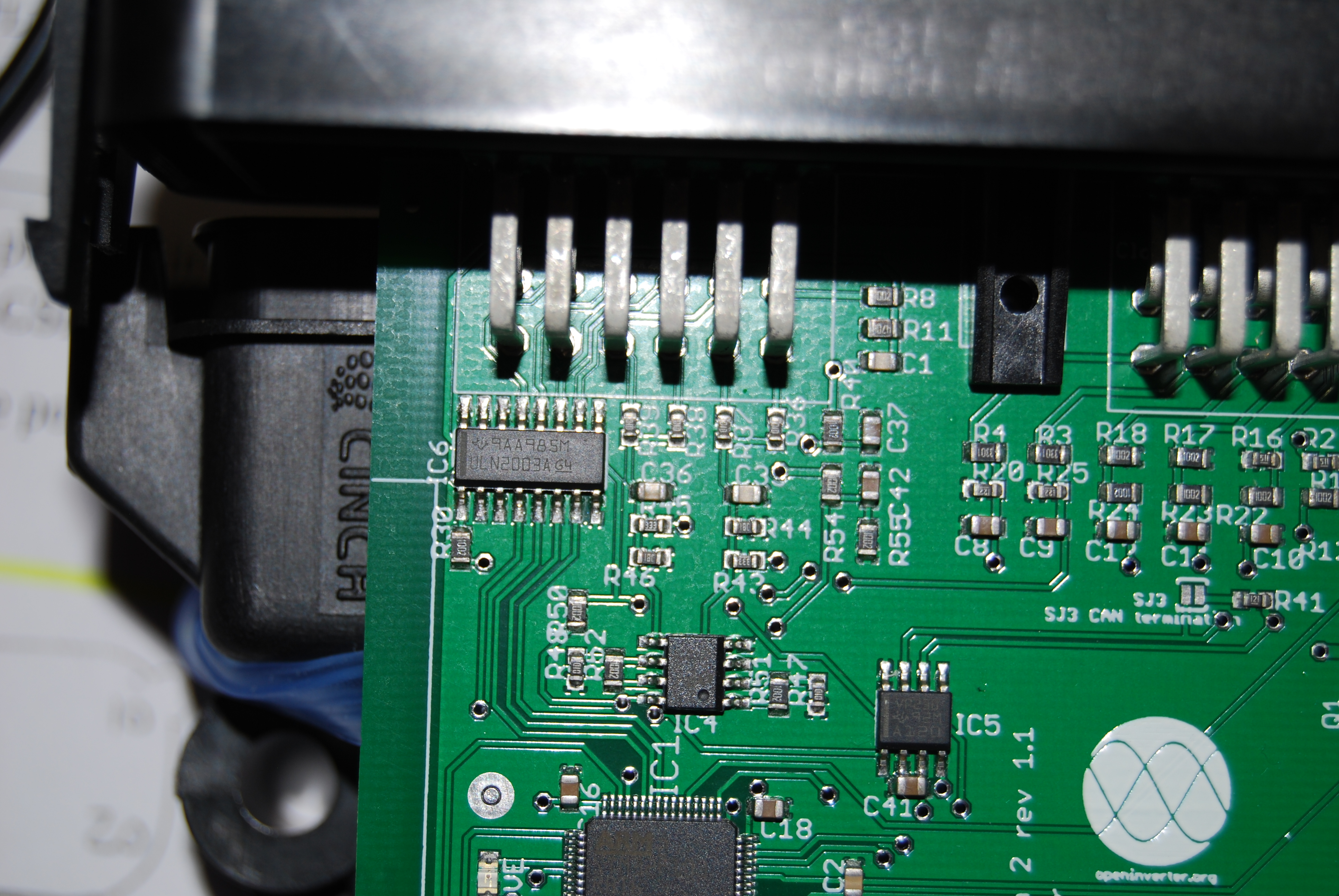

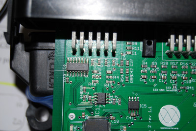

Does anyone know of a way to test the Hübner VCU control circuits to verify their functionality?
I get 16v from the Prius Gen2 inverter on MVU, MUU, MWU wires, but am not sure if the VCU is signaling. I have a meter that will read both duty cycle and Hz in the range needed, but am not enough of an EE to prove either is working or not.
I have tried connecting lamps to the VCU wires and +12v with no joy and placing them between the VCU and inverter with no joy, attempted to measure Hz (~7.6kHz) at varying VCU command outputs with no joy.
Ideas are most welcomed!

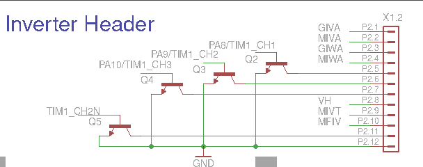

I found the diagram for the board, but it calls out Q1, 2 & 3 as drivers, but I can only find Q1 & Q2 on the board.
At least I know to concentrate the testing on the driver chip and resolver circuits
Now if I only knew what I was looking for
Same results, absolutely zero inverter output on MG1 or MG2 and the resolver circuits are not working, so I am pretty sure the VCU is damaged. Resolver wiring ohms out the same as before, I will take that as good news

Q3 is an oscillator or something like that. It is located next to the STM32 Pin 1 location. Rectangular.
Re: VCU or Inverter issue?
Well I'll be, thanks!
Unfortunately that does not match the diagram I found (attached), not even close. From the diagram, Q2, 3 & 4 should be the PWM control connected to the inverter MUU, MVU & MWU, but shown on different pins than the production board. Guessing Q5 is for CPWM?
The good thing is I am not over my head in this, but just about

I have been over and over the board looking for abnormalities and finding none, I performed some voltage tests as suggested. However, the diagram I found for the V1.1 board was in the "Prius Gen2 adapter board" thread and does not match what I can find on the board.
Link: viewtopic.php?f=14&t=701&start=80
So I did the best I can with a DMM and aside from Red LEDs on my board, when the diagram seems to call for Green, the board itself seems intact. The only things I see wrong or odd are that there is no PWM from the STM32 pins 41, 42, 43 that I can see and from the diagram, MCU pins 19, 32, 48 & 64 are tied together, but the voltage readings suggest that is not (or no longer) the case.
The below are all DC, I did measure the exciter/resolver pins 1-5 @ VCU connector and measured only a few mv ac or dc

I have a v1.1 Huebner Gen2 Prius board, no IC8 here and yes I can communicate with it just fine, read and write, it just will not "work". I see that not only did I lose the resolver/encoder data, but also that of the iL1 & il2 sensors

Ok, is this board similar to Damiens PriusG2_V1? Schematis can be found here: https://github.com/damienmaguire/Prius- ... ematic.pdf.
If it is, can you measure the DC voltage at the current sensor inputs, TB3 pin 7 and 8? With the inverter connected and no current.

No, there are very significant differences. The JH version uses all the Prius sensors and controls, but I can check the iL1/2 input voltage from the inverter.
Edit: I can see current data once I re-read the instructions, "Manual Run" DOH! But it swings wildly +/- 2A on both il1 & il2 and I am feeding it 2.5A, so need more power to figure out which is which.
