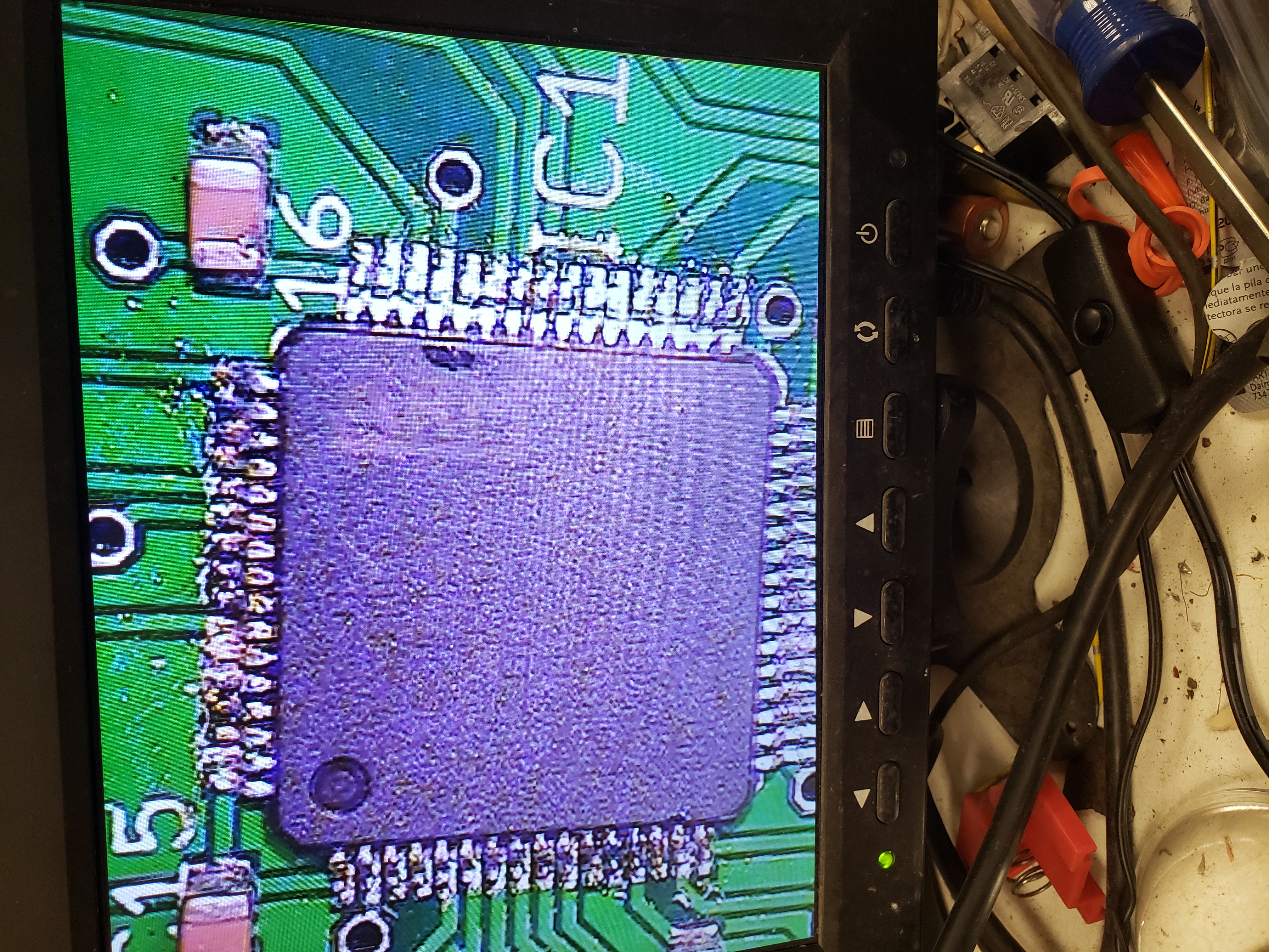

imwoody36
Posts: 92
Joined: Fri May 01, 2020 2:20 pm
Location: Scottsburg Indiana
Post by imwoody36 »
thanks " elon" while trying to figure out what pins are the sin and cos in to the STM32, I remembered this was one of the boards Johu had to rotate the chip.
so I reflowed it with hot air. and my symptoms are different... and maybe a little better. some circular jerky motor movement.
so, now I will go back and retest the polarity of the sin and cosine connections. you dont happen to know what pins I should scope do you?
I can likely go find a point to probe nearby.

imwoody36
Posts: 92
Post by imwoody36 »
update!
I can now plot a sawtooth, just like damiens in his youtube. the only change was reflowing the STM.
now when I attempt motor spin , I get a few moments before the contacters cut out and they wont restart until I power cycle.
no errors but Ive been up for 10 hours and maybe I should take damiens advice and ponder a bit.
is there a way to restart without power cycling?
Im assuming I need to play with W.C.U phases or perhaps sin cos polarity
does anyone want to see a tube video of the reflow under a microscope?

That is good news, did reflowing the stm32 fix the clipping present on the resolver drive signal?

imwoody36 wrote: Thu Jul 23, 2020 8:27 pm update!
Ok now we're talking. Lets ask ourselves some questions first before doing anything. why would the the contactors drop?
.....because we hit overcurrent limit........
.........why would we do that given that FOC firmware uses current control......must mean we are either not receiving the correct current readings into the stm32, or we are reading them incorrectly (not calibrated) OR we are reading the wrong current for that phase leg. Remember my fun with the Gen3 inverter where Johannes expects to be able to read the current on phase A and B but the Gen 3 inverter has current sensors on phases A and C!
Even if you have resolver incorrect (motor won't spin) it should still be possible to control the current into the stator via throttle. Once you get that happening THEN we mess with the resolver.
