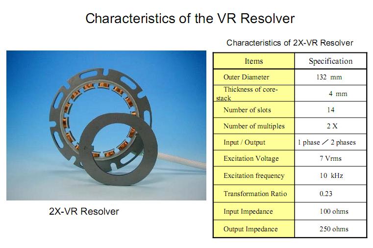

Posts: 6769
Has thanked: 384 times
Been thanked: 1589 times
Re: VW Squareback DIY EV
Good to know, want to place it in wiki? https://openinverter.org/wiki/Configuration_Files
I'm surprised about respolepairs=2 and polepairs=4. How did you arrive at that?

johu wrote: Fri Aug 28, 2020 1:31 pm
Good question, I found the data somewhere, I will find and post it.
<<MAJOR EDIT, I found it, it was Paul M Holmes who found it, linked video below. Other links removed as they conflicted each other.>>
<EDIT: I set the resolver to r=1/p=2 as a test and the indicated motor RPM was 2x faster than measured output shaft x gear ratio>
