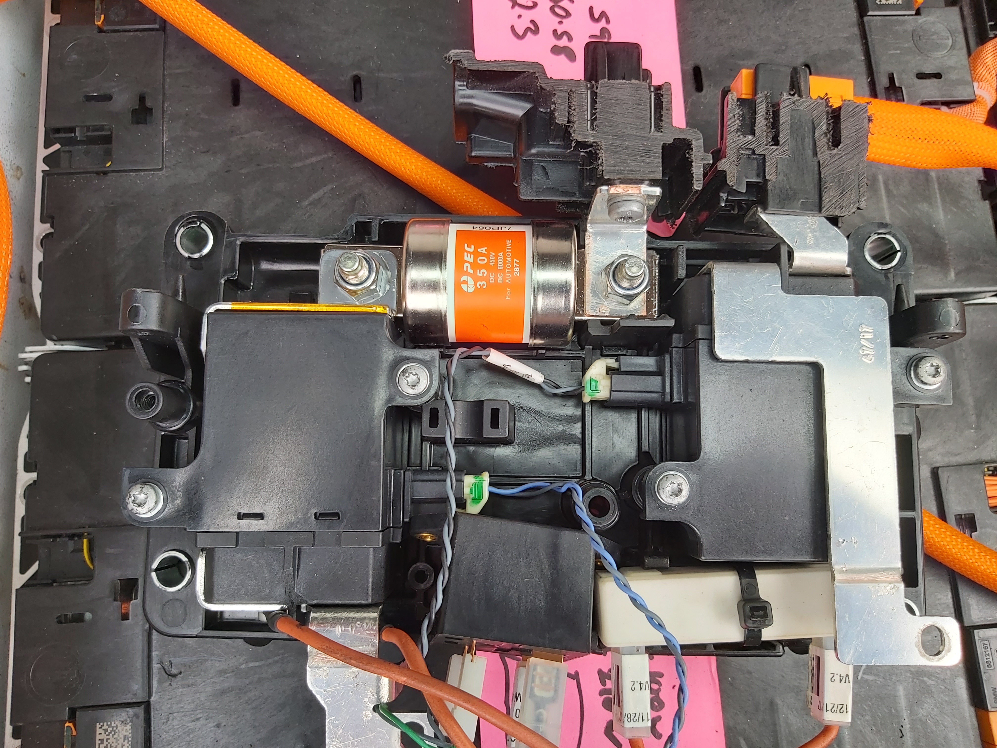

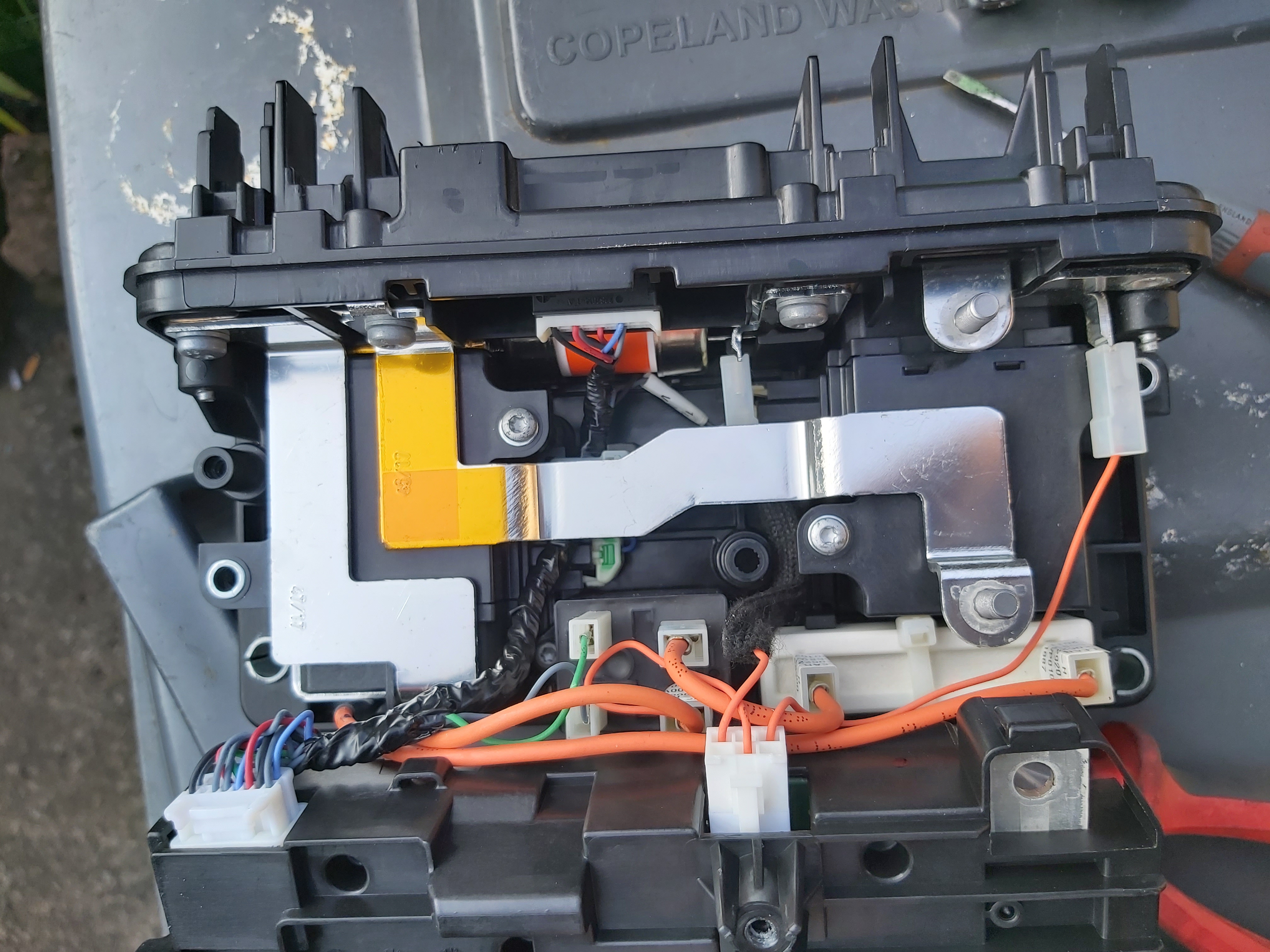

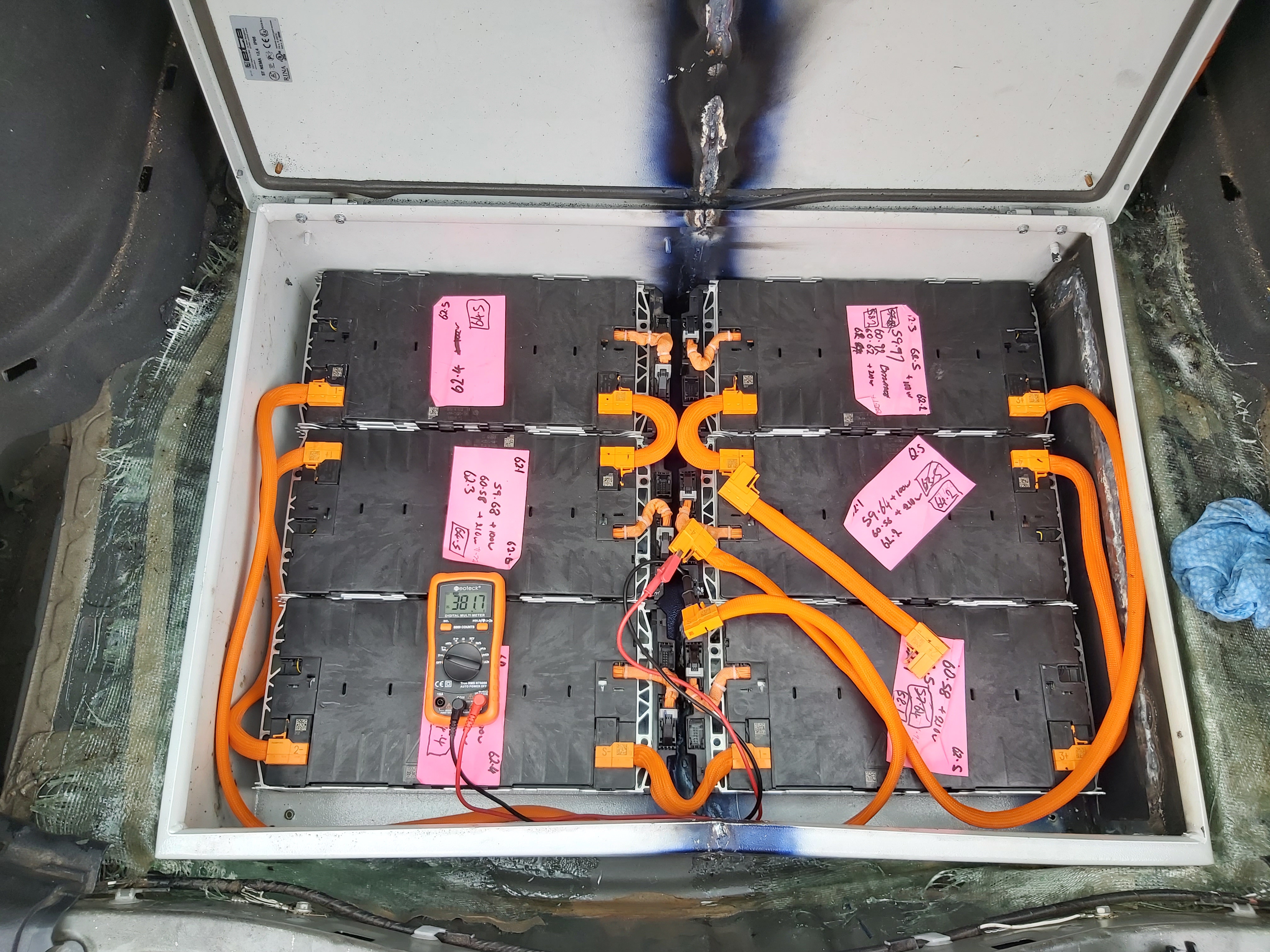

I am using the components of the BMW contact box for my project.
I had to cut down to fit in a smaller gap inside my battery box.
Also I cut off the plug in connections so that I can use the BMW connectors to connect to the batteries. I also drilled and re bent the copper bus bars to fit. I am going to fit 12 batteries in this box, two sets of 6 in parallel. One above the other with 40mm spacers in-between the batteries.
Does anybody have any suggestions how to do the connections? I was considering using two sets of contactors for each 6 batteries so that if one fails I should still get home.

Is there a Toyota wrecker nearby? If yes, try to extract the DC cables that used to go to inverter and to the battery. You will need access to the underneath of the wreck. I suggest this because these cables are shielded and higher temperature rating and 16mm2 or thicker. You should be able to get about 2m length or so.
