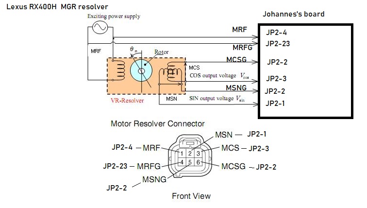

Is there anyone who could confirm the resolver pinout on this?
I have Johannes Gen2 Inverter board connecting to an MGR. Zookeeper, as you have the same setup, could you confirm which pin on the 6 pin resolver connector connects to which pin on the 20 pin inverter connector?
Re: Toyota MGR Rear Traction Transaxle
The ONLY change from the diagram is JP2-23 is pin 5 "R2" on the VCU.tom3141 wrote: ↑Thu Aug 27, 2020 3:57 pm Is there anyone who could confirm the resolver pinout on this?
Managed to get my MGR spinning nicely on 30V tonight
Thanks to everyone who has contributed to these discussions and the wiki. It’s meant that I can get up and running with it very quickly. I’m happy to start trying to put together a wiki on the MGR if people think that it would be worthwhile?
I’m using a Prius Gen2 inverter with Johannes smd PCB wired as per the wiki schematic. The resolver is connected as per Zookeepers post above and phases as per Zookeepers photo below:
I tried using the exact same parameters as Zookeeper but ended up having to change syncofs. With syncofs at 43500 it spun ok in both directions but would slow down and get jerky as I increased throttle input. It also span the opposite way to the way it should (forward when reverse selected and vice versa).
I then went through the wiki procedure for tuning syncofs and a setting in the region of 7000-9000 seems best. Interestingly about 32000 less than Zookeepers which would explain the direction reversal. It now spins the correct way and will spin up to around 1000rpm in both directions until I hit the current limit of my power supply.
