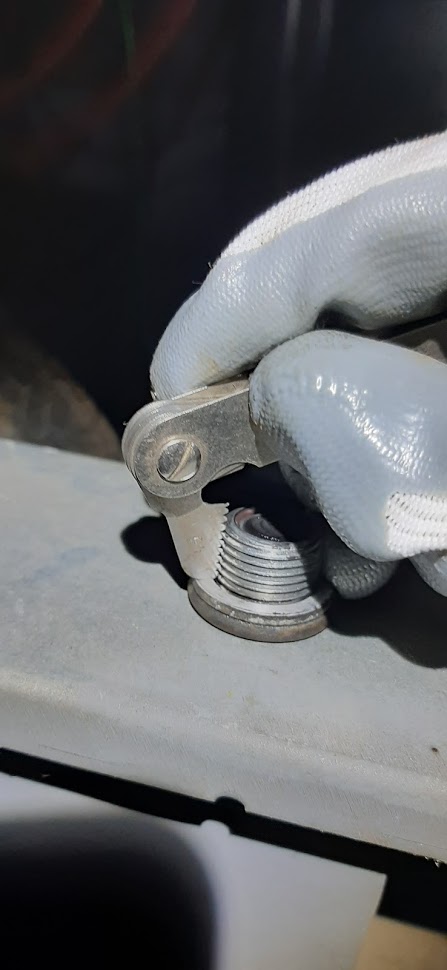

Jack Bauer wrote: Wed Sep 02, 2020 2:35 pm Anyone know the thread on the oil drain and level check plugs?
All three plugs are M18x1.5 Length 11mm.
Mouse
Posts: 138
Location: Wales
Been thanked: 7 times
Re: Toyota MGR Rear Traction Transaxle
Post by Mouse »
The filler is M18 by 1.5mm pitch and I haven’t taken the drain out but cant imagine it's different.

I was just coming back to say I don't know the diameter but definitely measured 1.50 thread count.
