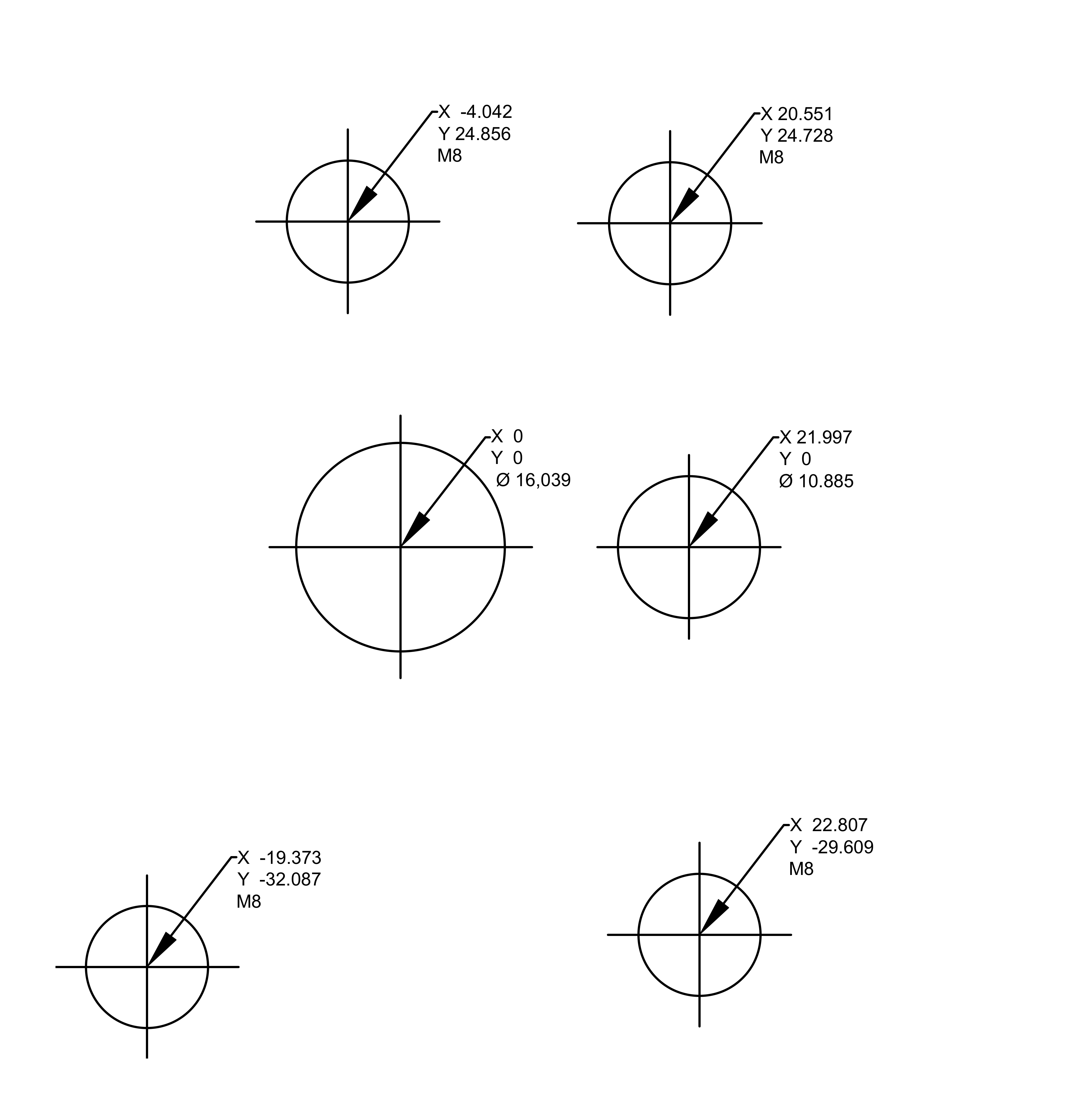

Im currently shopping around for a setup, having got a few prices back from some places, it seems one of the big costs is the Oil Pump, has anyone successfully used another more general purpose pump? I could easily mill an adaptor plate to fit the transmission.

Re: GS450H Discussion
If you do then please share the design.
You could try one of these : https://www.ebay.co.uk/itm/Genuine-BMW- ... Swl7pearYz
They are good pumps and typically last ~100k miles, rebuild kits are readily available too. I had to rebuild the one on my M5, they get dirty inside. I will look into this thanks. I was not sure if there was a required pressure that had to be sustained.Jack Bauer wrote: ↑Thu Sep 10, 2020 10:20 am If you do then please share the design.

Those seem to be a much more reasonable price - but some of them say SMG pump if searched for on the US site. Usually that is Pentosin CHF 11S that is flowing through that, I'm not sure if there would be any compatibility issues. But if so, $60 - 100 is better than another $700 just for a pump!Jack Bauer wrote: ↑Thu Sep 10, 2020 10:20 am If you do then please share the design.

The viscosity of the fluids doesn't seem to be massively different from what I can tell.
My only consideration is the SMG Pump does not run continuously on the S85 V10, the SMG only uses pressure to actuate the clutch and shift gears

Ah, I thought what I linked to were engine oil pumps for the S85?
You are absolutely right - my apologies, its one of the two scavenge pumps for the partial dry sump, at a glance it looked similar to SMG Motor. I will ask my friend who is breaking his S85 if he has a one for mates ratesJack Bauer wrote: ↑Fri Sep 11, 2020 7:12 am Ah, I thought what I linked to were engine oil pumps for the S85?
EDIT: After checking RealOEM it looks like this pump is also used on the transmission to circulate the transmission fluid to the cooler, should be a good candidate on paper.
