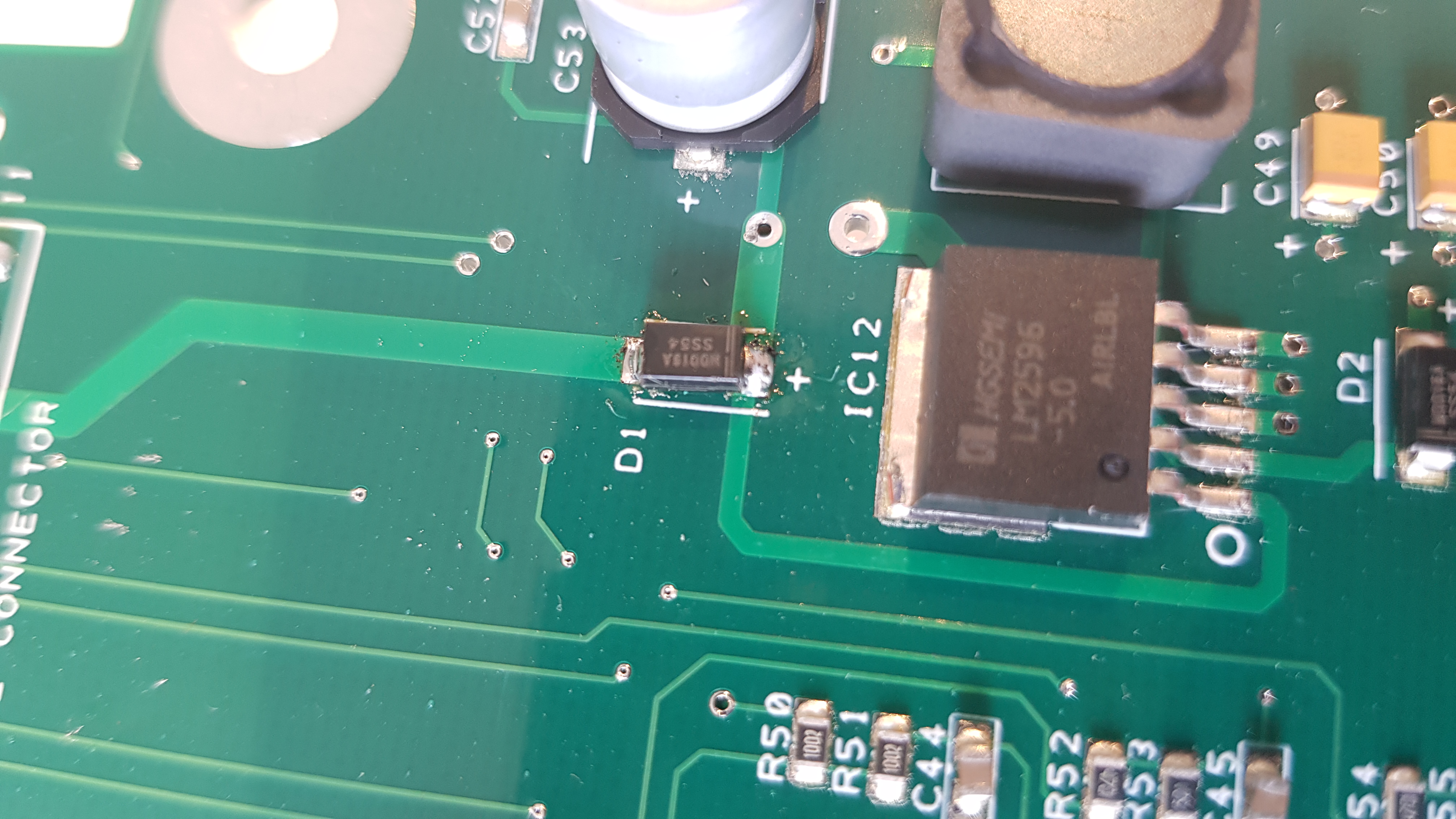

Hi all,
I think i found a small error on the V6 board.
The diode D1 needs to be backward ( ie the cathode of the diode needs to be on the side where the + is marked)
Picture of a warking board atatched
The other way arround doesn't work ( diode is blocking the 12V comming from Conn6)

Re: SDU Logic board V6
Yes true, I found out the same when testing the boards. All boards I ship have the diode corrected.
