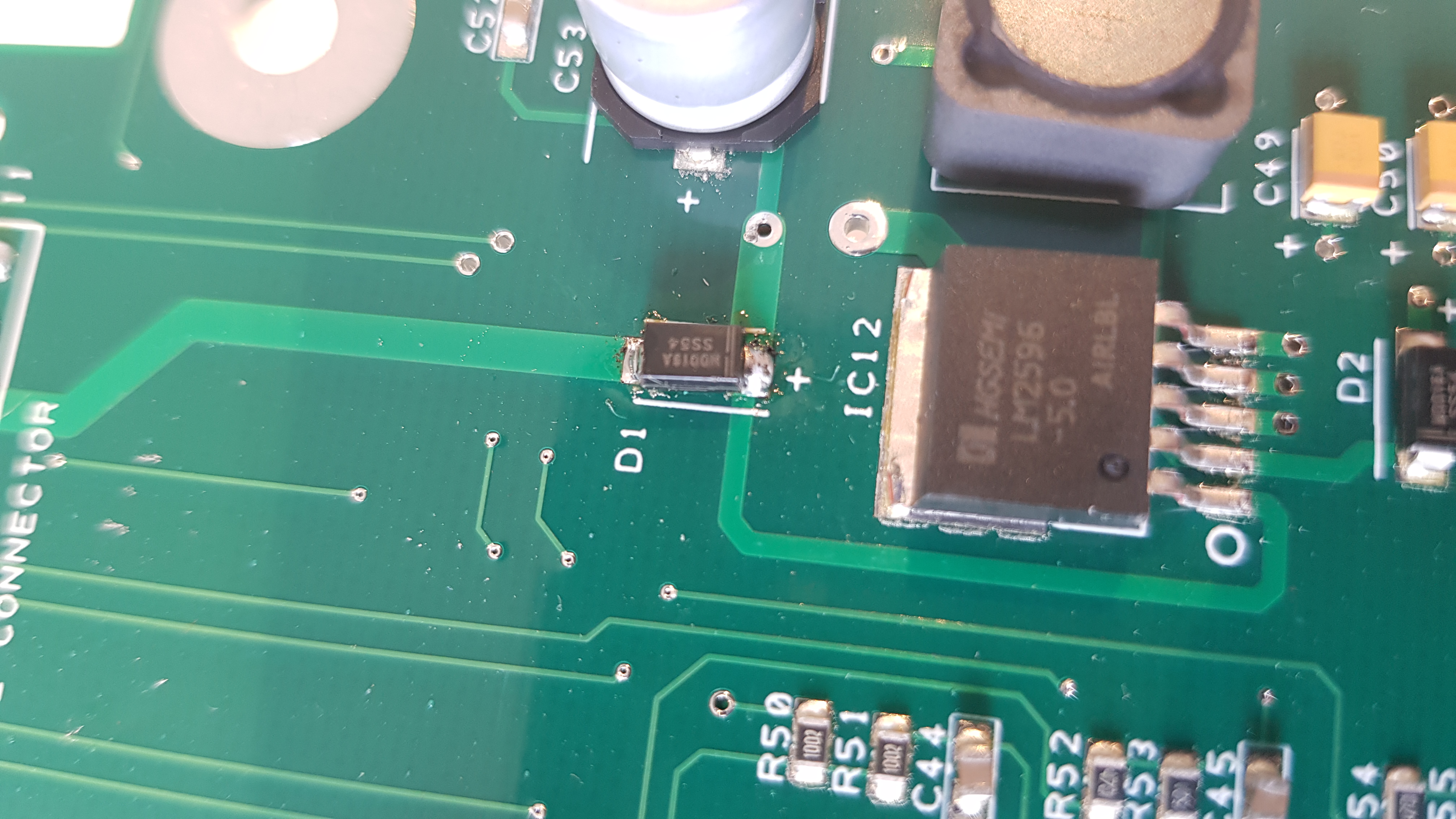

Hi all,
I think i found a small error on the V6 board.
The diode D1 needs to be backward ( ie the cathode of the diode needs to be on the side where the + is marked)
Picture of a warking board atatched
The other way arround doesn't work ( diode is blocking the 12V comming from Conn6)
Posts: 6969
Has thanked: 455 times
Been thanked: 1771 times
Re: SDU Logic board V6
Yes true, I found out the same when testing the boards. All boards I ship have the diode corrected.

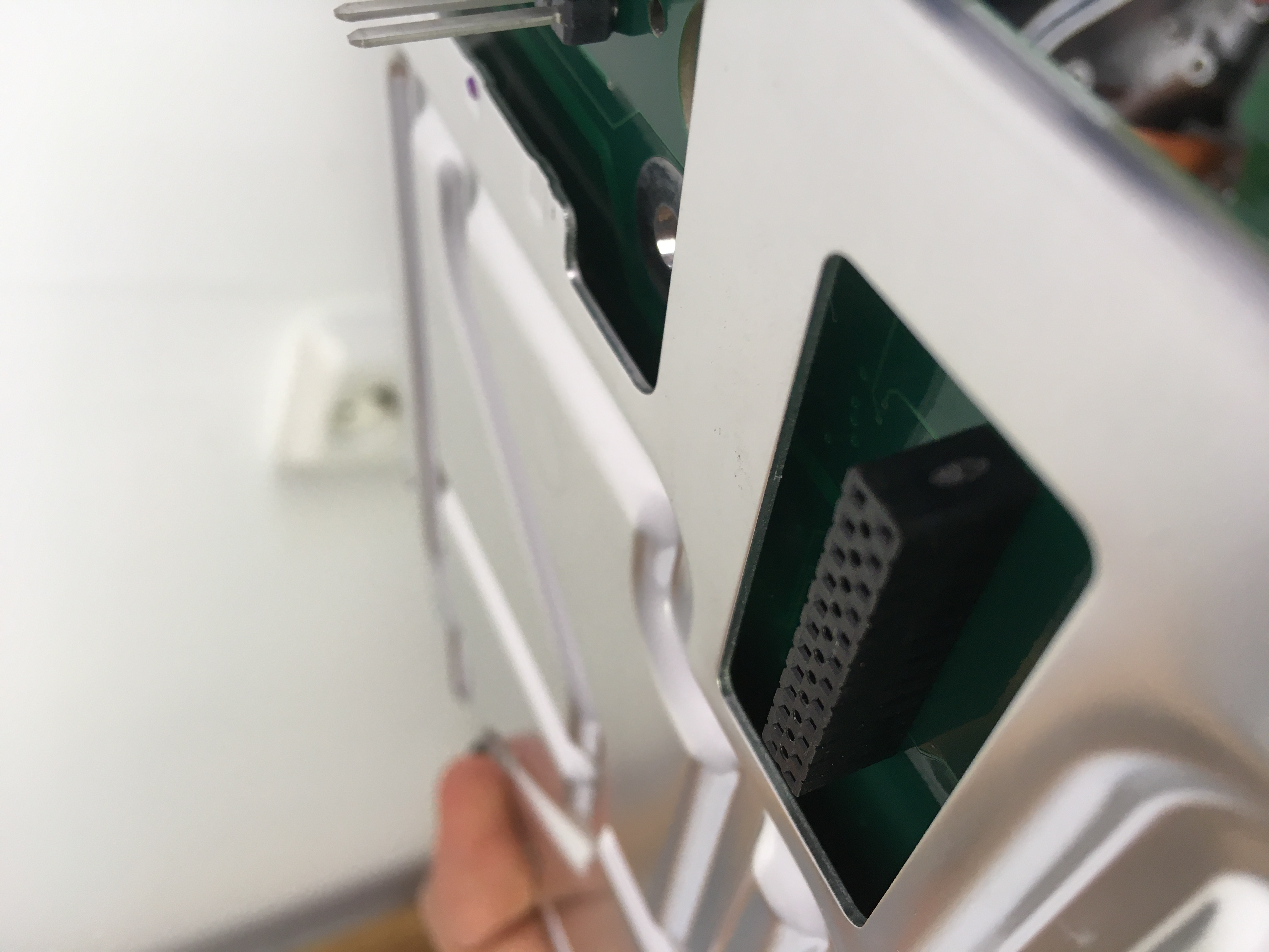

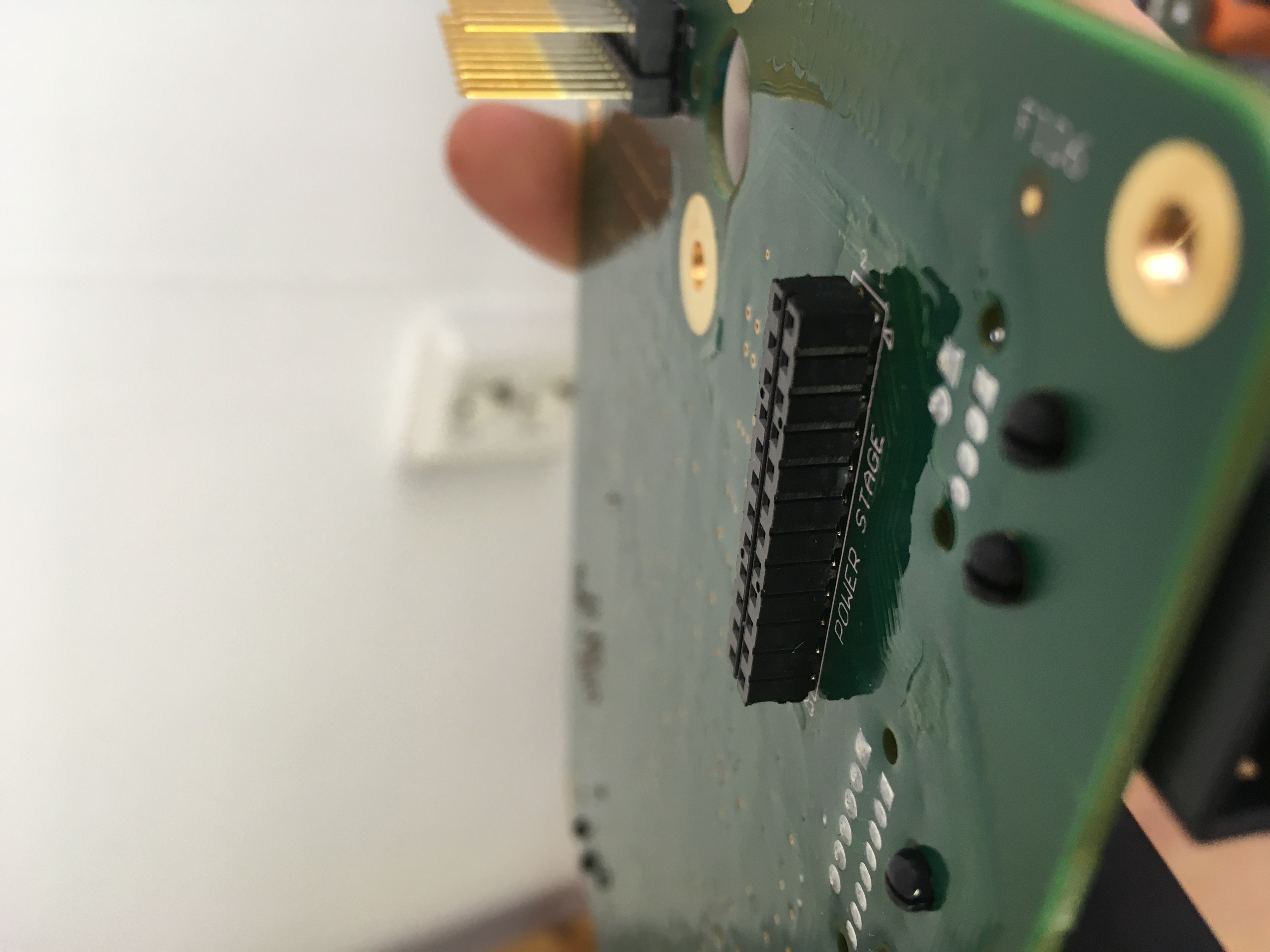

Post by ViktorT »
The ”powestage” connector in the open source logic board is a couple of mm thicker than the one in the original teslaboars. It makes it difficult to fit.
Alfa Romeo 147 with Tesla FDU and Kia soul pack
Posts: 6969
oh not good, must have sourced the wrong part. Sorry about the trouble, will fix it asap
Posts: 3831
Has thanked: 75 times
Been thanked: 696 times
If by thicker you mean longer then that's not a big problem. This problem was previously highlighted in the support thread. This is the actual connector tesla use : https://www.mouser.co.uk/ProductDetail/200-CES11201LD
