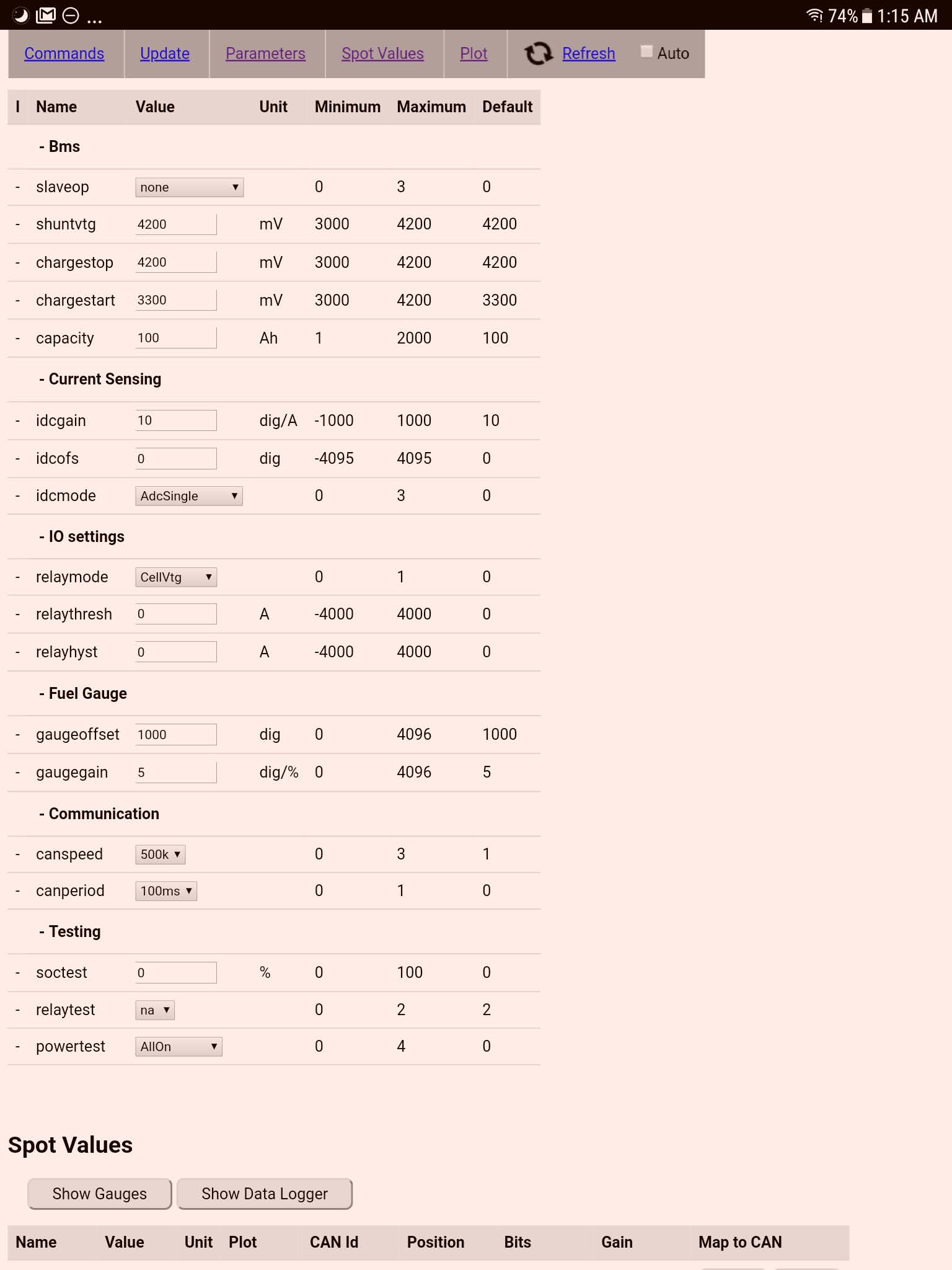

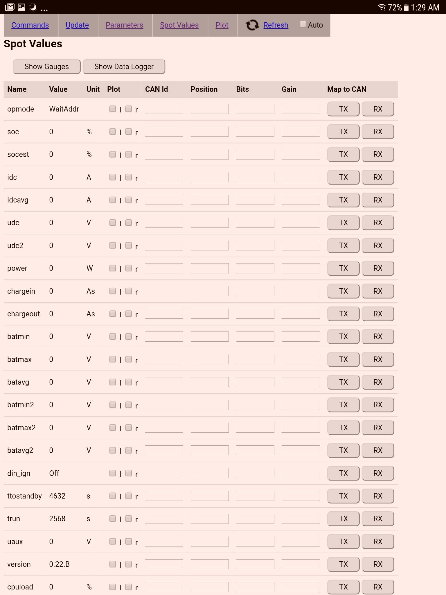

Everything was fine until I changed slaveop to FWUpgrade and now it's on WaitAddr again. Leds on first board are solid as long as it's connected to master unit.

Re: 4-channel BMS with daisychain bus
Oh, remote firmware upgrade gone wrong... just reflash the cell boards and you're back to good.

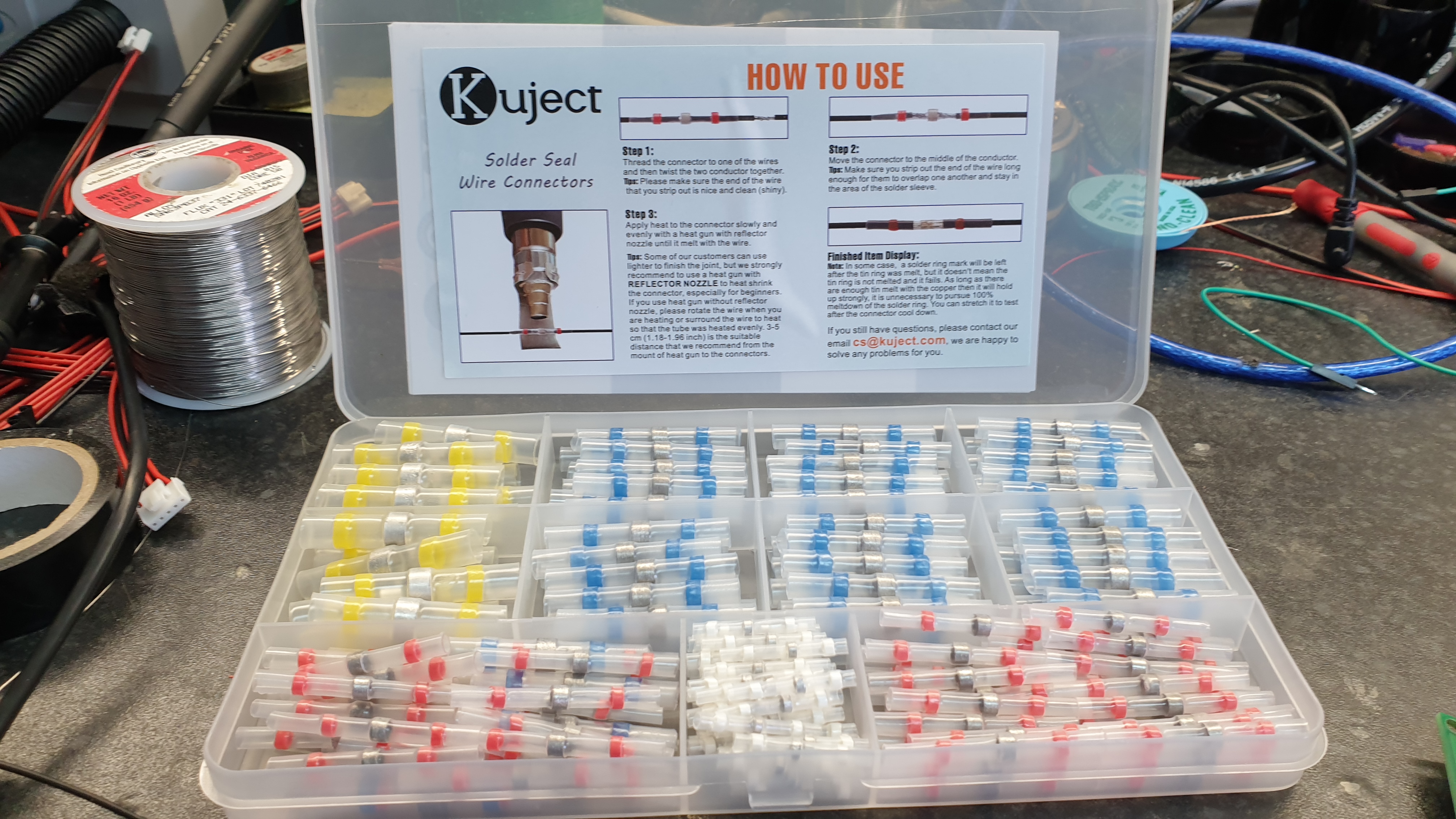

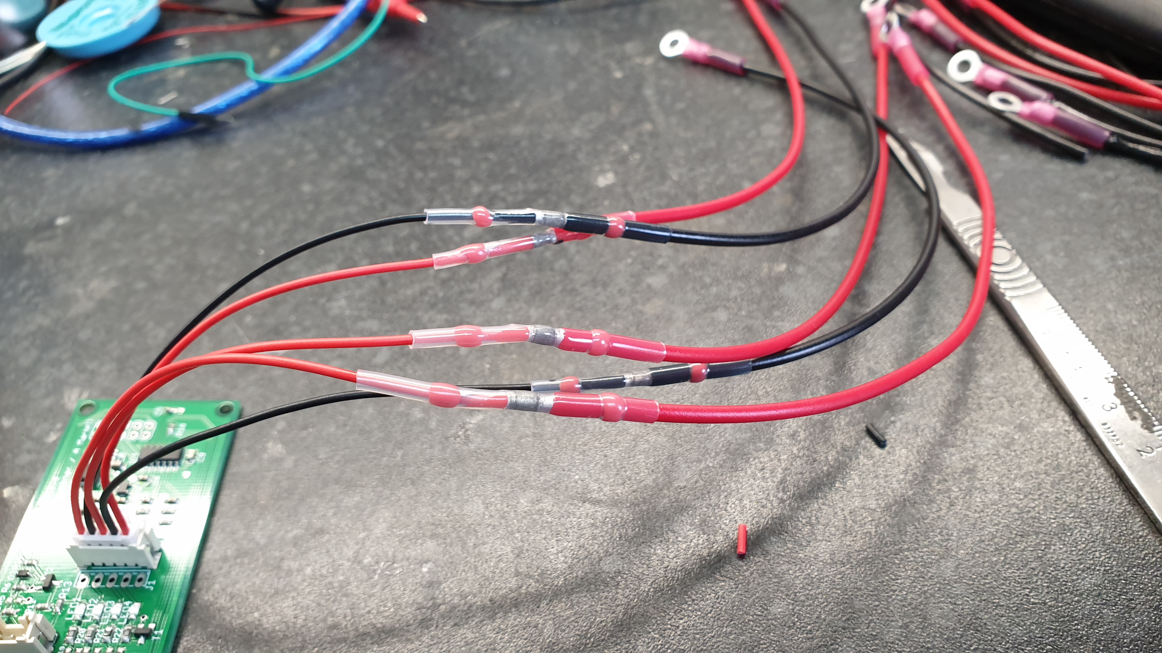

After agonising on how best to connect the bms wires to the slave boards I settled on these solder shrink connectors. Will see how they go the 2 x 100s packs in the E65.
You can also buy just the red or white shrink wraps.Jack Bauer wrote: ↑Wed Oct 28, 2020 10:33 am After agonising on how best to connect the bms wires to the slave boards I settled on these solder shrink connectors. Will see how they go the 2 x 100s packs in the E65.

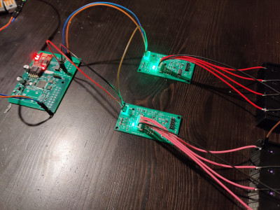

After couple of days of hard work programming and calibrating I was finally able to run first, somewhat successful test with CAN Isolator v2 and 2 Cell Modules v5.2 on 12s test battery pack.
It seems to work however I do not see any values from BMS reported in the "Spot Values" section on WiFi interface, all values show '0'
Modules seem to be addressing and communicating, so at this point I would expect to see some real values for Pack Voltage, average
and perhaps individual cells voltages.
I have no prior experience with OpenInerter platform and unified WiFi interface so I could have missed something.
Any tips would be greatly appreciated.
Did you do the oscillator-calibration correctly? It looks like the lights on the slaves are blinking in different frequencies.
It looks like the cell modules receive the "set address" command fine as they stop blinking. But the master does not receive it back. Can you try switching polarity from 2nd module back to master?
EDIT: I have also had trouble with filtering. You can try replacing R14 with 1M or 470k and removing C20 if still not working.
Success!
It was polarity as, silly mistake of me not checking it.
I am getting voltages of my 8 cells reported as well as averages and temps
Also, checked signal quality on the return channel (U6.4) and looks pretty clean, at least in this simple test setup. I will keep an eye on it as I expand system.
Next step is to update my calibration rig to get ADC calibration more accurate (just used series of resistors for this first test
) . I am good on clock/oscillator.
