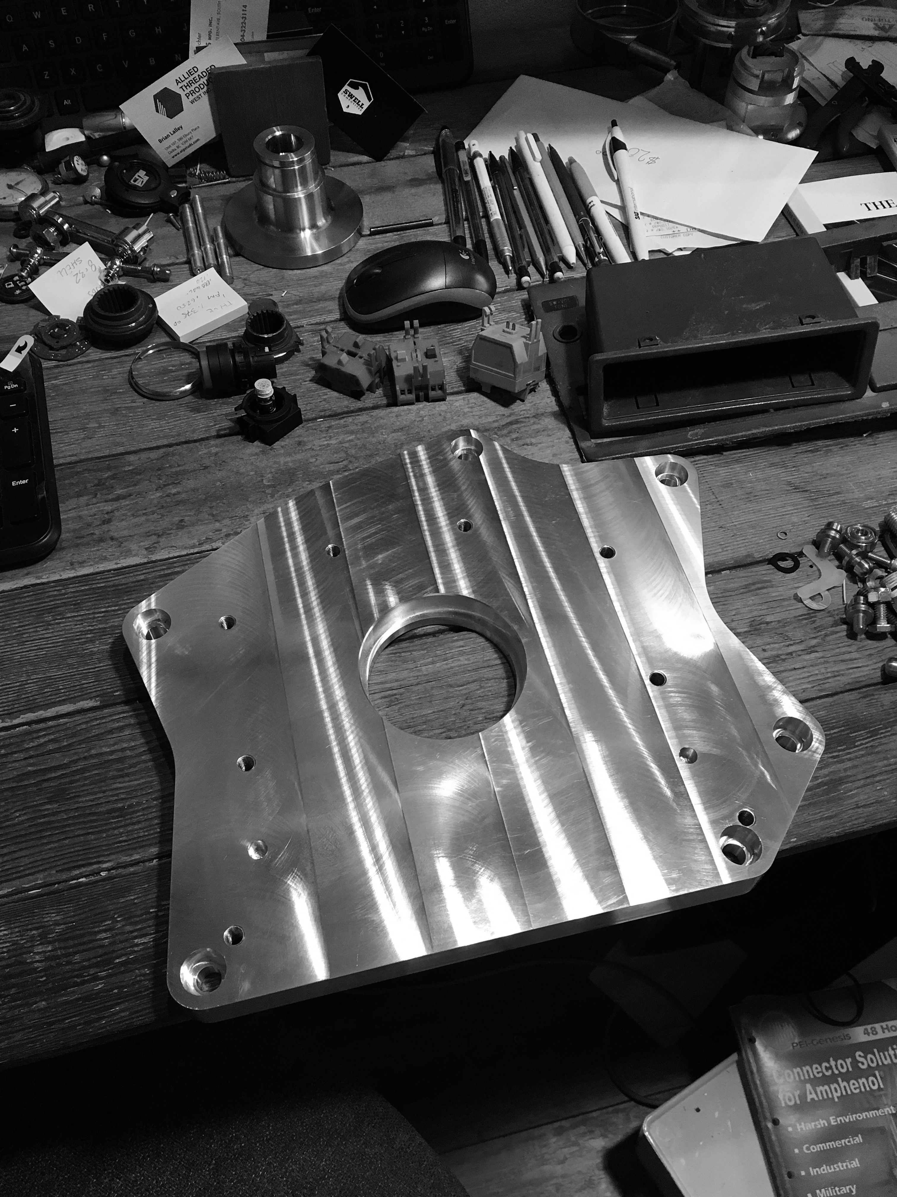

Now I’m back in full swing, things are coming together quick!
ampseal connector wired in to adapter board, mounts to the 3D printed file made for the Prius inverter. Few tweaks to make in the design, befor the fibreglass abs print.
adapter plate is done. Came out great!
Need to pick up the coupler bearing still.
then coupler gets mounted and locked in with A snap ring.
I picked up a used rotex off eBay for 40$. But it’s aluminum and a Gs28/38 ...so no dice there.
Either will find a steel gs38 then pressfit/weld the 4mt clutch center. Or get some steel plate laser cut.
With the plate method I’ll get a few made and can have a coupler for the modern awd subi tranys as well. Which will be almost a direct swap, other than a few minor mounting brackets.

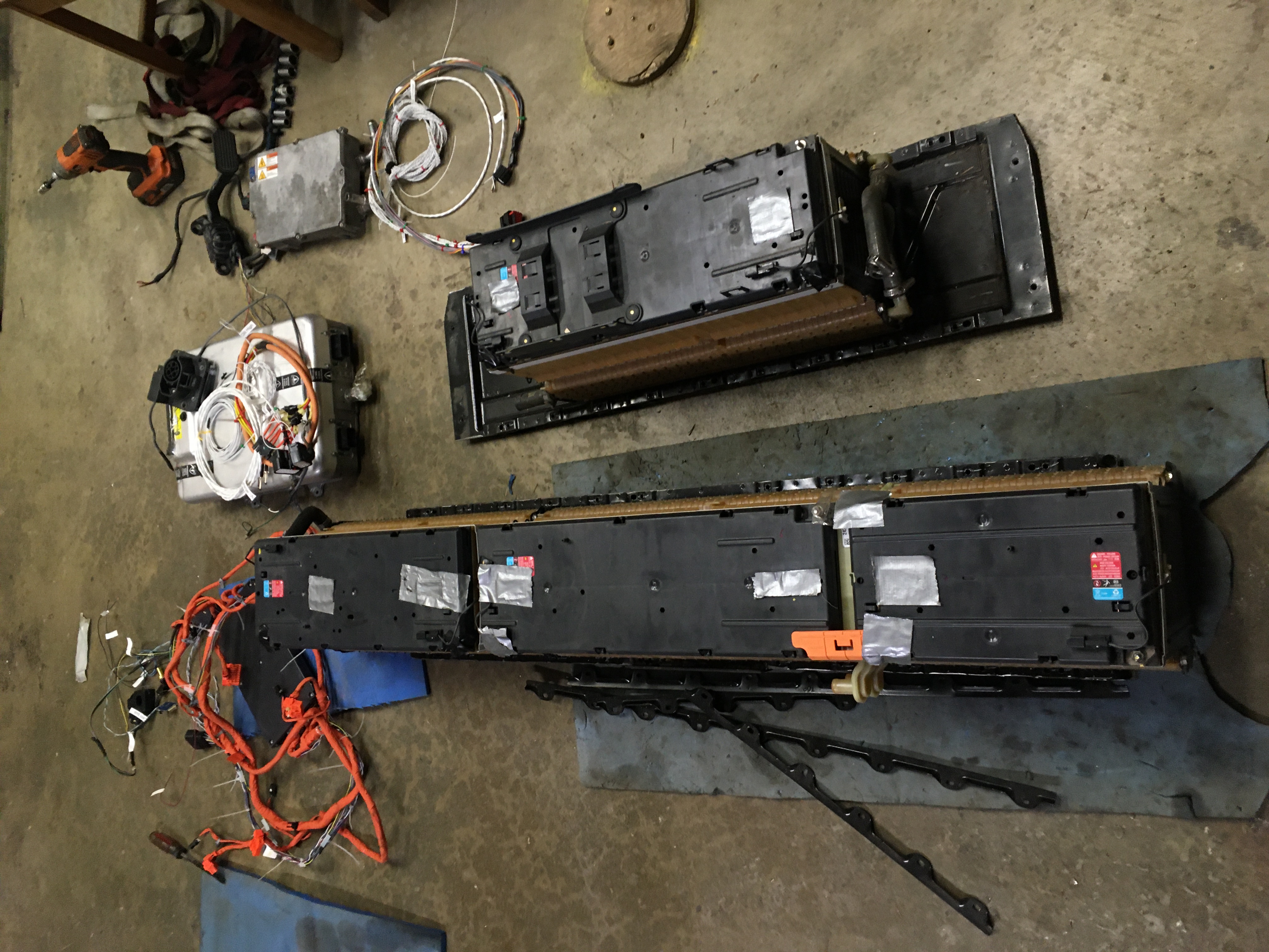

Picked up a second oem bms harness.
split/modded the loom to get the current sensor and power/communication set up.
next is getting the Gen2 bms to wake up and then start reading PIDs

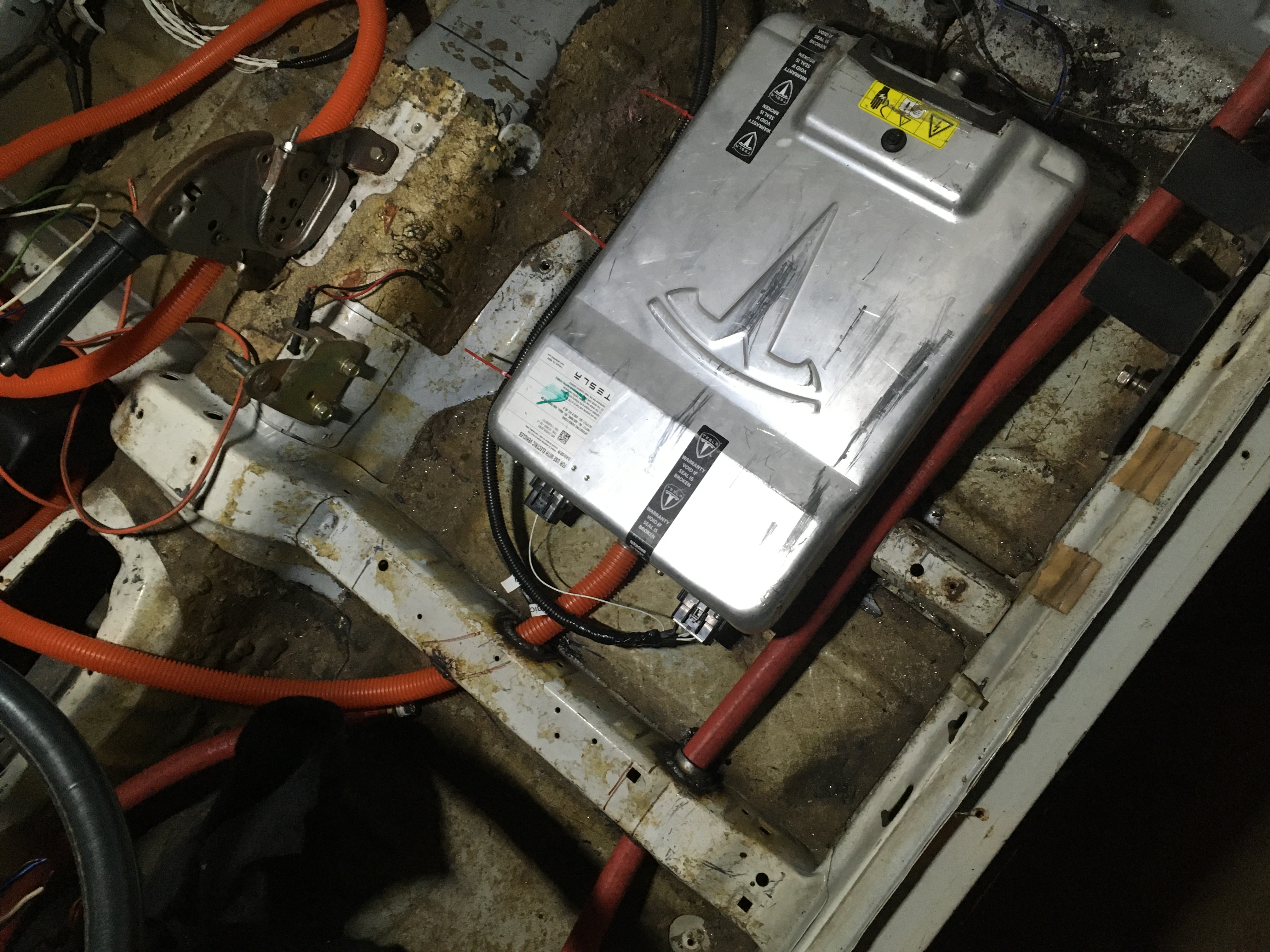

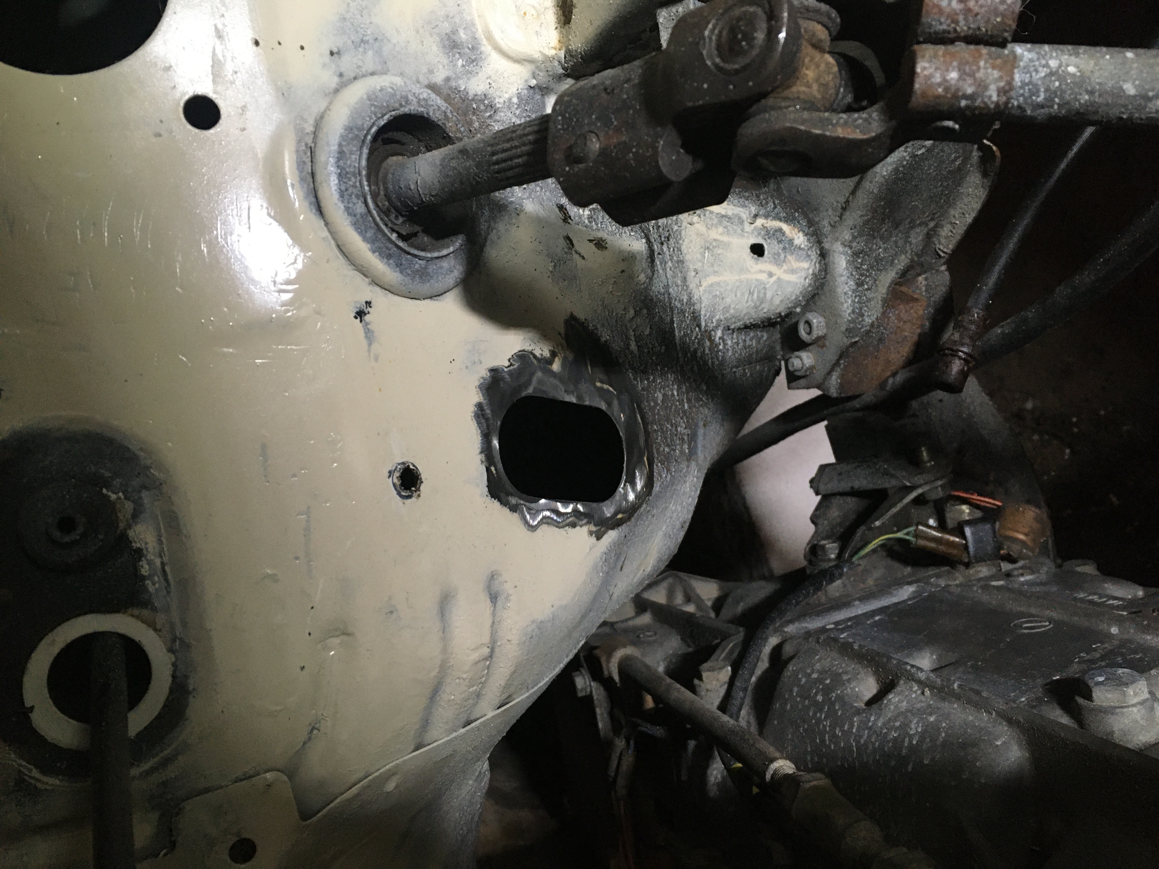

Throttle pedal mounted, heater core hole needed to be patched up. I’ll have to tackle re routing the heater core ports later.
inverter, charger and battery harness all ready. But more work to mount the battery trays.

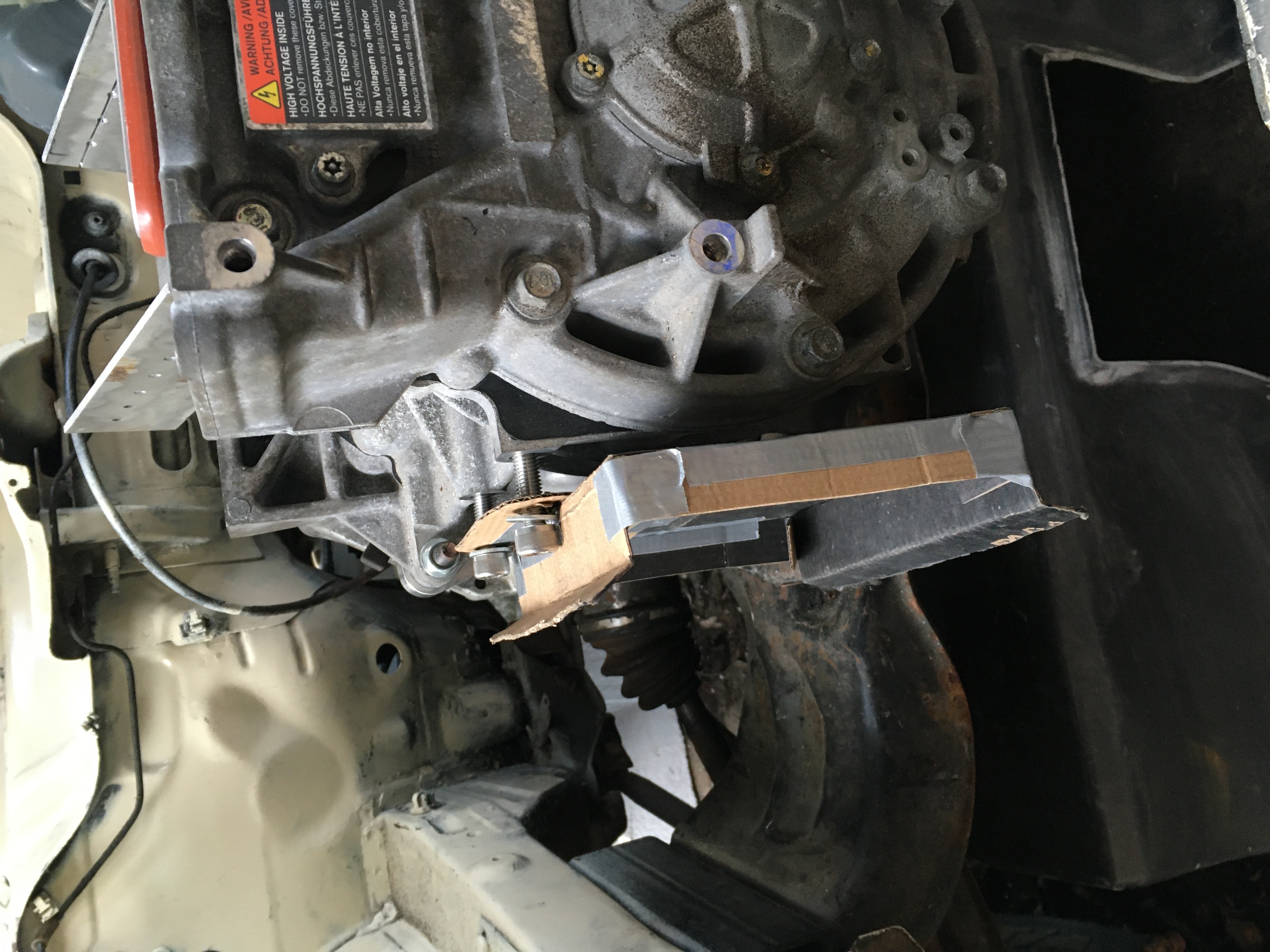

Re: 1983 Subaru BRAT
not really happy with the multi piece idea currently.
I found I could change the orientation of the coolent pipes with applying blow torch to them for a few seconds. Then with some leverage, they’ll spin.
brackets to mount the tesla dcdc converter to the side of the motor. trying to keep weight low, and central.not really happy with the multi piece idea currently.

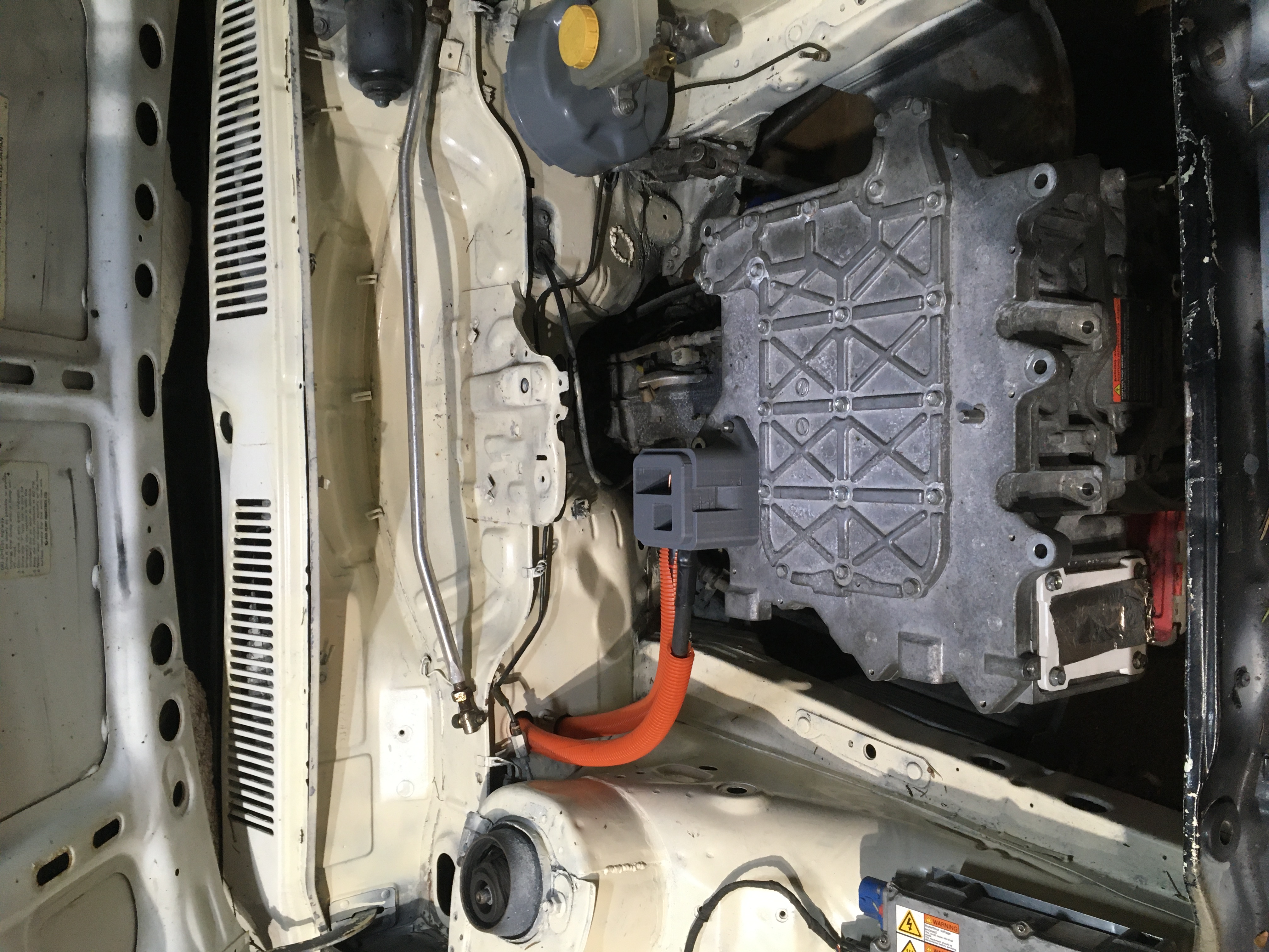

cabin battery pack is merged thanks to some very long pieces of 1/4in threaded rod.
almost done the rear/underneath box for last battery module.
finishing off a printable shrouded for the power input on the inverter.
Space is tight! Seat and trim clears with in mm!

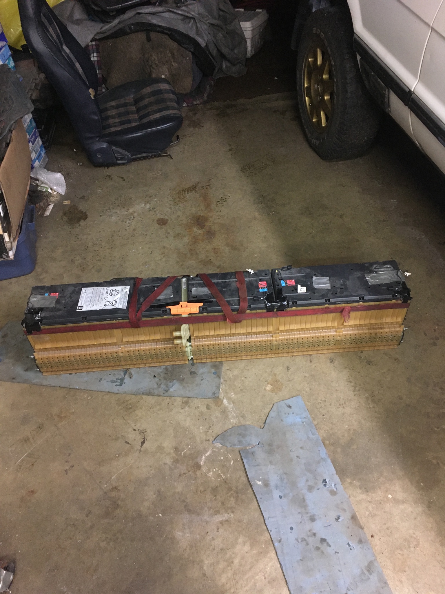

Life has been busy, but got first full fitment of batteries in. The T section of the Gen2 Chevy volt battery tray was cut off and I welded up a frame which bolts up underneath the bed of the brat.
Had to increase the rear subframe/torsion tube to a 4in lift. As in the middle of the crossmember is the torsion bar adjuster. I picked up a very rusty parts car, which came with 2 rear suspension clips. so later down the line I’ll remake the entire cross member so the torsion adjuster is out of the way, with out significant lift blocks. (Which will get linkd)
A few more brackets to make and the battery will be fully supported. Temporary ratchet strap loopd across to reduce cantilever forces...
New crossmember gives me the added bonus of increasing the trailing arms by 3-4in. just like vw baja bugs!
the other section of the battery tray was modified to bolt in to a series of points behind the the seats in the cab. there was just enough space to make one long batter module fit here. So that opens up space for another 3.1 kw module in the rear hanging tray. so on the hunt for a second pack

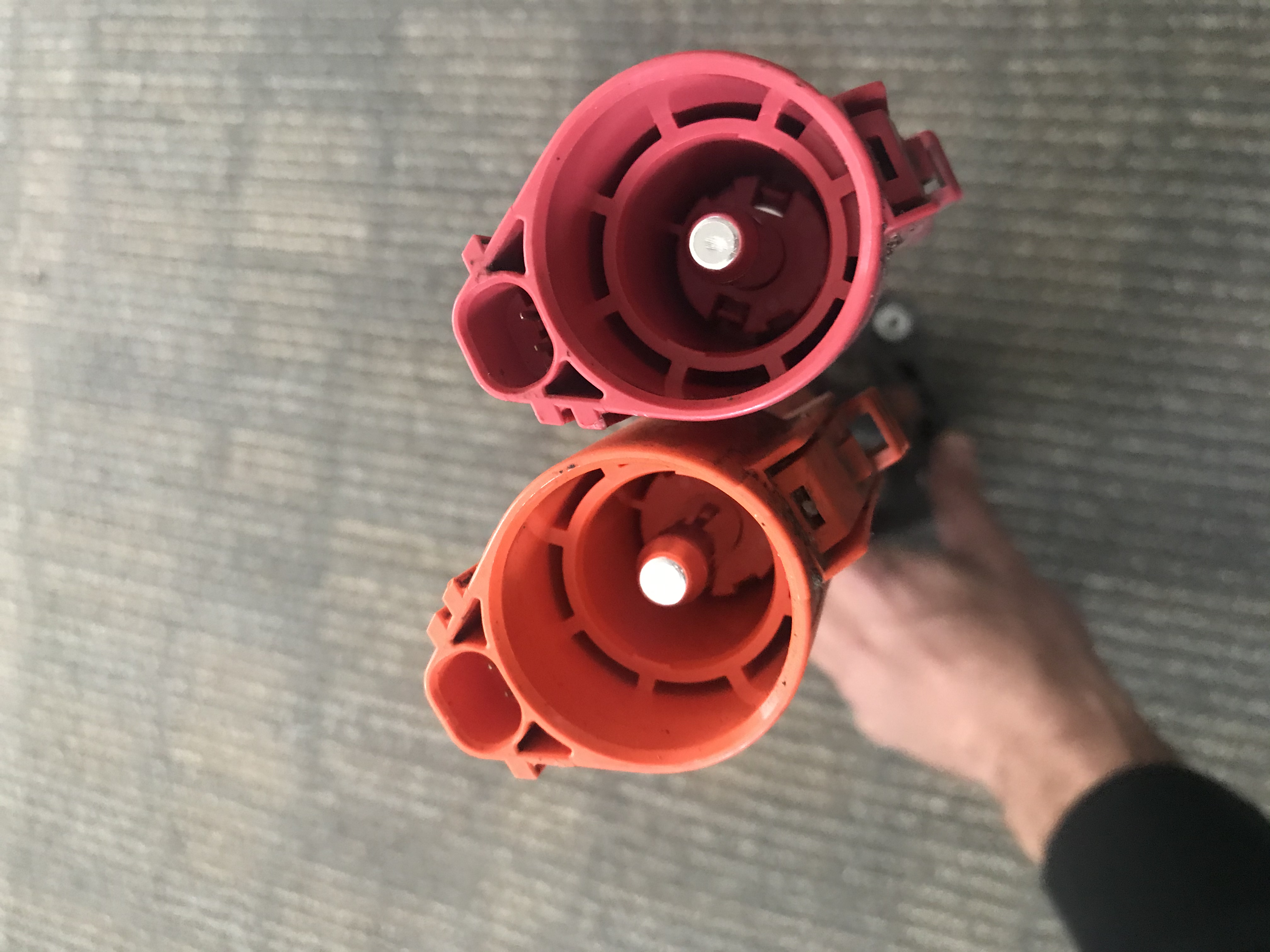

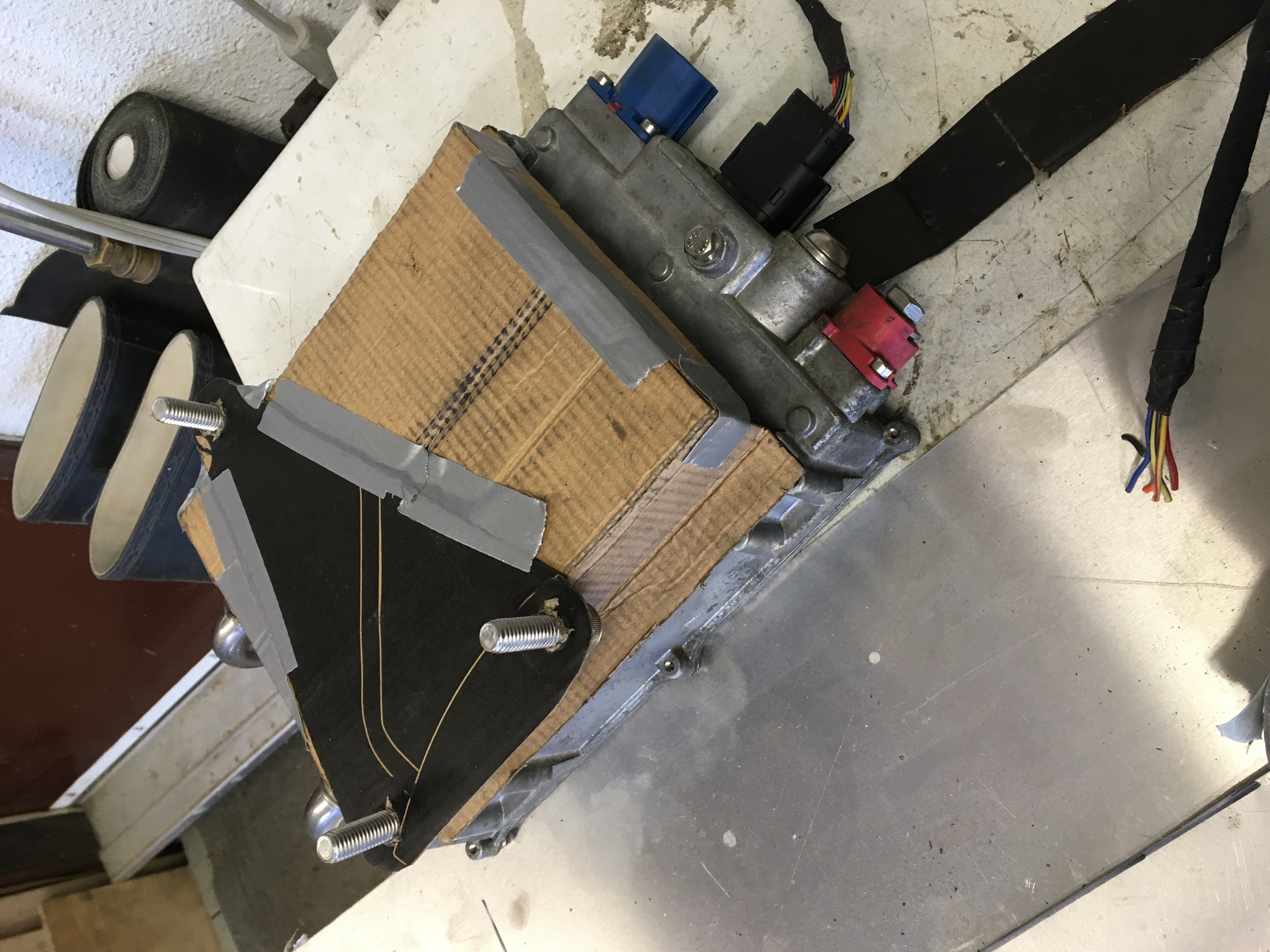

Chevy volt gen1ibooster bolted right in, after drilling 2 holes and rearranging the booster assembly. Tight fit!
After some digging it looks like both gen1 and 2 ibooster use the same main connector, “1928405762 26-WAY BOSCH CONNECTOR” but different pressures transducer connectors.

yeah the pedal sensor connectors looks like they are different, based on info from lars and others around the web.
found a source for the 26 way connector: https://store.chiefenterprises.com/1928 ... -Connector
Then found this thread from diyelectriccar, looks like some folks have had success ordering from them:
https://www.diyelectriccar.com/threads/ ... st-1034057
the volt ibooster version has only two bolts, and uses what seems to be 9/16-16 iff brake line threads

spent on time on the lathe and whipped up some brackets for mounting the ibooster.
instead of using the volt’s master cylinder that came on the ibooster, I made an adapter for a Subaru one.
This keep the hydraulic ratios properly matched, and no custom brakelines!
That fancy machined aluminum look
Everything on the ibooster was metric m8x1.25 threads.
The pushrod from the brake pedal is m10x1.5 thread. Just used a coupling nut and threaded shaft to the brats original clevis.
I had to existent the internal pushrod(the one that pushes the master cylinder) in order to get the proper pedal-to-master cylinder engagement. I just used a 60mm m6x1.0 socket head cap screw.
