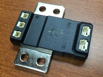

And to make sure everyone is on the same page in terms of what we will be getting. It's
a) The 500A = IVT-500-U3-I-CAN2-12
b) The 1000A = IVT-1K-U3-I-CAN2-12
So this means:
- 500A or 1000A nominal
- 3 channels (probably will not be used in most setups, but perhaps gives more flexibility in the future)
- No CAN termination (it's easier to add if needed than be stuck with it if you don't)
- 12V nominal
Update: wrote earlier that the non 3-channel version might be an option but it is not so 3-channel it is (thanks Damien for your input).
larsrengersen
Posts: 171
Has thanked: 16 times
Been thanked: 36 times
Post by larsrengersen »
Ok, guys, I have placed the order at ISA and received an update on price and availability.
The good news is there is a discount and the 1000A is in stock. The bad news is the 500A is not in stock.
I have chosen to split the order into two shipments.
The 1000A is expected to arrive at my place in a week, the 500A is expected in the first week of December.
The discount I can provide for the 500A = 29,30 and for the 1000A = 23,62
I have rounded the 5% kickback for Johannes and Damien to 10 per shunt. So the 500A is overpaying a bit, but these got more discount.
So that means:
500A = 192,15 + 6 for the connector kit = EUR 198,15 ex VAT
1000A = 208,42 + 6 for the connector kit = EUR 214,42 ex VAT
Obviously they cost more in my webshop so I will individually e-mail vouchers so you bottomline pay the above price (+shipping).

The 1000A IVT's are in and the connector kits are ready.
I have e-mailed the people who have ordered the 1000A version and provided a voucher so you pay the above price.
I have dedicated stock reserved for the group buy so you can place a backorder (if the shop says there is no stock) and I will be able to ship yours out.
larsrengersen
Posts: 171
Another update. There is good news and there is bad news.
Let's start with the good news: the 500A shunts are in
The bad news: I've shipped the wrong connectors with the 1000A orders :(
I've been bouncing around with the connectors before. Do we need 5, do we need 6?
Turns out I've been mixing up datasheets and models.
The old model has 6 connectors and uses JST.
The new model has 5 connectors and uses Molex.
And I've bought a bunch of JST not realizing the new ones need different ones.
Will dive into it and get back to you with a solution (refund/extra delivery/....).
