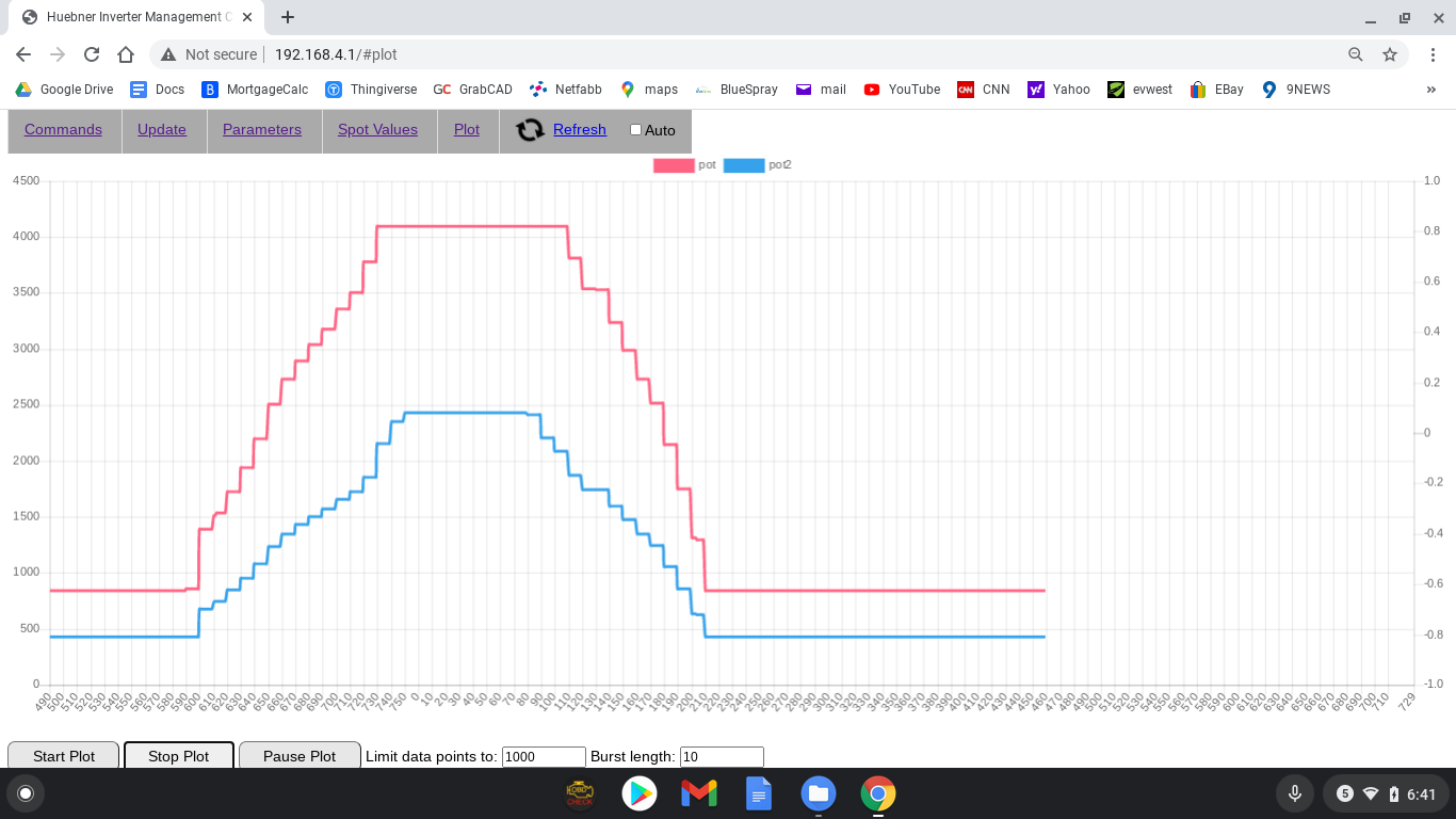

Here's a successful plot of my dual-channel throttle and potnom values I was seeking in the first place.
Dual channel throttle and potnom
