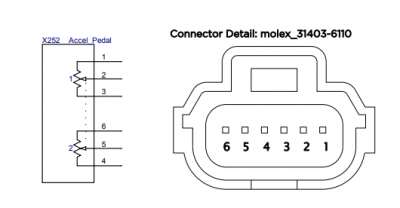

Only thing is that it won't let you measure the resistance so it's not only a simple pot in there...
This is the pin out for reference.
Voltage 0.7v to 3.8v approx.
1= Ref.
2=Sign
3=Return
4=Return
5=Signal
6=Ref.
Note: See the swap of polarity on the second set!

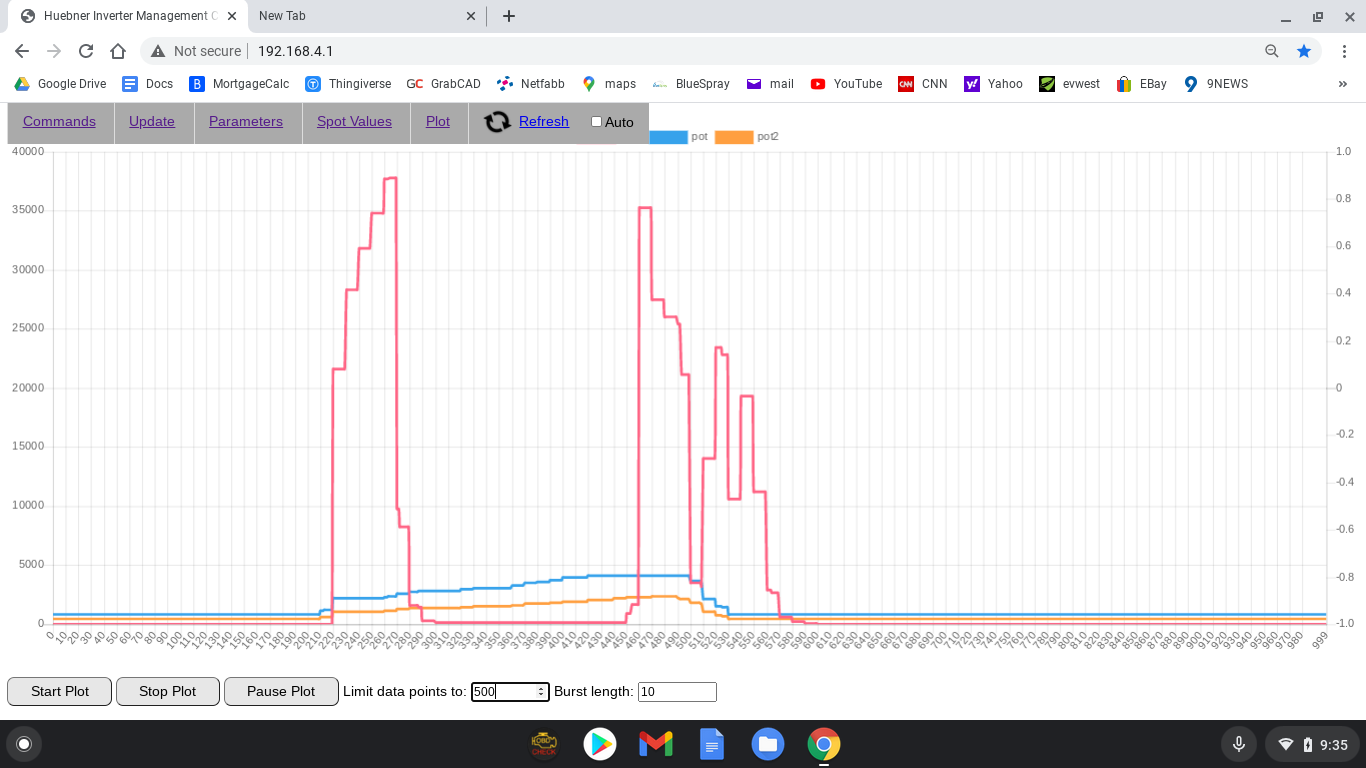

I'm having a weird problem with my throttle pedal while bench testing LDU at 80volts.
Dual hall effect pedal from old maxima, with two pot channels test and plot perfectly.
I configured the dual channel potmode for throttle signal redundancy, calibrated the two pot signals, everything seems fine, running motor, etc...
The problem is, there's a giant dead spot in the middle portion of throttle travel.
I've run a plot showing both throttle pots rising slowly as I depress the pedal VS amps to the motor. there's a deadspot thru the major central part of the travel, and it feels software induced. What am I missing? I did need to reverse the direction of motor rotation, is a side effect of that?
Is it a parameter problem? I've attached the plot and the param file if anyone has any chance to look, I'd be very appreciative.
Thanks-john
Blue=POT Brown=POT2 Red=AMPS
params.json
(1.17 KiB) Downloaded 451 times
Been thanked: 1918 times
Re: Throttle Pedal
The parameters ampmin and slipstart are your friends.
First try lowering slipstart in 5% decrements, maybe down to 30% and see if that fixes your problem. Then you can also try raising ampmin like up to 10%

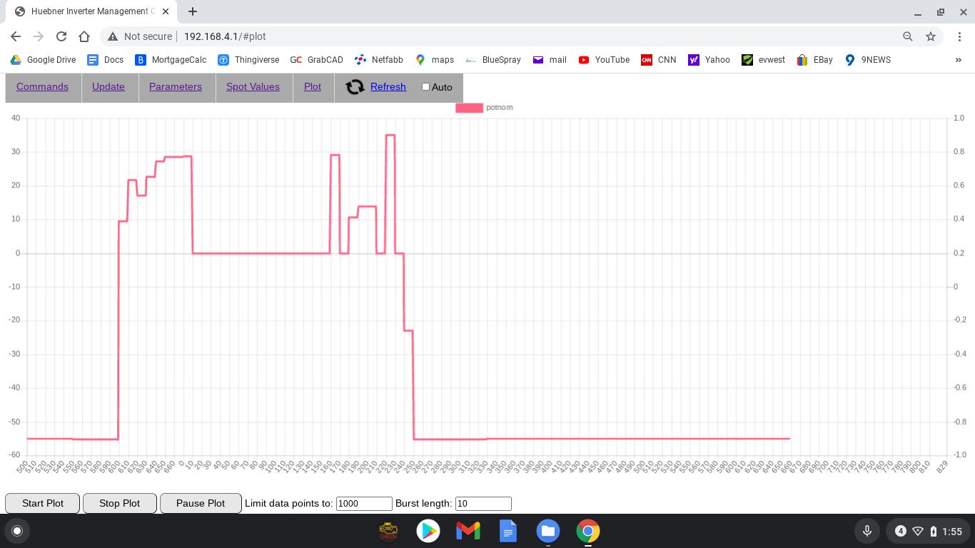

Plotting DualChannel potnom shows a problem with POTNOM, maybe the pedal I'm using doesn't stay within the required offset tolerance between the two signals , thus becoming invalid unless they align -more closely- at the beginning of pedal travel, and at the end... just not in the middle.
Ive attached plots both singleregen and dualchannel POTNOM, for what they're worth...And I've ordered an E46BWM pedal in hopes of finding the proper pair of signals. Is there a tolerance setting between these signals to accept some slop in the paired signal offset?
SingleRegen POTNOM plot
DualChannel POTNOM plot

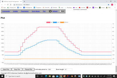

Here's a successful plot of my dual-channel throttle and potnom values I was seeking in the first place.
Dual channel throttle and potnom
