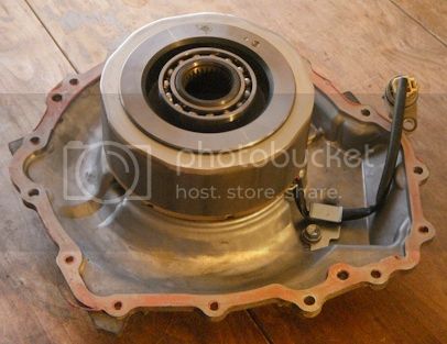

Looking at these pictures Kevin posted earlier it seems like you can run the motor on its original bearings without any of the rest in place. My hope is that I can replace the now exposed inside bearing with a sealed variety and have it do double duty as oil seal.
I'd then tap the oil channels between motor and gearbox and either block or use them as an oil feed/drain with an external pump.
Independent suspension would definitely be the optimal route, but would be a fairly major operation. I think if it came to that I'd give up and buy a new motor.

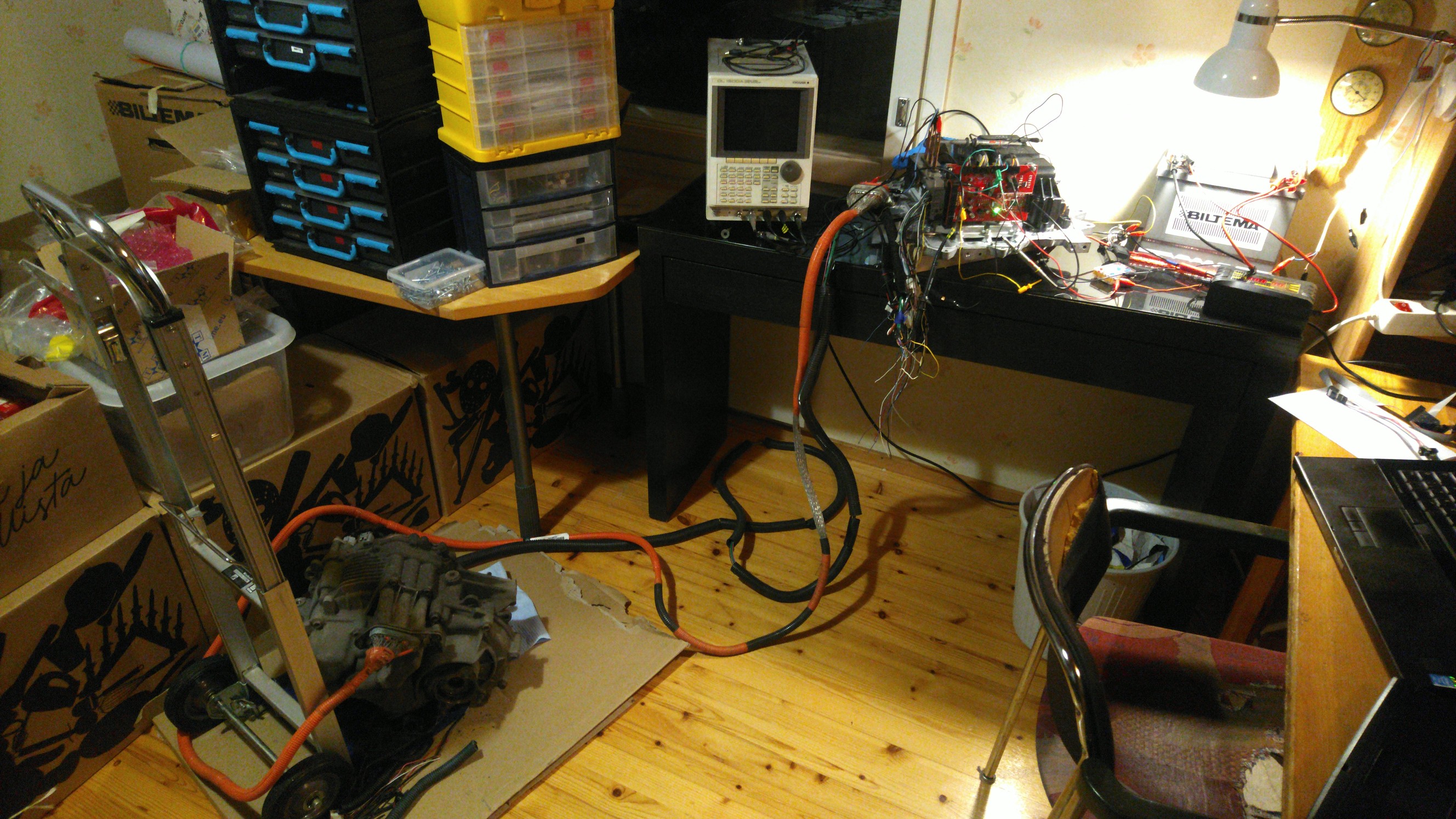

I've gotten this to spin using a Leaf gen2 inverter and FOC firmware. My plan is to test how much torque it can exactly create, given 500 amps.
So far it's spinning at 180rpm (= 24.2rpm at axle) given 14.4 volts which seems what one would expect.

Re: Toyota MGR Rear Traction Transaxle
About 5000rpm @ 275V when feeding it from a 10A 230VAC mains circuit. Iq reaches -20A which isn't much. I'm trying to use some kind of parameters that won't immediately blow the fuse. Next I'll start setting up the torque test.
EDIT: Attached the parameter file

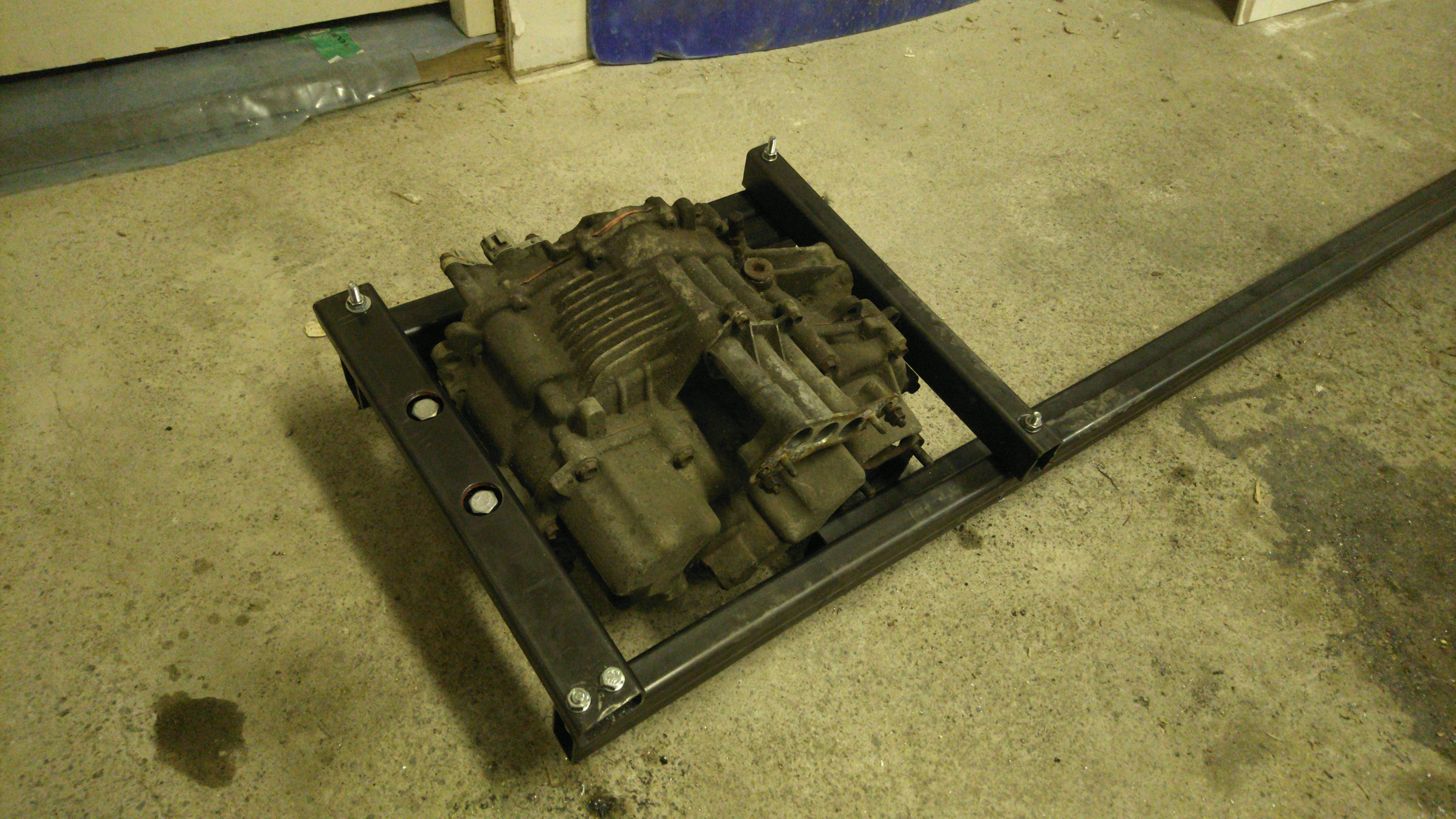

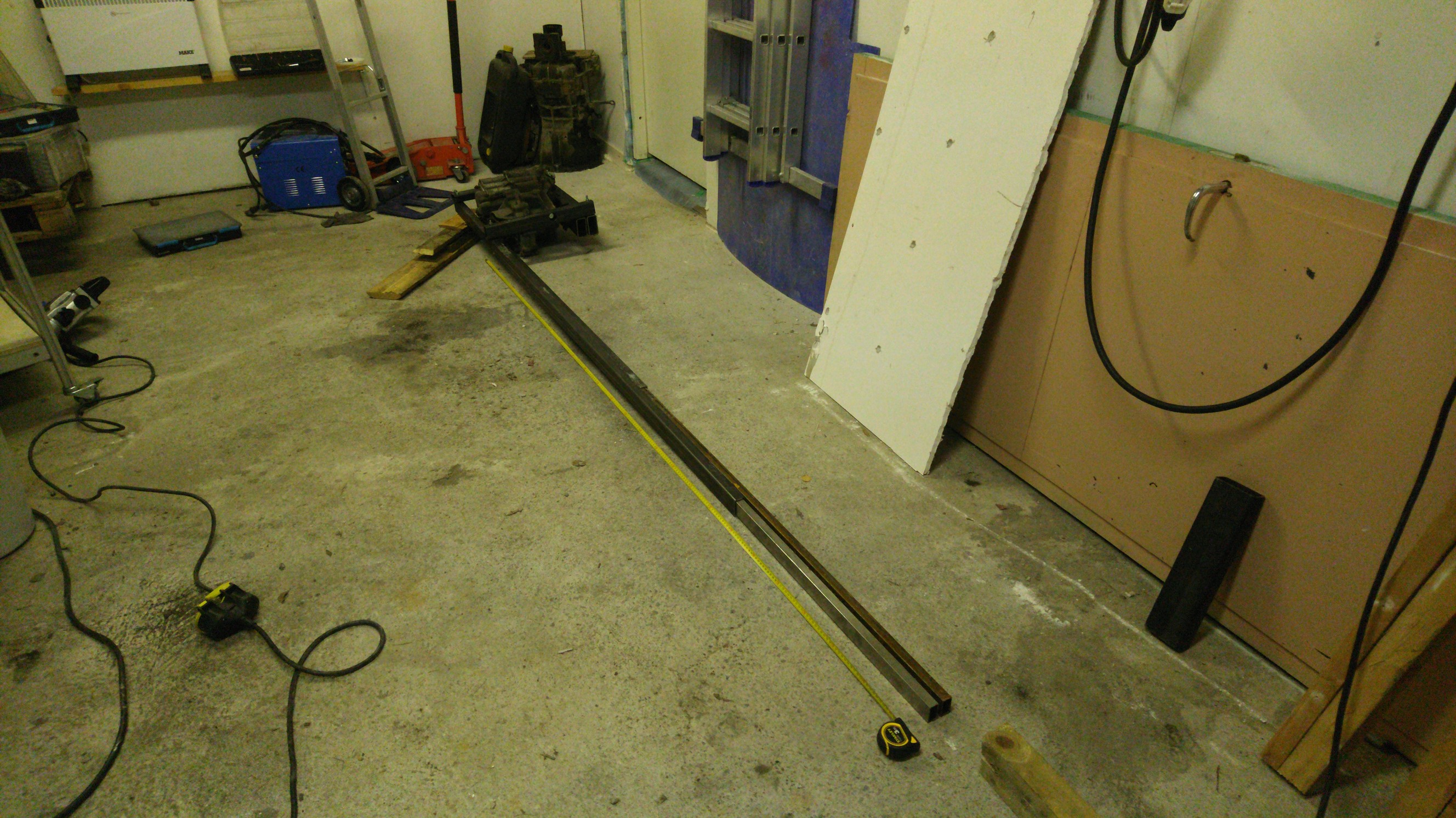

Rate my chances of staying alive operating this standstill torque testing device...
EDIT: Just a 12V supply and a laptop away from SCIENCE
Depends on how good your helmet is

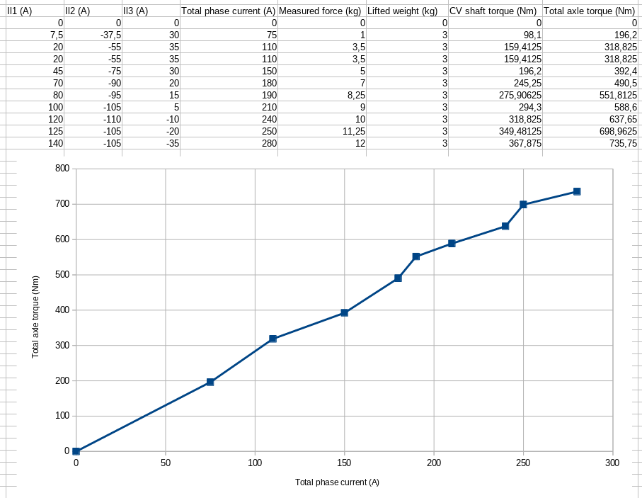

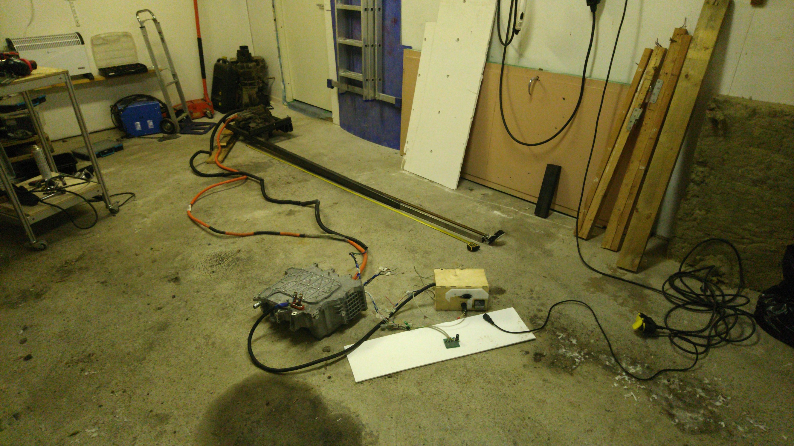

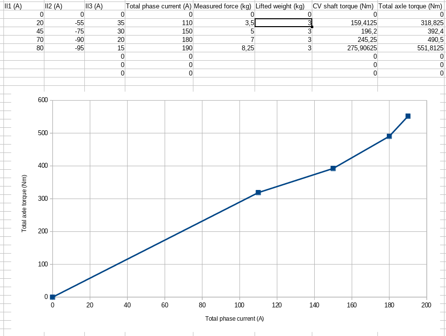

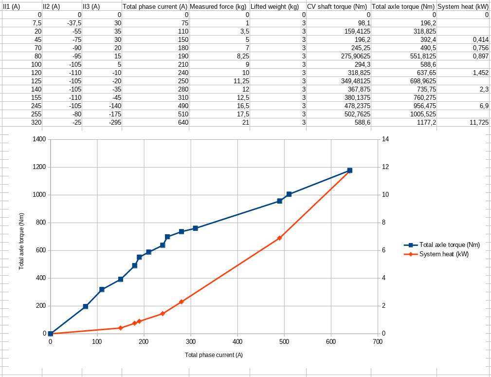

So far I'm not dead, and the jig stayed intact, which is already better than expected.
I made some measurements increasing the current in steps, but then got oscillation at higher current and my scale went all wonky. I need to log some stuff and see if udc goes below udcmin or something. Maybe I'll also get a cheap digital scale, those probably stand more abuse than these fiddly mechanical things.
Anyway, this is what I got so far. The current is simply throtcur*potnom. I haven't checked whether the inverter is reading correct current values compared to a clamp meter so you should assume it's probably wrong. On the other hand, I'm assuming the force measurements and calculated torques are somewhat accurate. Probably a good idea for me to check Iq and Id also, the inverter shouldn't be using much Id in this case.
You can extrapolate from these values that to make the published 900Nm torque, it would take 391A. And I need to go above that in order to learn what I want to know.

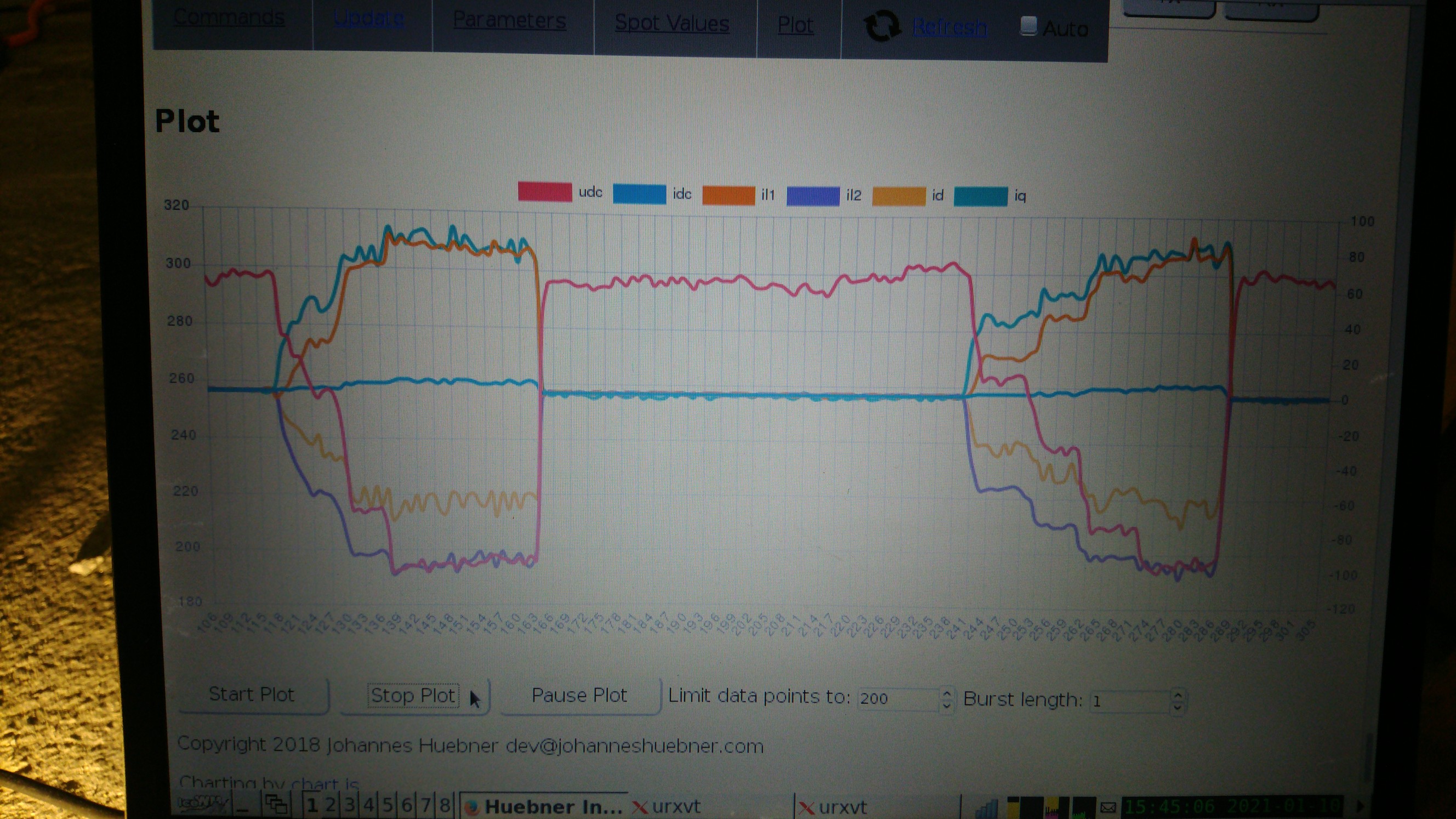

Okay that way of measuring current isn't reliable and I'm already facing my input current limit at the 450Nm tipping point in that graph. So up to that point it's (probably) accurate, from there the actual current is lower than what I'm requesting. I decided to use the phase currents from now on and made new measurements.
I'm feeding the inverter using a 500W isolation transformer and it's already pulling more than 1000W at the maximum here. Need to set up another power source (EDIT: about 830W actually). This obviously means though that to make 551Nm at the axle, the MGR and inverter will be heating up at about 1kW. I'm going to guess most will be at the MGR as 190A is pretty much nothing to the Leaf inverter I'm using here.
Overall this looks better from the standpoint of driving this using a 350A Prius power stage, as extrapolating from here gives about 1000Nm at 350A.
You can see there's a lot of Id being applied, I'm not sure if it's a good idea at a standstill situation but given it's there this test does give a more realistic view on what the torque will be at speed also.
EDIT: Re-uploaded the graph with a small fix
Skipped the isolation transformer, now I'm limited by my 10A fuses and 10A mains circuits. Still, got some more measuring done.
My goal is to get to the point where the graph is no more linear. So far it's straight as a nail. At the highest measuring point about 2.3kW seems to be used.
EDIT: I'm thinking I might need to double the torque and current to get to the non-linear region. To achieve that I probably need to quadruple the power, that is about 9kW and the Leaf inverter wants that at under 500V. I'll need to rig up a HV battery.

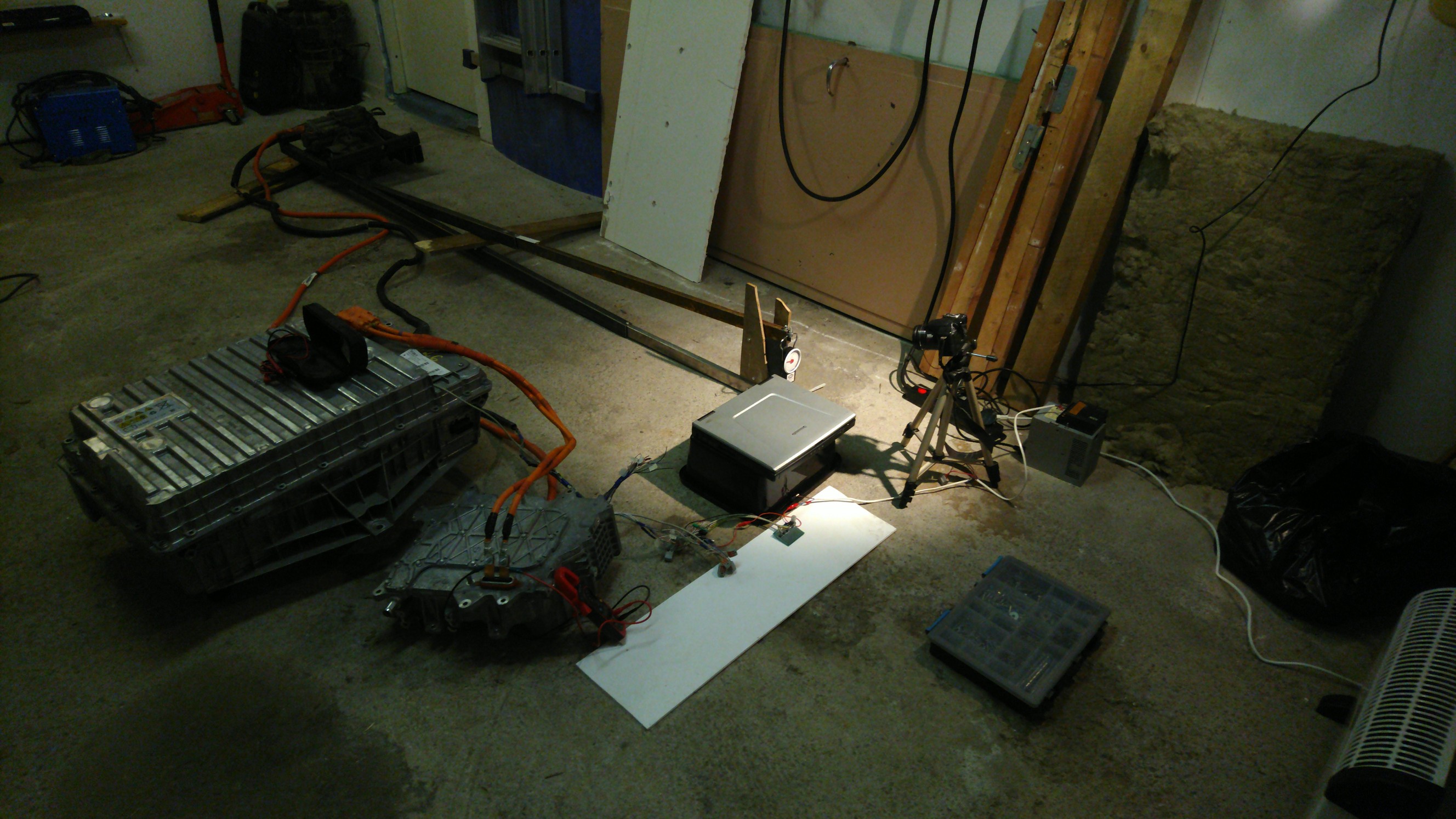

We have positive HV battery arrivement. 80kW @ 360V should be more than enough to either destroy everything or give me the results I want.
(Somehow this 1980s garage only needs 750W of heating to stay at 0°C while it's -27°C outside. Also, -27°C is probably the ideal condition to run an MGR powered vehicle.)

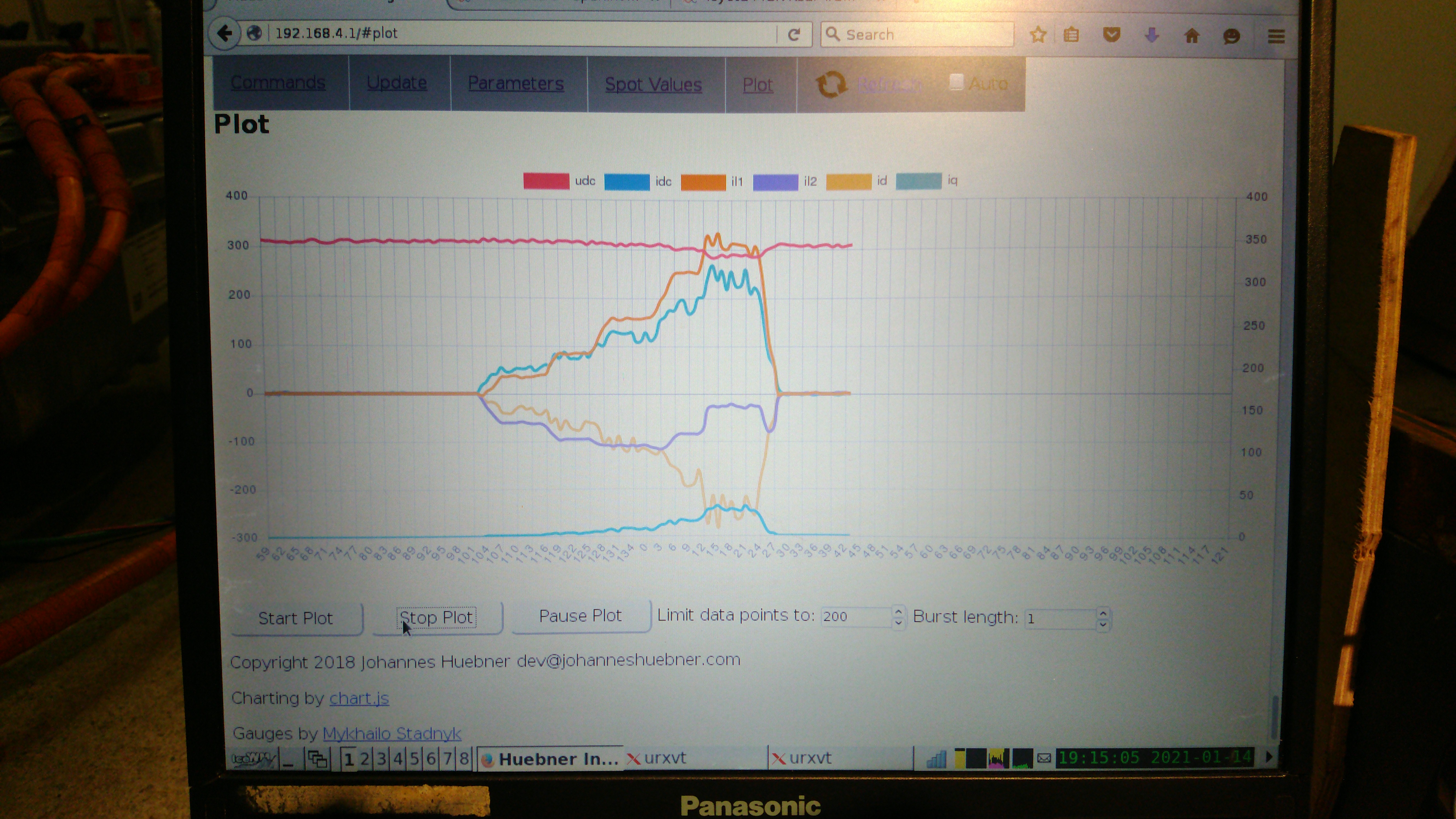

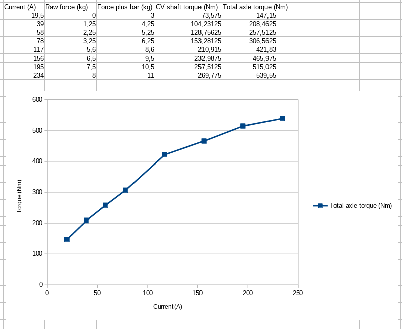

I increased idcmax up to 40 and this is the result.
I think there's like 35A going into the inverter at maybe 335V at the maximum point which would be around 12kW. At the end the MGR did feel slightly warm to my extremely cold hands, meaning maybe its temperature increased from 0°C to 20°C or something, so the total of maybe 60 seconds of maybe an average of 5kW definitely were turning into heat.
So this proves the MGR will output 1200Nm at the axle, given a total phase current of around 650A.
The "bang for amp" did decrease after 800Nm, but the graph isn't getting flat. I think I need to crank up idcmax even more. Obviously there's no way it can produce these torques for more than a couple of minutes without literally melting, but sometimes that's all the time you need.
EDIT: Graphed rough power values

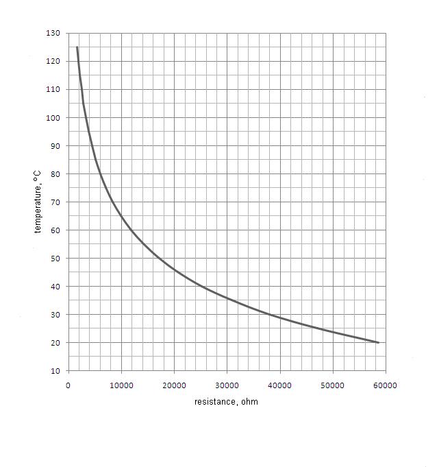

Yes, one can use the oft-shared standard Toyota resistance to temp chart to *fairly accurately* measure mtemp. The sensor is within the windings so fairly accurate.
- celeron55
- Posts: 804
- Has thanked: 38 times
- Been thanked: 136 times
The firmware expects a 10 kohm pull-down for the Toyota temperature sensor instead of the 510 ohm default one, is that correct?
This doesn't seem to be documented anywhere, not even in the code. What's certain is that my 510 ohm pull-down doesn't give correct readings when the Toyota motor temperature sensor is selected.
