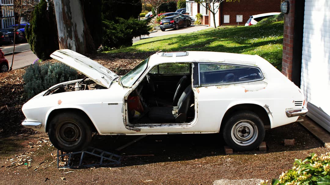

Hi folks,
I'm converting a 1971 Reliant Scimitar SE5 to electric drive train, using the Lexus GS450H transmission as demonstrated by Damien Maguire at the New Electric Ireland course I attended.
I've been collecting the parts I think are required and last week my 4 battery packs arrived (each containing 60s Kokam 100216216H cells) so I'm trying to copy what Damien's been doing but to be honest I'm a bit clueless so any help or advice appreciated.
As an example of how much of a novice I am, I opened up the first of four boxes of Kokam cells to discover I don't have any of the necessary tools to remove the BMS boards! (Have been shopping online for some new screwdriver bits etc, so hopefully in my next post I'll have been able to get some of the BMS boards out).
Can anyone offer advice on what boards on OpenInverter would be helpful to read?
Once I've got the bms boards out, what would you do next?
(Don't worry, I've got a mechanic booked in to do the work on restoring the Scimitar, whilst I try to get my electric drivetrain working)

So far I've gathered
4 battery packs (each containing 60 Kokam cells SLPB100216216H, which I reckon ought to be about 35kWh)
Oil pump for the above transmission
Toyota Inverter for the above transmission
And now that my new tools have arrived I can make a start on removing these redundant BMS boards
(Rookie mistake #2: I thought the boards themselves selves were a BMS! Well it's a relief that I don't need to rush the removal now)
The high voltage insulated tools were out of my budget range so I'll just need to be extra careful!

ggeter wrote: Thu Nov 26, 2020 2:12 pm Congrats on the start of your build. I've got a 1979 MG roller and considering using the 450h trans. How do you plan to mount the trans? Far forward where the original engine was? Modify the tunnel and push it farther back? I will have similar challenges.
Good question! Ideally I'd like to keep everything looking as original as possible so my initial thought was to move the transmission forward until it fits in the tunnel. I should do some measuring soon to see how much room I have to play with. Do you have any thoughts on this dilemma with your MG?
I'm getting some professional help with the restoration of the Scimitar and his advice was to modify the tunnel to fit the Lexus transmission.
This has the added advantage of making more space for battery packs and therefore keeping the weight as much as possible between the wheels, and low down (He suggested this would improve performance, sounds logical to my inexperienced ears!)

I think you will struggle to find a cheap working Jag lsd nowadays but this isn't too pricey ; https://www.rallydesign.co.uk/product_i ... s_id=25503
However the Scimitars rear suspension is very good and you can go a long way with an open diff, I used to sprint a 265bhp 302V8 powered SE5 and rarely had trouble getting the power down.
Unfortunately the front suspension is crap and they roll badly with the std antiroll bar- fit a second std bar piggy back or get a heavy duty one made. Uprate all the bushes and the brakes as they are hopeless too.
I think the chassis will limit how far back you can push the transmission but don't worry about cutting the tunnel, it's not structural but you might have to junk the heater, something you'd probably do anyway.
The fuel tank sits well back and quiet high and the handling would change quite a bit depending on how full it was, so I'd avoid putting too many batterys there.
The engine sits back behind the front wheels and you can trim a lot of the body from around the engine bay to make room for batteries up front.

Thanks Uppertown, invaluable to have suggestions from people who clearly know a lot more than me on this! Thank you!
Maybe I'll hold off on the LSD till I've driven it. Sounds like something I could upgrade to later on (and spend the money on more important things like the brakes and heavy duty anti-roll bar!)
I'm still at the point of waiting for my eBay workbench to arrive so I have somewhere neat and tidy to bench test components.
In the meantime, I'm having a go at restoring the Lexus transmission oil pump.
I've got the replacement bearings suggested on this wiki...https://openinverter.org/wiki/Lexus_GS4 ... ansmission
But I've already managed the strip the + screws! Will post some photos later so I can show others how NOT to do it!

Decided to tackle this "easy" first job on my conversion, refurbishing the Lexus GS450H transmission oil pump that I had to buy (naively bought a transmission without one)
It has been a swine so far. Hope the other jobs on this conversion aren't as tiresome! (I enjoyed it really)
The four bolts (10mm hex) came out no problem...
but the three cross head screws were totally seized and I manage to strip them. Oops
Out came my now indispensable induction heater and plenty of WD40...
...still no joy so I resorted to cold chisel (making a little notch first and then angling the chisel blows to eventually turn them enough to use a "damaged screw remover" bit. Bingo!
