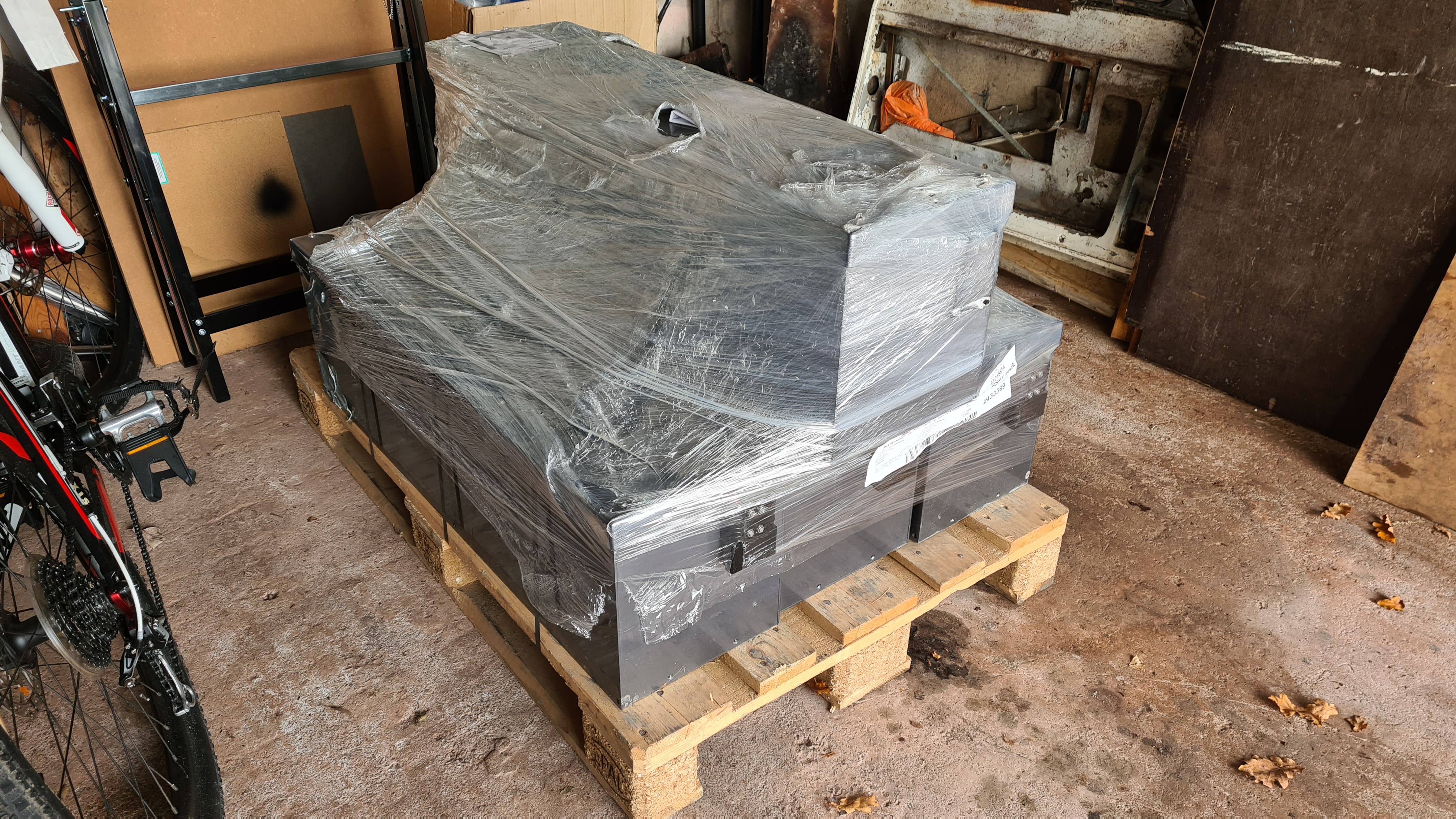

Hi folks,

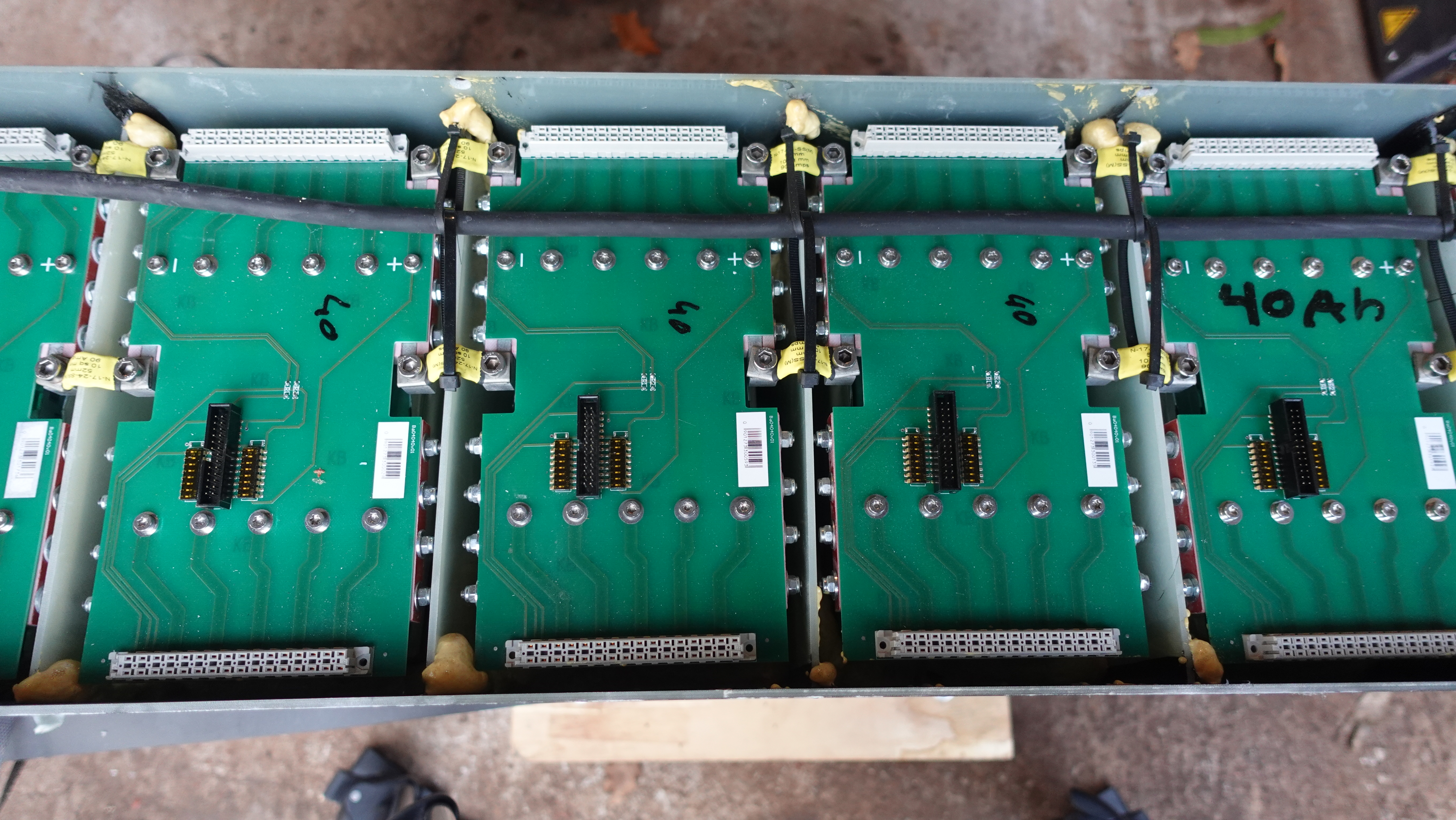

I'm converting a 1971 Reliant Scimitar SE5 to electric drive train, using the Lexus GS450H transmission as demonstrated by Damien Maguire at the New Electric Ireland course I attended. I've been collecting the parts I think are required and last week my 4 battery packs arrived (each containing 60s Kokam 100216216H cells) so I'm trying to copy what Damien's been doing but to be honest I'm a bit clueless so any help or advice appreciated. As an example of how much of a novice I am, I opened up the first of four boxes of Kokam cells to discover I don't have any of the necessary tools to remove the BMS boards! (Have been shopping online for some new screwdriver bits etc, so hopefully in my next post I'll have been able to get some of the BMS boards out). Can anyone offer advice on what boards on OpenInverter would be helpful to read?
Once I've got the bms boards out, what would you do next?
(Don't worry, I've got a mechanic booked in to do the work on restoring the Scimitar, whilst I try to get my electric drivetrain working)

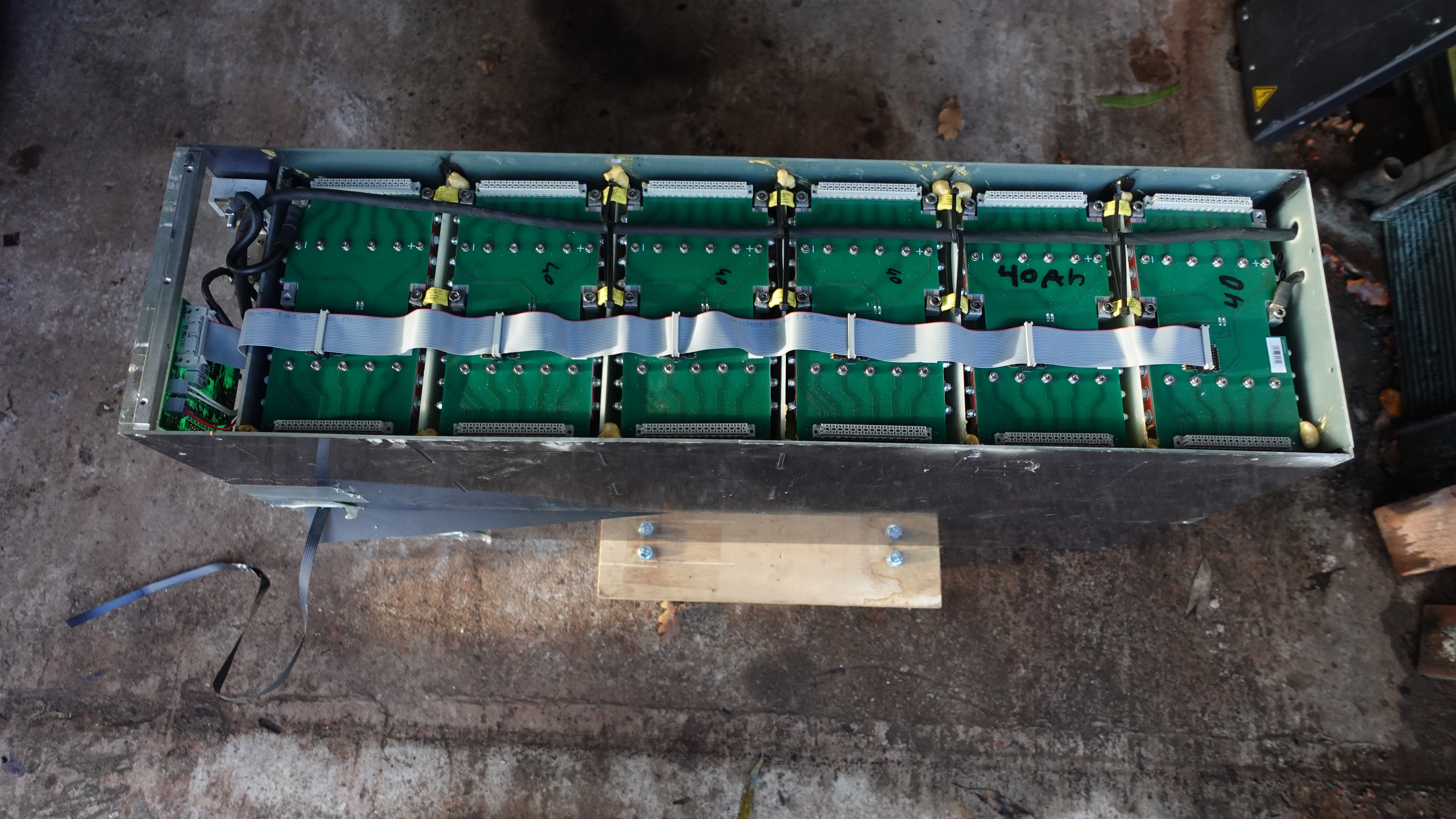

So far I've gathered
4 battery packs (each containing 60 Kokam cells SLPB100216216H, which I reckon ought to be about 35kWh)
Oil pump for the above transmission
Toyota Inverter for the above transmission
And now that my new tools have arrived I can make a start on removing these redundant BMS boards
(Rookie mistake #2: I thought the boards themselves selves were a BMS! Well it's a relief that I don't need to rush the removal now)
The high voltage insulated tools were out of my budget range so I'll just need to be extra careful!
Yes I've read that thread but I'm definitely going to re-read a couple of times to make sure I know what I'm doing a little bit at least!

Use selective covering of adjacent components, so that a dropped tool is unlikely to cause a short.
Use heatshrink to make you own insulated tools.
Never get complacent.
This should be a cautionary tail to all; http://evdl.org/pages/plasmaboy.html

slanceley wrote: ↑Mon Dec 28, 2020 4:26 pmThanks TFirenza, that's exactly the sort of help I need! (I think I'd heard of Scimitar owners using Jag LSD's but didn't know if it was viable, will look into it. I had been thinking of buying a Quaife LSD but perhaps that's overkill and I could do with keeping the budget down)
Re: Reliant Scimitar SE5 (1971) with Lexus transmission
Thanks Uppertown, invaluable to have suggestions from people who clearly know a lot more than me on this! Thank you!
Maybe I'll hold off on the LSD till I've driven it. Sounds like something I could upgrade to later on (and spend the money on more important things like the brakes and heavy duty anti-roll bar!)
I'm still at the point of waiting for my eBay workbench to arrive so I have somewhere neat and tidy to bench test components.

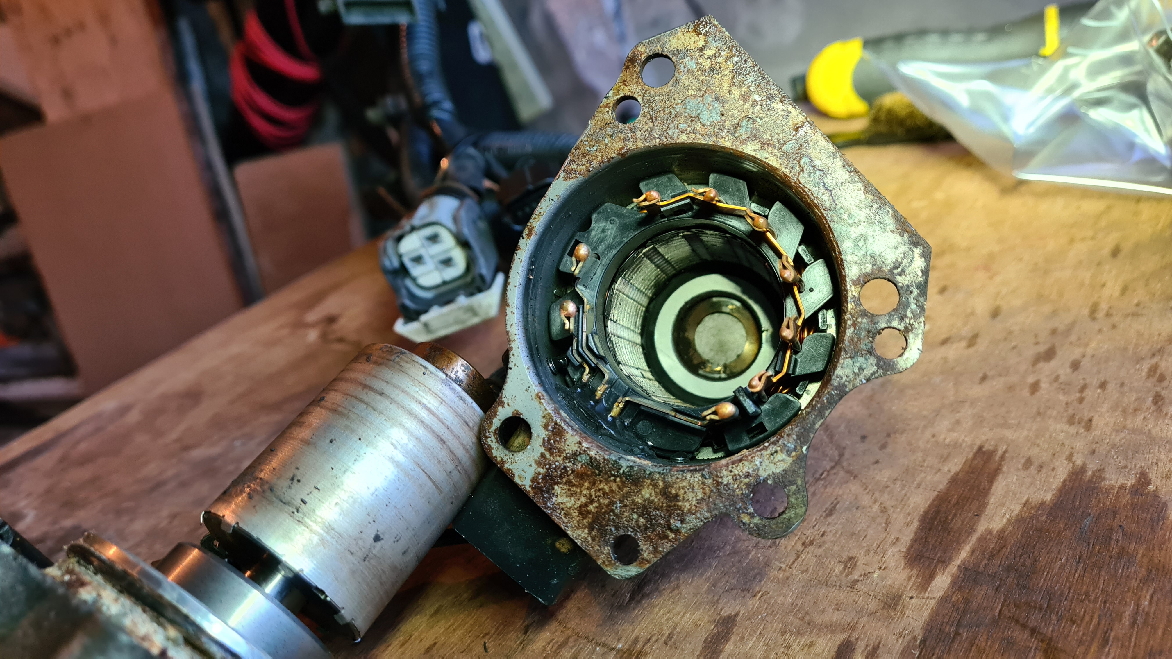

In the meantime, I'm having a go at restoring the Lexus transmission oil pump.
I've got the replacement bearings suggested on this wiki...https://openinverter.org/wiki/Lexus_GS4 ... ansmission
But I've already managed the strip the + screws! Will post some photos later so I can show others how NOT to do it!

Ha, I hear ya on the oil pump screws. Had two to do and the first one disassembled lovely, job done. Second one the screws were solid and ended up stripped too. Thought I had messed it up, but drilled the screw heads slightly to smooth them out, wd40, then used an opposite hand drill bit on slow speed and they loosened up handy enough.

I don't think tagging works here (it didn't last time I tried) but most forums use @slanceley (did that work?).
I just edit the relevant part of the post to make it more succinct

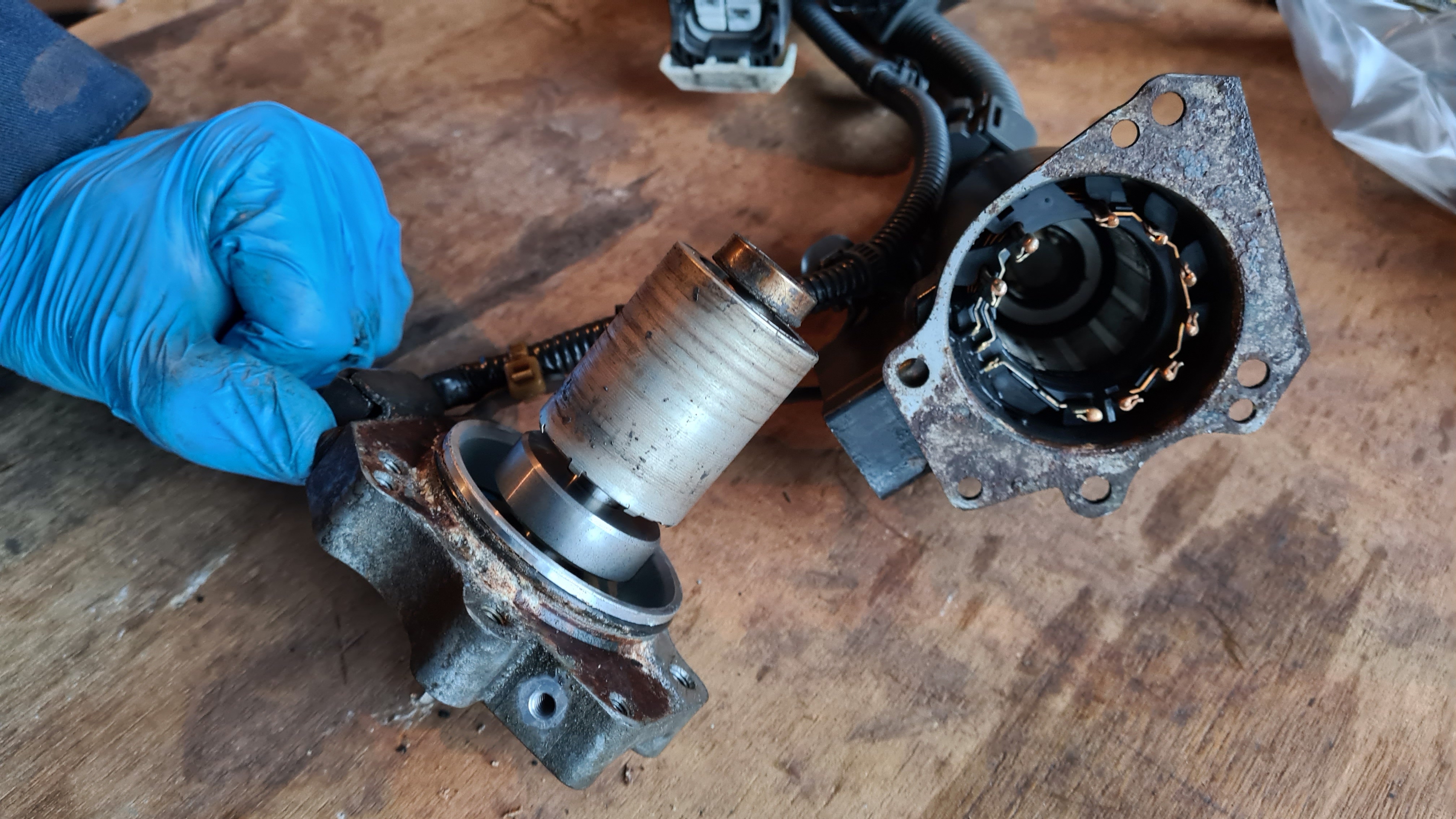

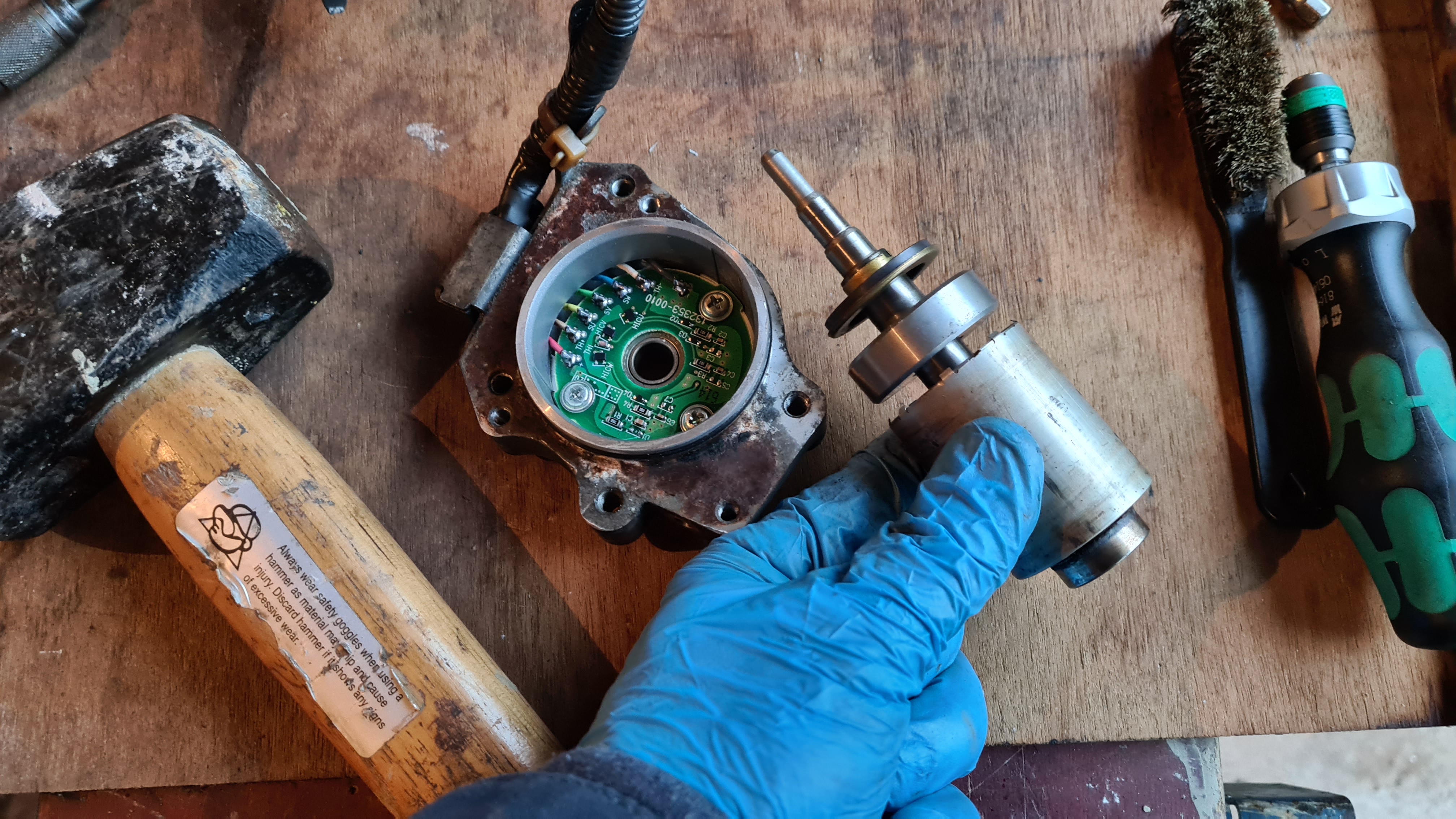

Decided to tackle this "easy" first job on my conversion, refurbishing the Lexus GS450H transmission oil pump that I had to buy (naively bought a transmission without one)
It has been a swine so far. Hope the other jobs on this conversion aren't as tiresome! (I enjoyed it really) The four bolts (10mm hex) came out no problem... but the three cross head screws were totally seized and I manage to strip them. Oops Out came my now indispensable induction heater and plenty of WD40... ...still no joy so I resorted to cold chisel (making a little notch first and then angling the chisel blows to eventually turn them enough to use a "damaged screw remover" bit. Bingo!

Oh that sounds like a great trick! Opposite hand drill bit... hang on this isn't like 'tartan paint', a replacement spirit level bubble or a long weight is it?

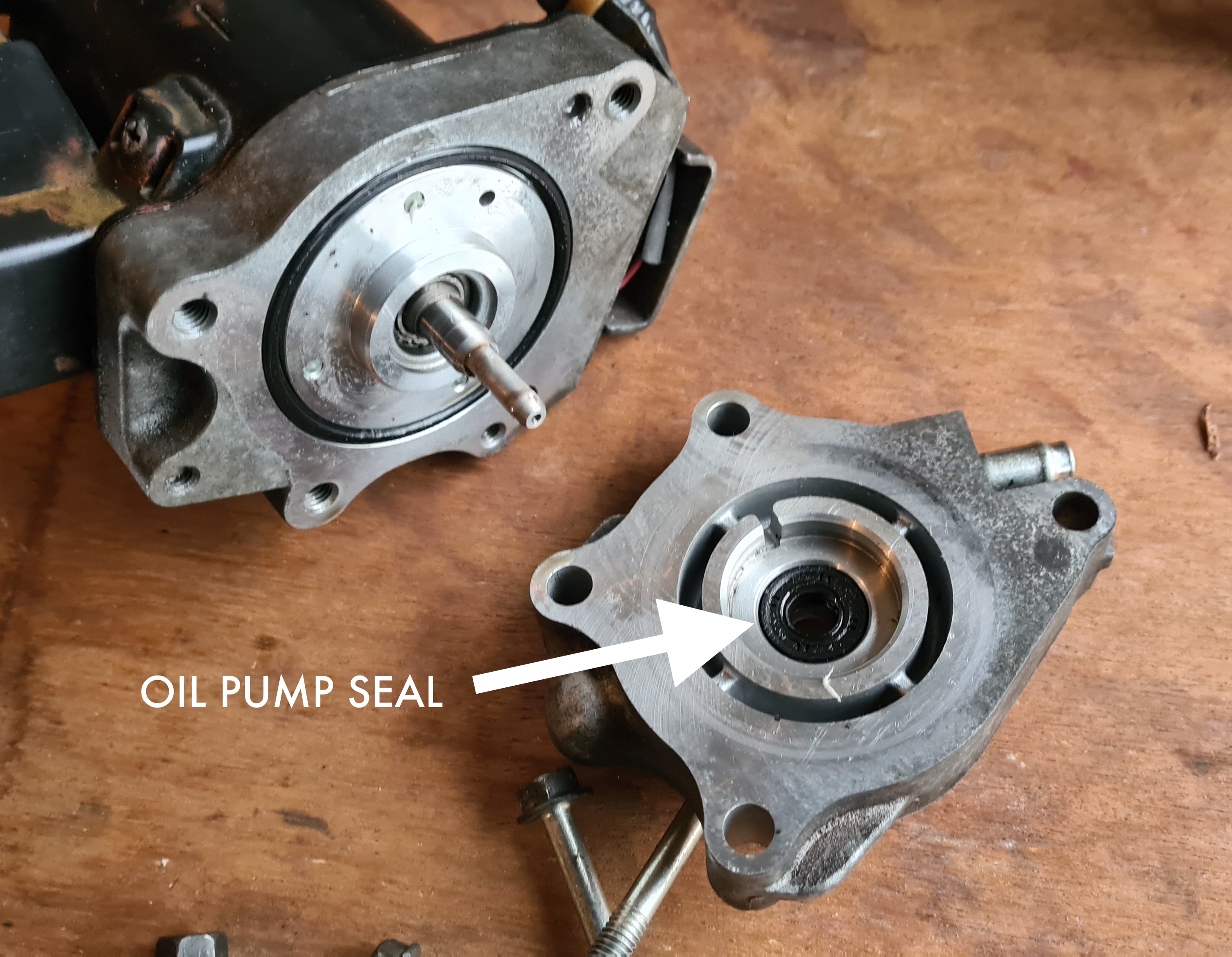

Next I need to get some replacement O rings (as some corrosion had breached the pump housing and damaged them - you can see in the photo that the metal is a little corroded too, I guess I ought to sand/brush it clean. Any tips for this?).
Sounds silly but when you are a newbie you soon find every little thing needs to be ordered in! eg rubber O rings, replacement screws that I stripped taking this apart, etc
Oh and the plastic seal thing, anyone who's done this refurb job already on the oil pump... did you replace the plastic seal thing? Can you point me in the direction of the correct part please if so? And any tips for how best to get the other bearing off (the rotor)? And lastly for today... am I right in thinking there's a gasket between this oil pump and the transmission? Any tips on how to do that/source one?

Ha, no not a rubber hammer suggestion. It grips in the opposite direction. Similar to the dedicated tools for the job. Doesn't always work that great though.

I've changed the bearings on two of these pumps but didn't have to change the seal you mentioned so can't help there.
For getting the bearing off the rotor, I found these weren't overly tight. I let them soak up some wd-40 for a bit, then used two flat screw drivers opposite sides of the bearing pushing on the rotor (maybe not the best anchor point) but worked slowly and kept an eye for any issues. Once the bearing started to move it came off handy. A small bearing pullers would be better solution possibly but more bits to buy for one off jobs!
For the seals, one of the pumps came with the seal. I can't find a pic from when I removed it. Was a profiled plate seal, so I refit that. Wasn't one on the second pump so I used a small bead of gasket sealant instead. I couldn't find the correct seal to buy any way handy. Not tested with full oil pressure yet though!
You need a puller plate, something like the one I made for overhauling Morini starter motors, you can see it shortly after the 3 minute mark;
