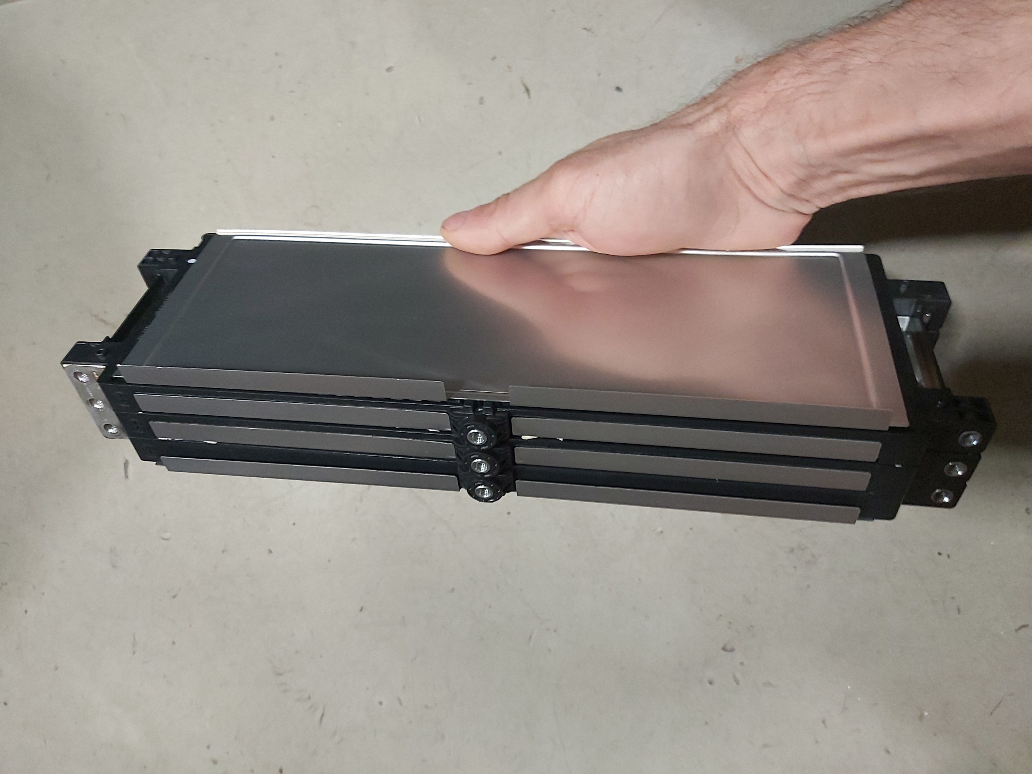

Yesterday I completed the last leg of my road trip to Saarland. It was 360 km and I ended up charging 5 times! Let alone I started with a full battery and ended with an empty one. I think that is very unpractical and not really a good range to convince people that EV driving is cool.
Here is what I found out about the various Leaf packs:
- 24 kWh: 48 modules 2P2S 7.2V
- 30 kWh: 24 modules 2P4S 14.4V
- 40 kWh: 24 modules 2P4S 14.4V (Up to here 192 cells total)
- 62 kWh: 24 modules 3P4S 14.4V (288 cells total)
Apparently the 30 and 40 kWh packs are more or less a drop-in replacement as I installed the packs in two equal sized rows. In summer conditions a 75% charged 24 kWh pack gives me about 80km of highway range. A 40 kWh pack would give me 130 km.
The 62 kWh pack would take up more space, I would probably only fit 16 modules under the car and would have to find space for the extra 8 ones.

johu wrote: Mon Dec 07, 2020 1:24 pm Apparently the 30 and 40 kWh packs are more or less a drop-in replacement as I installed the packs in two equal sized rows. In summer conditions a 75% charged 24 kWh pack gives me about 80km of highway range. A 40 kWh pack would give me 130 km.
I would argue that this is not the case when pack gets larger. Your safety margin also becomes larger because you cant say exactly if it is 75% or is it 80% SOC.
For example I saw 50km range with Volt gen1 battery which is exactly the same as with Ampera. I then filled it up with 11kWh which is some 66% statistically but in reality with age and wear it is closer to 80% SOC. I charged up to 4V per cell only.
In the case of Mazda Kokam cells i see 31kWh statisticaly but 27kWh with charging to 4V. This gives me about 160km mixed range. 180kwh if i made an effort in summer.

johu wrote: Mon Dec 07, 2020 1:24 pm The 62 kWh pack would take up more space, I would probably only fit 16 modules under the car and would have to find space for the extra 8 ones.
The Leaf e+ has the suspension revised to achieve this - it rides higher and has some slightly different lower trim to make up for the point.
The chassis is the same though so in practical terms all that's required is to uprate the springs.

Oh nice list, didn't know - thanks :) So I'd be adding 33 kg when upgrading to 40 kWh. Not so much.
Yes I read they made the battery case deeper to fit the extra cells.

Does the 40 kWh BMS talk the same CAN language as the 24/30 kWh one? Because I read you need to do some CAN spoofing to fit a 40 pack in a 24 Leaf.

johu wrote: Thu Apr 22, 2021 8:08 pm Now bringing this up again since it kindof turning spring.
Nope, 40kWh LBC won't talk to the legacy VCM. Requires a MITM.
Muxsan and EV's Enchanced have solutions off the shelf (I used the former).
If you're up for the challenge, no reason why Damien's one wouldn't work just as well.
You'll need to capture the battery ID codes from the old pack one way or the other in order to keep the VCM happy.

Ah sorry, should give a bit of context. I have the Leaf pack in my Touran conversion and the stm32-car does the BMS communication. So no ID code rubbish to worry about. Just wondering if the CAN bit mapping remained the same or similar.
