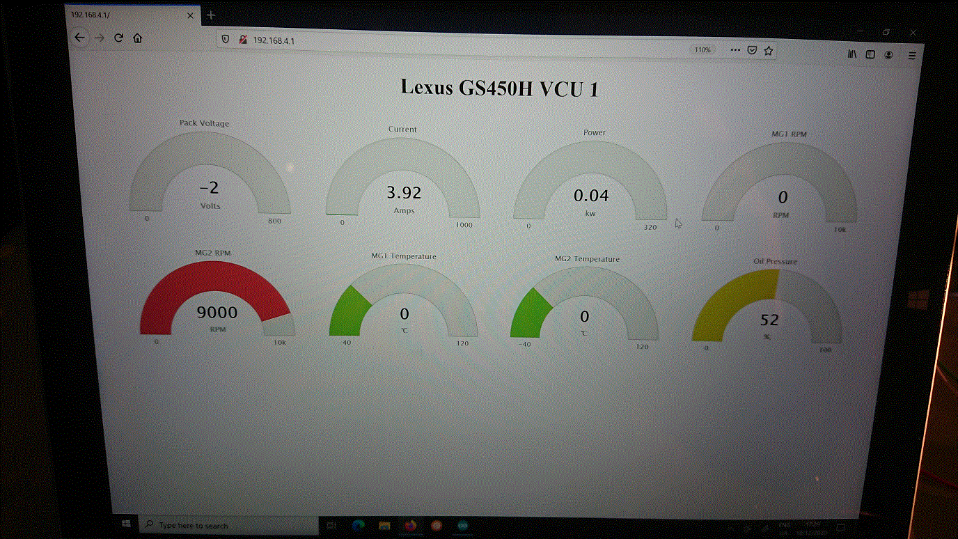

Has anyone had any issues with MG2 rpm not showing on the VCU wifi link!?
I've tried two VCU boards, on both a wifi connection to the phone and a laptop, and on two separate gearboxes, but the MG2 rpm stays at 9000. Not sure where its getting that figure from as there's no 9000 throughout the VCU code.
All other dials are working as expected. Even when I manually send test values over the wifi connection, all others work but not MG2! Looks as if the VCU URL just isn't getting the correct variable? Based on Damian's v7 code.
Posts: 3666
Has thanked: 12 times
Been thanked: 351 times
The gauges default to 9000 if no data for that item is received from the mcu.

Post by nkiernan »
When testing the wifi connection, I tweaked the code in the wifi function as shown:
Serial2.print("v111,i222,p33,m3333,n4444,o22,r33,q55*"); // Test string
Image below shows the result. As before, mg2 rpm is not registering. I would have expected if there was a wifi issue, the other 7 values wouldn't work either!? Its as if the identifier 'n' for mg2 rpm is not registering with the GS450H wifi dashboard. Is it possible I could have messed up the dashboard, doesn't look like it?
