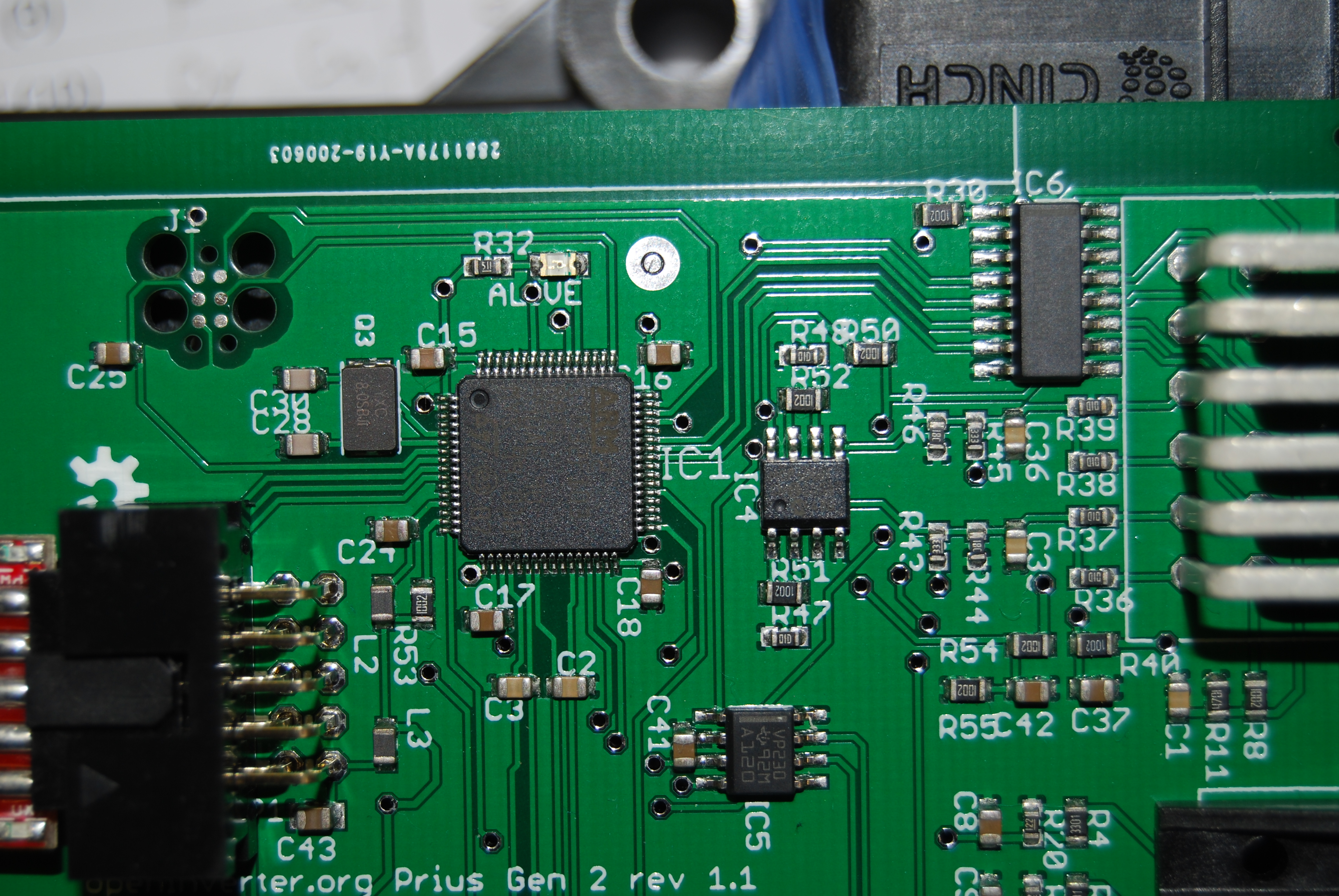

To get help show us exactly what you wired up, best with labeled wires like "12V" and "GND"
That is very good!
Do you have the Prius Gen2 VCU from the Openinverter webshop? If so, just supply +12v & ground (VCU pins 20 & 19 respectively) and see if you get a flashing light on the physical board. Flashing = goodive read the old wiki, ive spent about 3 month trying to cath up in the discussion thread so i beg, can someone please teach me like im a 5 year old who just knows v=ir. i dont know too many abbreviations i get that ENCa is the cosine signal for the resolver or something but thats after i get it to turn on. and connect to wifi.ill make a video of how i installed it for others to learn from what ive read so far. and show my confusion
I attached a photo of where you *should* see the LED flashing merrily.
