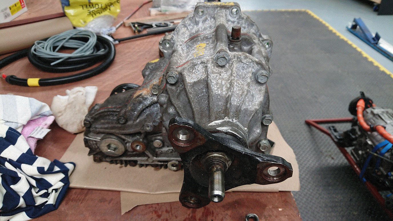

Re: Connecting a GS450H to an existing Transfer Case?
My understanding was that the transfer case off the back of a LS600H transmission would bolt onto the back end of a GS450H transmission to convert it to a LS600H. I picked up a LS600H transfer case, but its not that simple. There is a short adapter section that is required between the back end of the GS450H gearbox and the LS600H transfer case. Haven't been able to source one yet, but not a straight swap.
One thought was to make a simple coupler and adapter between the output of the GS gearbox and the input of the LS transfer case as it is a tidy transfer case compared to some 4x4 types.
Not needed anymore though, so if its of interest shout.

Ah, good to know, i've been searching around to see if that was possiblenkiernan wrote: ↑Mon Jan 04, 2021 7:40 pm My understanding was that the transfer case off the back of a LS600H transmission would bolt onto the back end of a GS450H transmission to convert it to a LS600H. I picked up a LS600H transfer case, but its not that simple. There is a short adapter section that is required between the back end of the GS450H gearbox and the LS600H transfer case. Haven't been able to source one yet, but not a straight swap.
you mean the ls600h transfer case is available?
Initially that sounds inviting, but i will have to adapt the gs450h to my existing transfer case anyway, plus the front shafts/hubs can't handle permanent 4x4, so if i keep the stock T-case then i keep the switching ability. So although the two lexus parts might adapt relatively easily i would presumably lose the ability to disengage the front shaft
