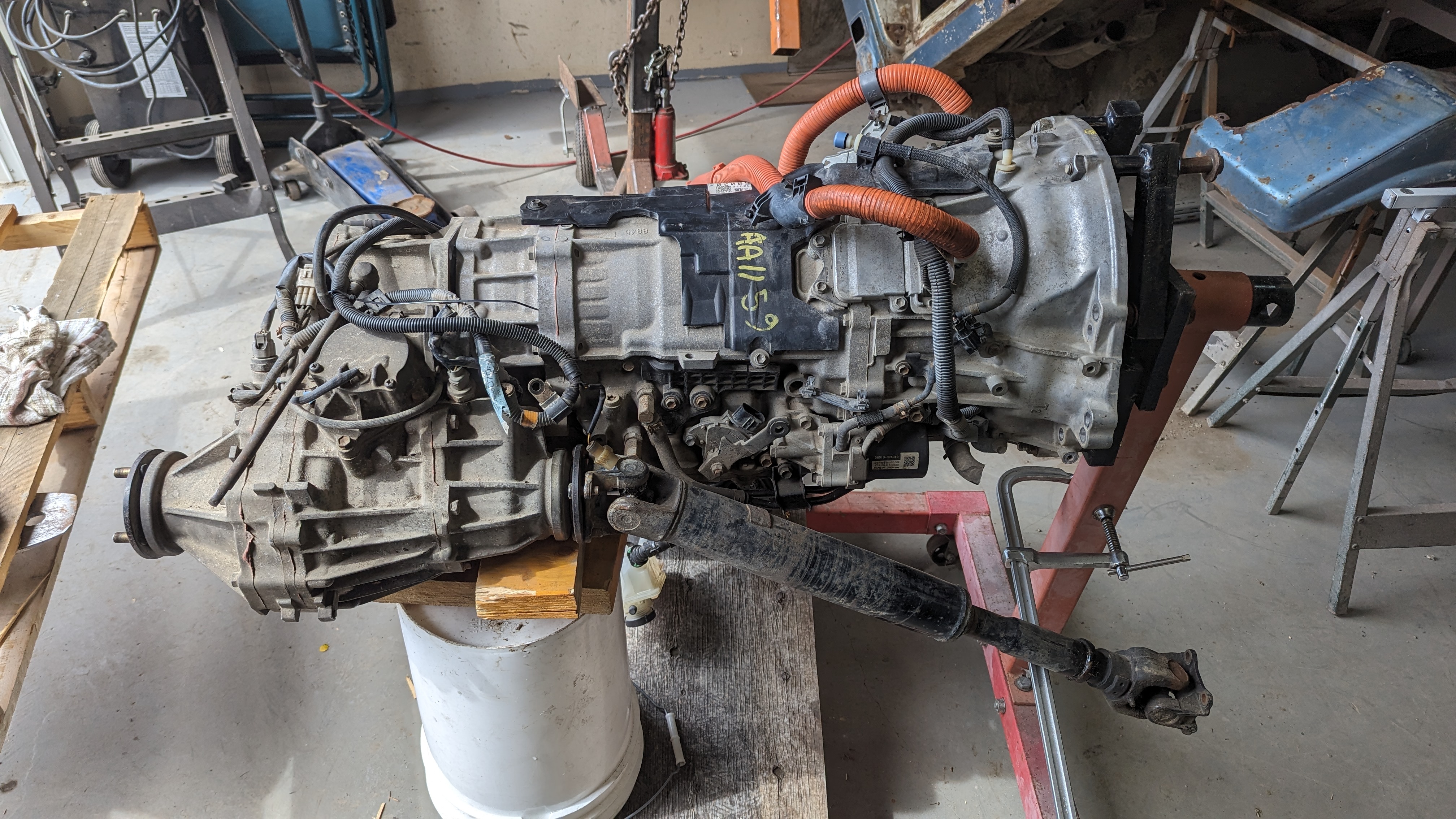

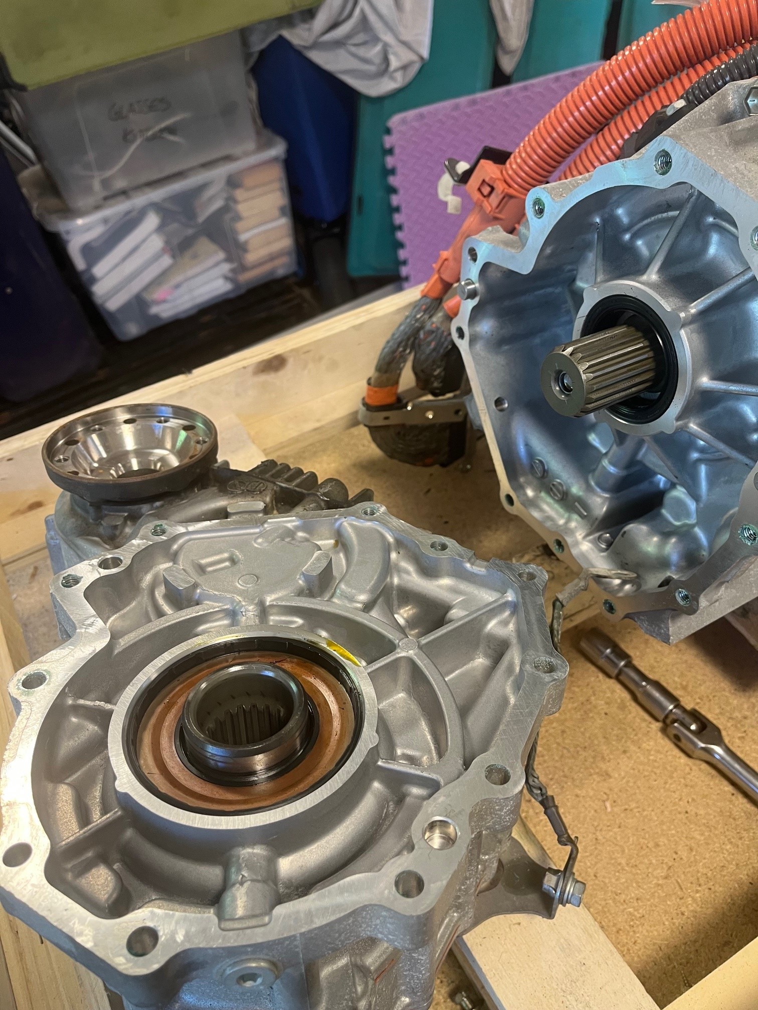

Looking to retain 4WD capability on my truck, if i could hook the gs450h up to my transfer case i will retain the ability to go Hi/Lo and also engage the front wheels, i might also save a bit of engine bay space for batteries and ancillaries.
Any thoughts?
Any thoughts?

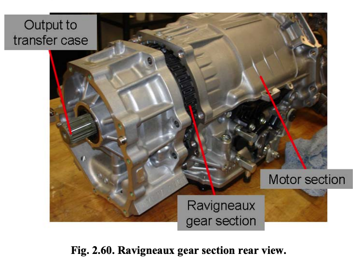

There exists a 4wd variant of the LS600H transmission with a transfer case (altough it's quite heavily integrated, I don't think it's removable at all), one being sold on Ebay right now. It doesn't have hi/lo but given these things can nevertheless put out about 1000Nm at the propeller shaft do you need hi/lo?
Greenbeast
- Posts: 115
- Joined: Sat Dec 26, 2020 5:44 pm
Re: Connecting a GS450H to an existing Transfer Case?
Aha, i saw mention elsewhere but typed GS600H instead of LS600H into ebay.celeron55 wrote: ↑Mon Jan 04, 2021 12:47 pm There exists a 4wd variant of the LS600H transmission with a transfer case (altough it's quite heavily integrated, I don't think it's removable at all), one being sold on Ebay right now. It doesn't have hi/lo but given these things can nevertheless put out about 1000Nm at the propeller shaft do you need hi/lo?
The only complete one i see is in the States? At about £2k inc shipping, quite pricey
Yes the LS600H has a variant of the transmission with the type code L110F

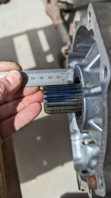

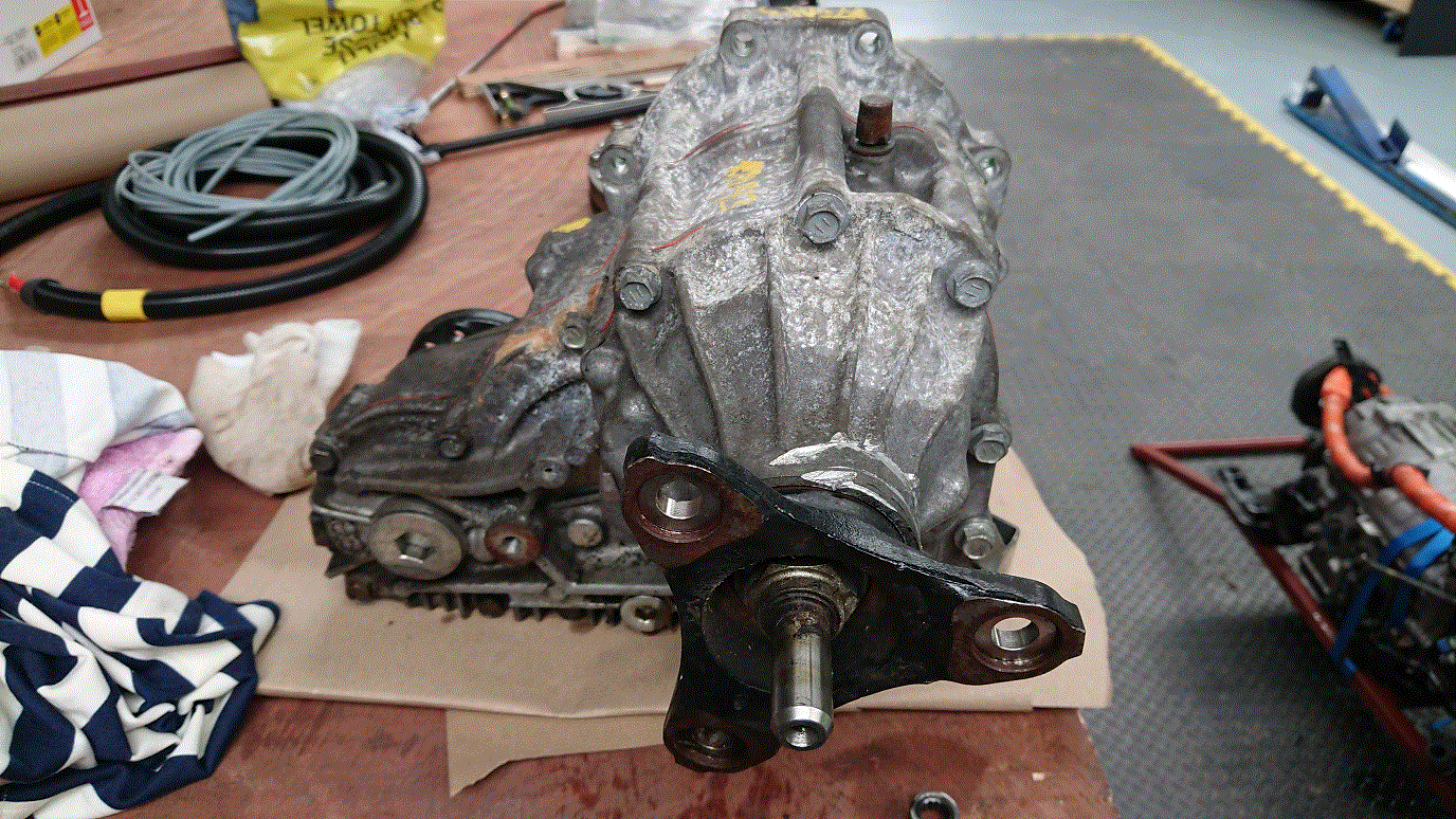

My understanding was that the transfer case off the back of a LS600H transmission would bolt onto the back end of a GS450H transmission to convert it to a LS600H. I picked up a LS600H transfer case, but its not that simple. There is a short adapter section that is required between the back end of the GS450H gearbox and the LS600H transfer case. Haven't been able to source one yet, but not a straight swap.
One thought was to make a simple coupler and adapter between the output of the GS gearbox and the input of the LS transfer case as it is a tidy transfer case compared to some 4x4 types.
Not needed anymore though, so if its of interest shout.

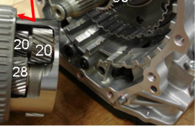

Worth pointing out that MG1 and MG2 could be operating at different RPM depending if you use the Lock Input Shaft method or Lock Planetary Gearset method.
Locking the planetary gearset will cause them to spin at same speed and direction with a max RPM around 11,000ish due to the limits of the bearings. In High gear 1.9 reduction this will result in about 5,250rpm coming out the back of the transmission.
Locking the input shaft will cause MG1 to spin 2.2x in the opposite direction to MG2. Thereby MG1 will reach the bearing speed limits much earlier than MG2 and limit the total output RPM. This will result in a max RPM of about 2,600.
Divide that by your 3.36 axle ratio and you have your rear wheel RPM and it's just a final step to factor in your tyre circumference to find your max road speed.

Presumably i also have to factor in 1.295 reduction in keeping my transfer case?sfk wrote: ↑Tue Jan 05, 2021 9:13 pm Worth pointing out that MG1 and MG2 could be operating at different RPM depending if you use the Lock Input Shaft method or Lock Planetary Gearset method.
So for locked input shaft it's 2600/1.295=2007, 2007/3.36=597rpm at the wheel, which i think makes 40mph top speed given my wheels
Or am i wrong again?
