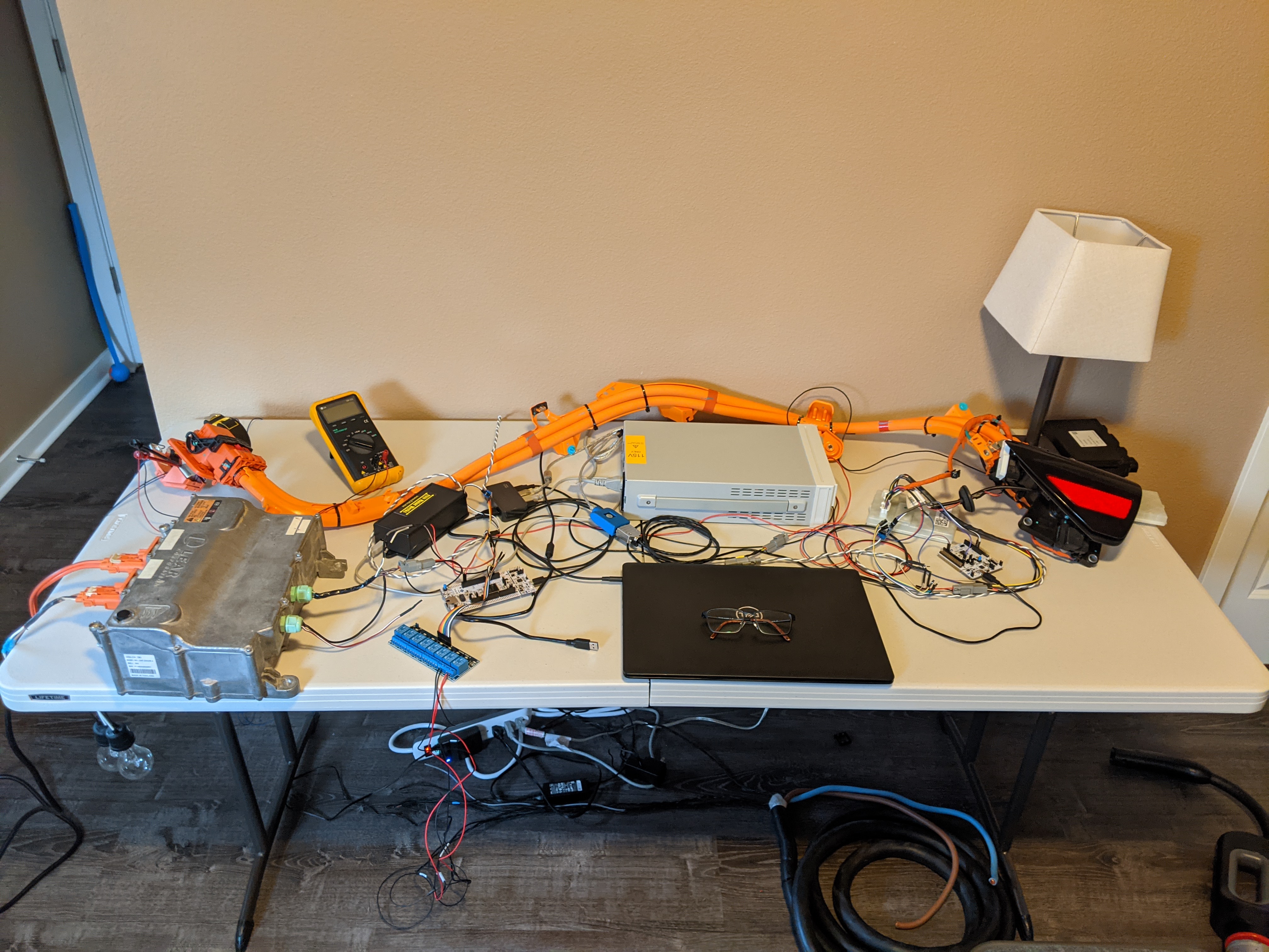

Good news so far today is that I've gotten the charger outputting voltage. I initially wasn't getting the right output, but I set the input current too low :D Annoyingly CAN Low was white, which is pretty much opposite from standard.. (de facto standard, but still...)
I now get 200V with a 1A current limit, looking good so far. I'll test the CHAdeMO out after I eat some dinner. Stay tuned!

YES, YES YES!!
We have working CHAdeMO!!!

So, I've found current control.
Here's a fun bit - the CHAdeMO adapter _ignores_ anything above 125 Amps.
I'm having a heck of a time figuring out how to set the voltage, however.
That's all for now. Tomorrow I hope to find voltage.

0.9 is what the adapter uses.
Interestingly, Fast Charge Limits CAN _does_ show 255A when I set it to that, but it looks like the adapter refuses to send a value greater than 125.
I've only seen standard 50kW (technically 62.5kW @ 500V) ever.
Didn't figure out voltage control yet. Definitely a little stumped.

So some clarifications... This connector is the one I unplugged and left the power on with:
The green wire is ground, and the white with purple is pilot. This connects to CAN Low (Ground), and CAN High (Pilot).
This then results in:
And my table still looks reasonable:
I did get it to work in Linux using my ValueCAN3. The key is the drivers basically just use the hardware config and can't modify it on the fly. So I booted into Windows, set CAN 1 to 500k and normal mode, and set CAN 2 to 33.3k and silent mode. Now I can capture in SavvyCAN and analyze in Vehicle Spy.
I did not get far with figuring out what causes the Fast Charge limits to be calculated as they are, but I did figure some things out. I think there's about 30 signals, and I figured out about 13 of them, including all the CHAdeMO ones. The others are harder. There's three multiplexed ones that I have no idea what's going on with them. :D
