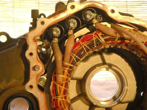

In tom3141's thread viewtopic.php?p=22570#p22570 we have lots of proof that the MGR won't do proper speeds without a voltage higher than what most are willing to set up their battery for. The obvious solution is using a boost converter, but that's not ideal.
Has anyone popped onto this forum with experience on rewinding motors?
Here's a photo from earlier in this thread. You can see there seem to be two wires coming from each terminal, the simple explanation being it's delta wound. That means there might be a chance of making it suitable for even higher voltage, which would be the most useless modification, unless you want to use it as a wind turbine generator or something.
As I understand it, rewinding a stator like this goes like this:
  • Cut one end of the wires off with a grinder flush with the stator core,
  • tap the rest out of the stator with a suitably sized metal rod and a hammer,
  • figure out how the coils were wound so that you can redo it in the same way but different
  • Add new insulating sheet around where the coils go
  • Make the new coils
  • Remember to add a temperature sensor somewhere in the coils
  • Tie the new coils in place using some kind of temperature resistant non-conductive fiber stuff, I mean... string
  • Coat it with some kind of temperature resistant non-conductive resin to keep it all in place
Overall it seems like a lot of work if you could just use software to control a boost converter instead.
There's actually a downside to rewinding also: You lose as much torque per current as you increase speed per voltage. Thus, it could be that a boost converter is actually the ideal solution, and Toyota was right all along.
Been thanked: 1918 times
Re: Toyota MGR Rear Traction Transaxle
On an old industrial motor I once reconnected the existing coils. Basically every phase consisted of 4 coils that were all connected in series. 4S1P so to speak. I changed it to 2S2P to half the voltage rating.
Are the coil ends accessible enough for that?

Thanks for mentioning on this thread. I was wondering today about the possibilities of rewinding. I have no experience so will be interested to see people’s thoughts.

celeron55 wrote: Sun Jan 17, 2021 6:11 pm Has anyone popped onto this forum with experience on rewinding motors?
Here are a few more photos of a rewind in progress, to save people from hunting back through the thread like I just did: viewtopic.php?p=19577#p19577

Wait a minute, why are there 12 wires coming out of the stator in the dismantling photo and what are those additional crimped connections? Is it wye wound after all, with two parallel windings?
