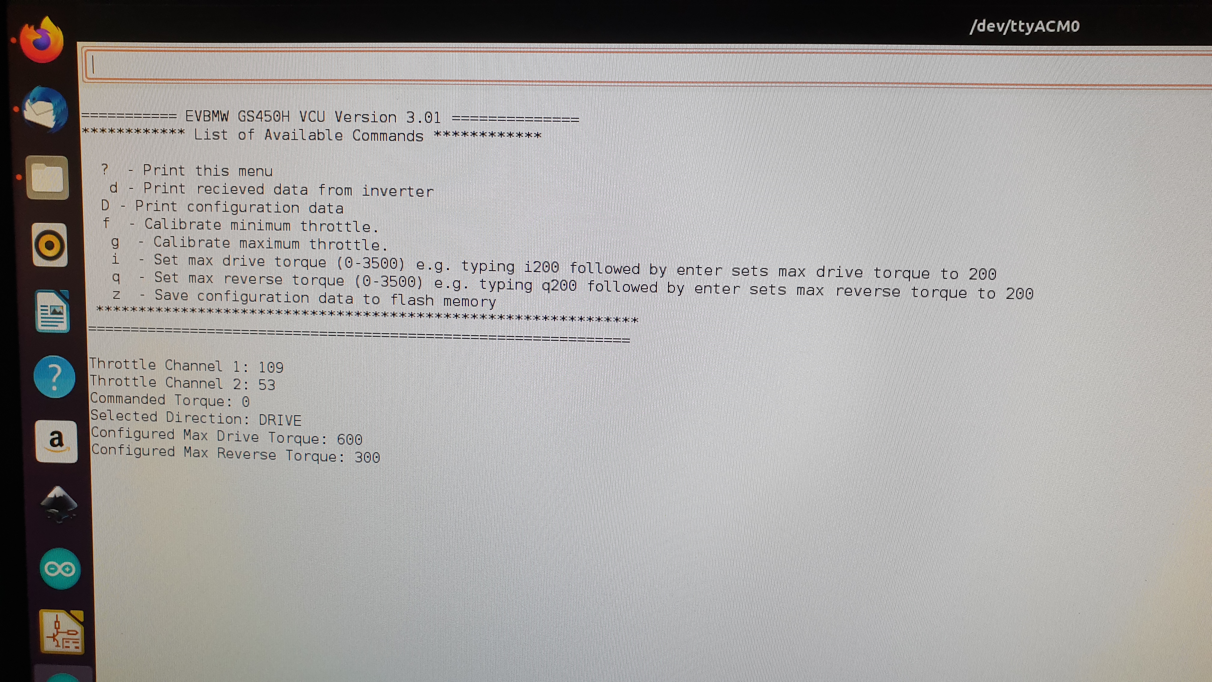

Ok I've worked out the guts of a simple little serial menu system to allow setup and configuration. No programming required. Just a usb cable , pc or laptop, any operating system with a serial terminal. Its super simple (as dictated by my programming skills!) and should get people off the ground.

Ok I was able to reproduce the wifi problem here on the bench. Funny thing is just replacing solid-gauge.js didnt fix it. So I pulled down the files from github, added the same sold-gauge.js to them and now it works. I cannot fathom what happened here or how my local files got broken in this specific way but I can now confirm the files on github are working fully :
https://github.com/damienmaguire/Lexus- ... aster/WiFi
As stated earlier, anyone uncomfortable with the wifi reprogramming contact me off line and we'll arrange an exchange module as this is clearly my mistake.
Few more hours on the vcu firmware and we should be good to go for a bench test and super boring demo video tomorrow:)

I have edited the wiki page with a description of the new simple menu driven firmware. Please have a read. I will bench test and shoot a video on this tomorrow at which time the firmware will be available on Github.

Well folks this one turned it to a bit more of a tour de force than expected. One of the reasons I had not posted any video to youtube recently was down to changes in their terms of service. Well, when I went to upload the firmware tutorial today it seems to be having a bad hair day. Emailing the "support" just gets a canned response.
Nothing like a crises to force change so the firmware tutorial is now processing on Vimeo :
The new firmware is available on Github following successful testing on the bench: https://github.com/damienmaguire/Lexus- ... 3_user.ino

Can I get a WOOT WOOT!
After LOTS of trail and error finally got the transmissions to do "Spiny Things"!
Lot of wiring connections because I did not have any part of the wire harness which at the time when I bought the inverter and trans, I didn't think it was a big deal, man I was wrong on that one. And I'm an electrician.
Also a big hurtle for me was trying to figure out the programing part of this whole deal, especially the firmware change. (Arduinos, STM32's, Sketches, libraries, com ports, yada, yada, yada.
My head is still spinning!
Special thanks Damien for your latest Video,
here is a short clip.
