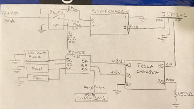

Guys please keep in mind the Tesla Charger board is designed to be the ONLY item connected to the charge port really, Unless the firmware gets modified. As the EVSE signals are always based on voltage dividers anything else adding resistance to the circuit will cause issues.
A "Workaround" would be:
1-Pilot signal is only needed by the Charger this can be direct.
2-The proximity signal is no more then a resistor divider to ground, so you can do this externally for the charger to mimic being always plugged in.
3- The actual charge port signal to the SimpCharge to activate the charger only when actually plugged in.
This means the EVSE/plug is detected by the SimpCharge via Proximity.
The EVSE is controlled by the Tesla Charger opensource board via the Pilot signal.

Thank you Tom, this makes complete sense. Simply spoofing seems rather simple! Your knowledge and openness to share is invaluable.
Attached is my simplified schematic, for anyone who may want to recreate in the future.

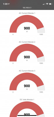

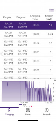

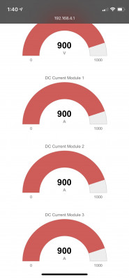

Alright, today I finally got the cooling system plumbed up and got a charge session with the Gen2 v5 in before I hook up the Simp Charge. I charged up to ~415V (90% SOC) successfully before manually disconnecting.
I've noticed two issues with the charger:
1) All values still display 900 on the wifi screen, I wasn't ever able to see anything different after several tries, power cycles, and a total charge logged of ~35kWh (read: it was actually charging) 2) During the charge taper period (I believe), phases of the charger keep cycling on/off, sometimes with all three cycling off. I observed a little bit of this during the nominal charge period, but it really went wild during what looks like the taper period. I can hear the relays clicking, see it in my EVSE log, and see it in the charger serial log with associated weirdness in the AC/DC data. Has anyone else observed this behavior before I start the debugging process? I'd like to solve this before introducing the Simp Charge as another variable and hope that it's not simply due to the higher voltage I'm running, as it was happening intermittently at lower voltage.
The setup as it looks before it gets tidied up and stowed away, please excuse the mess of wires: Thanks for reading this far,
Bryson

I have addressed the ramping issue in the past in fact I just did so again in the new firmware thread so here is a copy :
Once again to address the ramping issue : Yes I have seen it, no I don't know the cause , Tom has said its down to thermal limiting in the modules. It may indeed turn out to be a can issue and like all things we do here the more minds we have working on it the faster it will be fixed.
In terms of the wifi the first thing I would do is check you are seeing serial data on the wifi header. It comes out at 19.2k 8n1.
As Johannes has announced we will soon have an openinverter based firmware available (along with a new board rev) for the gen2 and gen3 charger control boards. It will be compatible with stm32 based V5 boards only. More on this once we complete testing.

As I browse through the log, it’s worth noting that one of the things happening is phase 3 goes into a fault state, which is triggering a move to state 2 and a reset of all phases (based on my understanding of the code). This may or may not be related to other phases dropping to zero current without faults. I’ll be going over my grounds again first to see if it may be noise related as I don’t have a scope handy. Maybe a choke on the power to the board is worth trying as well. Then I’ll attempt further dives.

Well, against my better judgement I wired up the Simp Charge as shown above before resolving the other issues. It works perfectly!
It takes about 10s from plug insertion to charge start with a cold boot of the charger. The Simp Charge triggers the BMS to charge mode (precharge and main contactors), turns on the Tesla charger, and fires up the cooling system and fans. Overall, very pleased.
Haven’t dug into the charger itself yet, but am very happy to have a low drain system that fires right up on command. Thanks Tom!!
edit: I did check all grounds, they are all going to the same point on the case and look clean and tight. That didn’t do it, on to the next..

Serial data is coming out of the header as va000,vb000,vc000,ia000,ib000,ic000,ua000,ub000,uc000,aa000,ab000,ac000* when there's no activity, it still showed 900 in the WiFi interface for every variable when there is no activity.Jack Bauer wrote: ↑Tue Jan 05, 2021 8:23 amIn terms of the wifi the first thing I would do is check you are seeing serial data on the wifi header. It comes out at 19.2k 8n1.
I swapped the ESP8266 with another one and that looks like it solved the problem. Thanks Damien
