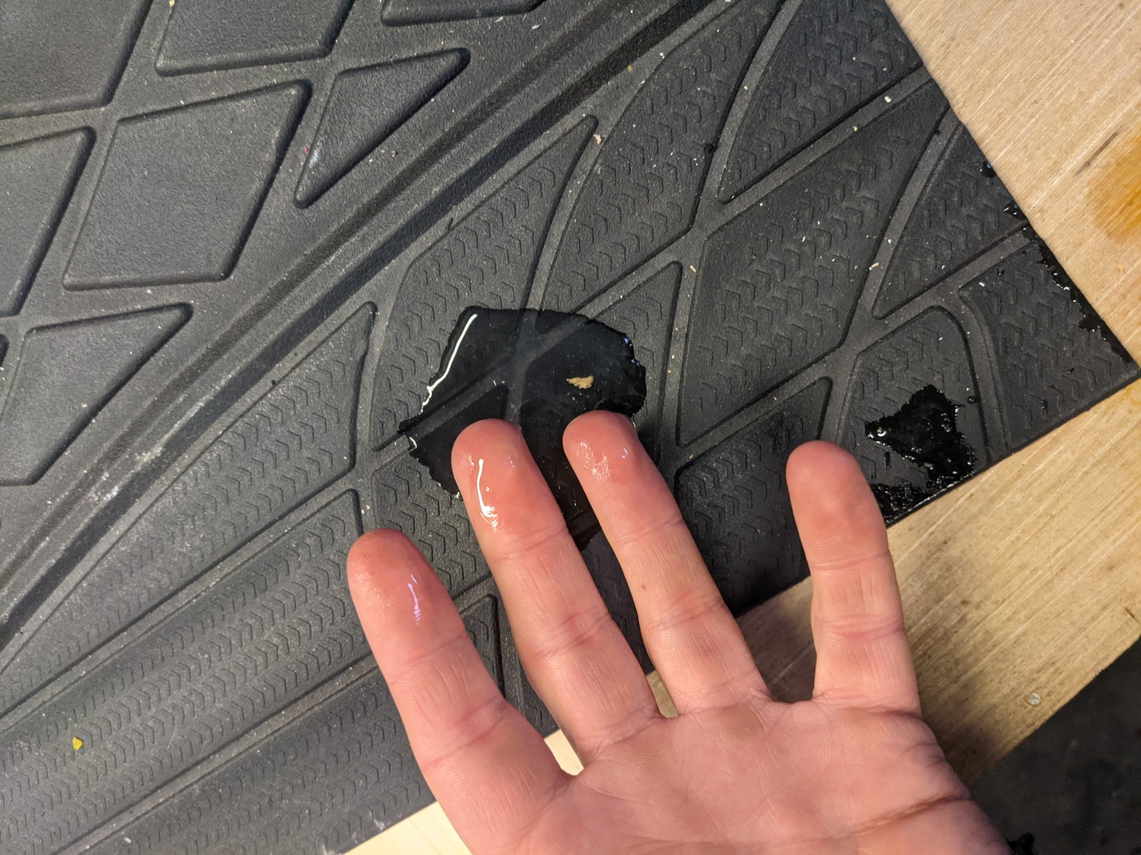

We got two gen 2 chargers and opened them today.
Turns out one of them was WET on the inside. Not water from the cooling outlets, definitely from within the unit.
We could now either
1) try drying it as good as we can and then check if it works
2) disassemble it further, to see where & how the water got in.
Has someone taken the actual charger boards out before? They seem glued in.
I will press on with the other charger for now, that seems dry at least.
A charger: A picture of water on a table: Sealant on the inside liquifying itself: Corrosion? Suspicious connector:
We could now either

Worth doing a pressure test to double check it’s coming from the inside. Haven’t come across that previously
Edit: If water has been in there it’s going to be knackered anyway.
If it came from a wrecked car, it could very well be rainwater, or removed and then get wet. It's not very whether proof even when lying flat. I do not think it could leak coolant on the inside, then it must be a crack/fault in the aluminium casting.
- EV_Builder
- Posts: 1205
- Location: The Netherlands
- Been thanked: 37 times
If it came from a wrecked car, it could have been sprinkled or soaked completely in the fire extinguish bath tub.
I have heard that over here they have big baths and they drop the car in completely to extinguish the battery fire.
