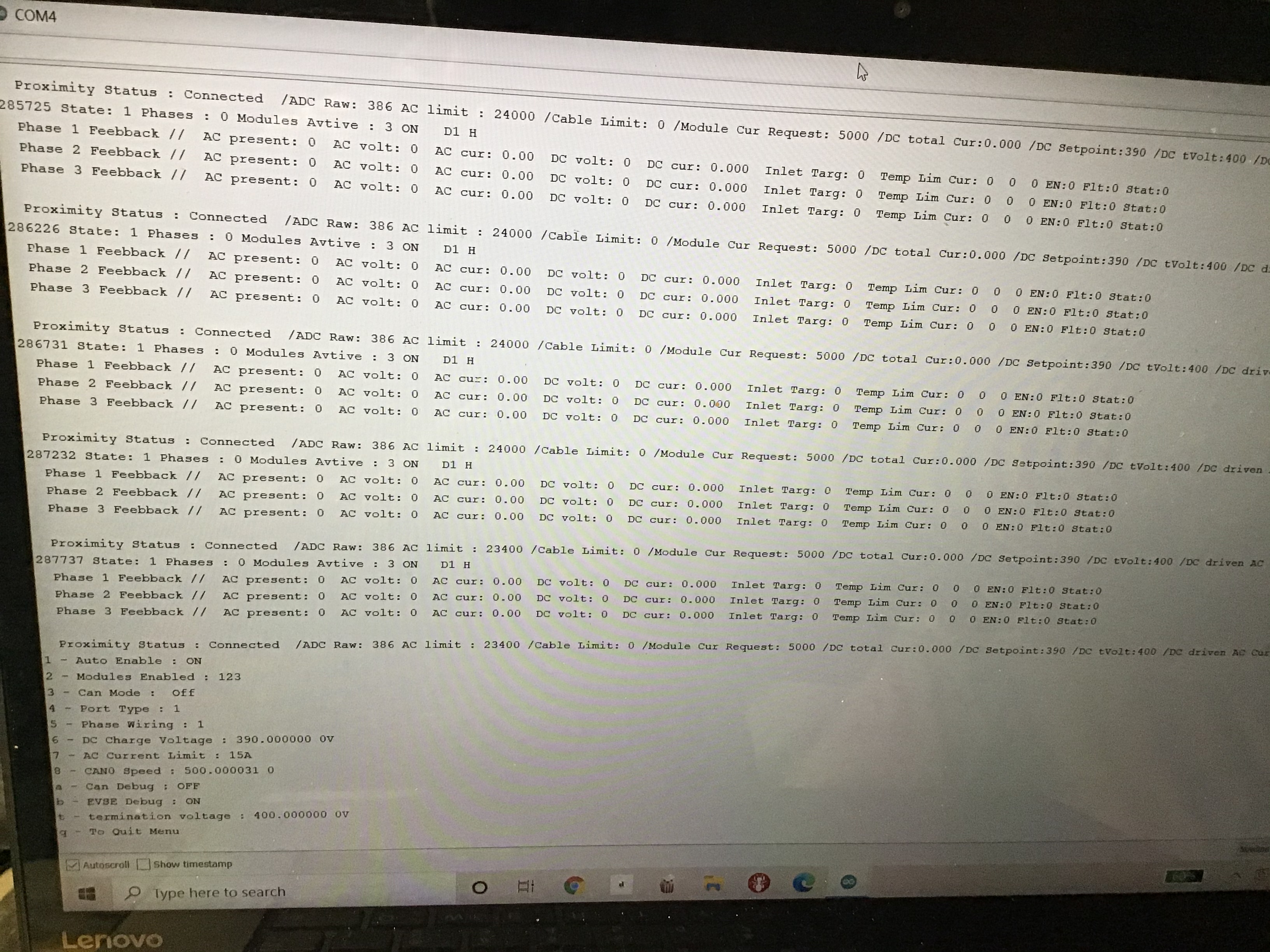

Post by Johaljaswant »
USA single phase 240 volt supply.
V5 board , I did try two Tesla charger 1014963-00-C and 1014963-00-K.
On both cases EVSE kick in but dc voltage showing 0, Not charging,attached screenshot.

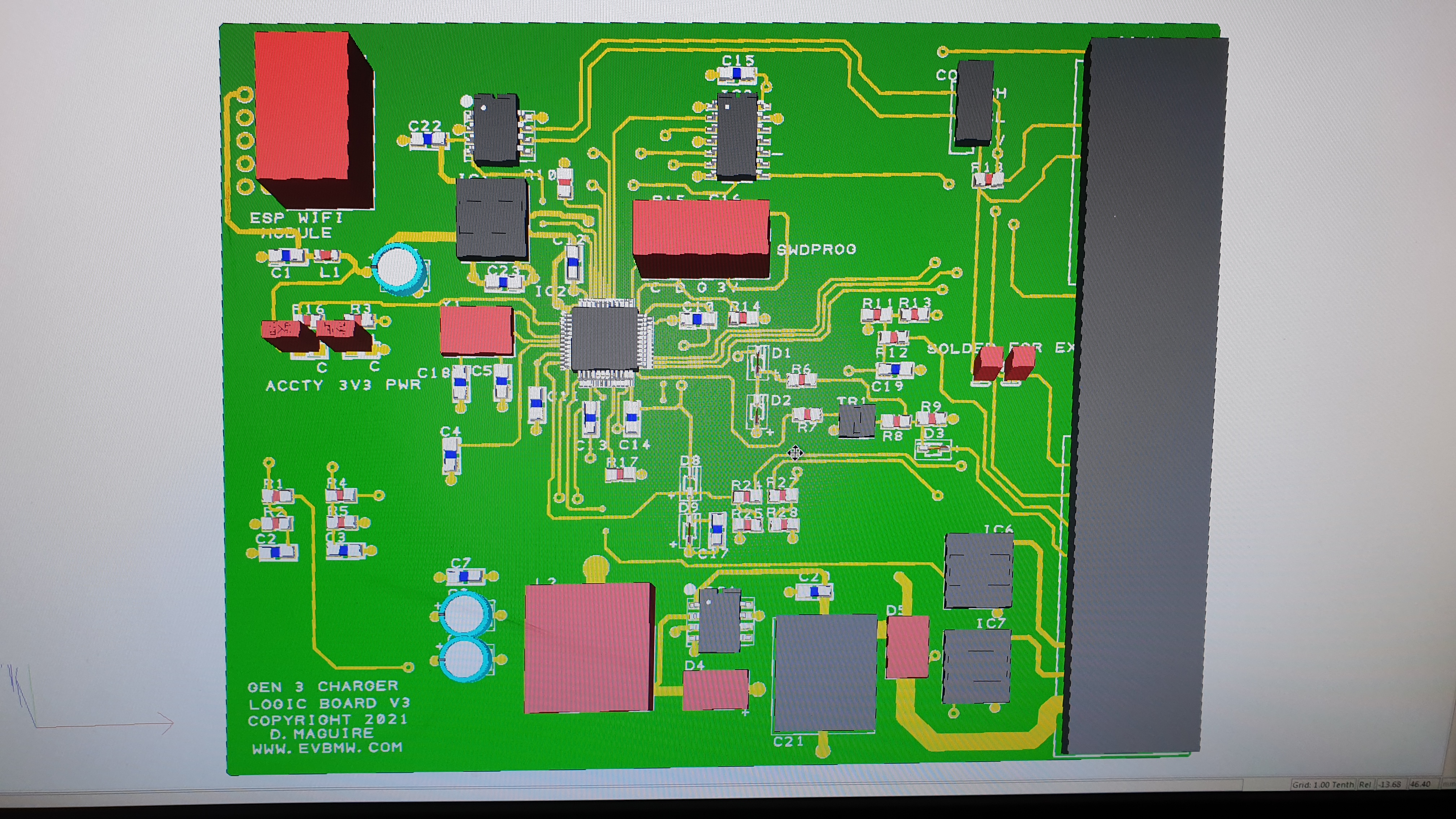

Posts: 4005
Been thanked: 1134 times
New gen 3 controller prototypes ready for testing:)

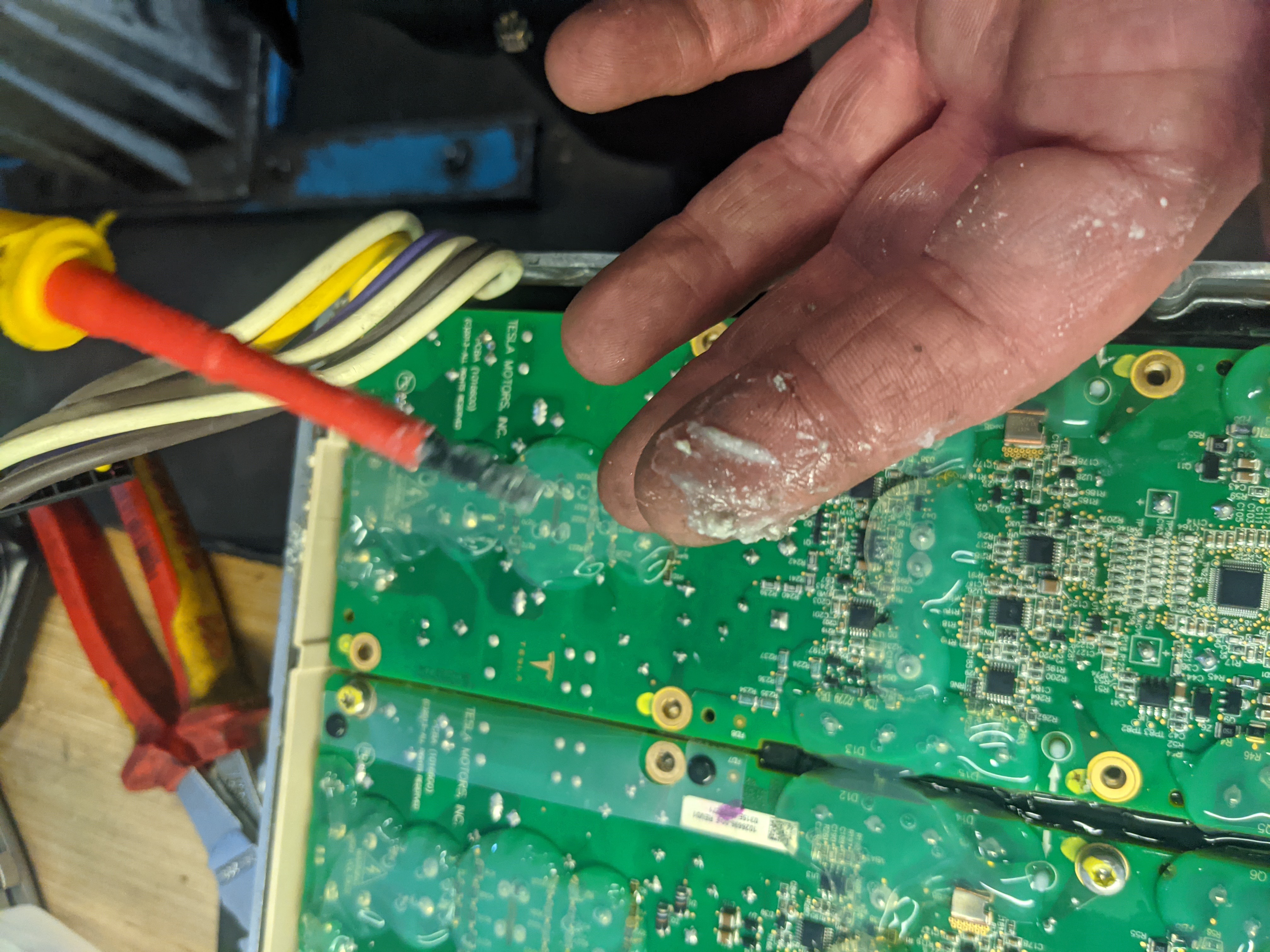

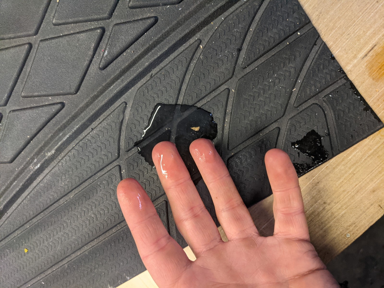

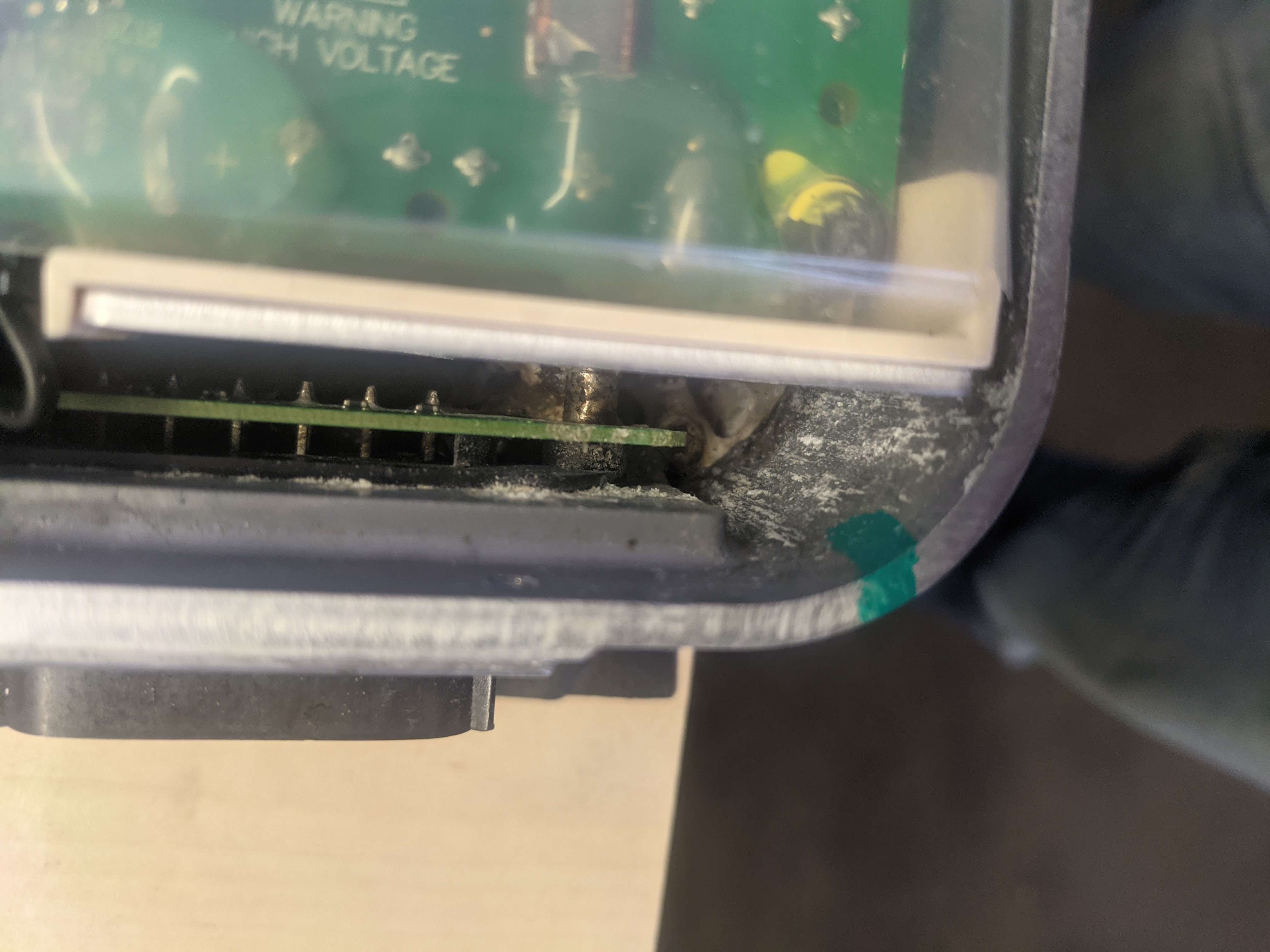

We got two gen 2 chargers and opened them today.
Turns out one of them was WET on the inside. Not water from the cooling outlets, definitely from within the unit.
We could now either
1) try drying it as good as we can and then check if it works
2) disassemble it further, to see where & how the water got in.
Has someone taken the actual charger boards out before? They seem glued in.
I will press on with the other charger for now, that seems dry at least.

Posts: 489
Location: UK
Has thanked: 57 times
Been thanked: 50 times
Post by Boxster EV »
Worth doing a pressure test to double check it’s coming from the inside. Haven’t come across that previously
Edit: If water has been in there it’s going to be knackered anyway.

janosch wrote: Fri Apr 23, 2021 4:27 pm We got two gen 2 chargers and opened them today.
If it came from a wrecked car, it could very well be rainwater, or removed and then get wet. It's not very whether proof even when lying flat. I do not think it could leak coolant on the inside, then it must be a crack/fault in the aluminium casting.

Post by EV_Builder »
joromy wrote: Sat Apr 24, 2021 7:27 am
If it came from a wrecked car, it could very well be rainwater...
If it came from a wrecked car, it could have been sprinkled or soaked completely in the fire extinguish bath tub.
I have heard that over here they have big baths and they drop the car in completely to extinguish the battery fire.
