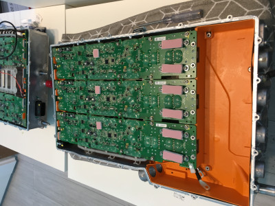

Does anyone know the coolant flow direction for the gen.2 charger.
50% chance I mounted it the correct way :)
It looks like this inside the coldplate:
Posts: 4005
Been thanked: 1130 times
I have ran coolant in both directions without problem.
